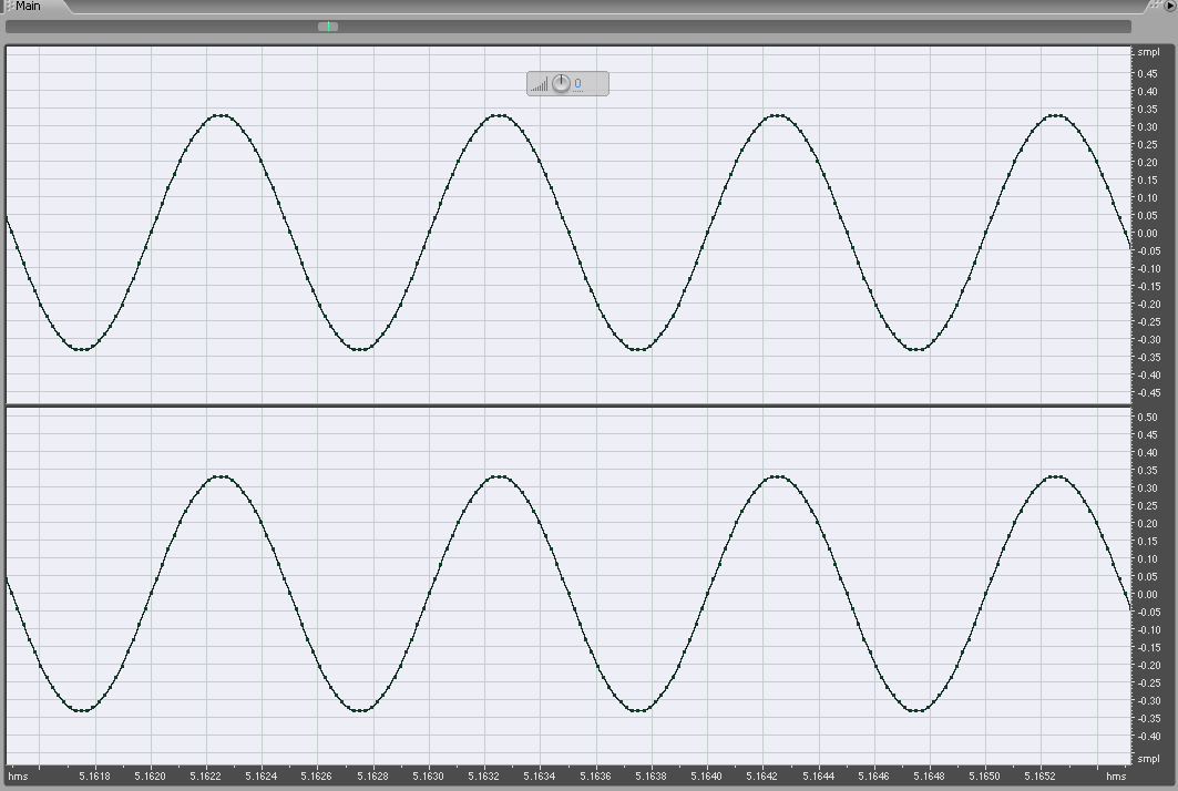

It would be interesting to try different kinds of dither and see what happens.
But 16 bit = 16 bit. These low levels are only toggling with least significant bit. No "true" signal.
-100dB/24bit is still a soundwave more or less defined.

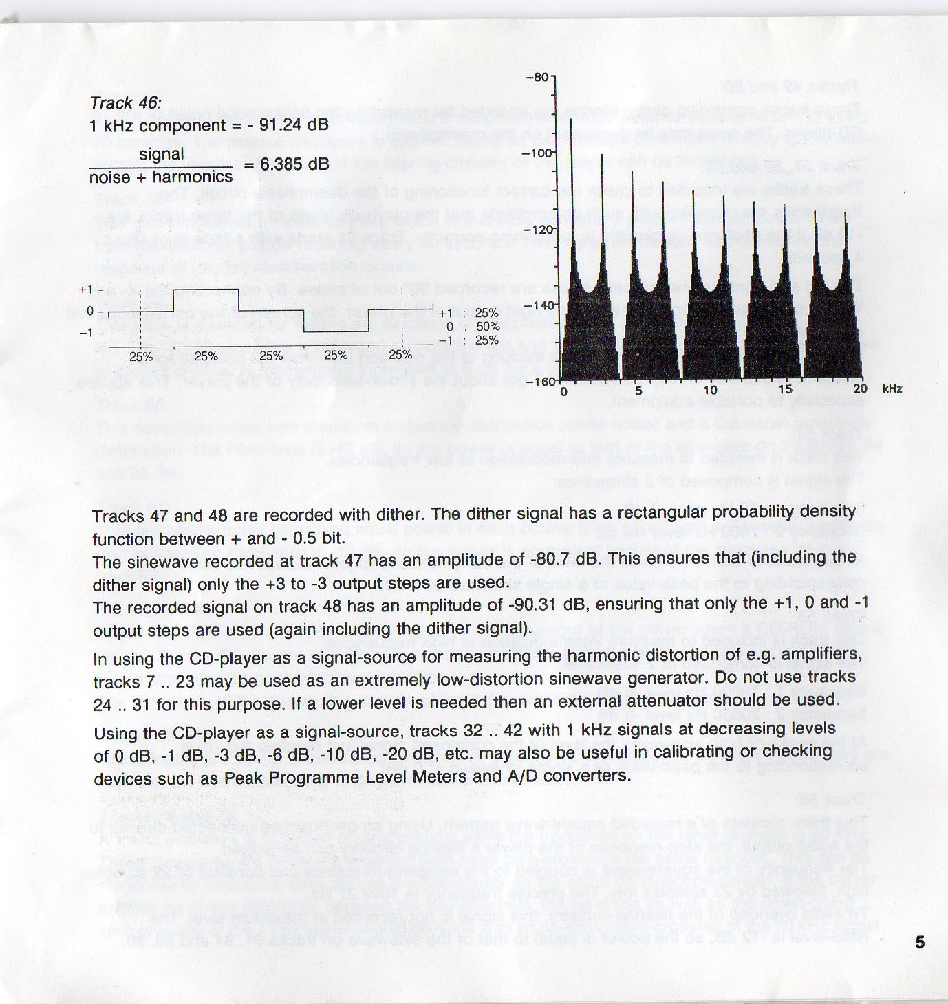

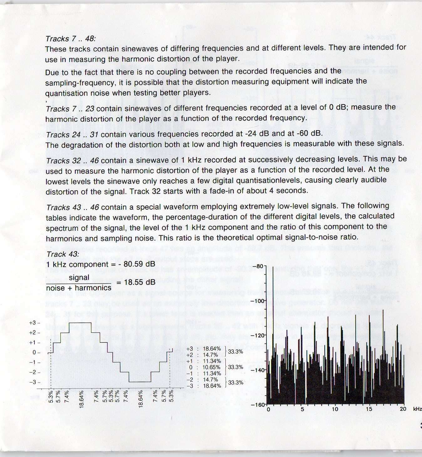

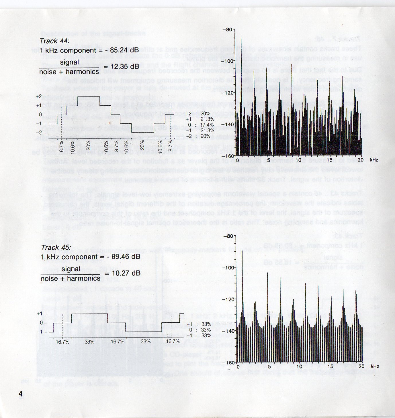

I'm reading all your replies, thank you 🙂
For interest these are the notes from the test CD that wouldn't play on a PC.

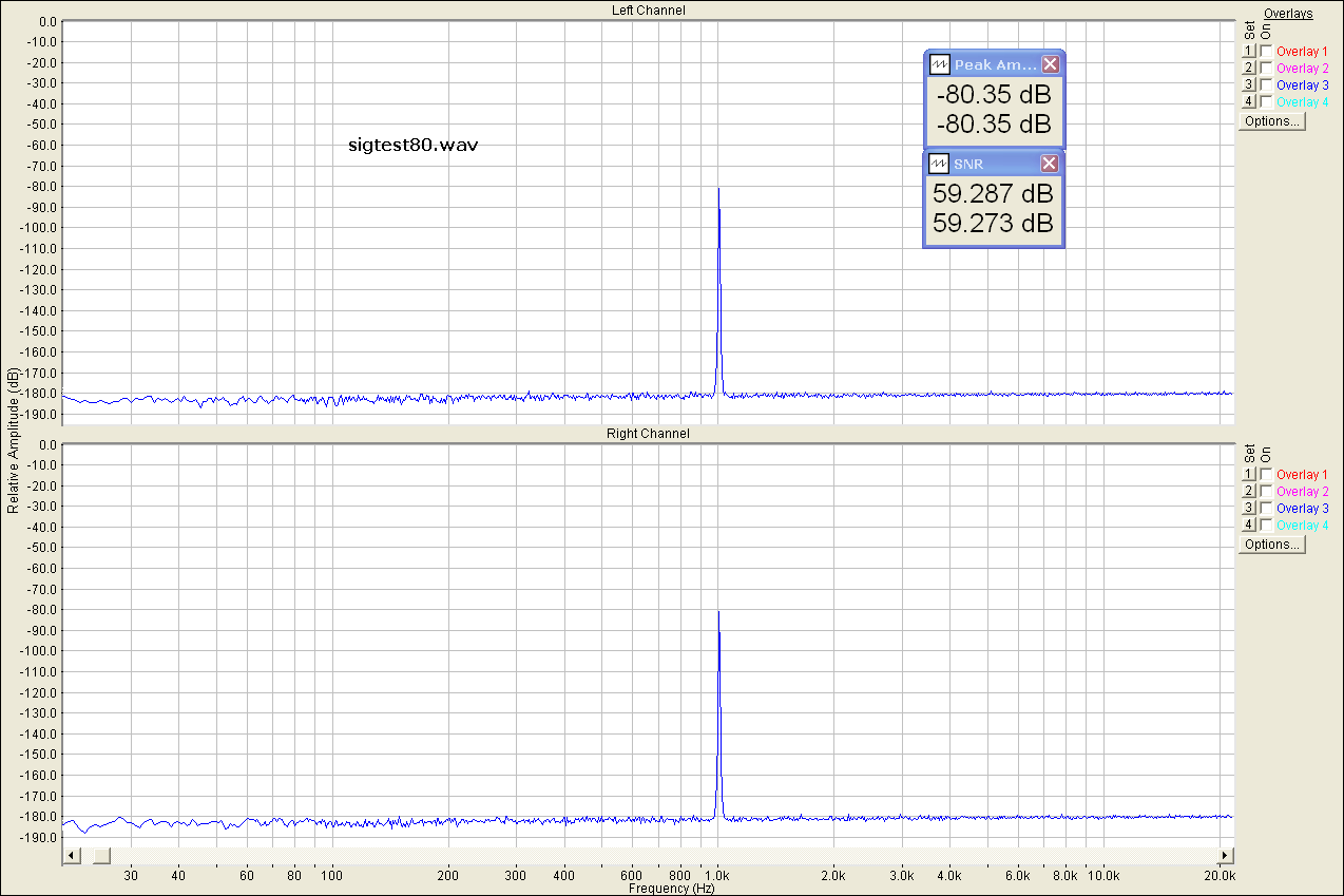

Absolutely. Or you would get instantly deaf when using headphones 😀
That -80dB signal is not too bad, I hope.
