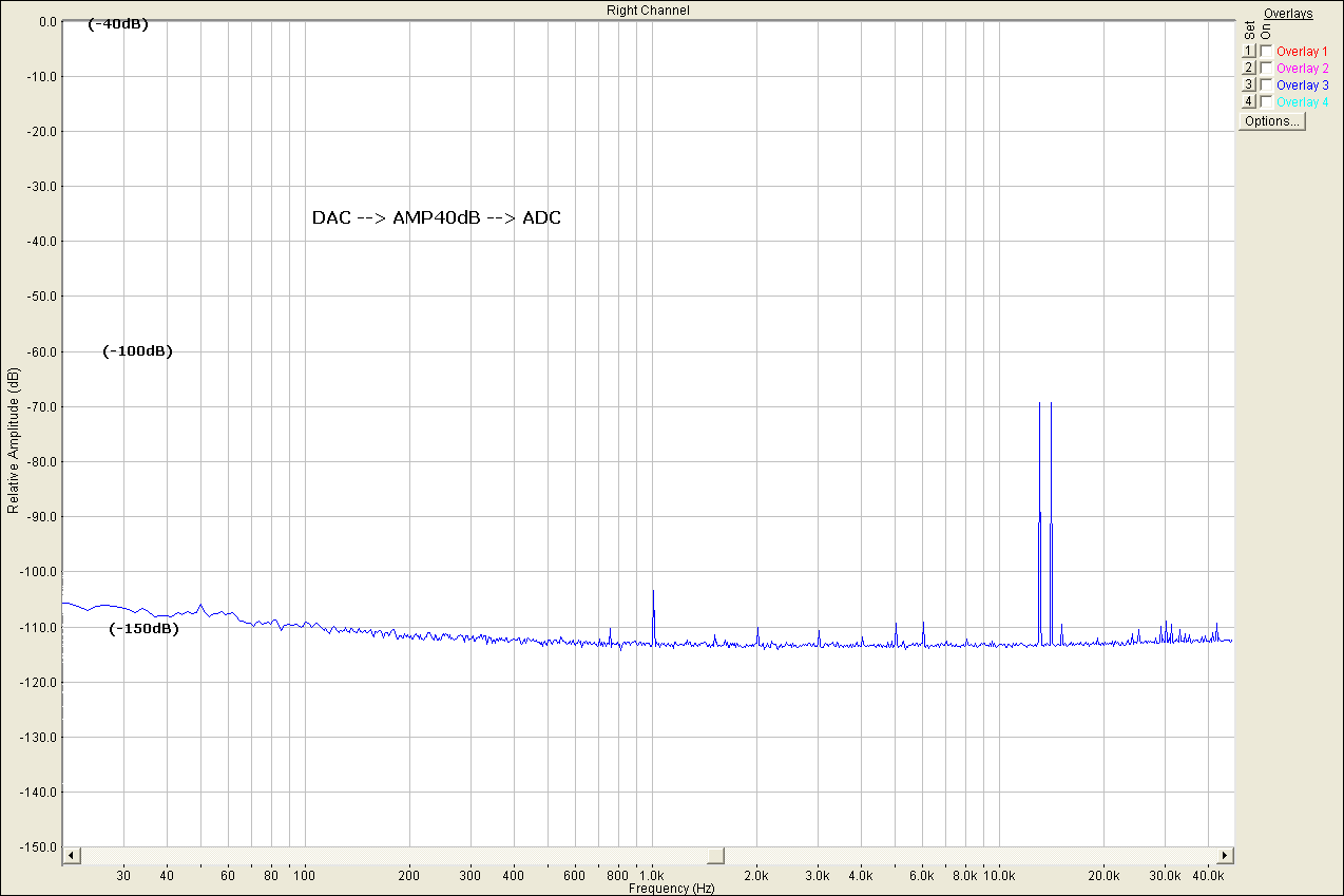

To test the DAC performance, I use additional +40dB analog amplifier. The reason is that my ADC is worse in parameters than the DAC. Example of DAC measurement is attached. The test chain is DAC (fed with -100dBFS signal) --> analog amplifier +40dB --> ADC. So the plot must be 'moved' 40dB down, for the reason of +40dB amplification. In brackets are already moved dB values. DAC output at FS provides -2.7dBFS measured with ADC, so therefore the dB value is not -60dB as expected but about -62.7dB. And yes, this arrangement has groundloop 😉. 0dBFS input of ADC refers to 2Vrms. Also please notice that -100dB DAC signal has only about 1% harmonic distortion .....

This is fine, there's nothing wrong with objective measurements.
But the proof of the pudding is in the eating, so we need subjective measurements.
Can you positively ABX a normal music file with no white noise added vs a file that has white noise added at -80dBfs?

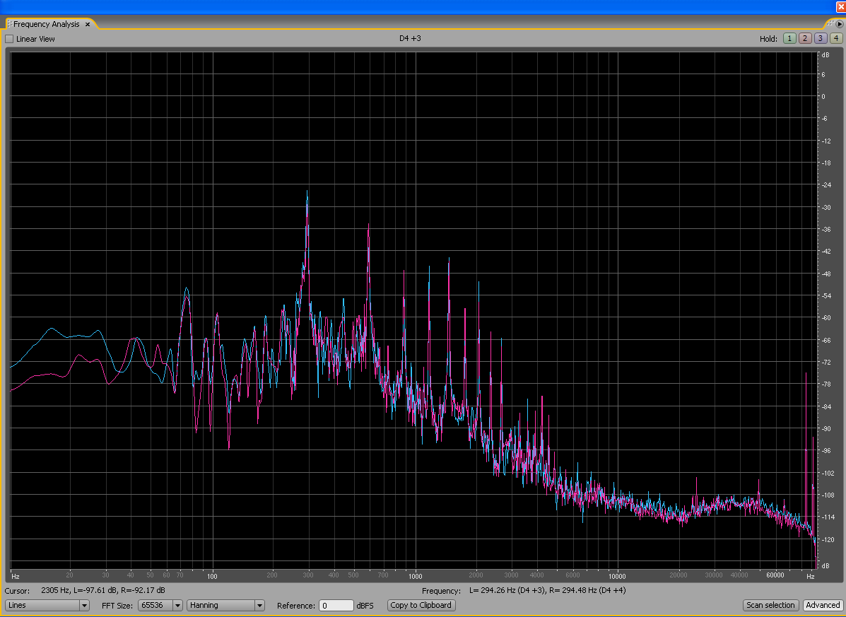

I thought if they had anything more. On this page, there is just one music sample, the 'test192'. Analysis is attached and it has quite low amplitude through the whole file. I am not sure that this sample would be a good candidate.
P.S.: Anyway, it is available, so why not give it a try🙂. Use something that is able to convert flac into 192/24 wav, if you try foobar without additional setup it would create a 44.1/24 file.
