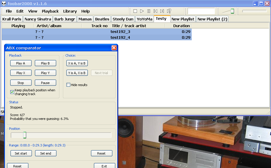

Here is my ABX result:

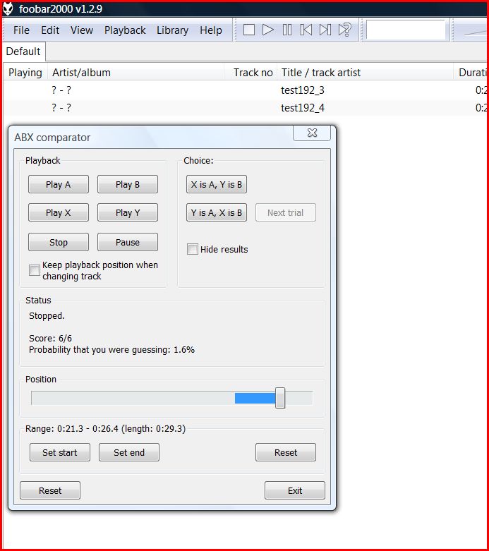

So I downloaded this foobar do-dah, then find it needs a plug in for ABX, then have a play to see how it works 😛
Once you know what are listening for its, well I won't say easy, put its do-able.
Edit... as you will see. I used a very narrow time window to play back to focus on differences.

Great result, Mooly!
heb1001, do you think that 2/2, that means 2 trials, is enough? 😛
No, you and Mooly ABX result. Good enough for me.
Shaped dither when converting to 44.1kHz is poor choice. Common engineering mistake. Great for recording high sample rate.
At least we may verify its ABX audibility 😉.

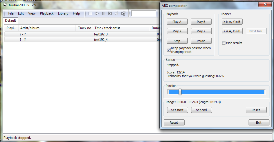

Pavel, this test is a lot easier than the cello one.
Do you think ? I didn't have the ABX thing for that one.
There is no way I could have differentiated these latest ones without being able to immediately compare one agains' 'tother. With the Bach I just listened normally... and preferred the degraded file 😀

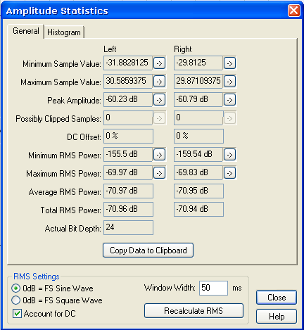

It is crazy. This is the statistics of the difference file between test192_3 and test192_4 😀 .... and spectrum of the difference file
