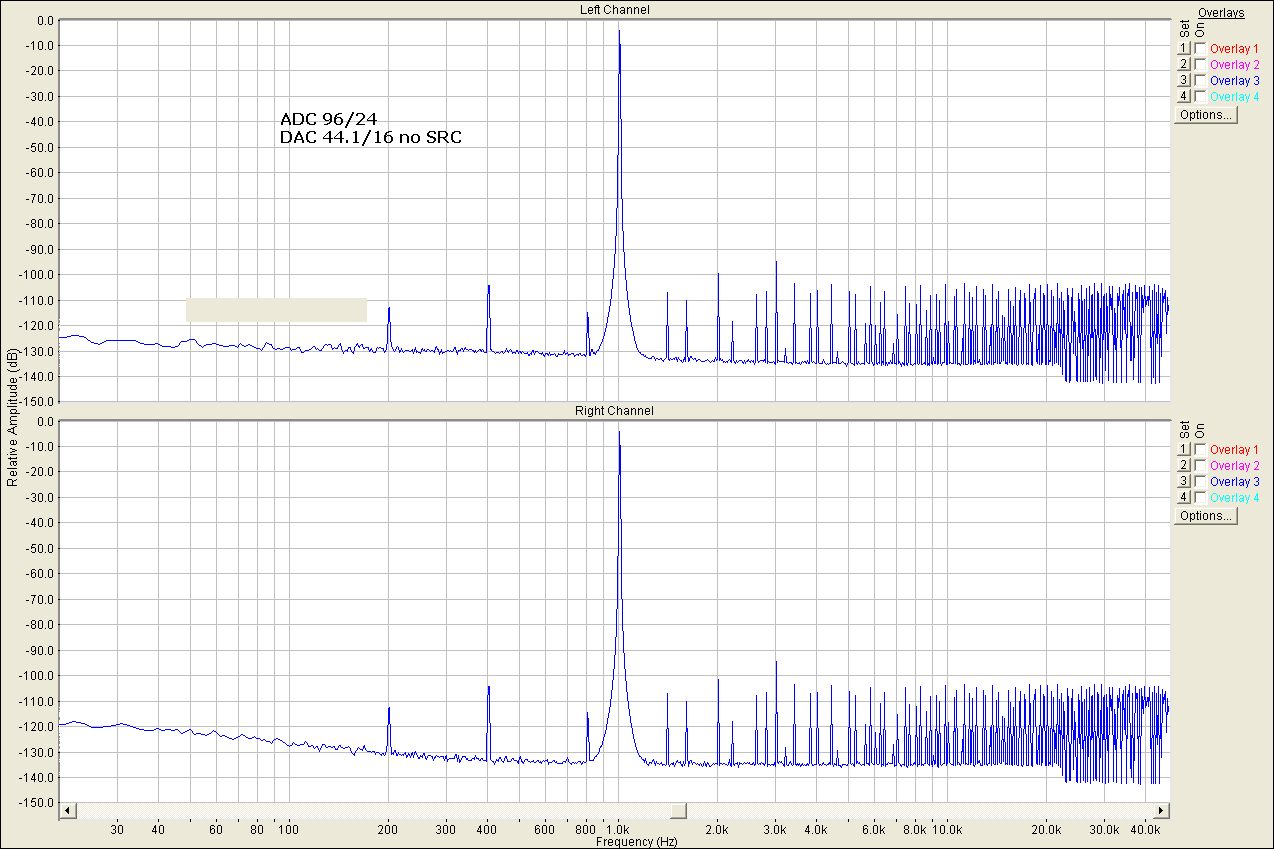

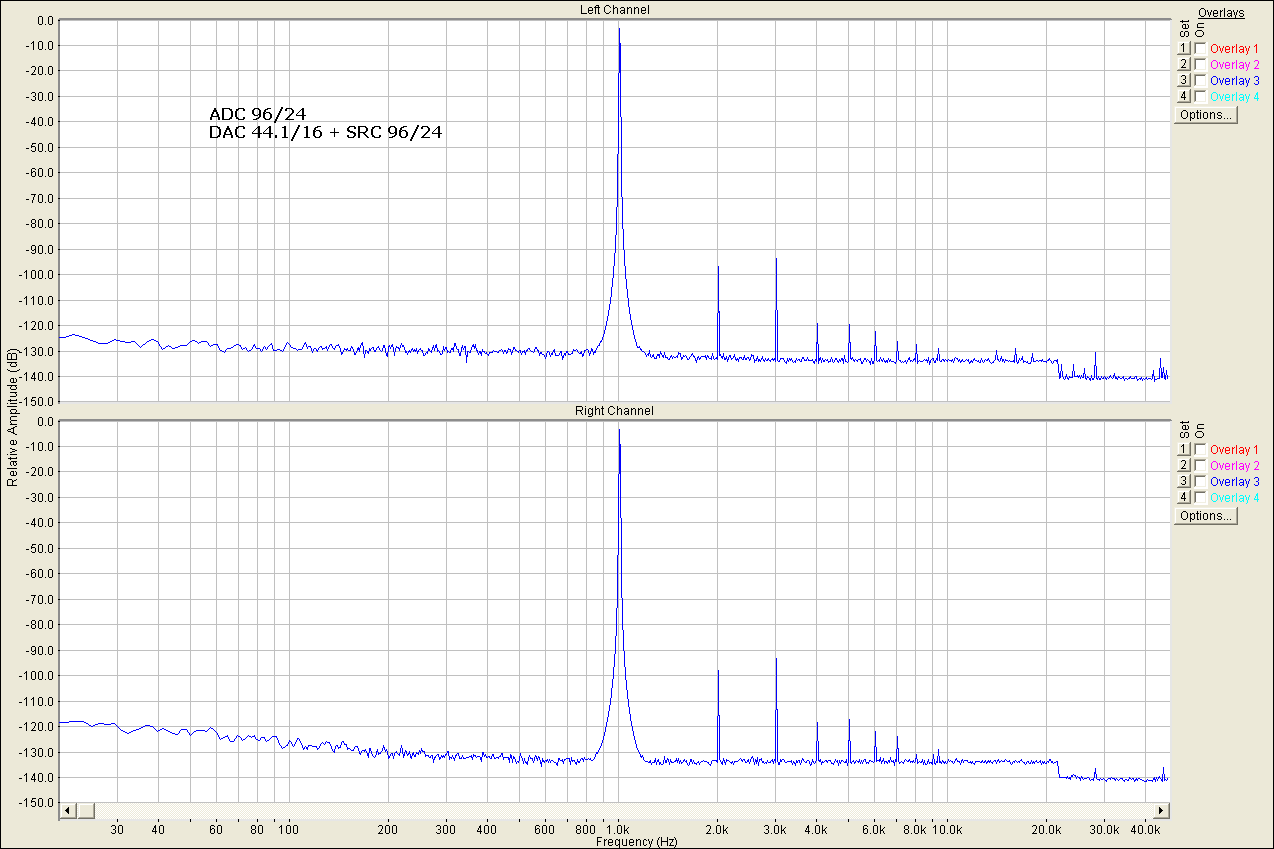

But again, without measurements and analysis one is lost. My card is clocked for 48kHz/96kHz. For 44.1kHz it uses inner sample rate converter (which performs horribly). Thus, i MUST use SW SRC for playback and I do use this in foobar. Please compare what I get from 44.1kHz with and without SRC. The 1kHz test signal is 16 bit, properly dithered.

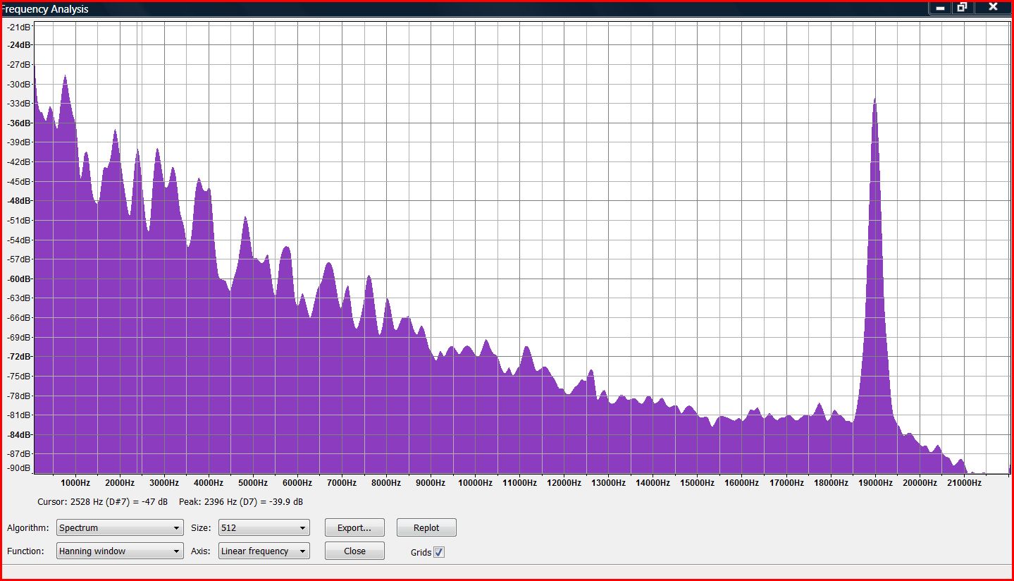

heb1001 might find this interesting. Remember the 19.2kHz tone you were concerned over and that was proved to be being generated by the sound card on my old Acer. Well here is the output of an old FM tuner (Sony ST515, the companion to the TCK cassette deck). As a youngster I could detect that pilot tone on FM broadcasts 🙂

Good!! 😀
(Mooly, try to enlarge "size") of your FFT (bottom left click box))
