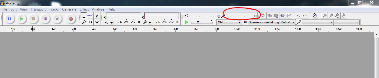

Quick Audacity question.
When recording with Audacity and using the PC's A-D convertor (so using line inputs) where in the chain is Audacitys record level attenuator.
Does the setting affect quality and resolution of the recorded file ?
What I am getting at is whether it is better to set the slider to full and attenuate the input or, is it OK to attenuate using just the slider. To avoid clipping I find the slider has to be no more than around "0.22" on its scale.

Yes, generally better to set the slider to full and attenuate the input. Some sound cards distort if input is near full scale so you should check that too.
You need to make Rightmark loopback test or you may use other SW that is able to make FFT, S/N etc. and you have to optimize both output and input level for lowest distortion and highest S/N. It may be pretty tricky with various soundcards. 100% level setting usually results in quite high distortion and unwanted digital artifacts. There is no advice without proper measurements.
Yes, the position of the record level attenuator depends on the details of your particular soundcard. Some have an analog mixer with level control, others do the mixing in the digital domain.
Even if the chip does have an analog mixer, it may not be able to handle more than about 3V p-p input without distortion, irrespective of how the mixer is set.
That makes a lot of sense because I found that a CD player connected to the line input and playing a 0db test tone actually breaks through and is loud and horribly distorted even when no audio programs/Audacity etc are running. PS was just displaying the desktop. Drop the input level down a few db and silence returned. Thanks 🙂
