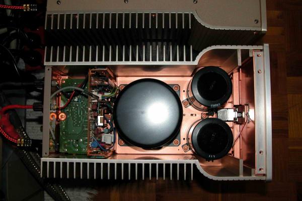

That's because you cannot sell a 20Kg amplifier costing 5.000$ by advertising their "just" 25w per channel.
Other mainstream manufacturers choose to say the real ratings, but they seem so small that use to show them in a shy and small thypography.
22KG the pair, at roughly $5000 in the early '90s, for 30W Class A power per channel. :clown:
Quite a few sold, actually.
(Oh Dear, these were used Bridged, and MOSFET output stage amps on top of that !)
