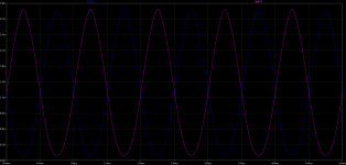

the two halves are in series (I think series is the right word) with the load so we don't get 5.2A class A from our 2.6A bias.
Appologies. I think that statement is bollocks.

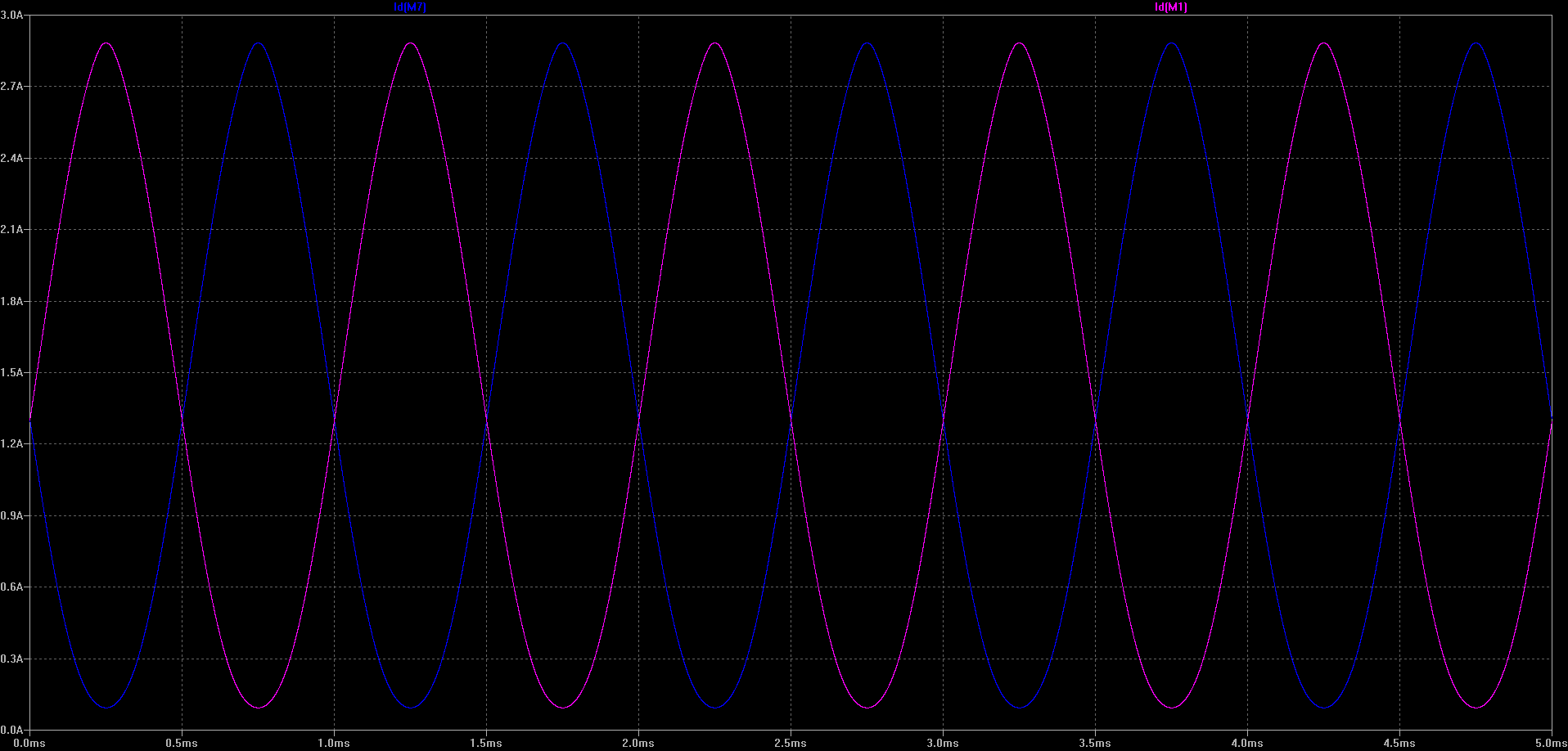

My guess about the reason why you don't get 5.2A max Class A in the F5X is because the signal running through each pair is 180 degrees out of phase so you don't get summing of 2.6A + 2.6A max class A of each half.
A stock F5 with 2 parralleled pairs each biased at 1.3A (2.6A total bias) gives you max class A of 5.2A because the signal coming from each pair is completely in phase so you get 2.6A + 2.6A from each pair, which is obviously 5.2A.
Well this might be bollocks too. But it is my best dumb guess.
Nelson, you would be surprised how much basic stuff we don't know. If this is wrong Nelson please put me out of my misery.
Here is more additional guessing. Some serious guess work going on here. If I get this right I might be kicked out of the dumb club.
At the middle of the load we have a virtual earth.
When we have +10V coming from one half of the amp we also have -10V coming from the other half of the amp.
+10V referenced to -10V is 20V. However when we have our max +2.6A coming from one half of the amp we have 0A coming from the other half of the amp.
2.6A referenced to 0A is 2.6A. So we don't get 5.2 A.

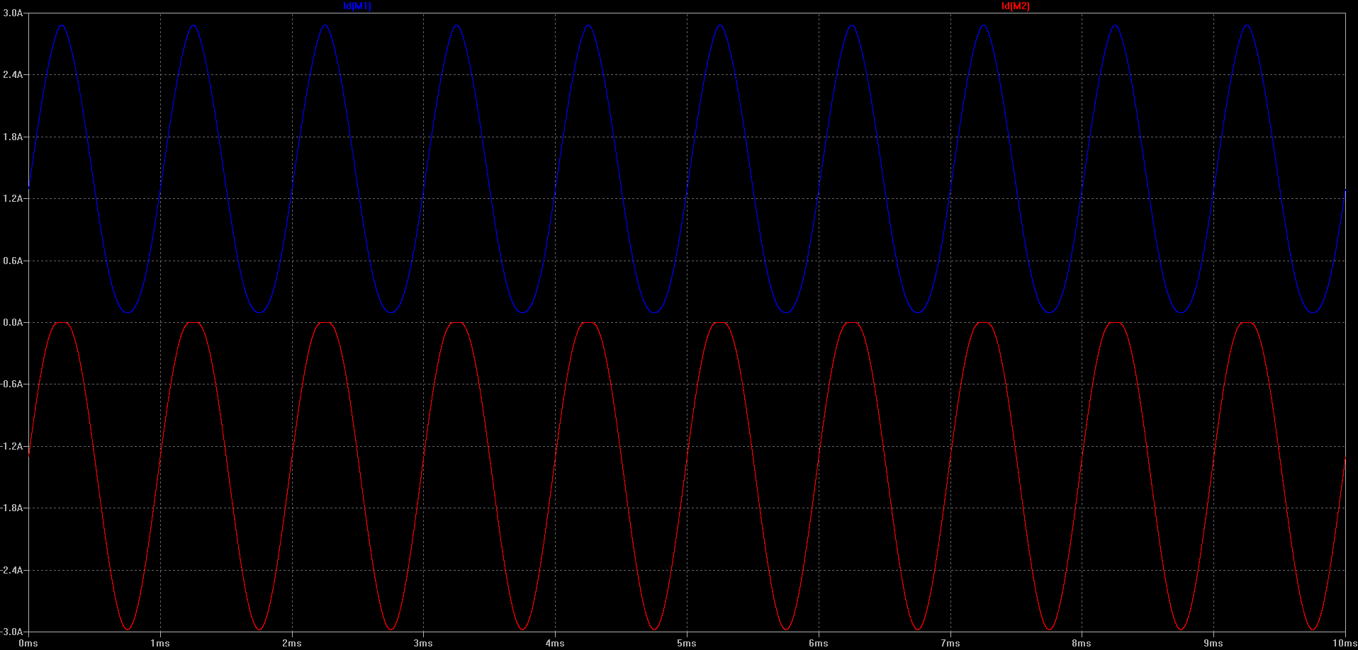

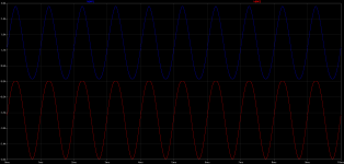

I think this proves my guess (I am too dumb for theories).
When IdM1 is at max current IdM7 is at basically 0 current, and vice versa.
If I got this right, I just reinvented the wheel or reinvented 1st year University Text books across the planet

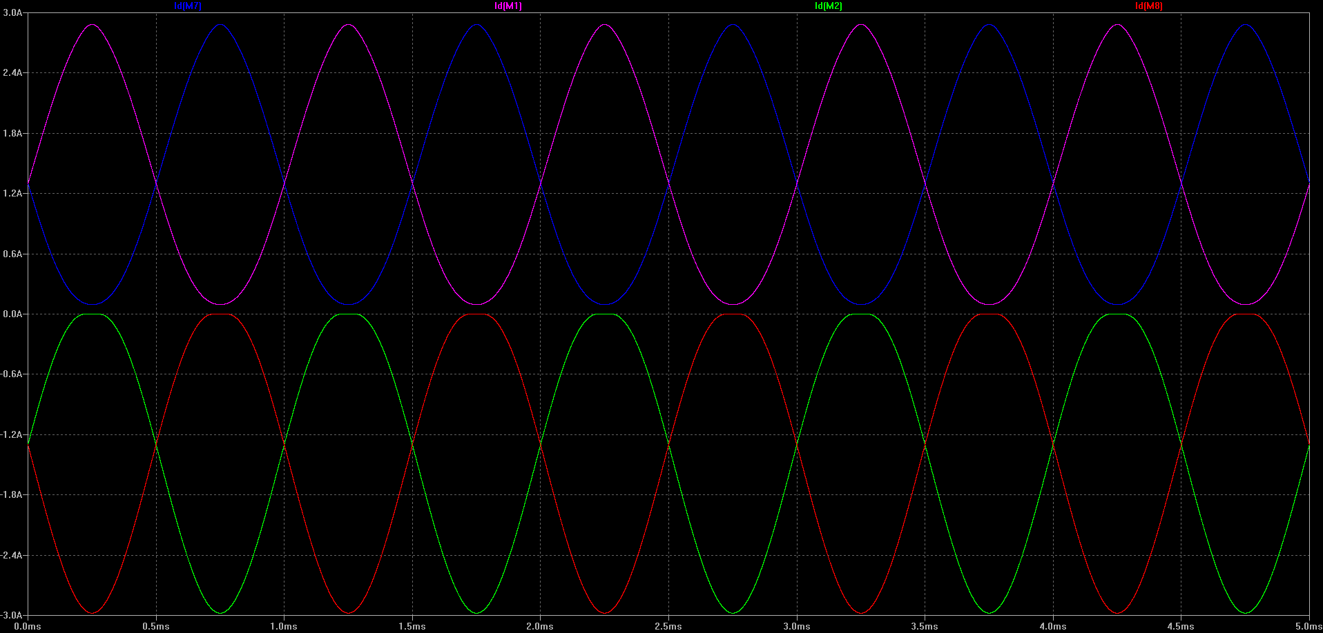

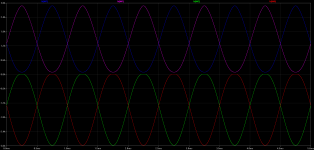

And here is the complete picture.
When IdM1 is at max positive current IdM7 is at 0 current and vice versa.
When IdM2 is at max negative current IdM8 is at 0 current and vice versa.
Nelson if this is wrong then please say so. I don't care actually. If I am wrong then it is more evidence to say that I am dumber than Zen Mod (I am trying to build up a strong case)😀

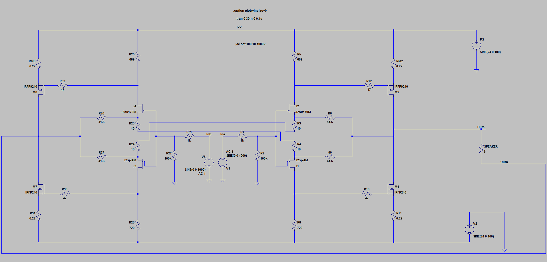

no way Jose ;
it's well known who's dumbest around
you even know how to power up that sim .........
tip - just look what's current through load - then it's easy to see where it's coming from .
another tip - decrease load resistance and push those buggers in clipping - it will tell you even more
edit : maybe you can post zipped asc file ..... so somebody else can play with , too ......

I already did that. I don't have a problem with that part of the operation.
Just trying to explain for the benefit of all why you don't get 5.2A max class A from F5X biased at 1.3A + 1.3A.
I think I have explained it correctly however if I am wrong, I will be making a claim for the title of King Dumb😀
Since this is the balanced thread, I shall only comment on the balanced version.
The definition of Class A is that one transistor goes to near switch-off. So for a balanced circuit biased at 4A in total, the top left MOSFET (say) goes to 0A, and the top right MOSFET goes to 4A; the bottom right to 0A, and the bottom left to 4A. A net positive current of 4A now flows from the positive power supply rail through the top right FET (as only the top right FET is on, and the bottom off) to your speaker, returns to the left side where it is drained to the negative rail via the bottom left FET.
i.e., the maximum Class A current output equals the total DC bias in a balanced circuit, and the power supply sees a constant current consumption (over-simplified as total device linearity is assumed, which is not reality).

Melon Head,
In a balanced amp, the output currents are Xed.
From the top of an amp to the bottom of the otherone.
And reciprocal.
When one branch of the X reaches 2.6A the other one reaches 0A.
Which is the definition of leaving classA.
And yes, it's a serial crossed connection.

Thanks Patrick. Which I think agrees with what I discussed earlier below and backed up with simulated results
