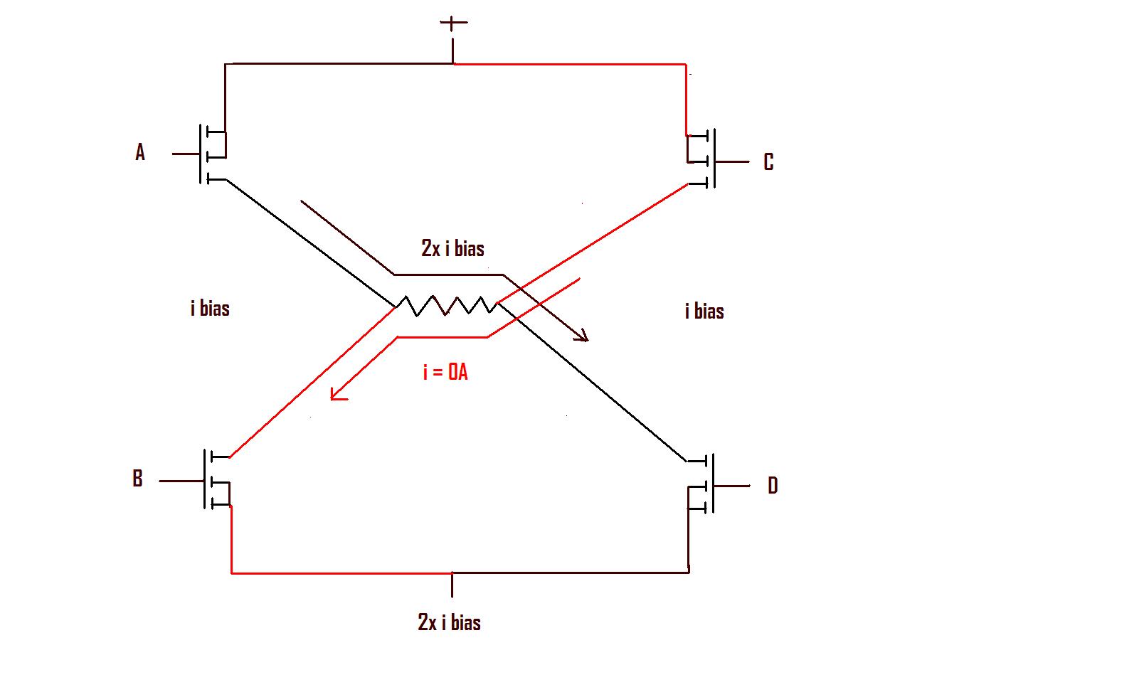

After my last post, i realised that my post 987 and some others were wrong.
Two balanced stock F5 balanced biased at 1.3 each produce 25w classA and not 12.5W.
I am stupid.
Even looking at the drawing with virtual ground, it can be seen that each amp produces simultaneously 12.5W classA into half the load, which is 25w total into the whole load.

In order to (try to) be forgiven, i produce this drawing.
When the current in AD branch reaches 2xIbias ( or total bias)
The current into BC branch has decreased to 0A.

I think all this confusion in amongst some very correct science is brought about by two quite different "wives tales".
First. It is wrong to say a bridged pair or balanced amplifier delivers 4times the power.
Second. It is wrong to say a ClassA amplifier draws constant current.
These two errors in understanding are so ingrained into our thinking that they are subtly altering our ability to reach experimentally based or thought based conclusions.
You must go back to the correct versions of the two statements.
A bridged pair or balanced amplifier delivers double the power into double the impedance.
A ClassA amplifier modulates the current demand in the supply rail/s to match the modulated current fed to the load.
Many parts of the recent discussion are accurate. But, in between, there are many statement that are simply wrong.
