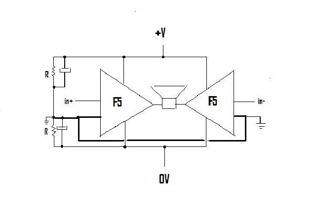

I've asked a few times in the main F5 thread, but I didn't have a schematic. I put together a rough sketch of my question on the attachment.
Briefly, I have a standard F5 set of parts, and I'm interested in whether two boards can easily be converted to one balanced channel. I've seen Patrick's balanced F5 schematic, but he uses the Toshiba outputs, I have the IRFs.
Can the attached setup work without substitution of a lot of resistor values, or is the effort more complex?

I noticed that I had misread your partially inverted pdf. I intended to come back with an "oops" and ask you to explain what was happening to the two sides of the inputs.
But, I forgot. Sorry!
If the left side is restored to non-inverted, then the two new links get twisted to form the X, that is part of this balanced arrangement.
If you draw that part with the X and with both sides non-inverted, how does your proposal compare to the other examples of balanced topologies? I think there are about 4 ways to make this balanced work.

The balance topology is basically correct.
As shown, it delivers its full power for a 15 ohm load.
If you have a lower load impedance, then you are not using the rail voltage to the full, and you could have used with more current.
This is why the circuit I published has 16V rails and 2A bias.
But it will work.
And I suggest you ground the intersection of the "X" to start with, trim everything properly, before you float the X for final trimming.

is this your recommended setting up procedure?......And I suggest you ground the intersection of the "X" to start with, trim everything properly, before you float the X for final trimming.
Ground the X and set up the amp resistors/currents.
Then unground the X and trim to final currents/offsets?
If ungrounding shows up an error, can we read the errors to work out where they are coming from and make circuit adjustments to correct the circuit errors, eg. change the value of a source resistor rather than simply trim out an offset.
