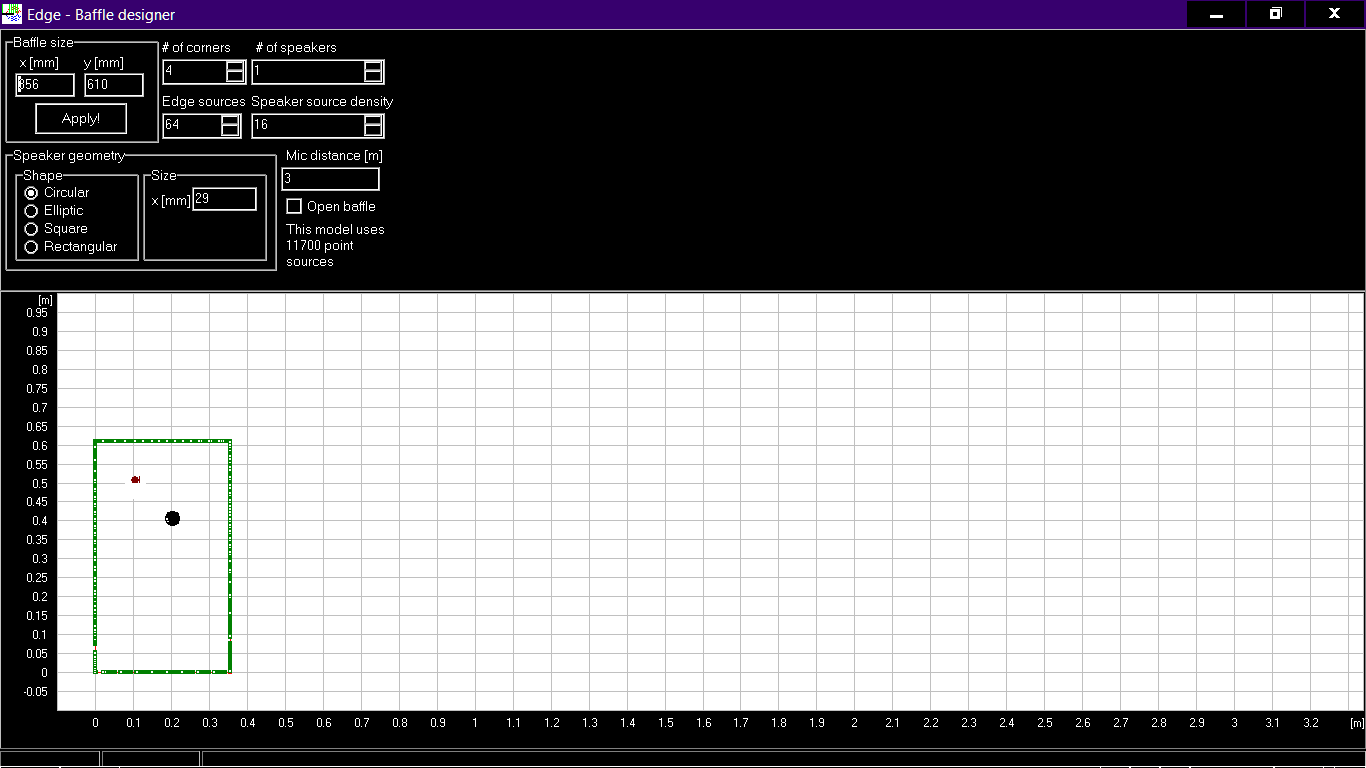

Alright here is a screen shot of an edge simulation that shows a baffle and tweeter. Plug it into edge and move the microphone around and you will see the diffraction signature is fairly "consistent". Therefore if the peaks and dips are equalized it will help all around. This is what I've been trying to say, anyways.

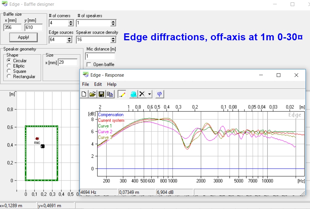

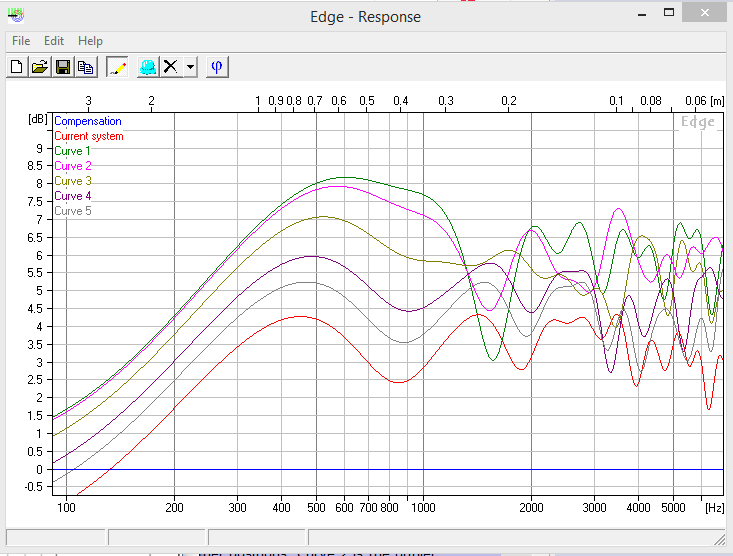

3m distance. I'm genuinely interested if I did something wrong. Looking at your graph I'd say that's more consistent than other positions. Curve 2 is the outlier.
Using your Edge model, I get something like Juhazi. I do not see how peaks and dips line up anywhere. As a result, EQ can not help "fix" the pattern.
I started more or less right on top of the driver. Then I moved off axis keeping the same "height" until I reached 3m to the right. This was at 3m distance. That's only going out to about 45 degrees off axis.

Looking at 33's overlays, the consistency of high treble reveals that offset angle was less than 10¤ in every pos. Stereophile uses +/- 15¤ average, but listening window ála Harman means up to 30¤ sideways.

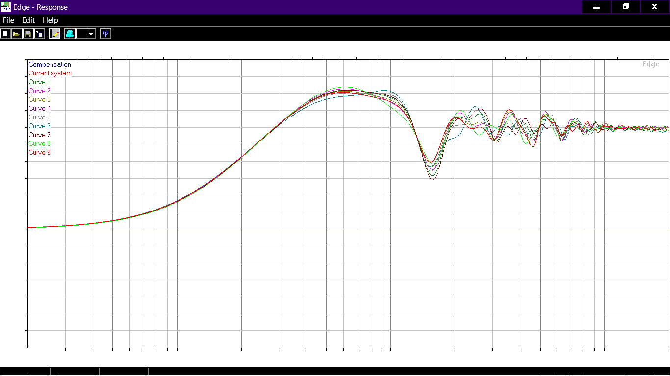

I found how to reproduce 33's plot where the peaks and dips line up. Just increase the mic distance to a very high number (e.g. 9999 meters). Then everything looks the same! Why? Because at that distance the off axis angle you get is all very close to zero, and thus APPEARS the same but that is because it it. You are looking at essentially the same off axis angle (very close to on axis) everywhere. That is unless you zoom out the x axis to match. Then you can again create a non-insignificant off axis angle and the peaks and dips move.
Even if you do not use such a large listening distance, you can get almost the same effect: start with the mix on axis at 3m, move the mic over 1m, and then set the listening distance to 12m).
Is this what led to your plot, 33PolkHigh?
I think it was within 15 degrees listening window. AND no they don't all line up at the axis when you measure in a circle. You can still get swings even when measuring at those angles. You went way off axis to produce a plot that definitely didn't line up.
