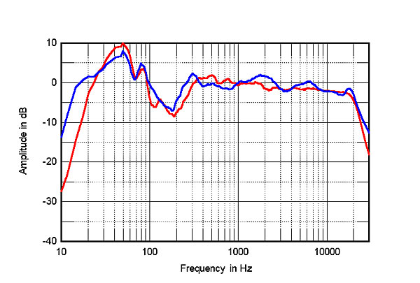

Stereophile magazine has done measurements of loudspeakers for decades, off-axis for more than 20 years. Some of their reports have also in-room measurements, and it is very interesting to compare lab and room measurements vs. listening impressions - some astonishing reports included! Sonus Faber Aida beats Wilson's top model in smoothness! Red line in graph. B&W top models are strange fruits - in-room is much better than near-axis would indicate.

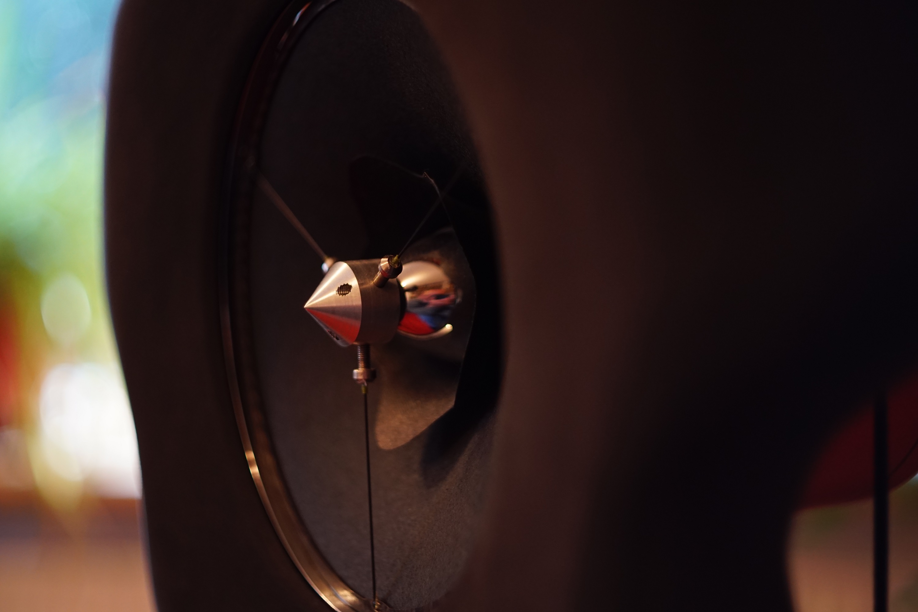

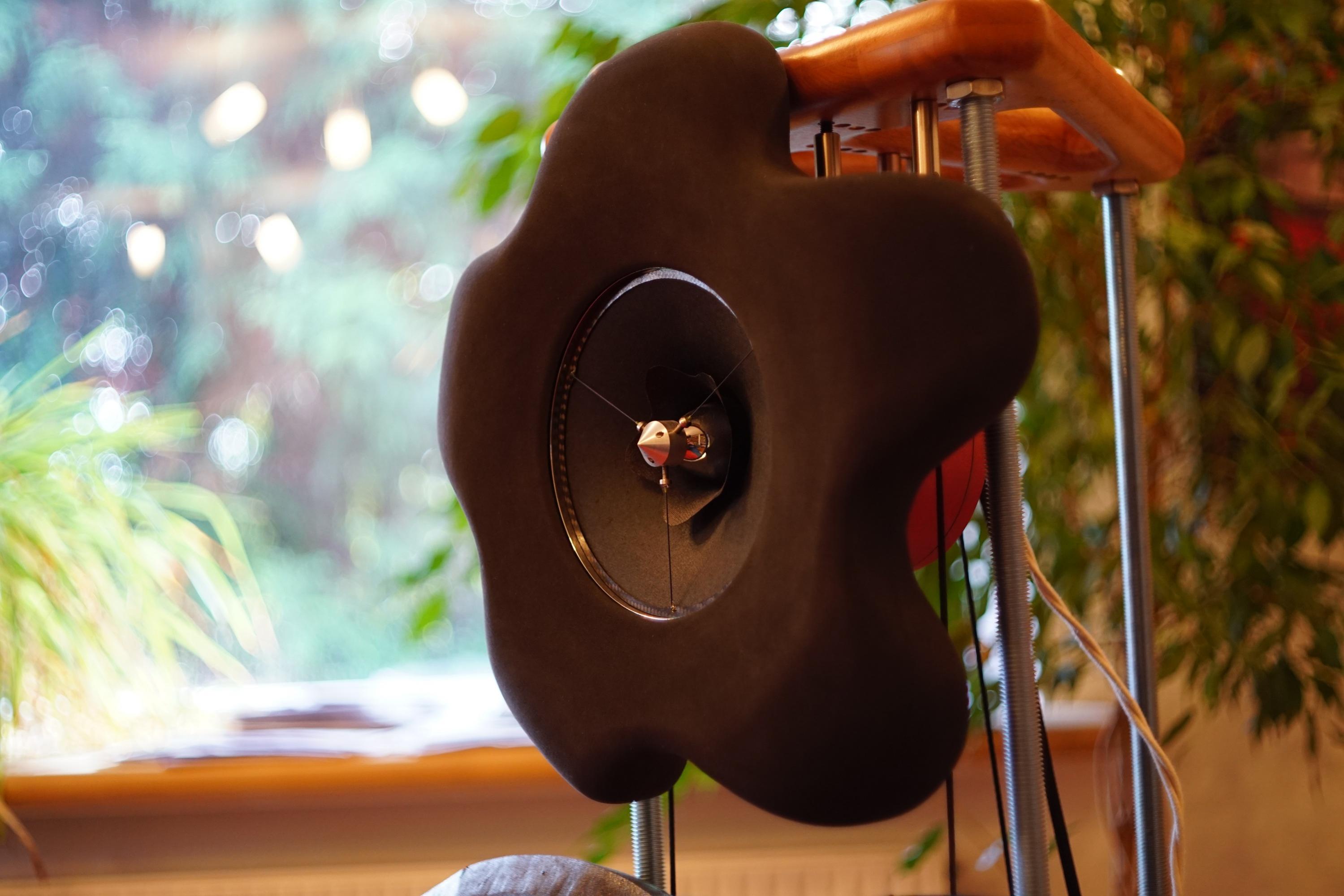

Dear all,
my latest attempt to control diffraction and dipole effects (which I just for myself classify as geometrical resonances) is a petal-shaped baffle with large differences in the return path and large, variable radii at any edges. This geometry rewarded me with a clearer and more relaxed representation than every prototype before, with better imaging, same driver and crossover.

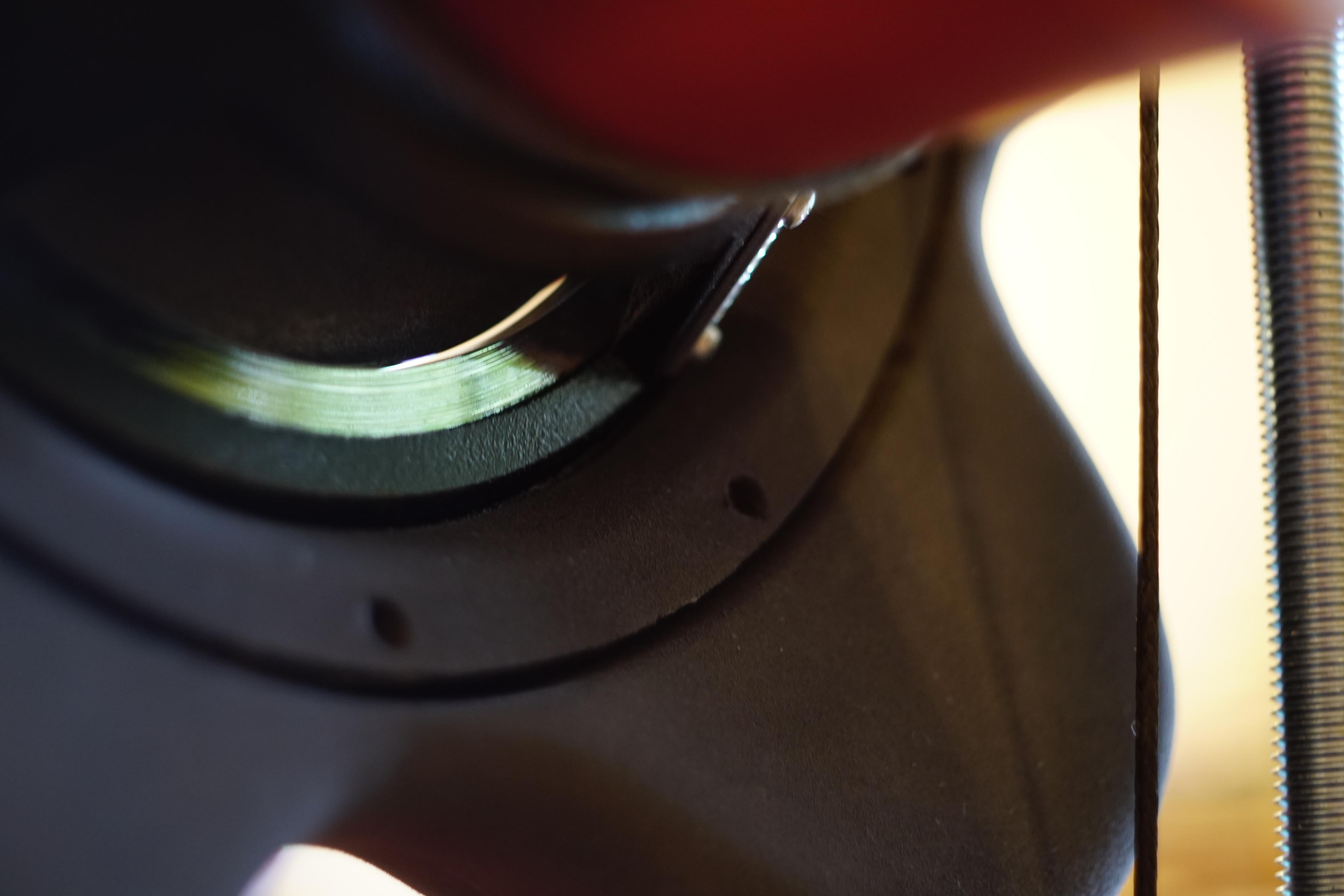

The only issue I´m not happy with is the small step between cone and baffle, but this is due to driver construction and can´t be avoided.
Some will argue that a spherical baffle is a bad approach, and in theory of course that´s right. With the petals however, I haven´t found any negative effects so far (sorry, no measurements yet, I´m not at home in the moment...), but found that I preferred the spherical baffle to rectangular and trapezoid shapes.
Some will argue that all this is meaningless in a dipole, due to the dipole null, but after several prototypes I´m of the opinion that diffraction control matters in dipoles as well.
All the best
Mattes

The "petals" baffle that you have constructed should (I think) have worse diffraction than a planar baffle of whatever shape. In a dipole system, where the front and rear waves meet there is strong cancellation. This is often at the baffle edge, the same place that the "cabinet edge" type of diffraction would occur. So for a dipole system with a planar baffle, most of the edge diffraction is eliminated as long as the edge is being illuminated by both front and rear waves (e.g. not if the driver is beaming strongly).
In your petal setup, there are edges that occur before the baffle edge. These come from the folding of the baffle into the petal shape. This happens on both the front and rear. So my guess is that this will have some "edge diffraction" more so than a planar baffle. Also, you are expanding space in front of the driver but at the same time constricting space behind the driver with the petals. This may also be influencing what is going on with the response.
Although it is certainly good that you feel it sounds better, the mind and perception can be very tricky. It would be great to have measurements on several angle to normal and a comparison to a square planar baffle of about the same dimensions. If that is possible to do and post here, I would very much like to take a look.
or perhaps he might have reduced diffraction but dipole cancellation suffers because its difficult/impossible to illuminate both sides of the petals equally
I fail to see why people believe that this happens like that. To me the huge cancellation at the edge would cause a large reflection and reradiation of same. This IS diffraction. So, to me, dipoles have far more edge diffraction than a closed box. It's just that at LFs this diffraction blends into the direct radiation to create the dipole radiation pattern, but higher up this diffraction is still an issue.
A driver at the center of a donut would have the least possible HF diffraction while still maintaining a LF dipole pattern. Kind of like a dipole waveguide.

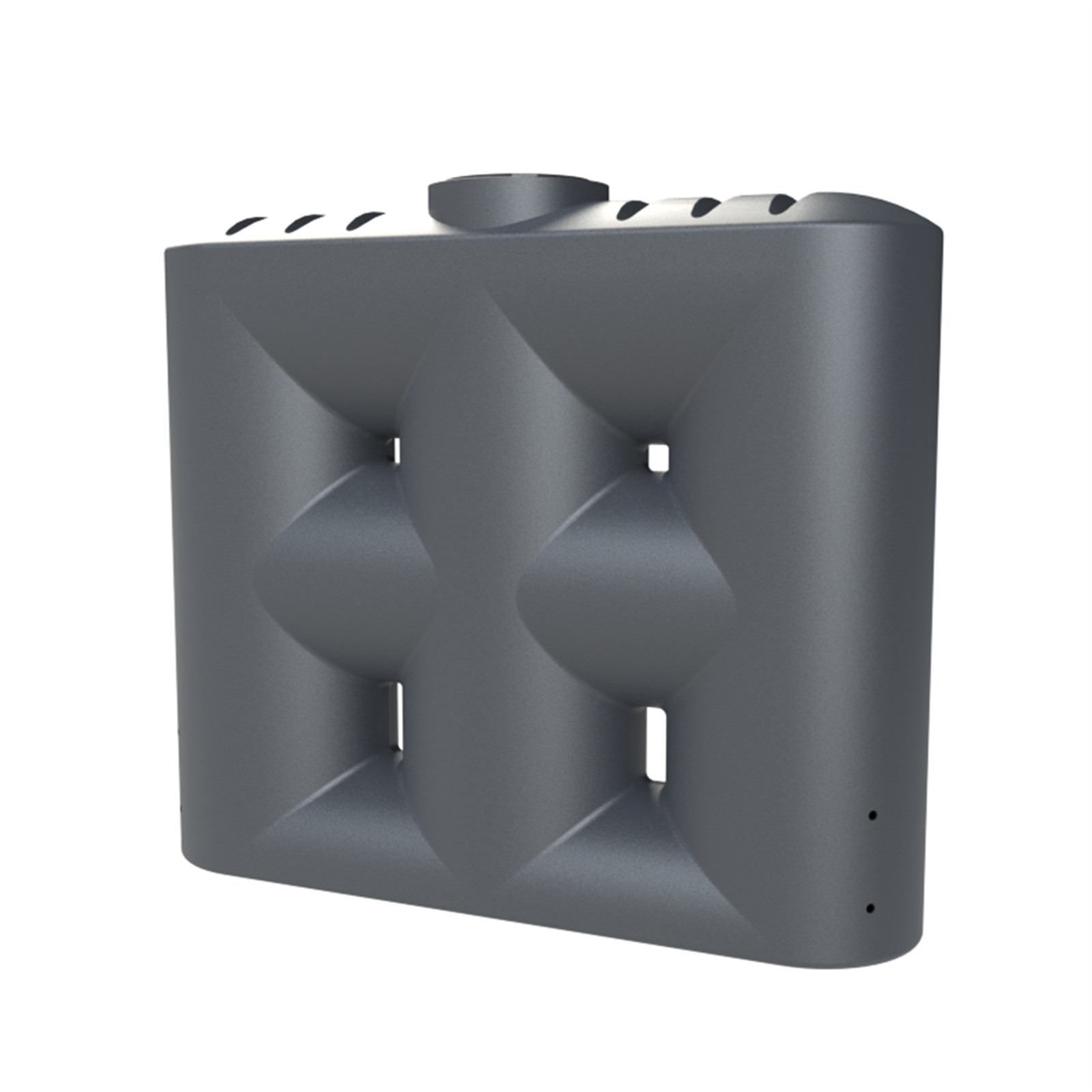

Some slimline water tanks have (pretty much) this shape.
If I wanted to build such an object, I'd cut and weld together a few used polyethylene food drums. They are cheap, robust, and would lend themselves to making this sort of shape.

Allen, could you elaborate on any positive effects a small gap or step might have? No offense, I´m just wondering...
The gap between cone and baffle is only a few tenth of a millimetre, so I´m more worried about the 5 mm step between cone and baffle, although it´s slightly rounded. But the step is inherent in the driver´s construction, there´s no way to change it.
