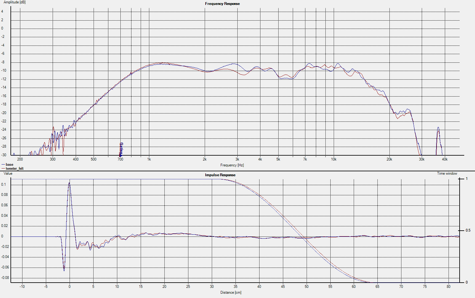

I find that felt on the baffle works quite well to lessen diffraction, but the aesthetics is... questionable. In my case I managed to reduce +/-2 dB variations to +/-1 dB. Sorry, no off-axis measurements.
