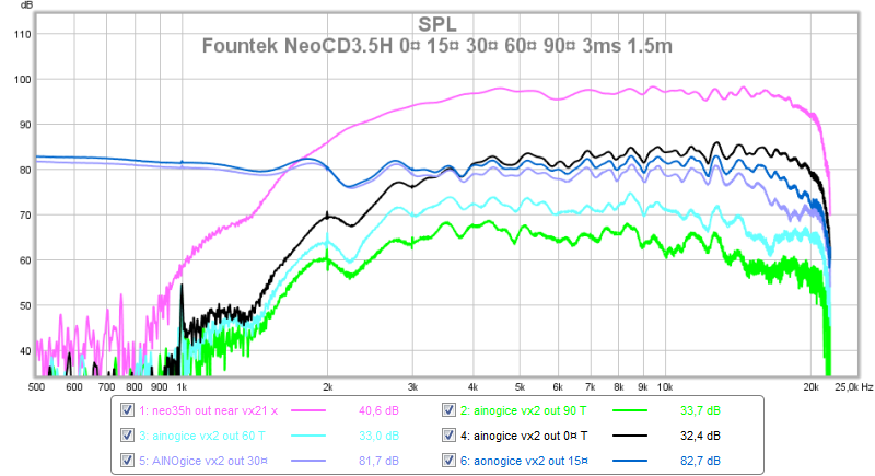

Shallow waveguides lay on a wider baffle, which alleviates diffractions. A synergy horn or similar wide and deep horn is more critical, but they can be highpassed above the problematic frequency.
I have measuend Fountek NeoCD 3.5H without a baffle and it works quite well too, up/down to certain F.
