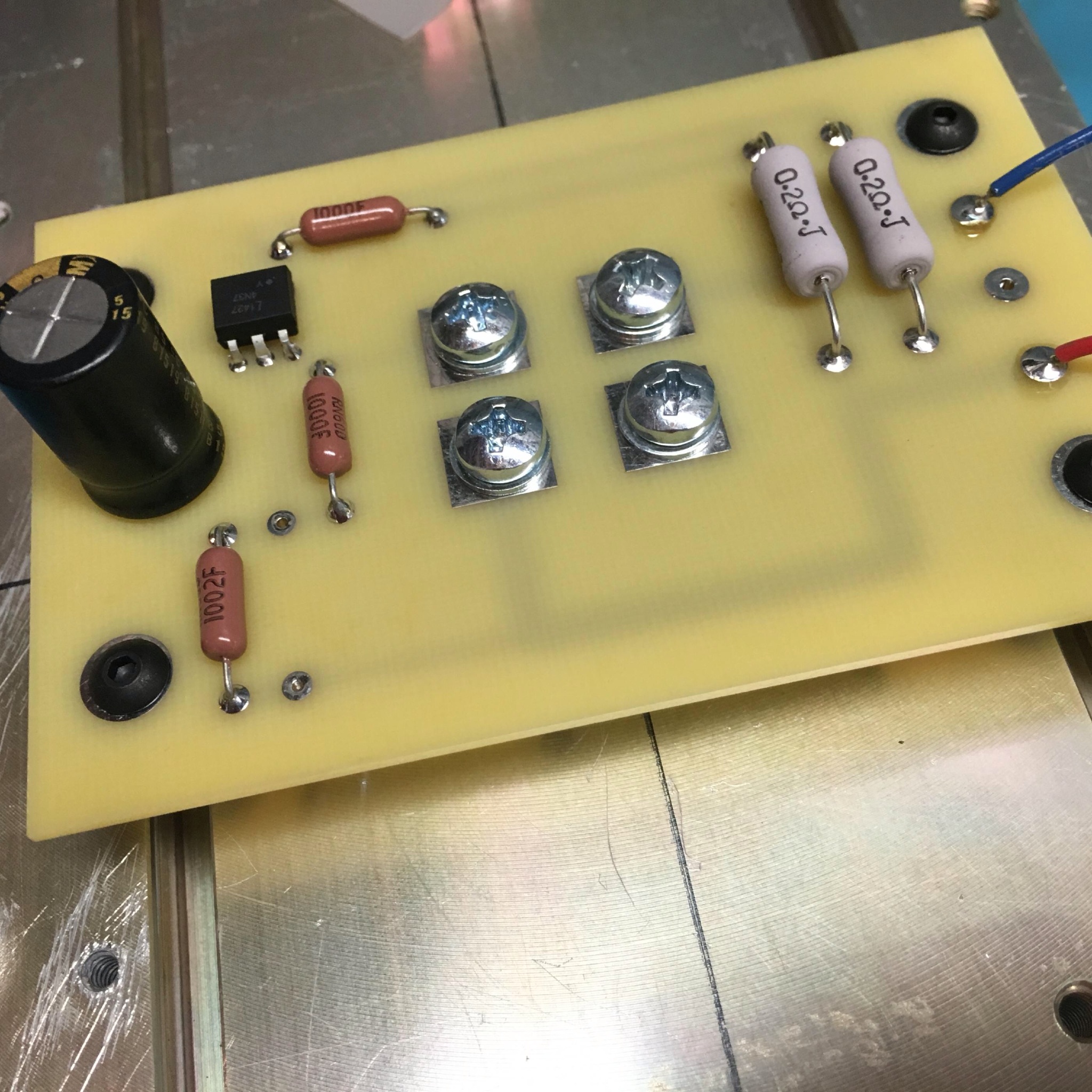

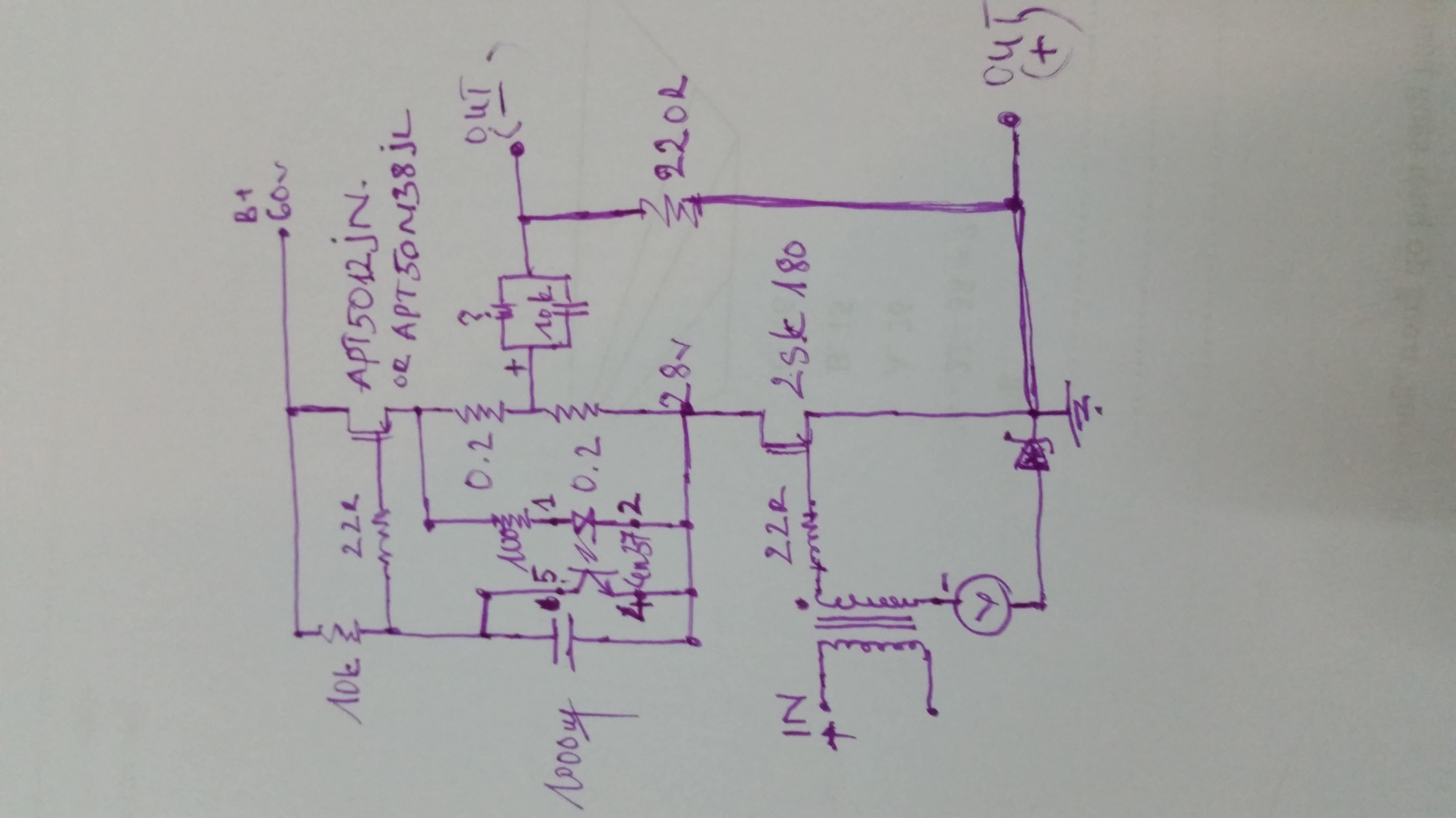

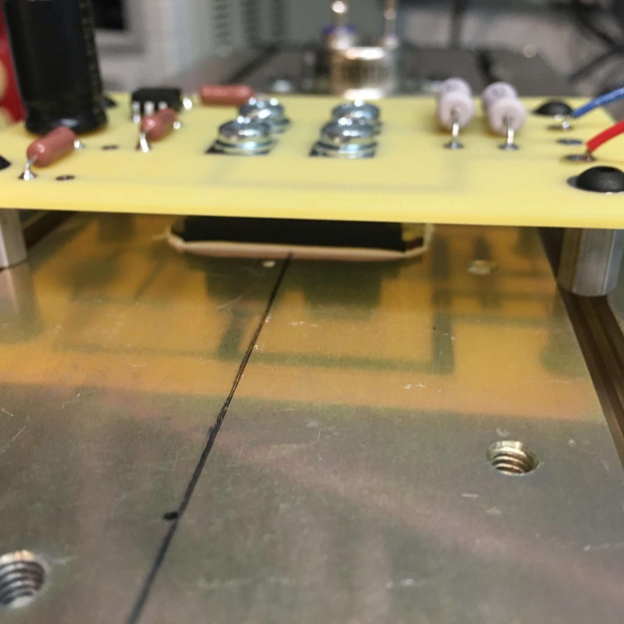

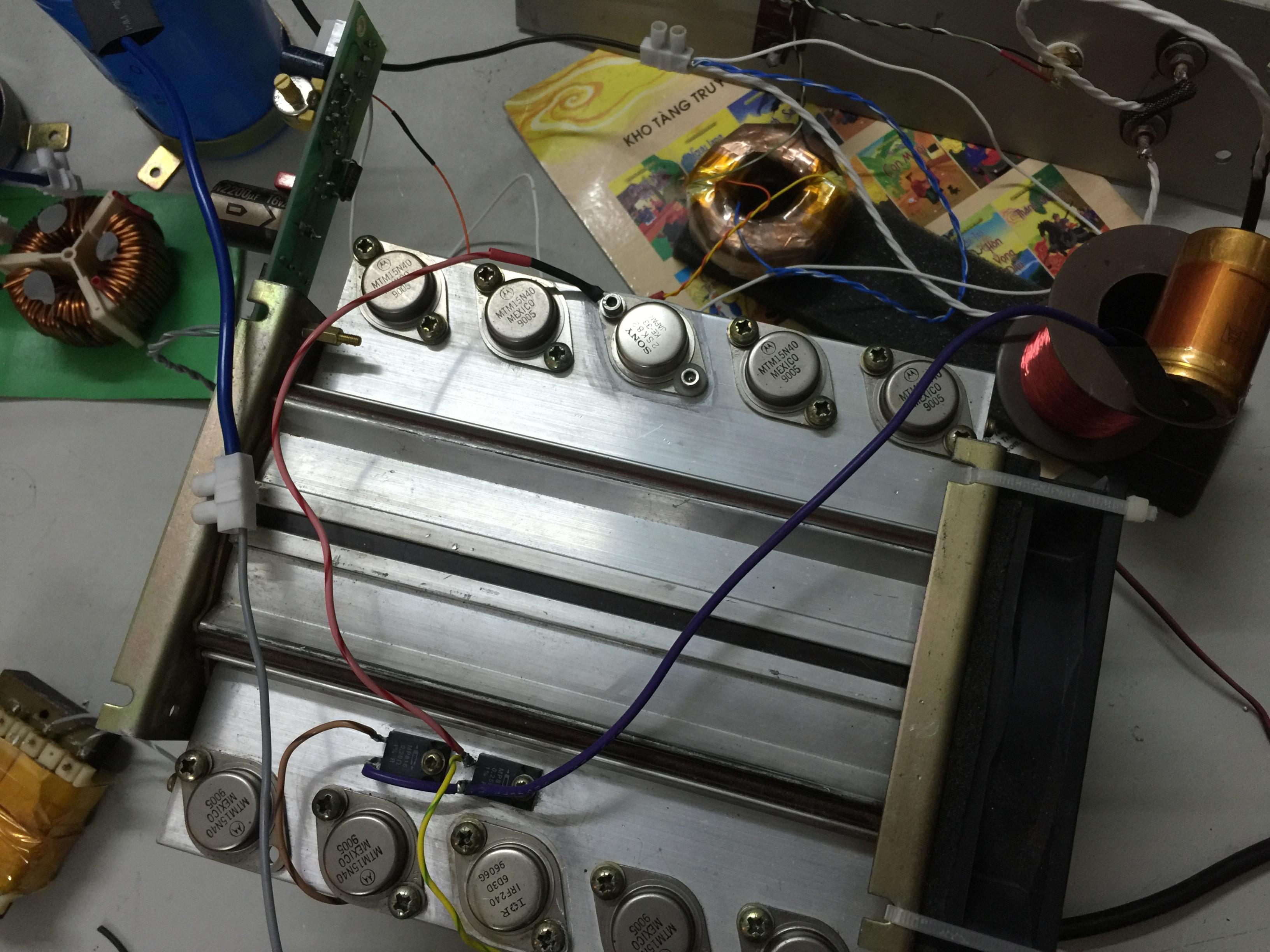

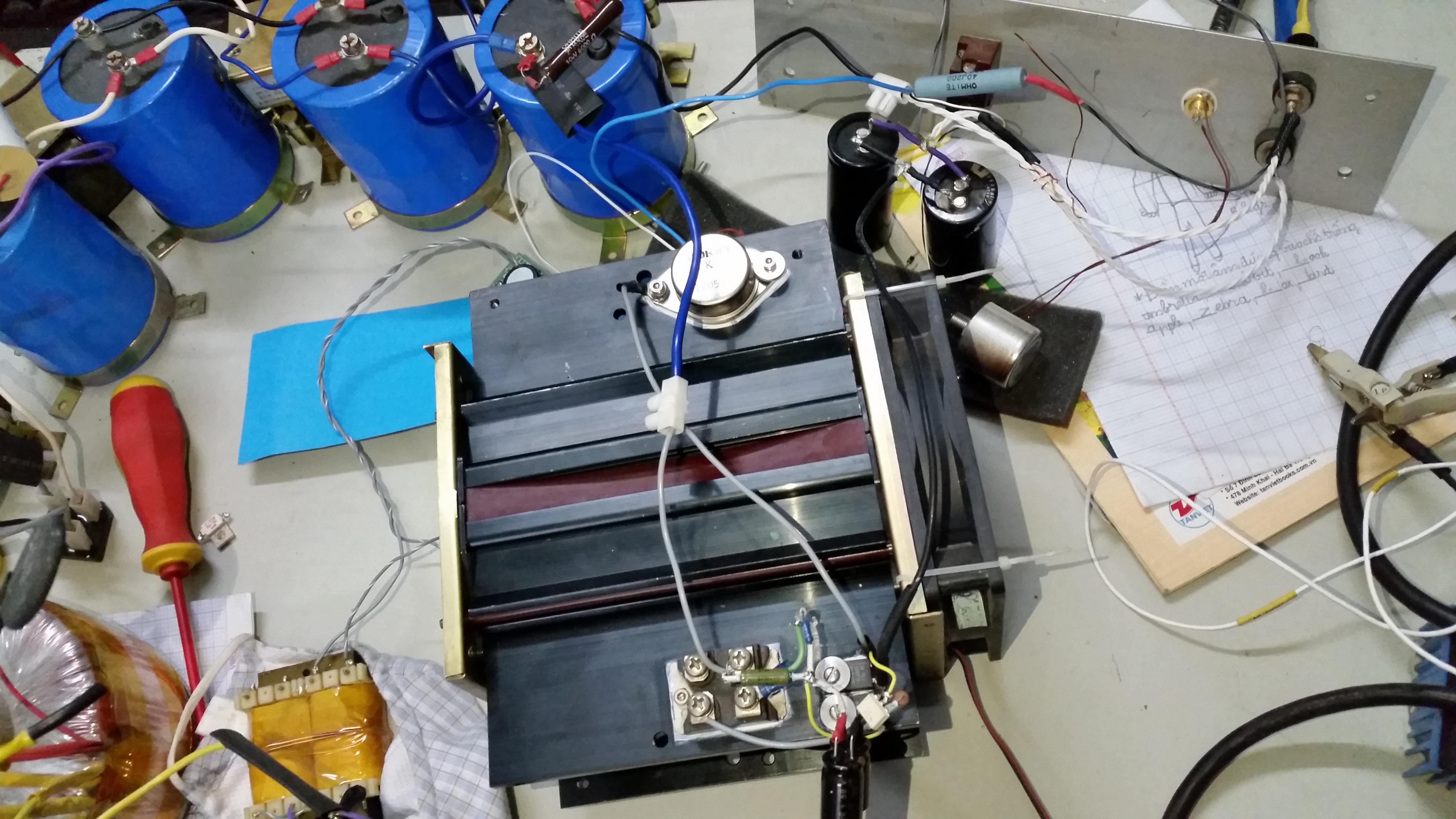

As far as I know, nobody came to an end! Different problems. At least with 3 A.
Smaller versions seem to be running.
Maybe Mr Rothacher Schade 50 ?
Non news about is finished because he is very busy with new house build.
On the photos show his exemplary diy circuits with hockey puck.
Papa say we need adequate impedance audio source to get amp work like expected.

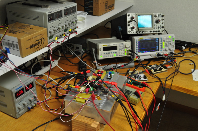

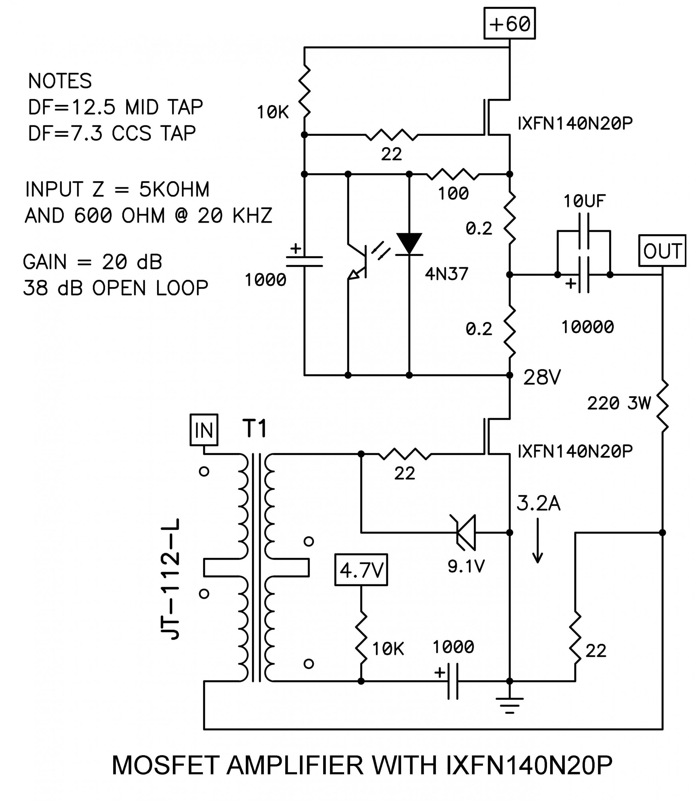

Different problems. At least with 3 A. Smaller versions seem to be running.

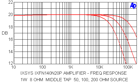

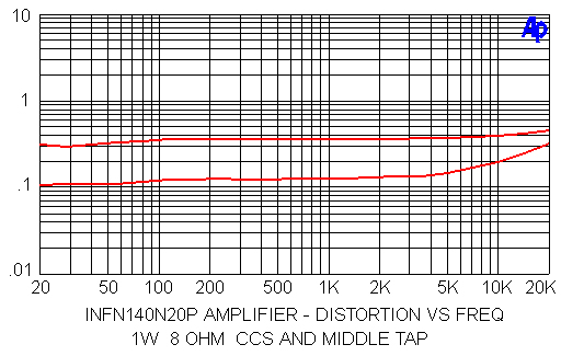

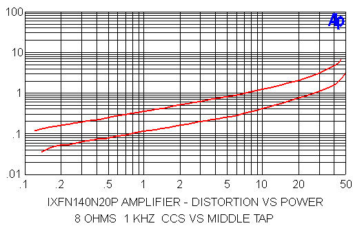

Odd. Here is the original schematic and some curves. Note that the CCS tap is
at the bottom of the 2 0.2 ohm resistors.
As stated before, this has to be driven by a fairly low impedance DC coupled
source, otherwise the transformer will react by motor-boating.
