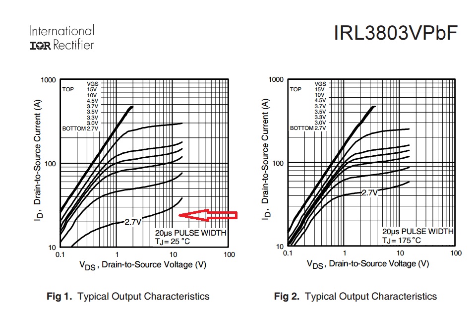

Here is the ohmic region of the IRL3803VPbF. It seems quite similar to a SIT or Triode.
Johannes

These are enhancement mode mosfets?
How do you know where to set the drain voltage and current for the circuit, based on the graphs that show the ohmic region?

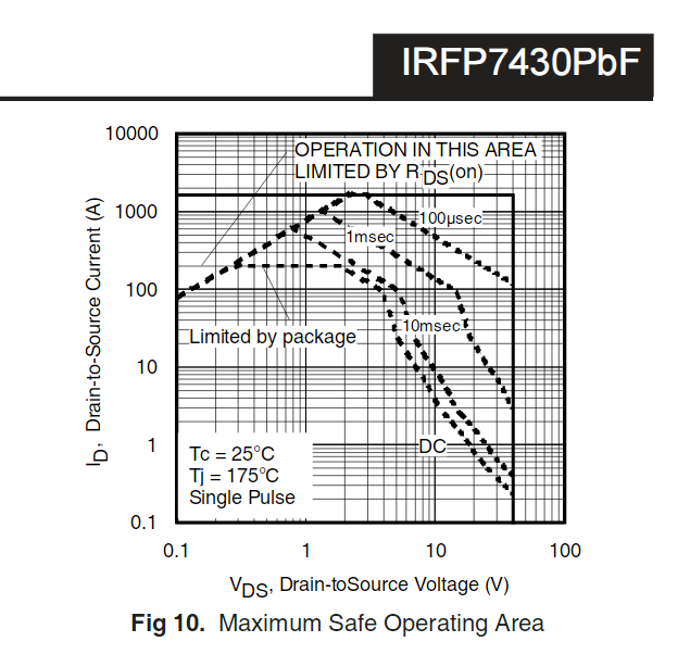

I think it is this graph Nelson Pass refers to.
I would guess that the area of safe operating area is applicable to a mosfet without any source-resistance. I have been running the IRFP7430 with 25 volts Vds and 2 ampere of current without any thermal instability. It is a 366 watt device with a linear derating factor of 2.4 w/C. At 100 degrees Celsius silicon temperature you still have 366 - 100 x 2.4 = 126 watt power capacity left.
These devices can be prone to thermal runaway if there is no or too little source resistance.
Johannes
Yes these devices are enhancement mode. They need 2.5 - 4.5 volts Volts between gate and source to work. You use them in the same way you would use an IRFP150 or IRL540.
They will sound quite different compared to normal Pentodish devices like IRFP240/150/044 etc.... You can tune the character of the device over a very wide area of Voltages and currents. You have to test it yourself in the amp you are building.
It is important to not exceed the maximum Voltage over the device.

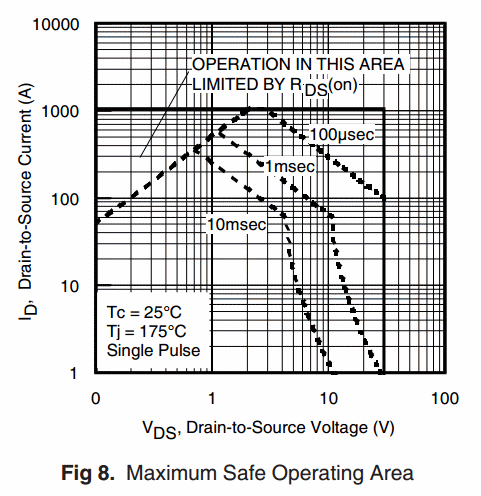

maximum safe DC operation
Looks like very conservative values for maximum safe DC operation.
For the smaller IRLB3813 things are so bad you would not think about using it for DC operation without cascoding
Yes.
My experience with these devices is that they are very rugged and tough.
I have run more then 3 ampere and 25 volts through an IRLB3813 for a few seconds.
I hade coupled a small piece of wire directly from the plus rail from the power supply to the drain of the bottom device. I discovered my mistake by the smell of the burnt silicon-pad. I have no idea if the mosfet would have survived for any longer. I cut the power immediately when I discovered my mistake.
The IRFP7430 was run with 25 volts and 2 ampere for many hours. It got to hot to touch, but still works perfect in the new amp.
I think that the safe operating area graph is about thermal runaway. They need some source-resistance for thermal stability when used outside the safe operating area.

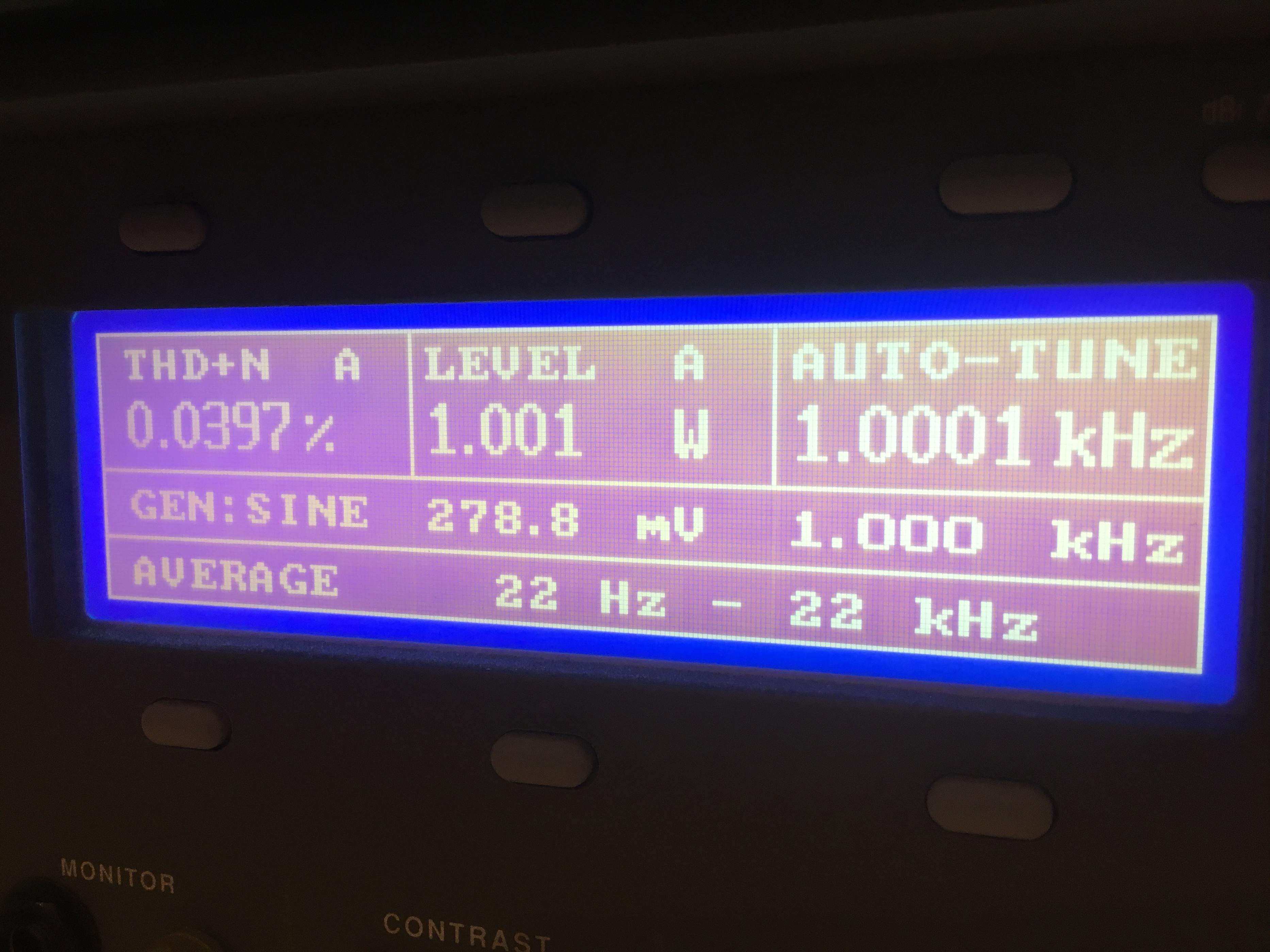

Getting things back up to speed here. I pulled this out of the mothballs today. That's Nelson's BAF 2015 Schade Amp, and yep, that's .04%! 🙂 I was trying out the mu follower tap. 🙂
I'll be working on getting these DIY-ready.
