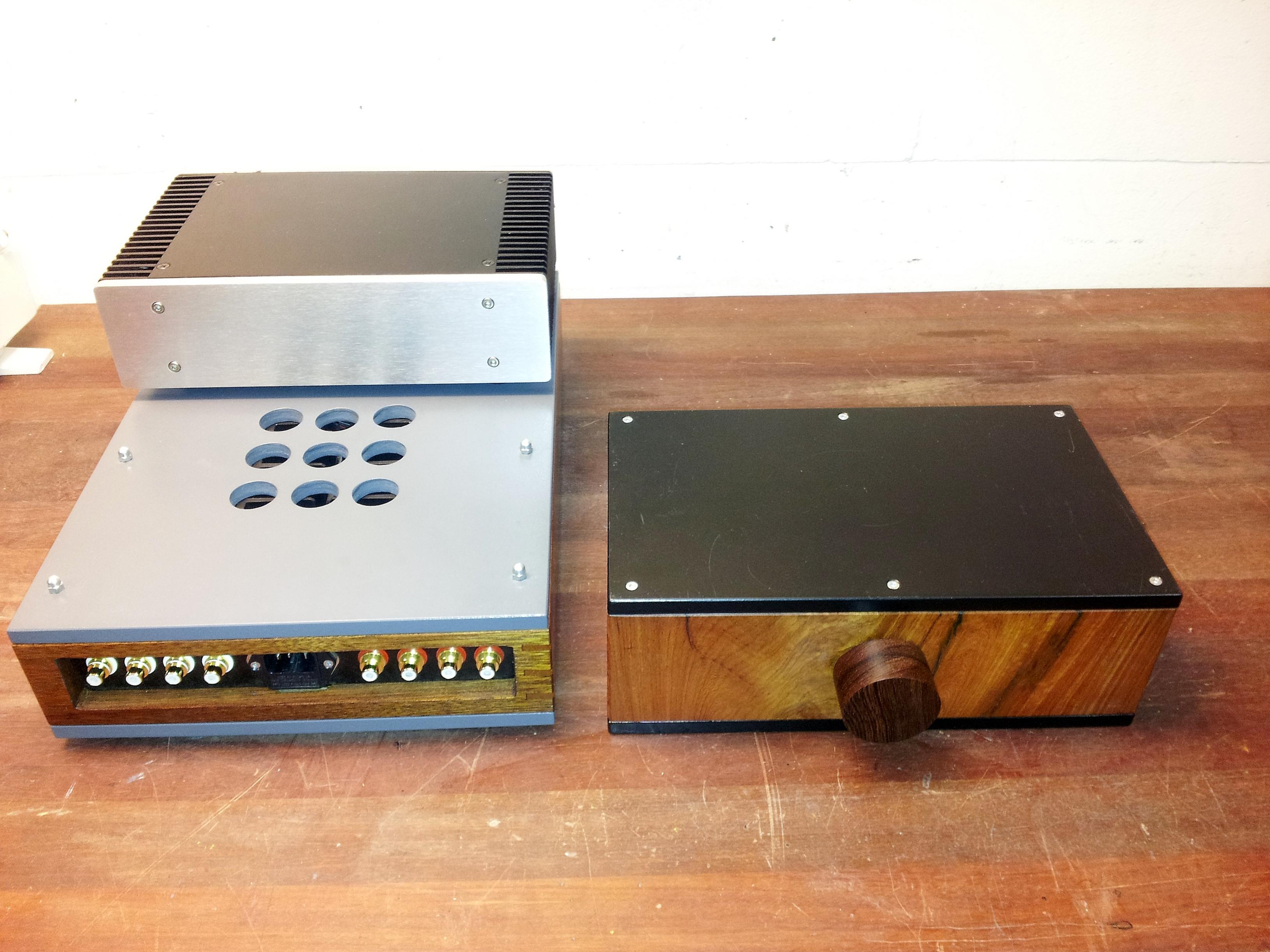

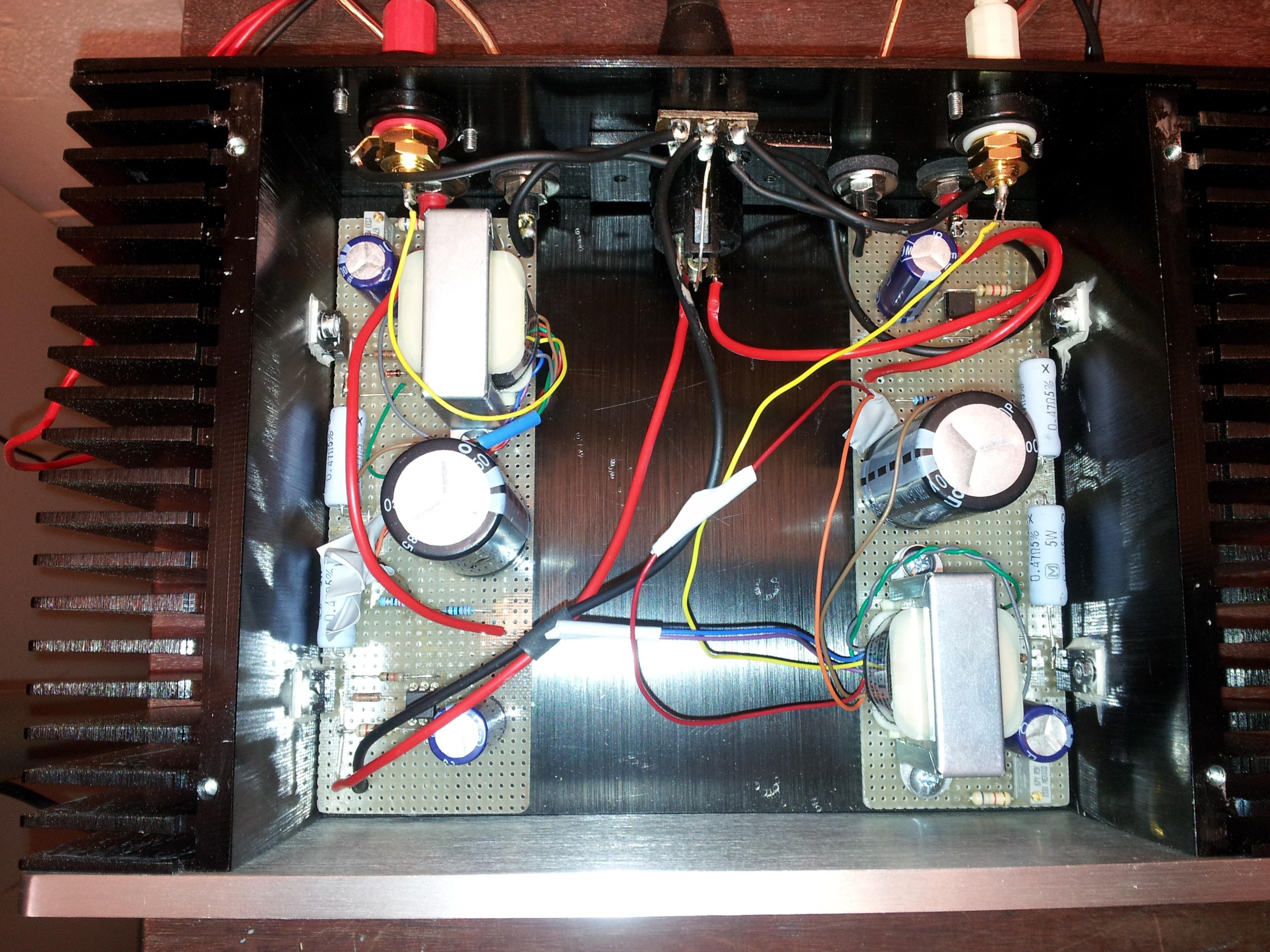

I have built 4 versions of low power Baf Schade amps.
All with B+ 19.3 V and CCS with 1.17A
Motor boating is a problem that needs to addressed and DC coupling worked fine in my case.
I appreciate this design a lot. Good gain and decent DF. Low noise floor and excellent sonic performance.
The mosfet IRLB 3813 has been my preferred device, both for my ears and in LT-Spice where harmonics are up to 15db lower than with other mosfets.
This amp requires a low impedance source to shine. I am perfectly happy with LuminAria driving it.
Building on the gained experience i would do the following if i were to go for the 50W version.
1) not worry about the CCS. I have full faith in this current limiter that will protect the lower mosfet from too much current
2) Use a SMPS to keep the costs down. The CCS shall keep the noise from the supply down
3) Use a thermistor in the bias chain for the lower mosfet. Otherwise it may be difficult to reach and to keep the voltage at the drain of the lower mosfet at a set value.
A change of the ambient temperature of 10 degrees (winter summer) may totally upset the situation.
Enclosed are pictures of the small BAF Schade 5W amp in company of LuminAria and a Transformer Volume control.

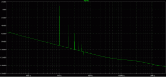

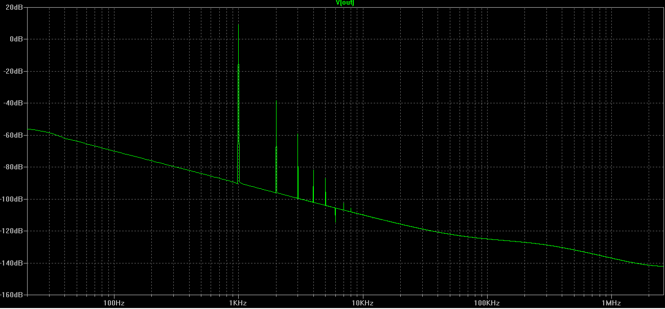

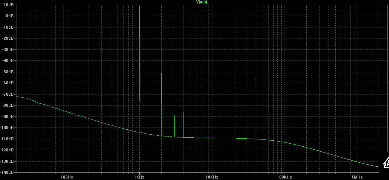

The spectral analysis shows about .3%, which is about the same as the
curve w/ ccs I showed above.
In any case, don't get too excited about spice distortion results - the lower
level models are too simple to capture the subtleties and the data sheets
are designed around the needs of switchers, not linear operation.
Thank you Nelson for the wise words. LT-Spice is a nice toy but as far from the truth as the result of the interaction of imperfect models.
Unfortunately my distortion measurements are not reliable enough. I wonder whether the IRLB3813 is really that much better than the IRFP7430? Can anybody confirm?
