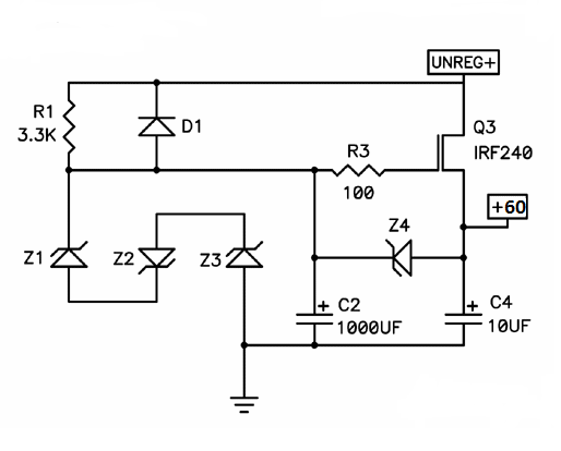

The current for the circuit shown is 3.2 amps, so I don't quite know what
you mean by "current runaway at 2.8 A".

Thank you Mr Pass for the many hints. I think I did not express correct the "2.8A problem"
I gathered the words of members.....
"Member Jama post 551
The main problem was one CCS that could works to this current and dissipate a lot of power. I have tried some devices, first, IXFN140N20P, but I did not worked for me (broken one mosfet and one THF51
Ci11
Member Ci11* Post 558
1. Power draw is not as expected. I started with +60V, limited to 4A. I measured +26V at the gate of the output device. However, once the output device warmed up, the voltage draw dropped from +60V to about +32V, and the current draw kept trying to push beyond the set limit of 4A. The temperature of the output device was about 160°F. So I increased the current limit to 4.5A, and the result was that it was all quickly "absorbed", with the voltage staying around +32V, current draw at 4.5A, and the temperature of the output device rising to 190°F or so. At this point, I stopped.

I'm thinking of using something like this on the supply. Any other suggestions welcome.
besides still needing hefty C4 , why that ?
that's sort of CCS up there , pretty well buffering PSU ripple
of course , reg is welcome if you 're in a middle of winter season

My understanding, at least on the optocoupler current source setup, is you have approximately 1.2V across the led (with some fine adjustment) which leads to 1.2V drop across the 2 x 0.2 Ohm resistors (0.4 Ohms) around 3A (ie 3.2A).
If it is wired up correctly it should be rock solid stable.
The only imaginable problem I can possibly see is the bottom mosfet which is set up manually, (highly sensitive to temperature, and very high transconductance), so will need ongoing adjustment till everything reaches thermal equilibrium to get the appropriate voltage at output as shown on schematic.

Ignore the cap values at output.
I was sure Nelson said somewhere you needed a supply with around 10mV ripple, can't remember exact figure but it was very low.
I can do CRC 512,000uF but I don't think that gets me down to what Nelson suggested at 3.2A.
I don't want to do CLC cause I'm a dumb bastard.
