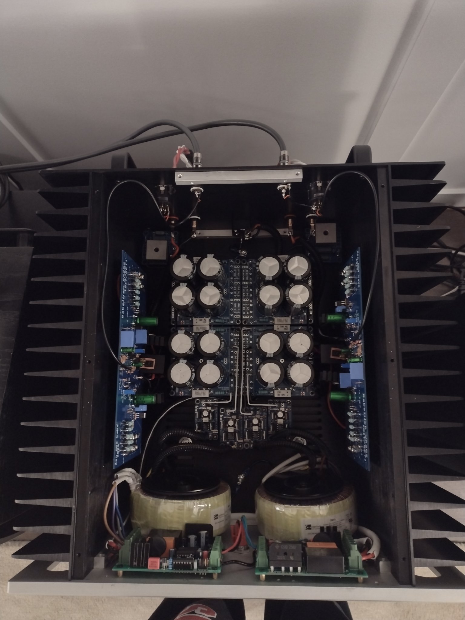

Well it makes music. Iq set at 180mv? Is that right, or 200mv? Sounds amazing, even the wife commented. No idea on temps yet. Running the SET version. Slight hum from toroids, but no noise through the speakers. 30 volt secondaries ended up being 42 volts(damn active bridges) under load at the boards. Played for about 3 hours and nothing popped yet.
it will, if you leave that small box (preamp?) on top

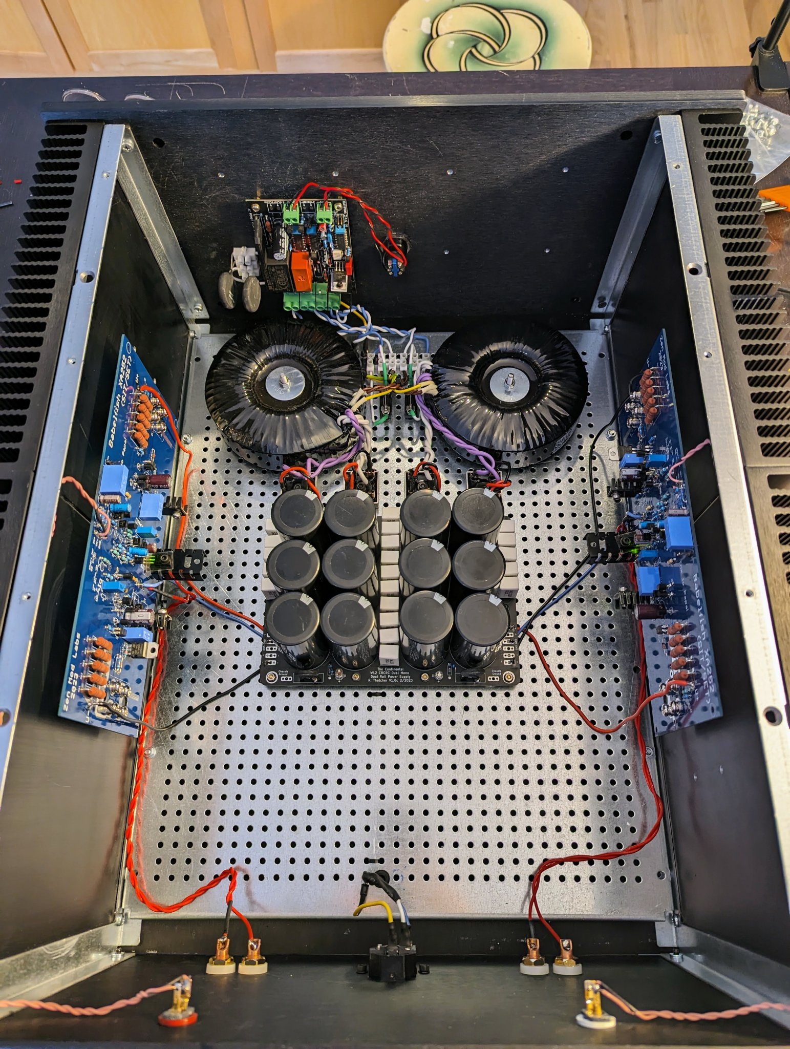

Here it is. Still planning to add speaker protection. It warms up the chassis quite nicely 🙂
About 11 gauge.at least 4mmsq
dunno Gauge
