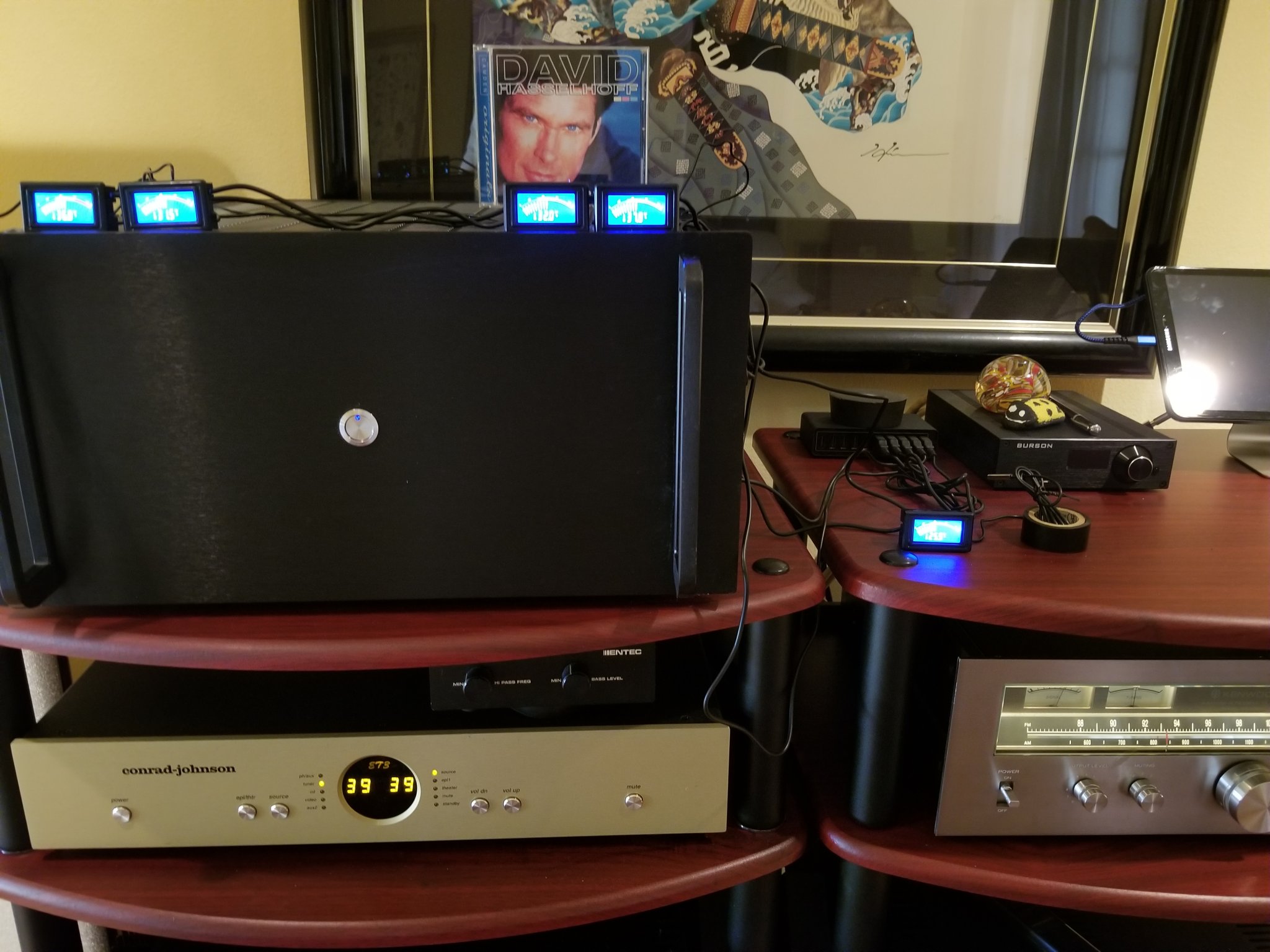

(2) The first iteration, post smoke, was to enhance the cooling of the amp. i ordered custom top/bottom plates from @Gianluca with LOTS of ventilation, RH added big heatsinks to the internals ( see pictures in a previous post) and then I measured it with five thermometers. The 5U 400 is indeed capable of keeping a stereo 252 SIT at working temp. If you add a Babysitter then you drop the temps to well under 50C! So, that's quite doable.

Take a bow man.... you deserve it... here's a beauty shot... prior to the 2nd smoke... when I was testing it for thermal stability. I'm not quite sure I had the babysitter in place yet.
