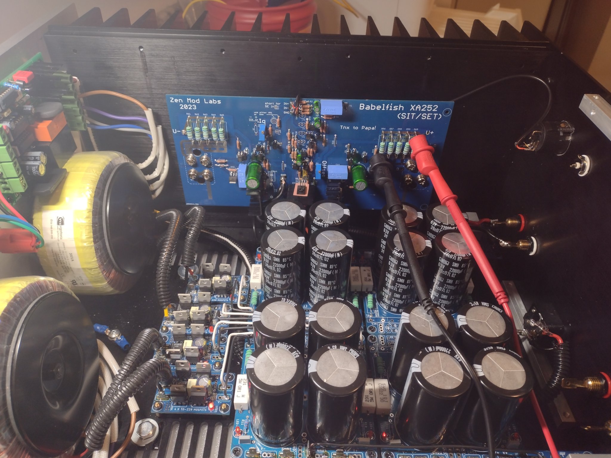

Update.
I hooked up my scope, a big dummy load resistor, 2 DMM's to watch input and output Vac, and then a signal generator. My goal was to slowly ramp up to clipping. I stepped up input 0V1 at a time. I got it up to somewhere between 35-40W and the protection kicked in. I never saw clipping. No smoke. Turn off the amp to rest a few moments, turn it back on. Repeat. Same. Switch channels. Same tests, same results. It appears the XA252 updated with the 8V2 zeners is working as designed - fantastic!

I powered up one channel, +-42 volts is present at +-U. My dc offset can be adjusted to 0, but no matter how many turns of P2 I can only get to 50 mv. I cant get less than 50 or more than 50. I tested at RT and it reads 1.5k ohms and doesnt change on each board. I have Bourns 3296W-1-501LF pots so they should only be 25 turns. Any ideas what I am missing here, at least there wasnt any smoke. Pucks dont seem to be getting warm either.
Let me go over part of this board, going over every resistor and just noticed I put in a 120ohm resister instead of a 120kohm one at R**.
