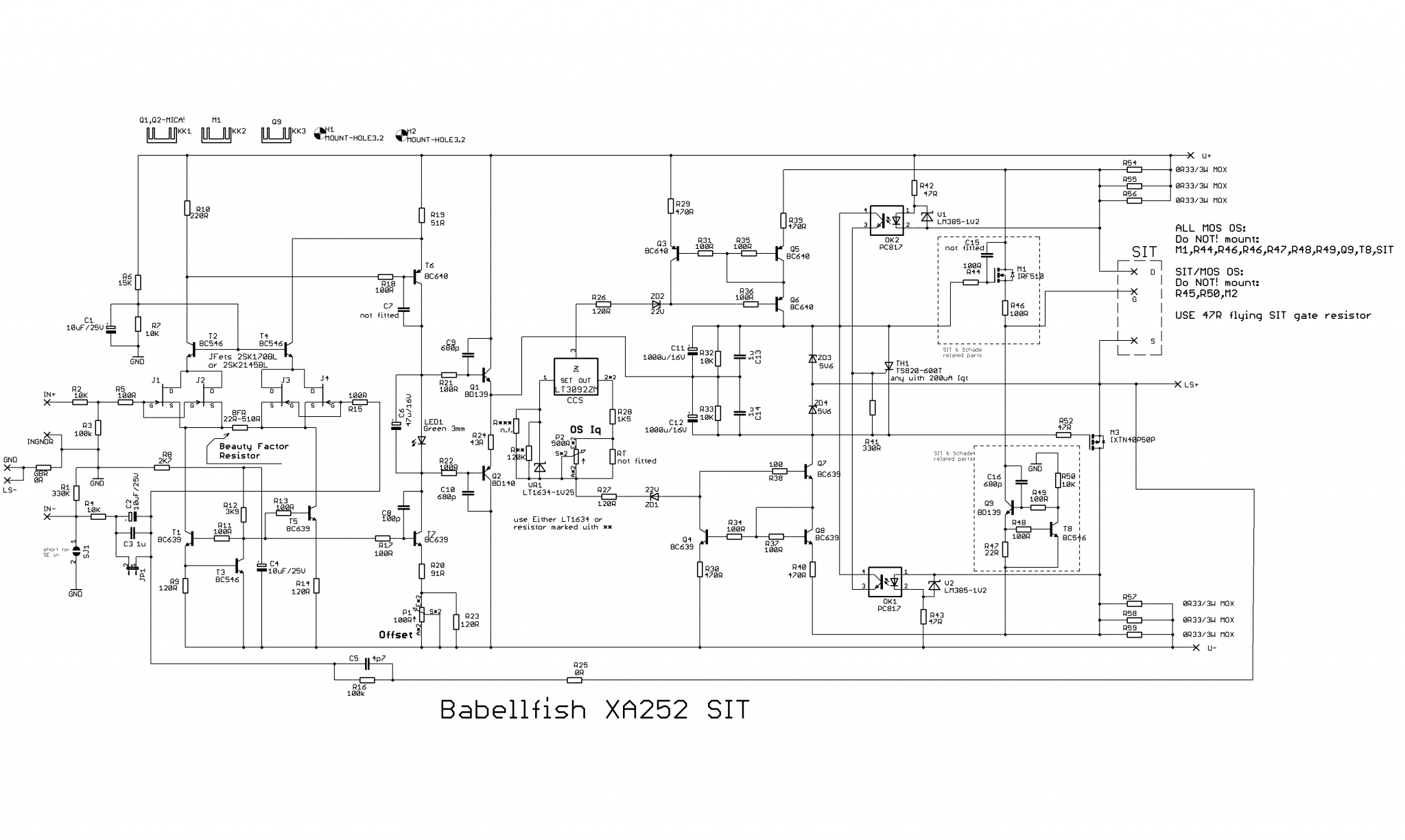

So, we go back to the SIT... why did it smoke? I mean, I really didn't have them so loud... 90db is rather efficient to begin with.

as it seems, culprit is in 5V6 (ZD2-ZD3) zeners
as I said few times - I invested some serious time to devise small caps arrangement (anti-oscillation measures) to ensure compatibility with all 3 iterations and there is no chance of amp being unstable
was banging my head in recent time trying to determine scenario of SIT iteration misbehaving, when I know through what I put my own (serious clipping, overcurrent protection engaging) and 'nuttin bad
conclusion - with border-line SIT Ugs values, upper 5V6 zener (ZD2) is evidently going in conduction, establishing current path though C12, so Q1 going Berserk, and then inevitably smoking R24 and at least well heated Q2

Your analysis of the damage sure makes sense... it is the damage we saw.
Looking at the schematic... is that ZD3 instead of ZD2? The 5V6 zeners are ZD3 and ZD4.
ZD2 is marked as 22V and just below Q3.

Is 9v too much? I have these in my parts bin but can also just order 8v2 with next batch
use 8V2 or 9V1, no biggie
BTW, this is the schematic I have...
yes, ZD3 and ZD4 in your case

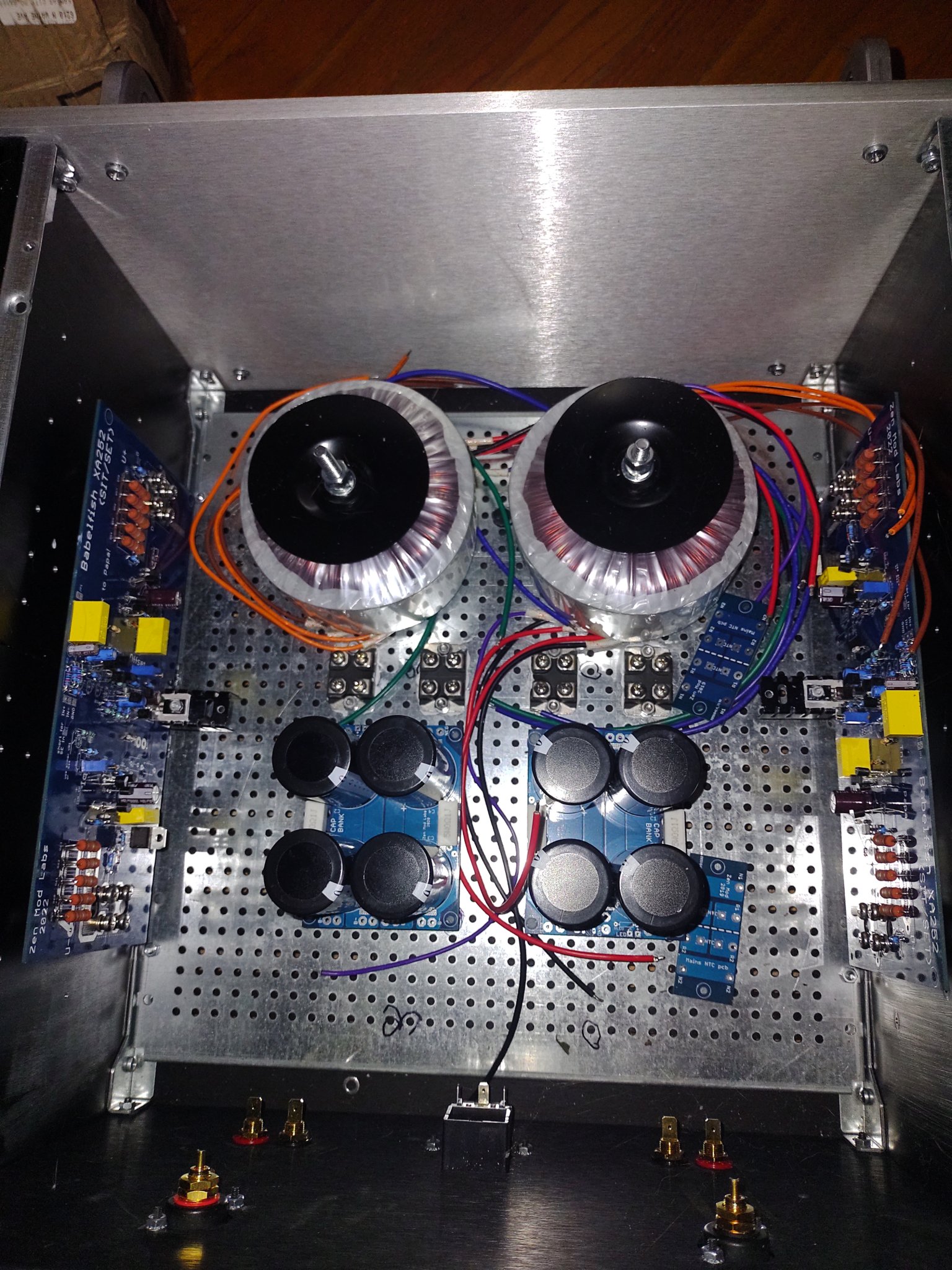

Beginning to wire power supply and have a few questions. First, I planned on using the zenmod approved method of running wires from transformers underneath the slotted shelf thing.
The wires are not long enough to make it to switch/fuse fixture. This is deluxe 5U box and ac/fuse thing is what comes with the completion kit, shurter by looks.
Is 16 gauge milspec wire, silver plate multi strand with Teflon insulation sufficient for "transformer" extensions? I've never heard of special transformer lead wire but didn't know if special stuff needed. I've shortened some transformer leads, but made the connections with pieces of what I cut off. That will not serve here obviously!

Another thing just hit me. Previous dual mono were mono blocks, so each had there own IEC/fuse fixture and power cord. My F5 was dual mono,
but I carried the through including two power cords. Not so this time, just one IEC fixture. I suppose I just double up on the hookups to the IEC/fuse fixture?
when going dual mono (in one case, logically) - IEC and mains switch are common, then everything else is separate, especially important to mention separate mains fuse(s) for each Donut

if regs in your neck of wood are calling for one fuse per circuit, go with that
if regs in your neck of wood are calling for fuse per leg ( so fuse in phase and fuse in Neutral) go with that
of course, no one prevents you of going overkill, installing separate IEC and switch for each channel

same logic as you (ideally) have one fuse per circuit in your house
I mean - it is ever hardly ideal in our houses, especially if built in Yore and with fishy regulatory or application of same, but when building your own amp, no reason to cheat
in short - fuse will (hopefully) do prescribed duty only if dimensioned properly
if you dimension fuse to live through power-up sequence of 2 parallel Donuts, even with obligatory soft start circuit, how you can expect it to have appropriate value to react in case of trouble with just one Donut?
it's hardly to expect having trouble with both Donuts in same time
