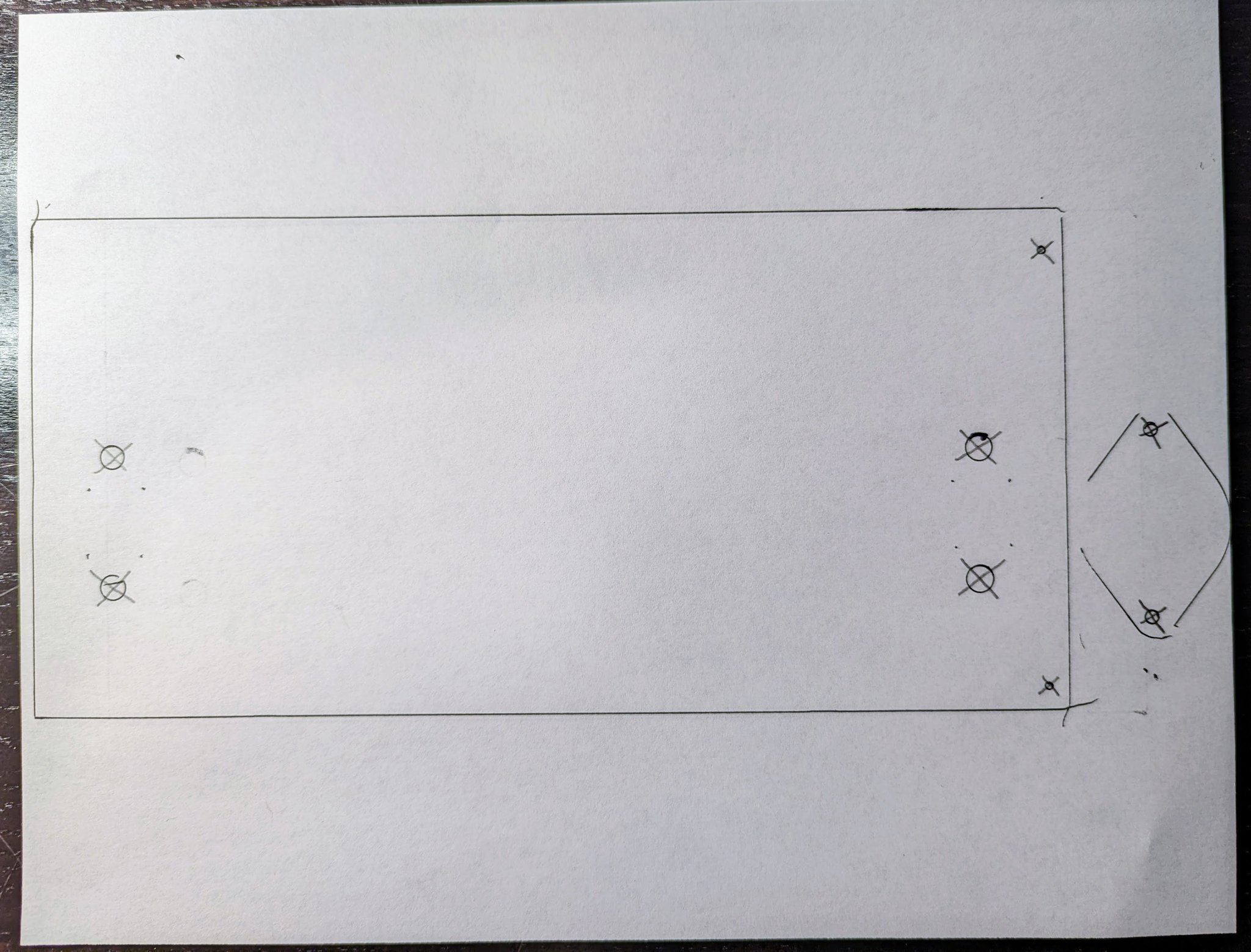

"Novice hour" ... Just about to begin stuffing boards for a SET version and thought I would start by tracing the boards and holes for future mounting on the heatsinks. To accommodate both the SET and SIT versions, would the indicated holes/taps be sufficient?

good
important pcb measurements are in post #2
for both pucks mounted, no need for pcb mounting holes
for SIT at right side, two pcb mounting holes are needed
edit: post #1386 having even more measurement details

Soren,
Looks like you got the right array of holes for both cases, as ZM confirmed.
Here's my method... put painter's tape / masking tape on the heatsinks. Put the unstuffed PCB where you will want it. Take a pen or marker and mark the hole locations using the PCB as your template. Once marked, have a look again to confirm the board didn't shift around while marking the various holes. In this case you'll be doing it with the MOSFETs mounted... You get the idea though.
If you're happy with the markings, then hit the marks with a punch. Confirm again. Then drill & tap. Repeat for SIT. This is a long way of saying that a paper template step is not necessary.

That's what I do, except I add an extra step. I tape the PCB down so that it does not shift while I mark the hole locations. It is extremely important to punch the drill locations accurately. Check, double check, even triple check. PCB mounting holes usually do not have much slop so slightly offset holes may cause standoffs to not align with the PCB holes. I know from experience.😢
Another thing I try for is to align holes between heatsink fins, if possible. I try to avoid blind holes and broken taps.
