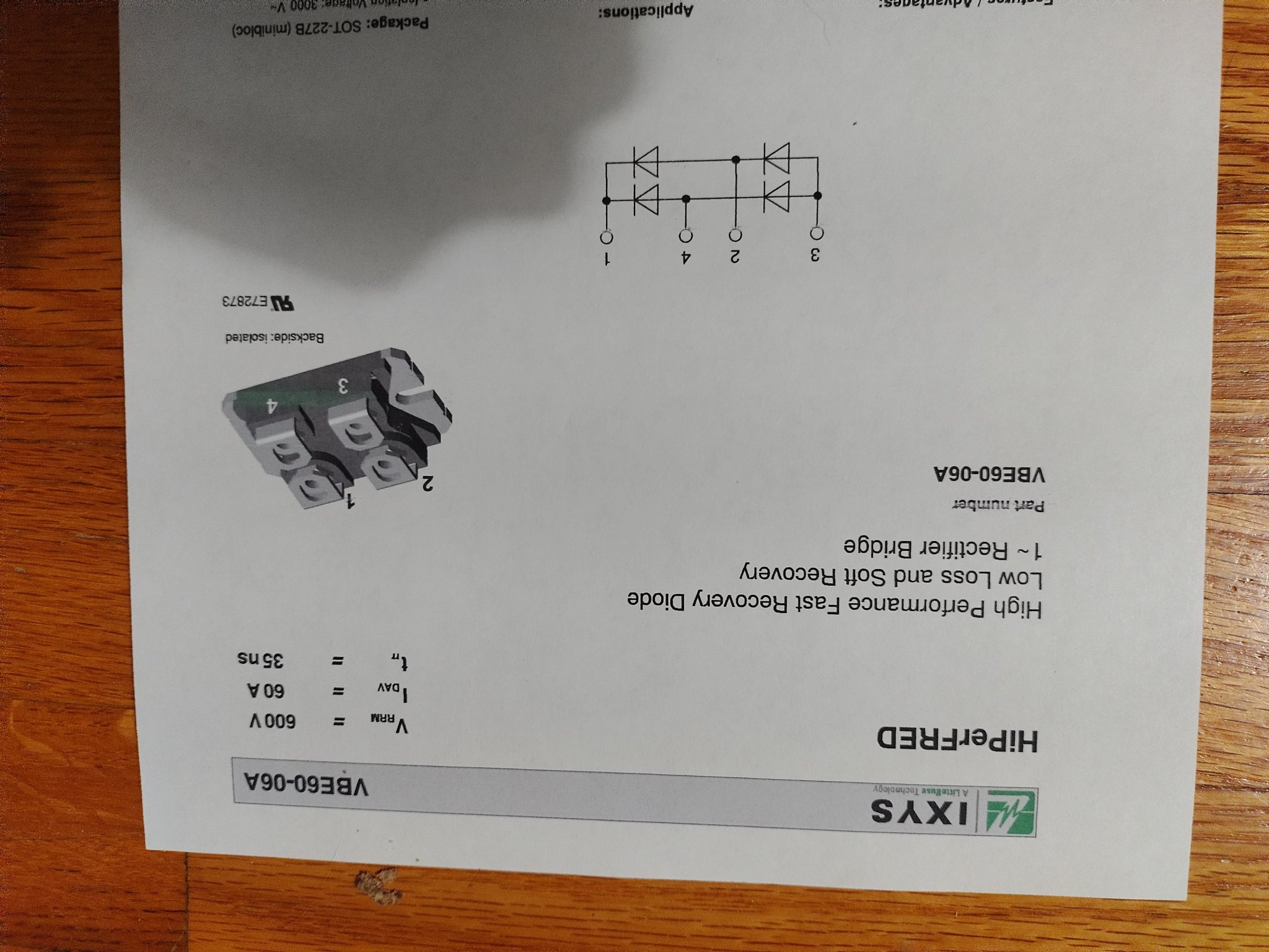

You are correct, it is Antek transformer. I just wanted to make sure my assignment of bridge connections 1,2,3 and 4 were the same as the 1,2,3 and 4 of the data sheet locations on actual device.Looks fine to me... but, as always... particularly with me... extra set of eyes besides mine is good. Also... depending on the toroid you're using... it's unlikely that it will be the red and black going to the rectifiers... maybe the green and blue?? Juuuuuuuust in case.... anyway. The secondaries. Not the primaries... of an Antek is where I'm going with that. 🙂

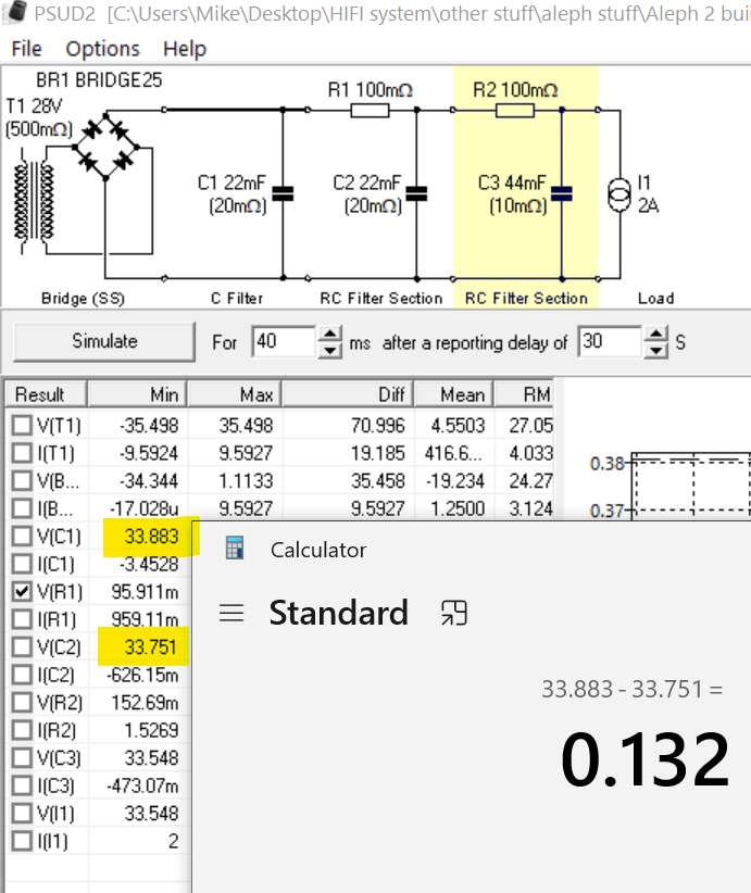

I started the simulation on PSUD. I will play with some values tonight and see what I get. I am still pretty fresh with PSUD but at least it is a simple program. Looking at Randy's Aleph BOM's, they call for a single 5w resistor of .22 and .33 per rail serving a Aleph 2 monoblock. So lots of current. From the sounds of it, these should do alright. I will check the simulation regardless.

Thanks for confirmation, when I start flipping and "converting" diagrams, mistakes abound.1. +
2. AC
3. -
4. AC
Back to wiring.

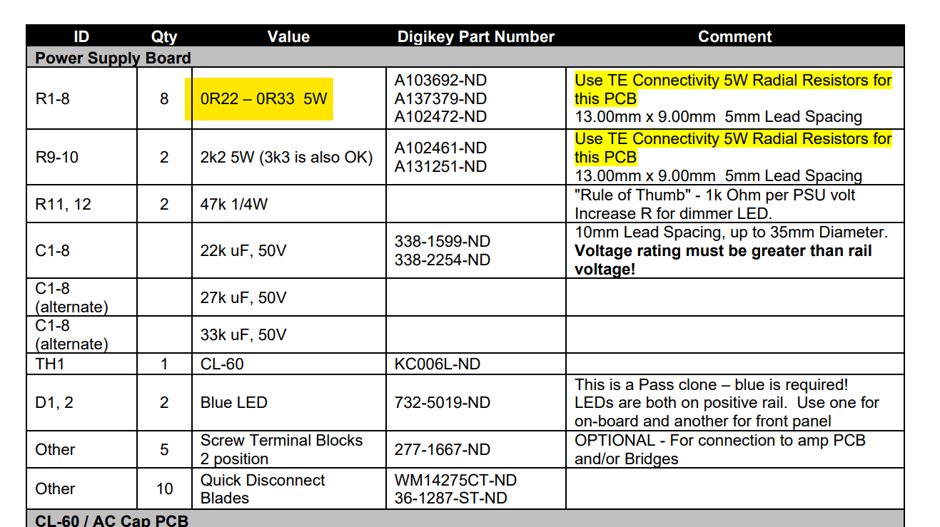

Best to be sure we're looking at the same thing. Attached is the guide I have for the 2s.Looking at Randy's Aleph BOM's, they call for a single 5w resistor of .22 and .33 per rail serving a Aleph 2 monoblock. So lots of current. From the sounds of it, these should do alright. I will check the simulation regardless.

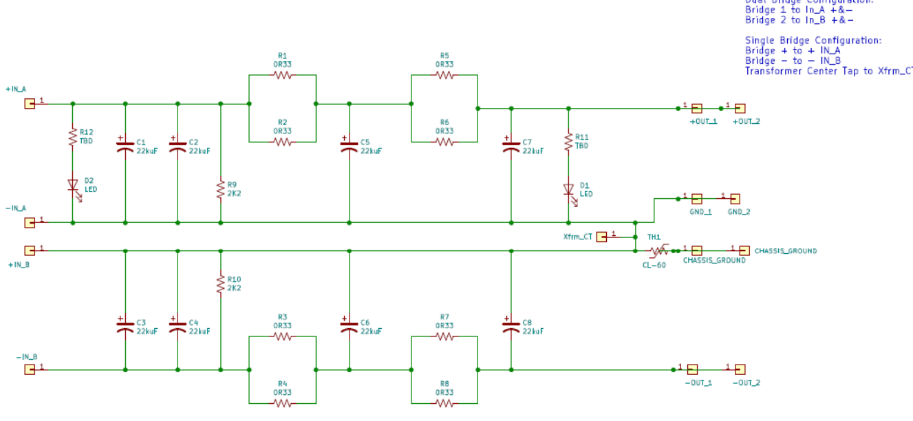

Page 18 is the schematic for Randy's V8. The filter resistors are the parallel pairs. R1-8. R9 and R10 are the bleeder resistors. That's also how the PCB is designed. I can't say for certain re: Randy's other PCBs.

Cool. 😎 I had just noticed in your drawing that you had labeled the AC wiring connected to the rectifiers as red and black. That's the primary side of an Antek 😉 Unless you do your own wiring, the side you will connect to the rectifiers will be blue and green.You are correct, it is Antek transformer.
Okay, since we are talking about Aleph 2 stuff, it is important that I say the word "Inductor". Now that is out of the way, Highlighted on the top left "0R22-0R33" is the filter resistor for the A2. I really like these big radial resistors less parts to solder, order etc. the resistors on the A2's I built were quite comfortable doing their job.

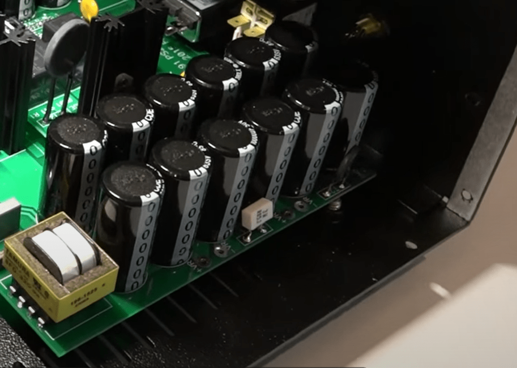

Here is a screenshot from a video on youtube where Wayne talks about their amps. This is the medium sized chassis I believe. So XA100 = lots of current. You can see, CCCRCCC with that resistor being the filter resistor. Now these are X amps so filtering isn't as critical so I made mine have two stages of filtering. I had to look hard to find out what part the resistor was as I like the idea of it being so raised. Also, you can figure it is going to be a reliable part because Pass's amps last until the end time due to great part selection and their terrific engineering (as we know 🙂 )

Yes, I was copying a diagram and carried colors over, was only concerned if I had labeled 1-4 on the bridge correctly! All my amps except one use anteks.Not sure which PSU schematic, but that would be odd (to me).

Emphasis added is mine - maybe we're saying the same thing... but different ways...Looking at Randy's Aleph BOM's, they call for a single 5w resistor of .22 and .33 per rail serving a Aleph 2 monoblock.
Maybe I should start over. What I'm trying to say is that if you don't use the inductors, that it may be nice to put in pads to have two resistors in parallel instead of just one.
The way I would phrase is that there are 4 per rail. See below.

That is the BoM for one PSU, yes. Agreed. Now, look at the schematic on Page 18.
Note in the schematic that R1 is in parallel with R2. R3 is in parallel with R4. R5 is in parallel with R6. R7 is in parallel with R8. 4 pairs of paralleled 5W rated resistors per PSU. So... you get the rough equivalent of a 10W resistor for each pair. Why... b/c it would be very likely that if one were to put a single 5W resistor of equal value to the two in parallel that it would get very, very warm.

Okay, so using some simple ohms law, let's assume 2 amps going through a single rail. With a resistor value of 0.1ohms. I am seeing .4 watts, .2v drop in that extreme situation. Looking at PSUD, my thoughts are sorta verified. Going from C1 to C2 shows a voltage drop of 0.132v accross the resistor. So (0.132/0.200) 0.4 =0.66 x 0.4 watts = 0.264 watts. Now I am not the best at math so I wouldn't be surprised if I am doing something wrong but it looks to me like a 3-watt resistor can handle around 10x as much power as needed. Of course, dissipating 3 watts would make it really hot. So a 5w resistor in my situation should be able to handle quite of current especially since we are dealing with one channel.
I suppose another thing to keep in mind is the aleph 2 makes a lot of current and the parallel resistors are dissapating for both sides... So I kind of have the equivalant of the two resistors in parallel. In other words, the A2 has 8x5w resistors and my power supply has 8x 5w resistors 😀
With that being said, now the "why not" factor is kicking in... Sign. Let me know if you think I am driving into a ditch or if I am on course.

I absolutely don't/didn't think you are/were driving into a ditch. IMO, it's a kick a$$ design / idea. If you're considering using those boards for other things....
P (power dissipated) = I^2 (current) × R (resistance)
Why did I underline and bold that part? B/C I still don't know if you're running dual mono (if you mentioned, apologies) and/or if you're considering using those boards for anything else that may be a power thirsty monster. The dissipation rises at the square of the current. Example... if you wanted to use it for let's say... an amp at Iq of 2A5 per channel, and it's not dual mono....
So... I like adding a set of pads... even if they're never used. It's surprising (to me) how quickly the temp rises with the load, and it makes your already cool idea a bit more versatile, IMO.

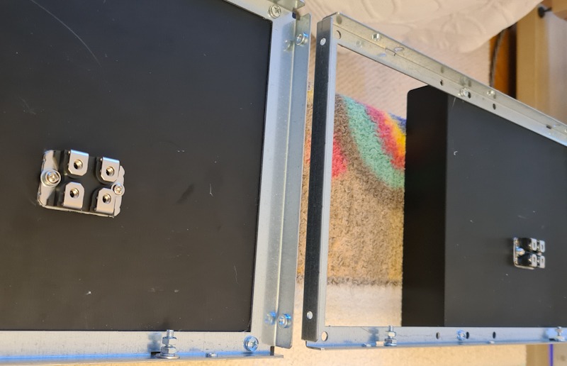

some progress: pucks are mounted.
To avoid making a mess with the goop, after dry-mounting the pucks, I covered their outlines with self-adhesive tape so that the squeezed-out residue can be easily removed. And shortly afterwards I also invented the wheel

what's wrong with goop around, it's perfect to attract wandering dust particles .........
edit - you didn't forgot split washers?

No, there are split washers 👍
