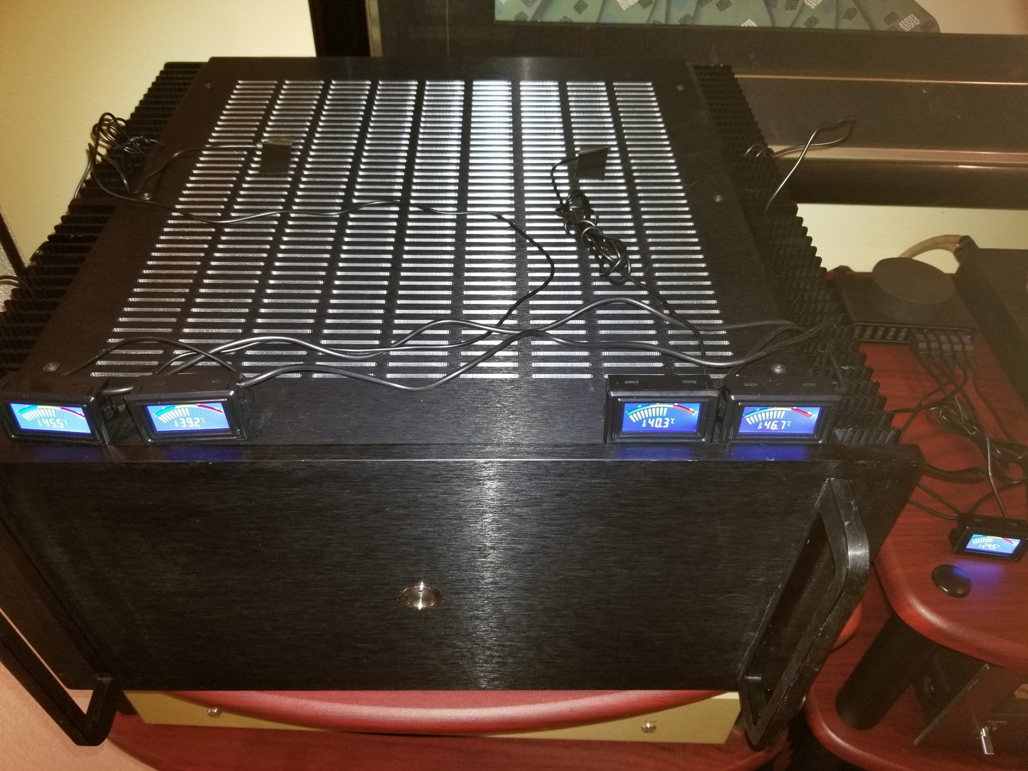

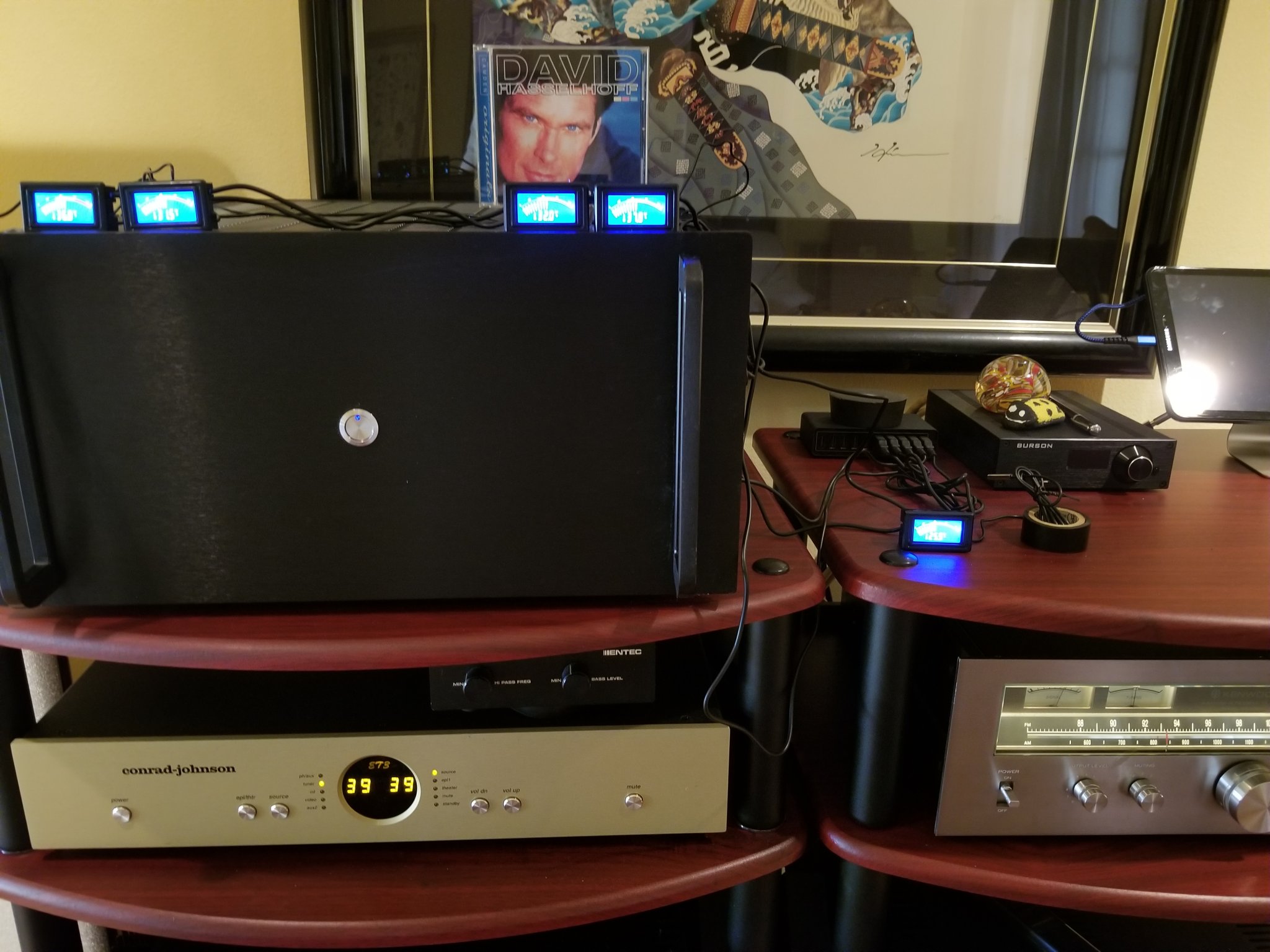

Good News... the Mucho Mas Macho XA252 has been putting some awesome music.... new super ventilated Mk II version with bigger device heat sinks and a color changing power supply (*)
Here's a snapshot.... I will post heat measurements as I go along...
As it now stands, it looks like the heatsinks are settled at around 48C.

Initial tests, out in the open show a >5C variation from no fan to full dual fan at high speed. That's very little fluctuation. As I need to learn this fellow fast, I will wait before I risk putting it in one of the lower shelves.
