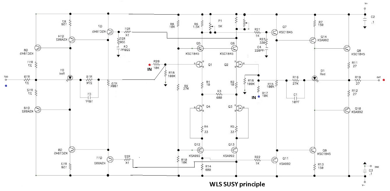

I guess I can correct myself and use your description, the [Input stage]. For me, the input stage is a buffer, buffering the incoming signal in case it is low, but if it is also a gain stage, I can call it a gain stage, no worries. Only preamplifiers need gain stage in my mind, but I am wrong, I can change.
When I look at the XA252 MOS schematic, there is a +IN and a -IN, but it is only BAL in and then converted to SE internally.
Meaning, I would need the XA252 US which is BAL internally also.
Looking at WAYNE'S BURNING AMP 2018 LINESTAGE, I see some similarity's in UGS and XA252 input stage and the offering in diya store is a balanced version, so you need two PCB's for stereo.
Am I correct ?
Am I correct ?
Wayne's - yes, but most likely some important work needed to make it functional as SUSY
arranging it as two separate SE stages , each conditioning one input phase, is simple bridging, not true differential state of affairs
Right.. well, I have UGS 4-6 sch, and Wayne's look like a sibling of the PASS UGS6, so could "easily" be modified to SuSy. The main difference between Wayne's and official PASS is same sex JFet (N-chn) and PASS use complimentary. The main difference between UGS5 and UGS6 is that UGS5 uses one degeneration resistor while UGS6 and Wayne is using degeneration for each JFet. But other than this, they are all very similar.
If I redesign Wayne's burning amp line stage into a SuSy and throw in some Schade feedback, I would end up with something unique which started its life in the diya community and would probably be fine...
well, if you ever start doing it, instead of contemplating, you'll find thing little more complicated
as I personally didn't tried it, I can't tell how SUSY arranged Wayne's LS is going to be stable , regarding output offset ( both differential and absolute)
so, that's first task for you - take one stereo board and make SUSY of it, test stability , offsets and oscillation
This can be interesting. I will explore it after looking into Wayne's linestage a bit more. Thank you for enduring 🙂

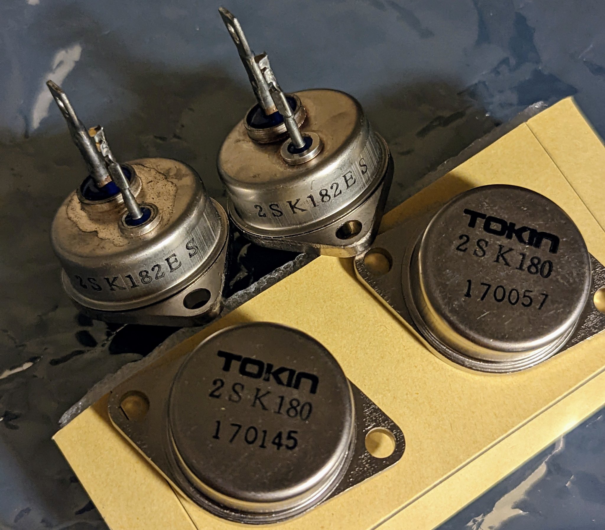

I happen to have these lying around now, jealous seeing their THF-51S brothers get favored in the Sissy.
Are there any advantages to using a THF-51S vs a 2SK180 & 182ES pairing in the XA252? Or could I use these two up in such a build for the same performance?
