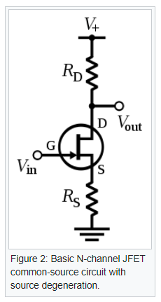

Sure, I can give it a try.
The basic structure of the gain stage is A differential Common Source amplifier.
"When drain current (Id) flows through the channel and source, there is a voltage generated across the source degeneration resistor (Rs). This voltage raises the source potential by Id*Rs, so for a given gate voltage Vg, the resistance causes a decrease in Vgs since Vgs=Vg-Vs. Since Id for a given Vgs will be larger for a FET with higher transconductance (𝑔𝑠gs), the degeneration will also be higher, source degeneration can be very useful in making amplifiers less susceptible to variations in 𝑔𝑠gs."

Back to the "where exactly is degeneration not featured?" .. It is no longer used in the JFet source pins in the gain stage and it is not used in the MOSFET source pins at the output. I believe that if you are matching Idss to better than 5% and the use of CCS, using no degeneration should yield a very good result. After all, your amplifier should be very stable and a joy to listen to 🙂

proper state of affairs is:
XA25 is having avoided degeneration in FE and non-existent in OS ; I'm 158% sure of that
Xs and XA.8 are having avoided degeneration in FE and existing degeneration in OS; I'm 99.85% sure of that; while it's easy (once when you know how) to remove degeneration in FE, paralleling several devices in OS is practically impossible without source resistors
there are the ways to do it with just few of them (mosfets, bjts, whatever) in parallel, though not exactly simple, and with dubious positive outcome and most likely no other reason than just to do it - meaning - I can parallel pucks that way (but why) while paralleling just few TO247 is not good enough when you need more of them .......... and pics of XS and XA.8 amps are clearly showing bunch of Pana 3W resistors

Yes and yes, this is evident from Pa himself in the positive feedback article.XA25 is having avoided degeneration in FE and non-existent in OS ; I'm 158% sure of that
Without sharing too much of original stuff, the Xs-150/300 and XA.8 use source degeneration resistor (0.47Ohm 3W for XA60.8) in the OS as evident in the picture attached which is from the XA60.8 gain stage, but they all use the same platform. Also, another change between .5 to .8 is the use of CCS in the output stage.
