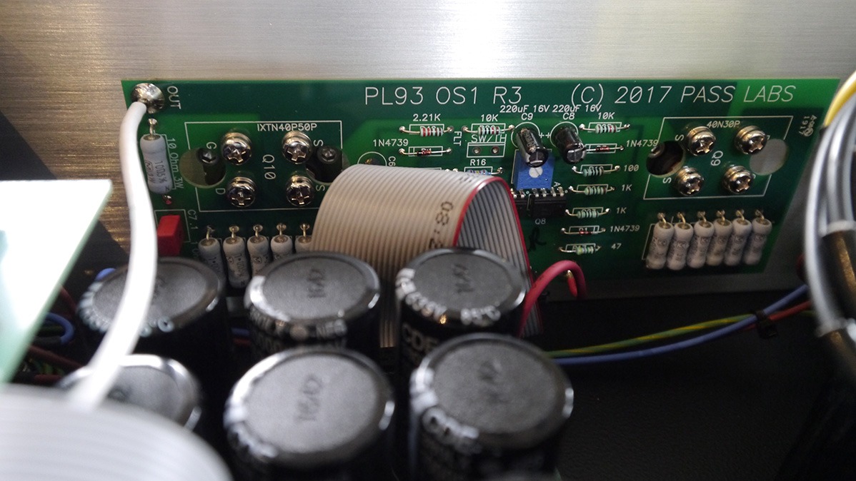

As to my reason for being here: I was going to build myself a version of the GamuT D200i which also feature some pucks in the OS, and the pucks was the main reason for me wanting to build the D200i. But faith would have it so that some time passed and I have yet to build this amplifier... but, after a brief conversation with its creator Michael Edinger, I have decided not to move forward with that amp. There is no reason since the brilliant Babelfish XA252 exist and both SE & SET exist with the US or differential in the planning stages. Because that was something I wished for regarding the D200i, a differential version of it and the whole differential comes from Allan Wrights DPA-300B amplifier. I later learned that PASS also offer differential amplifiers and that is yet another reason for me being here. That AND having the prospect of building my own amplifiers with the option of bling-bling if I want too 🙂.
But it wouldn't be in my nature to not have questions, so I do.
Q1 ---------------------------------------------------------------------------------------------------------------------------------------------------------------------
The first question is oriented around the IXYS N-chn and I sincerely have something I am wondering about, so reaching out in hopes of clarifications. Most of you guy's have decided to pair the 140N20P and 40P50P pair which I find kinda odd since PASS uses 140N30P and 40P50P pair, but beyond this fact, I want to run something buy you guy's.
Looking in the datasheet for the 40P50P we find this.

- On resistance: 230mΩ ... (a bit high, but what can you do huh)
- Ciss: 11500pF
- Coss; 1150pF
- Crss: 93pF
- Slew rate: 10 V/ns
Since this is the P-chn and we don't have many P-chn to choose from, these values are sort of the reference and ideally, the N-chn will be close. So lets look at the 140N20.
- On resistance: 18mΩ ... good.
- Ciss: 7500pF
- Coss: 1630pF
- Crss: 280pF
While the Input capacitance (Ciss - gate to source) is lower for the N-chn, the remaining Output (Coss - drain to source) and Reverse Transfer Capacitance (Crss - drain to gate) is significantly lower on the P-chn.
Now lets look the 140N30P part.
- On resistance: 24mΩ ... (still good)
- Ciss; 14800pF
- Coss: 1830pF
- Crss: 55pF
- Slew rate: 20 V/ns.
Look at Crss... its only 55pF and thus much closer to the 93pF of the P-chn part. The reason I am addressing this is Miller Capacitance and I am going to quote Aiken amps here:
The term "Miller capacitance" is often seen when reading about guitar amplifier circuit design. It refers to the effective multiplication of the plate-to-grid capacitance in a triode tube (or transistor) by the gain of the amplifying stage.
When a tube is amplifying a signal, it has to work against the plate-to-grid capacitance, charging and discharging it as the signal changes. Because the grid is a high impedance, and doesn't sink or source any current, this charging current must be sourced or sinked through the driving source resistance of the previous stage. This forms a lowpass filter, with a corner frequency determined by the source resistance of the previous stage and the input capacitance.
The Miller capacitance effect on music usually have a frequency limiting factor as well as removing some of the micro-details and transparency we often associate with Triodes and Pentodes. If you look at them tubes, you can see the the grid-to-plate (gate-to-anode) is MUCH lower compared to FETs.
300B Triode have a Cg-a of 7,5pF while the KT88 Pentode have a Cg-a of only 2.5pF... and the later happen to have more details and resolution compared to the 300B. A drastically lower Miller capacitance. So the 55pF for the 140N30P part is actually among the better out there and better than the Vishay IRFP240 (130pF) and IRFP9240 (81pF) parts.
Ofc, they don't beat the lateral MOSFETS from Exicon which are only 10pF, but they are only 125W and 8A packages, so not really useful here.
Also, if we look at the SOA of the 140N20P and 140N30P, we can see that the 140N30P is almost identical to 40P50P.
Q: With all of the above in mind - what was the reasoning for 140N20P over 140N30P for the Babelfish version ???????

1. calculate Miller for common drain stage
1a. lack of mileage often results in obsessing with tiny details, which can be only observed after plethora of mileage; you can't even think of importance of interelectrode capacitances without context - first taking in account mode of operation ( common drain, source or gate) and then cojones of driving stage and then amount of NFB in system; you didn't even think of xconductance in your table of data, and you certainly didn't think of fact that Pa ( nor Mighty ZM) is not sharing your obsession with identical transfer characteristic of part used in adjacent OS halves ; in case that everything is damn symmetrical, I'll have much harder work to invoke 2nd as dominant
2. I have no problem with that resistor; it's there to shape THD Spectra by my wishes and it isn't in OS; name of the game was to make Square Law OS amp, not everything without any sort of degeneration
as I wrote - I had beautiful iteration of Babelfish XA25 ( distinction - no 2 on end), with handfull of tricks included, so different enough to Papa's origin ..... but I didn't even put it to power to try it for more than 2 years sitting on the shelf, simply feeling that I didn't reach sparkle I wanted to be present; this iteration gave me pleasure of having that sparkle
build something, stop obsessing with things you're not able to put in right place in Pyramid of Significance, without building and measuring and thinking what's really important

aha, use either -20 or -30 as N channel, depending of your luck which one you can get; you'll not hear difference, even if you use -20 in one channel and -30 in second
that gives you common drain OS, stable enough biasing circ, cojones of drive and NFB
