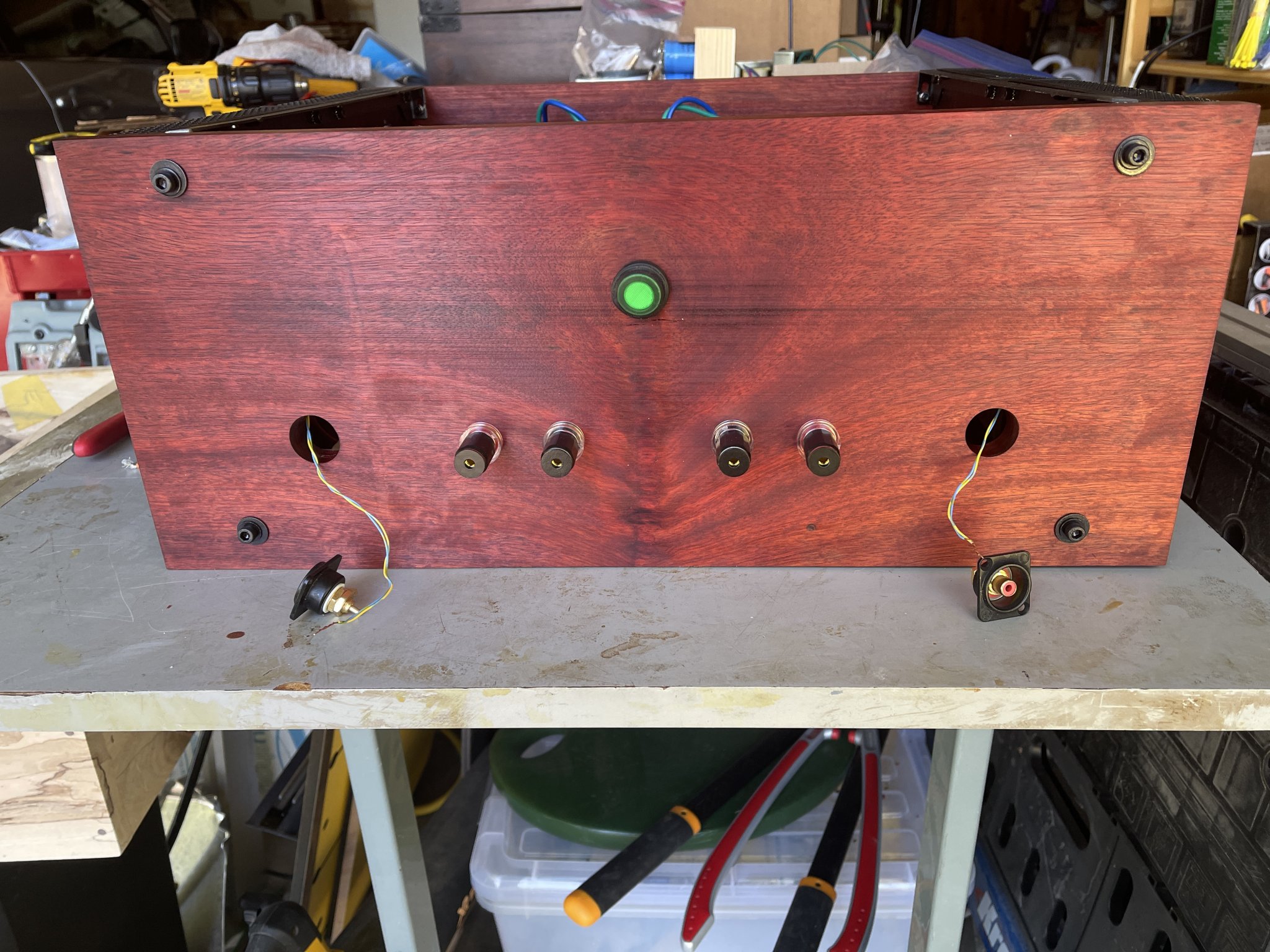

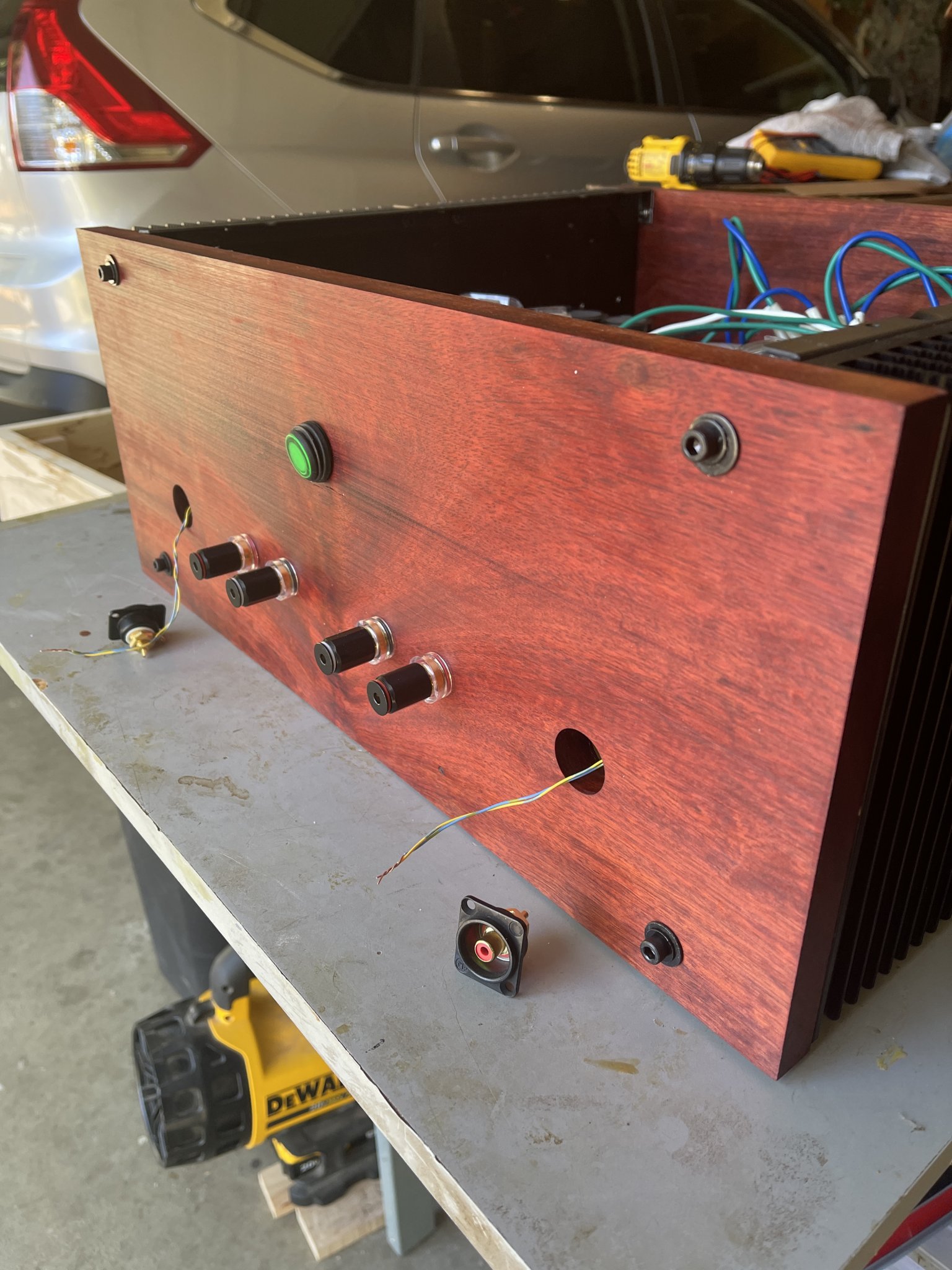

It has been worth waiting for - I have been the delay not Aleksandar - I have been listening to the BAX252 for a couple of hours now.
Softone 4 phono - Iron Pumpkin - BAX252 - Tannoys
It does not disappoint. All that you expect from a Mighty ZM project plus some. Its a foot tapper and a keeper

Could you tell something about the funny inductors?
My IXYS are waiting too... so contacted his Mightiness
ERSE Super Q 2.2mH 16 AWG 500W Inductor
NP put me on to these 15-20 years ago - mine are probably 14 AWG

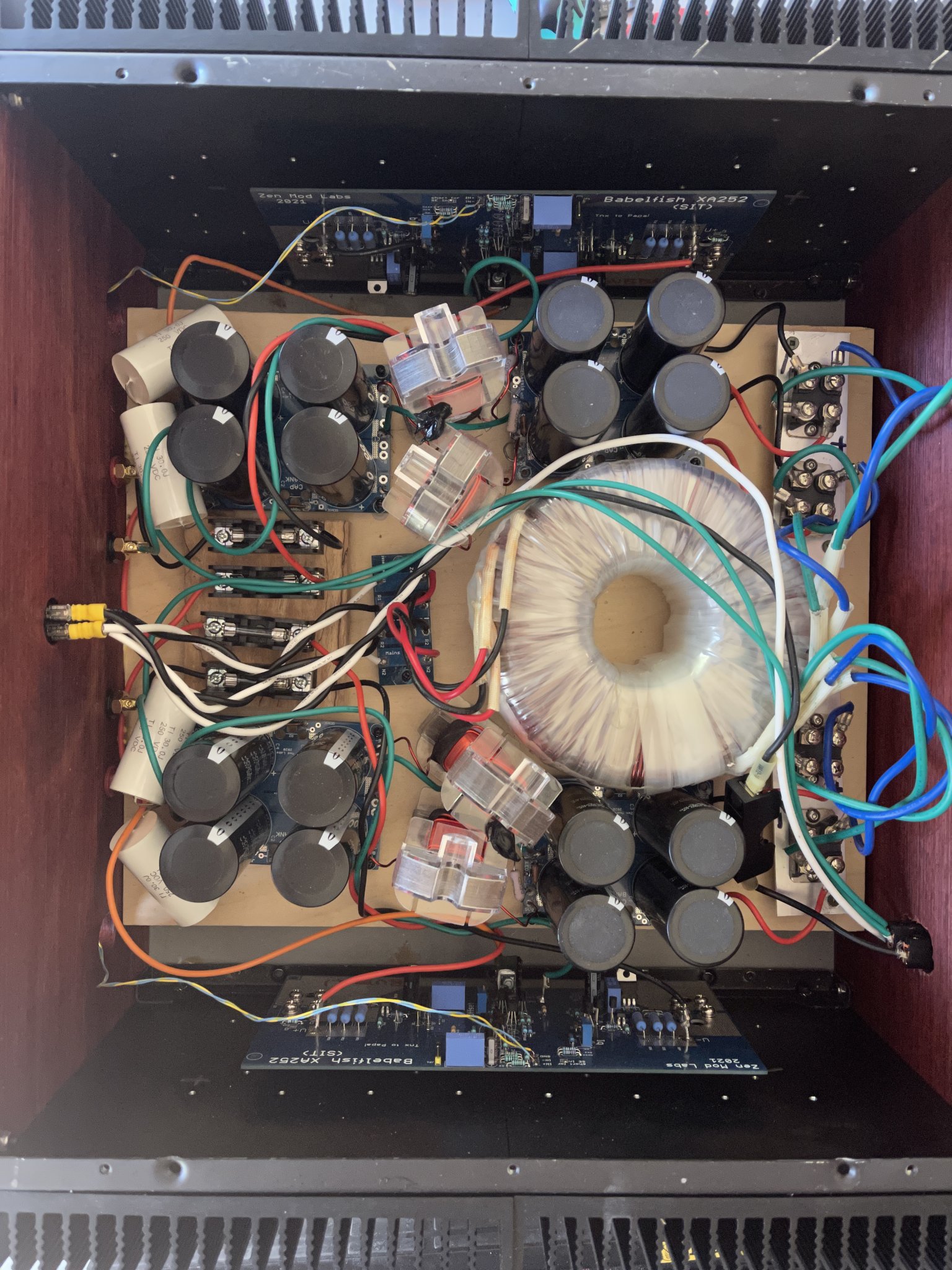

His Mightiness wrote somewhere this amp will have "a shitload of watts", so which VA has your donut?
if going Full Monty, meaning 35Vdc rails and 1A8 of Iq, dissipation is 126W per channel
case (sized as) Modushop 5U/500
common Donut 600VA or - better - two of 300VA

The transformer is
https://www.antekinc.com/an-10425-1000va-25v-transformer/
It is what I had on hand.
The heat sinks are the ones used in the 5U case - I would not go smaller 😈

yes 4U/400 computes , but there is always a problem how to arrange two output parts on two (on different sides) heatsinks - one OS part goes with pcb, second must be moved to adjacent heatsink, using wires and always taking gate resistor to part itself ( heatshrinked with wire)
with some amps that is proven and working, it'll do even here, but I can't guarantee because I didn't tried it, so can't say firmly that there will not be some oscillations
that's exact reason why I asked last year guyz from Modu about monoblock chassis ...... but unfortunately there is no 5U/500deep one
as always, there is no free lunch
but, if you really want (this) 60W+ strong 25W amp, you can skimp only if you're able to draw custom corners by your self
