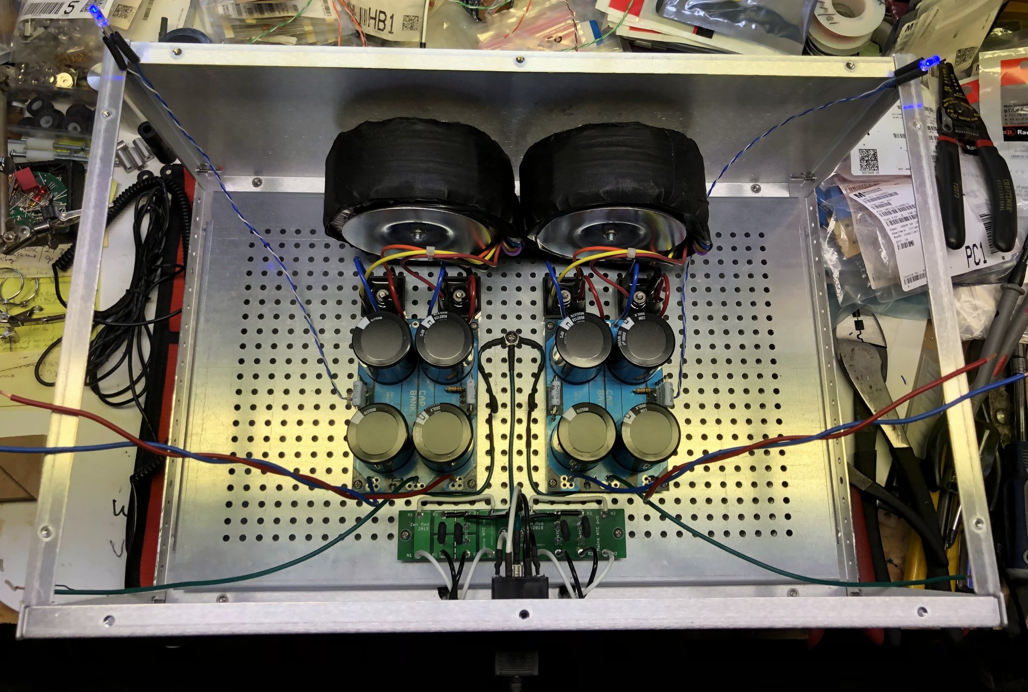

I finally got around to making one of my new power supplies operational.
My intention is to build two stereo amps to play with active multi-way speaker experiments.

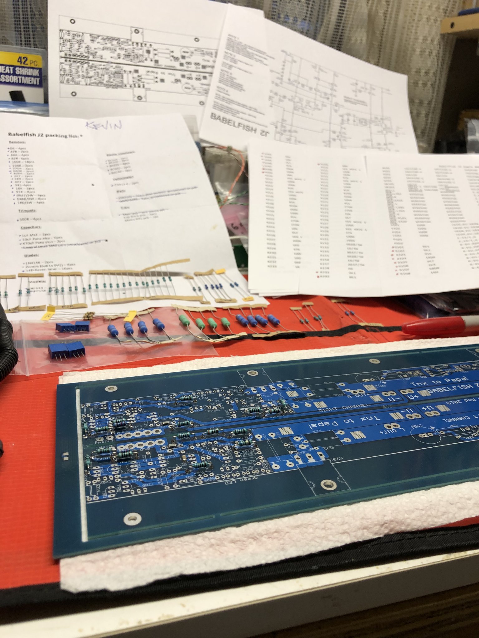

I lost patience due to limited time and discipline…and started populating my first set of Babelfish 2J boards to try with this supply.
Just wanted to vocalize some thoughts after having re-read this entire thread and taken notes.
I got my boards as a gift from Mighty ZM himself through the raffle at BAF2019…good times!
Afterwards, I ordered the full parts kit from Mighty ZM…so glad I did…kudos to him for all the hard work he does for us Lazy Greedy Boys!
ZM has already mounted the 2sk2145 critters at J101,2,3,4 and a couple other SMD bugs.
All posts I have read relating to the population of the LTP section (even as ZM stuffed it) I found point towards the same answer regarding R110 and R114…leave them empty.
So that is what I’m doing…unless I’m told otherwise.
I’m not sure how things will go given this is only the second amp I’m building outside of the documented DIYAudio kit realm. The F2J I built seemed much simpler.
Anyway, my goal is to try to maintain some flexibility for the purpose of minimizing expensive mistakes and trying different scenarios.
My intention is to build an amp with Semisouth in the lower position and the IRFP150 in the upper.
I’ve seen the various transistor combinations and source resistor values ZM has played with, and although I have hoarded enough Semisouth to try them in the upper position as well I’m not sure I will feel compelled to.
Regardless, my feeling is that I should first build the amp with IRFP150 in the upper and lower positions so that if any poop hits the fan because of a mistake I made it won’t expose the expensive Semisouth to that initial risk.
The thing is, I want to be able to change things over to the Semisouth down version as easily as possible once I confirm the initial version is functioning properly.
I’ve mounted some transistors remotely before in some ACA amps I built so that I could swap in various transistors like matched Harris IRFP as well as Semisouth.
I made my own “transistor plugs” from some DIP sockets and 16 gauge wire I had on hand that I cut up for this purpose. It worked out quite well, and the amps still function perfectly.
Since I don’t enjoy desoldering and exposing transistors (especially Semisouth) to multiple heat cycles, I think I may go this route again. Although this time I have invested in some good quality Delphi harness connectors for the cables that will attach the circuit to the transistors.
https://www.amazon.com/gp/product/B07DZ31MXL/ref=ppx_yo_dt_b_asin_title_o03_s00?ie=UTF8&psc=1
Since I know I will have at least two versions of this amp, and I may want/need to change the source resistors at some point as well, I am thinking I should mount some sockets I have on hand for these resistors (R132, 133 & R232, 233)…assuming they will accept the wire of the 3 watt resistors.
I am wondering if there is any place else in the circuit I should consider mounting sockets?
There was mention of adding 100K at R139/239 in order to make DC offset behavior more “friendly” with the Semisouth in the lower position.
There was also a few people that ran out of adjustment on their pots for Iq and DC offset adjustment that required increasing the resistors in series (R123/233 and R118/218).
Does it make sense to mount put sockets in any of these or other locations?

good thinking
wherever you think you will need altering of resistor values, just solder 1pin sockets in place and push resistors in them; take care of proper contact (feel that they're grabbed in sockets)
once when you're sure of functional value of resistor, do not even bother pulling sockets out - just solder resistors in sockets
for small MF - you can push those 1pin from IC sockets, if you have those handy
same applies for small MF and for 3W Biguns, if you are able to find adequate sockets for fatter pins
regarding output parts care - thermal cycling - no need to worry about soldering as is needed to take care of not bending pins without being sure they'll end in that form for good
see in various pics of my (first, smaller) T-Bed - in most cases I bolted mosfets in place without bending pins at all, then connected them to pcb with short pieces of solid core wire - thickness of, say, 3W MOX pins , or 3A diode pins; works as charm, mosfet pins are not bent and everything good
you can do the same with any semithick wire, stranded or solid core
and yes - pcbs which will ( hope, Pony Express was better than US Post today) soon arrive to you are of much better quality than pcbs of that era
:rofl:
just recall that Mark (Variac) got same pcbs....... and he's having Plethora of Semisouths too .......
can't remember what he said at last BAF (chat) - it's possible that he's having SJDP too ......... depletion ones .......... those I never had and someone better/more clever than Mighty Moi could say that nothing new under the Sun can't happen ...... but me being me ..... it'll be interesting to try them in DEF arrangement ..............

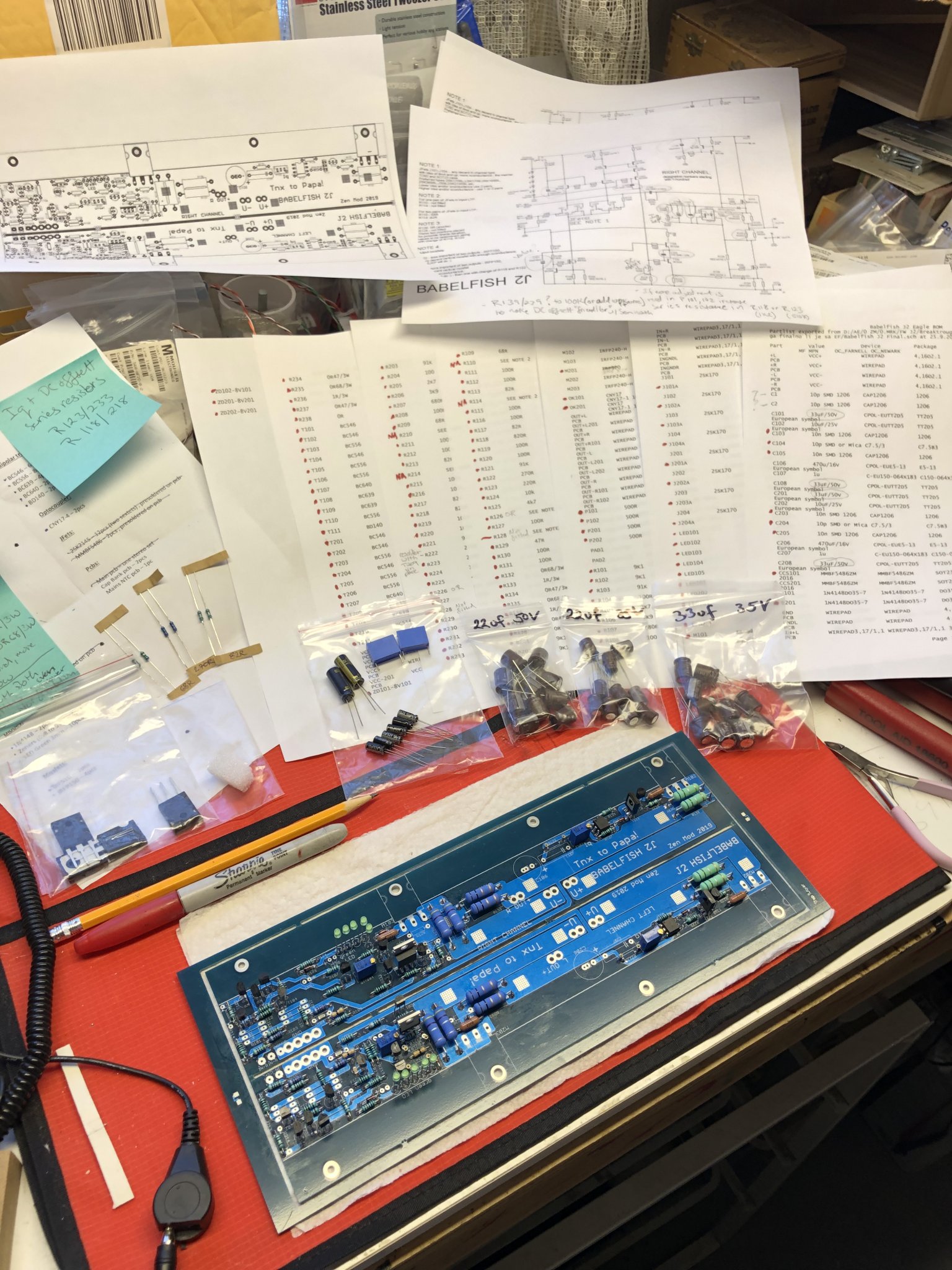

I’m almost done stuffing my boards.
I left the caps for last.
Looking at the BOM you generated from Gerbers and provided at some point earlier in thread…and comparing to circuit diagram(s) you’ve also posted.
Few questions:
BOM lists a C1 and C2 10P SMD?
Am I blind?…or do these not exist?
I only discovered (3) SMD caps on boards already mounted by Mighty U.
After referencing the circuit diagram and boards I determined them to be C103,104&105 (C203,204&205).
Did I miss something?
Second question:
C101 and C108 call for 33uF/50V
In the cap bag from kit I have (6) 10uF/63V, (2) 470uF/25V and (2) 1uF/5/100
(2) 10uF/63V work for C102(202)…
470uF/25V=C106(206)
1uF/5/100=C107(207)
Are the other (4) 10uF/63V meant to substitute for C101,108(201,208)?
If not, I have a few Elna Silmic on hand I might be able to use…although they have a bigger footprint…I might have to insulate leads and hang them off the back of the boards.
I have:
22uF/35V
33uF/35V
22uF/50V
ignore BOM designation (if there is "C1" and "C2")
another reason why I despise/avoid using BOMs made by anyone else - I'm having my head and my own tendency of making mistakes, so I'm usually just confused with someone else's head and tendencies
now, in schematic at first page, there are caps marked C104 and C204 - those are 10p caps, so called lag caps , or compensation caps in feedback loop
they're both near GND pads field, on top of pcb
now - C101, C102, C108 - all are the same - 10uF/63 I did change that due unification reasons, none of them being critical in value; in fact - startup/turn off behavior is more benign when C101 is decreased to 10uF
C106 - that one must be 470/16 (even if 6V3 is practically enough) and of course that 25V is good
1uF MKC Philips is bypass for that one
