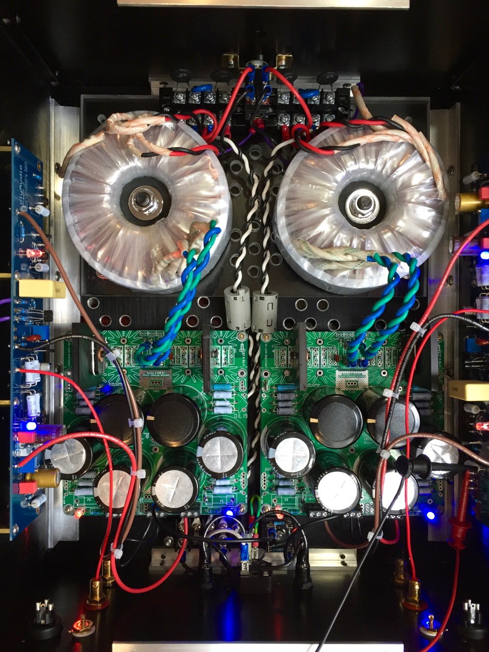

Something else to consider: CRC Power Supply (Class A amplifier)
I used a pair of these CRCRC boards with low Vf bridge rectifiers in my Aleph J. Together with a pair of Antek 300VA toroids, they all fit into a 400mm deep chassis. Just barely. The Aleph J is still my reference amp.

Thanks! I've taken a look at that one.
I have Prasi's LT4320 boards in various formats, and I still have yet to try XRK's SLB. I used Prasi's boards for the Singing Bush, and I still have a few left over along with some parts. However, I hear great things re: the SLB. I lean toward SLB just to try something new.

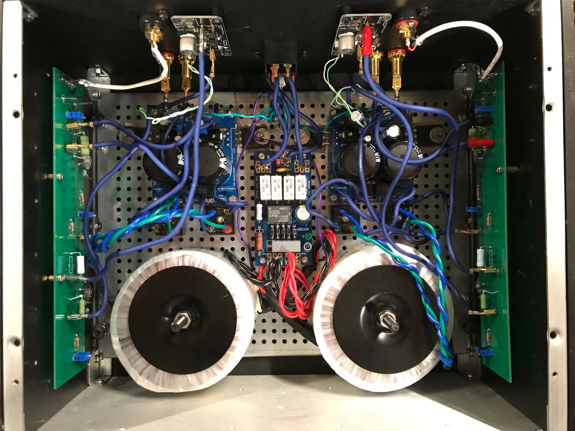

SLB's are great too! Go back to post #560 to see my implementation. They aren't cheap to build and take up a considerable amount of space in the case, but they work VERY well and don't have a ton of voltage drop considering how much they clean up the power. I'm running dual Antek 400va with 22v secondaries and ending up with 26.9v under load. So only dropping about 4.2v, maybe less, through the whole system including sag from the transformers. I really need to go to 20v secondaries and scrub some extra heat off though.
