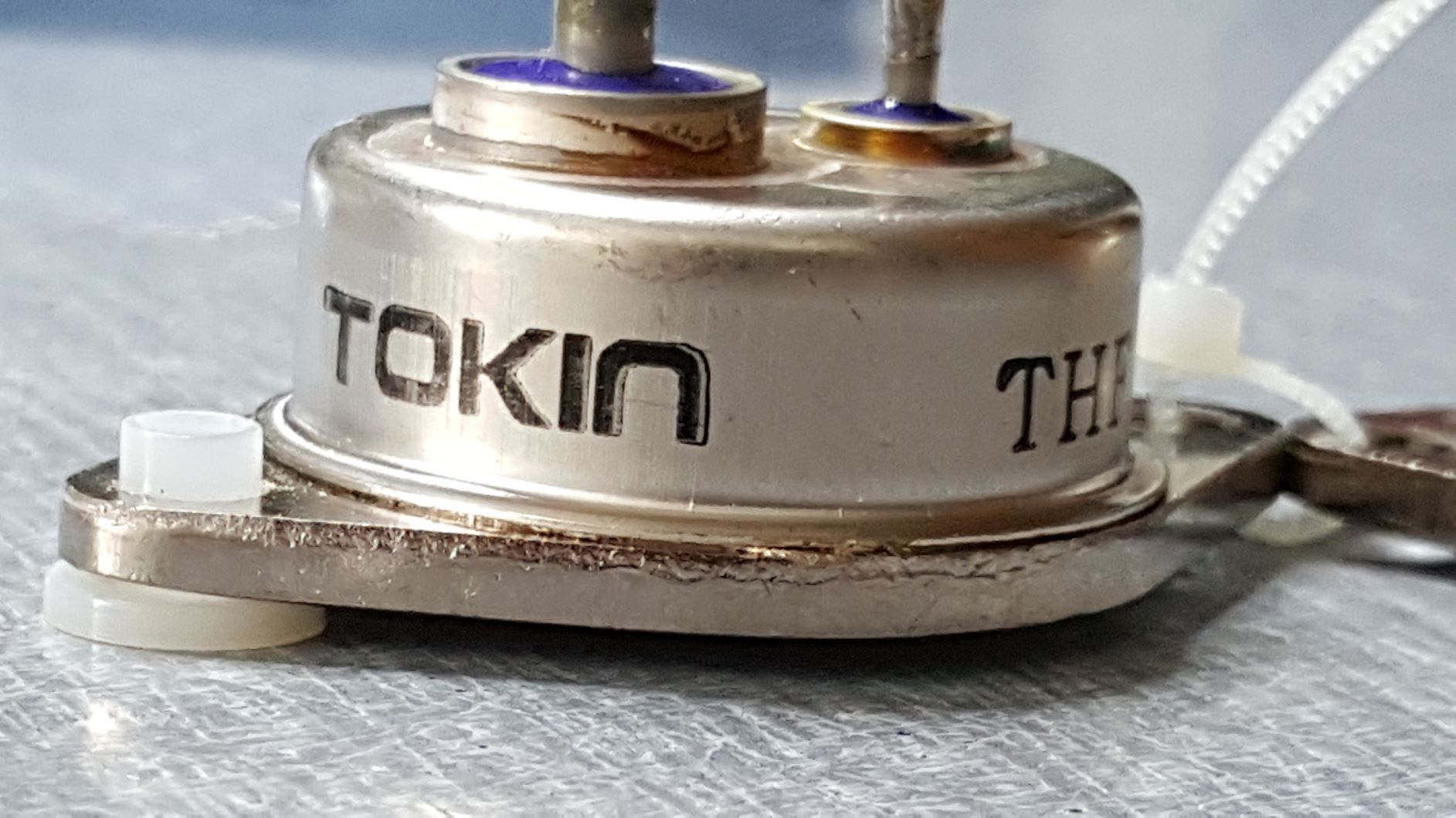

...but my problem is finding the proper bushings to isolate the hole
That is true. I received my SITs yesterday and they came with the isolation sheet and 5 bushing rings. The SITs were matched within 0.1V, 2.27V & 2.17V respectively, if you can trust prss1701's measurements. Some assembly is required as the bushing is about 2.5mm longer than the SIT is wide.
I Have these in my next Mouser order for mounting after measuring THF several times with digital calipers (out of paranoia). They will be nice and tight and fully insulate the mounting ear holes while allowing me to use 6-32 stainless screws to mount these hockey pucks.
561-08012 Eagle Plastic Devices | Mouser
These are the pads I settled for.
CD-02-05-C-54 Wakefield-Vette | Mouser
My own measurements showed Prasi's to be spot on and the three devices I bought are all a gnat's whisker apart.
