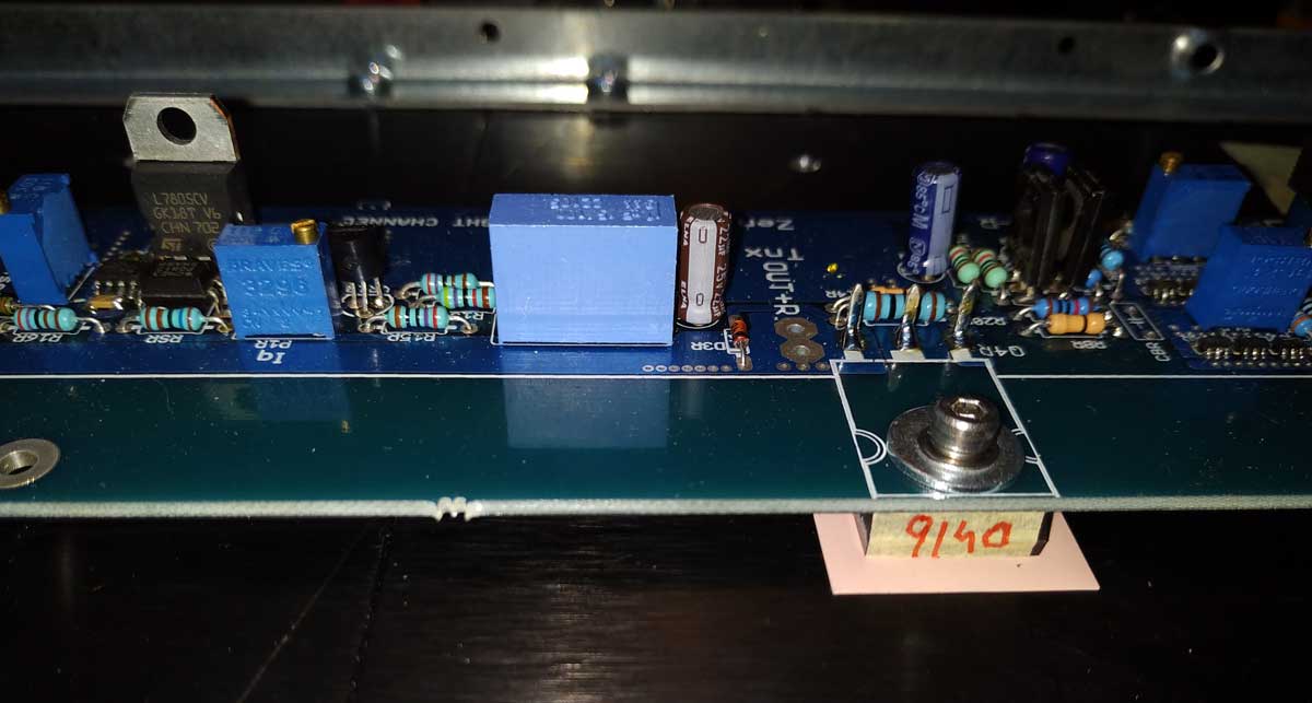

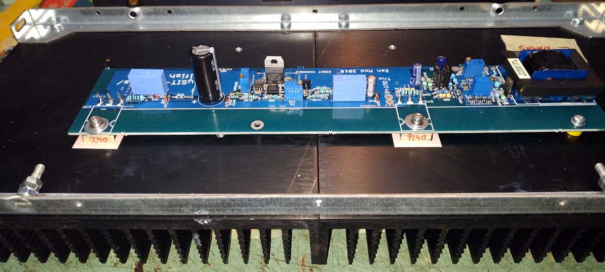

handy trick 1
as I said in one of edits of post #1 , it's sorta hard to set Babelfish M25 channel , when you mount pair of IRFP240 instead of IRFP240+IRFP9140**
so , make label as this , or use white marker , enabling later checks
saying that , with years , one is taking as granted that brainfart is permanent state , so why not doing things in a way to prevent costly consequences
**funny - nothing goes Dodo ; I needed just to swap IRFP9140 in and do setting procedure

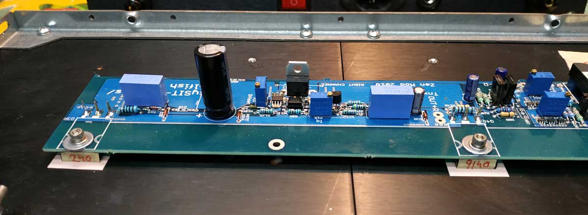

handy trick 2
yup
when setting input buffer Iq and DC offset , prior to closing JP jumper , one need measuring apparatus connected across R8
if you , as me , still didn't grow another pair of ......... hands , use mini clips as shown on pic
that way you'll avoid messy change of R8 , when slipped probe connect wrong end of R8 with GND ; lemme see - difference of 23V , constipated with just 1R , will certainly toast tiny resistor
