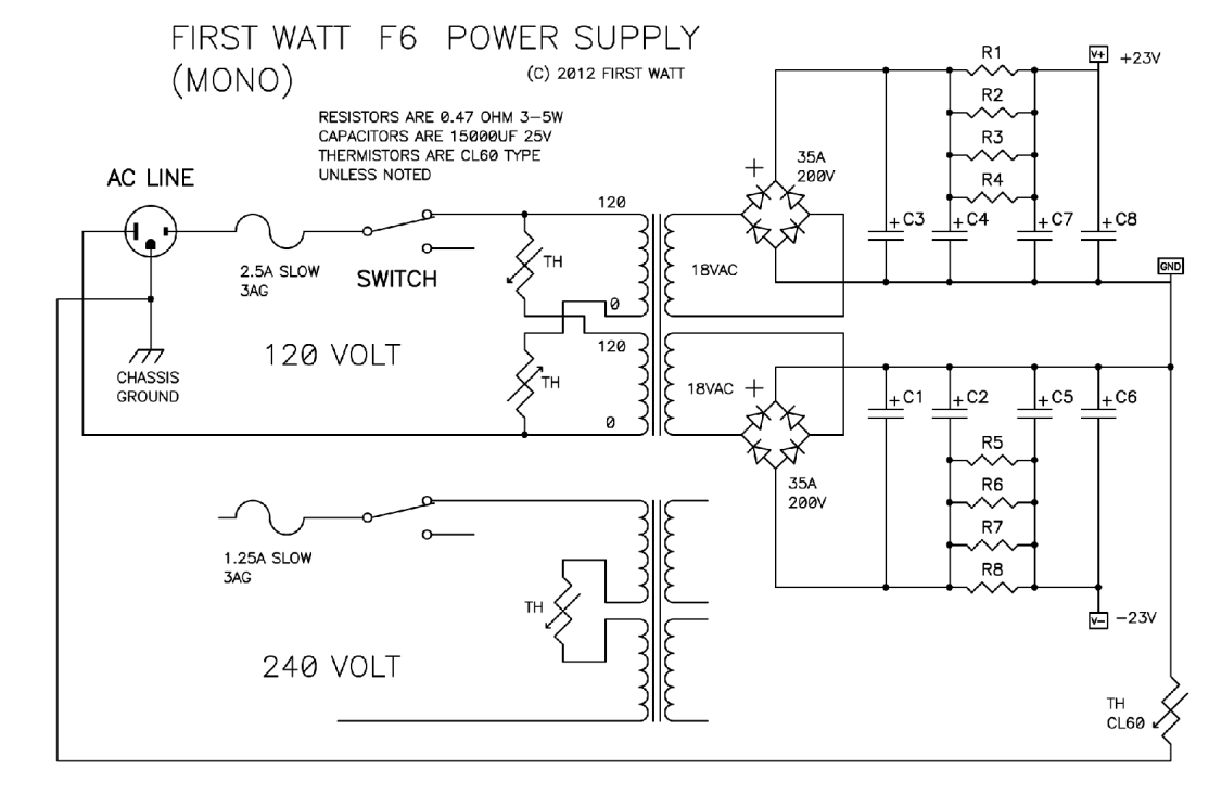

PSU
my habit - custom made Donut - always asking for decreased flux in core , which means more turns per volt than usual jobbie
300VA , separate 18Vac secondaries , one per channel
static shield , magnetic screen
filter - CRC , made of 33mF-0R1/WW/5W-33mF , per rail
yup, one Graetz bridge per secondary , so two per PSU
meaning that - when case is common , you'll have just IEC and switch shared between channels , after that NTC (CL-60 or equivalent) in series with primary and one fuse per primary
then 10-15R NTC from audio GND to chassis , safety GND of chassis is mandatory
as illustration - Papa's drawing from F6 article

dear ZM with the last update to post # 1 you finally answered my incessant question "Bias procedures .... bias procedures ... BP .... beep" . now you have finally turned off the alarm that had been lit for quite some time.
Now the picture is complete .....
really .... thanks for your great work:cheers::worship:
PS=another little question .......
why not use a "soft start" instead of NTC?

of course you can use soft start instead of NTC ;
but - as I'm always saying - to get really soft soft start - replace all fixed series** resistors with NTCs .... no more than 30R in sum value
**some are making soft start with paralleled resistors , which is recipe for .... not exactly disaster , but certainly non-functional soft start
