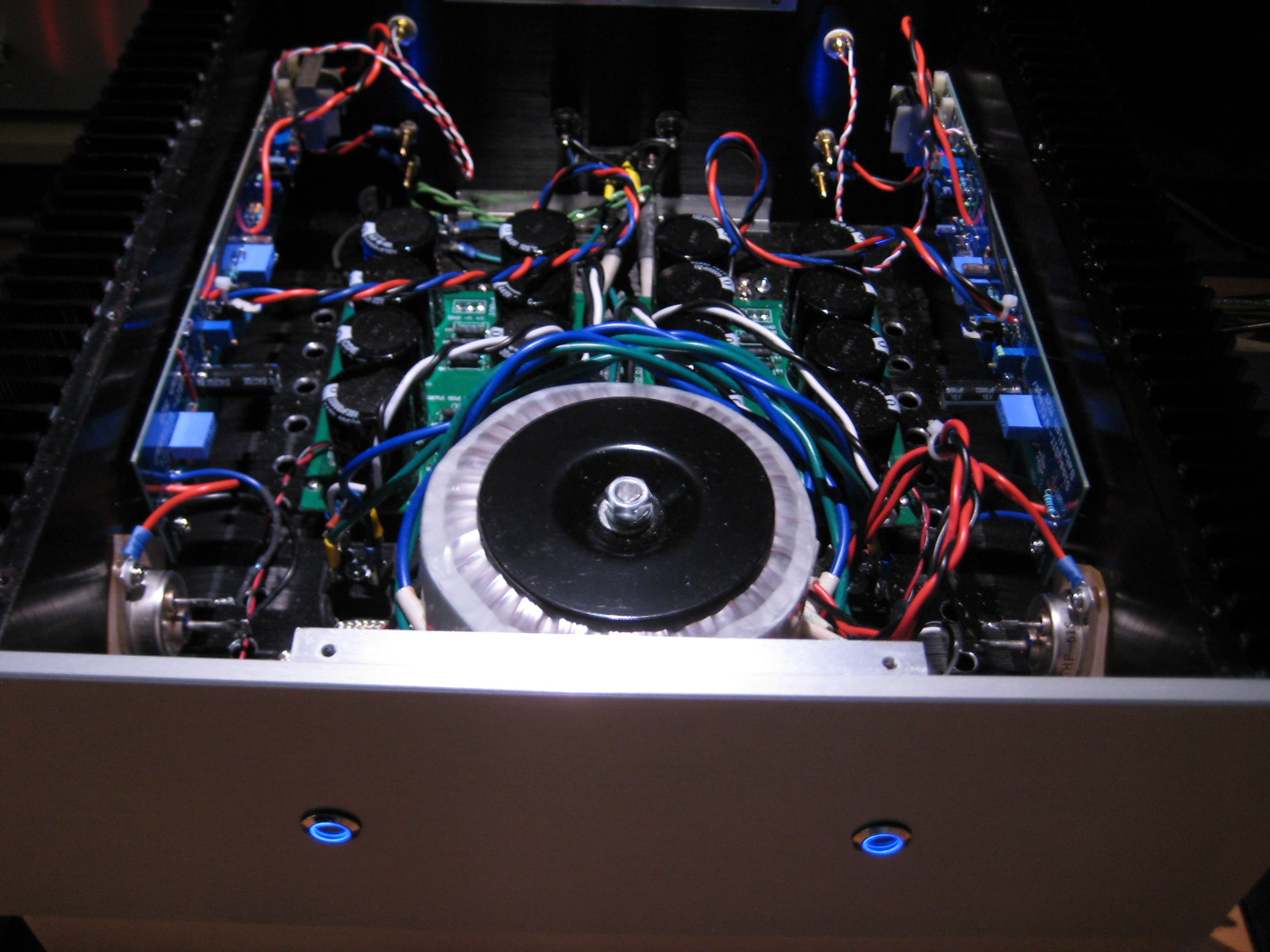

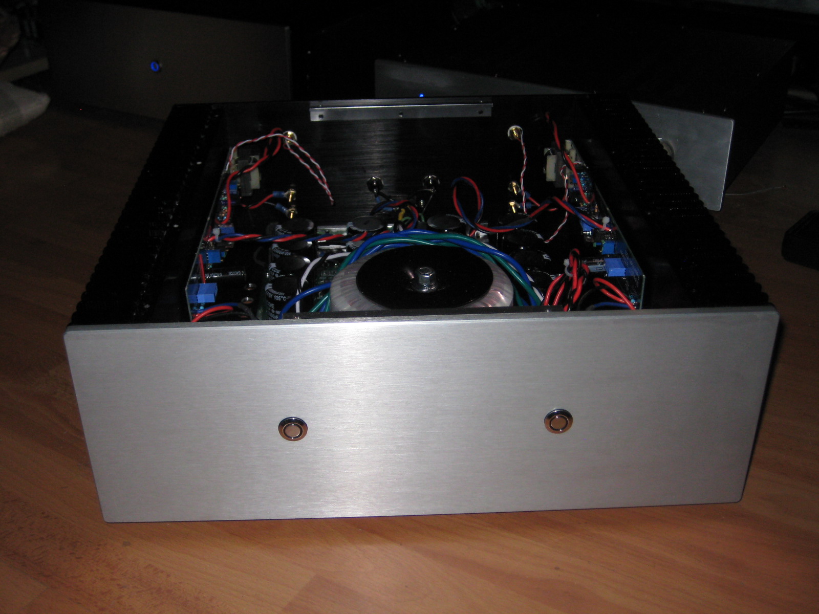

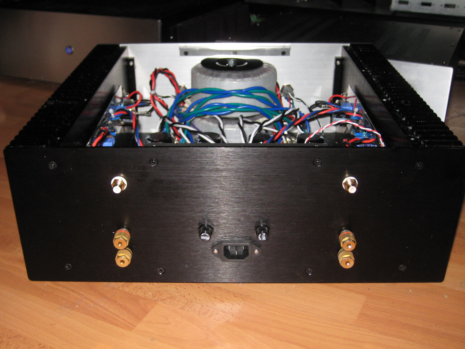

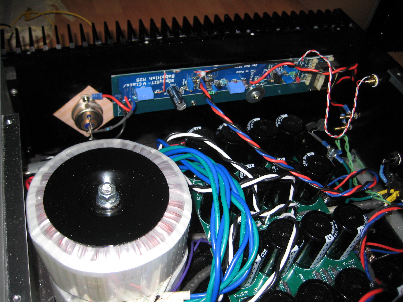

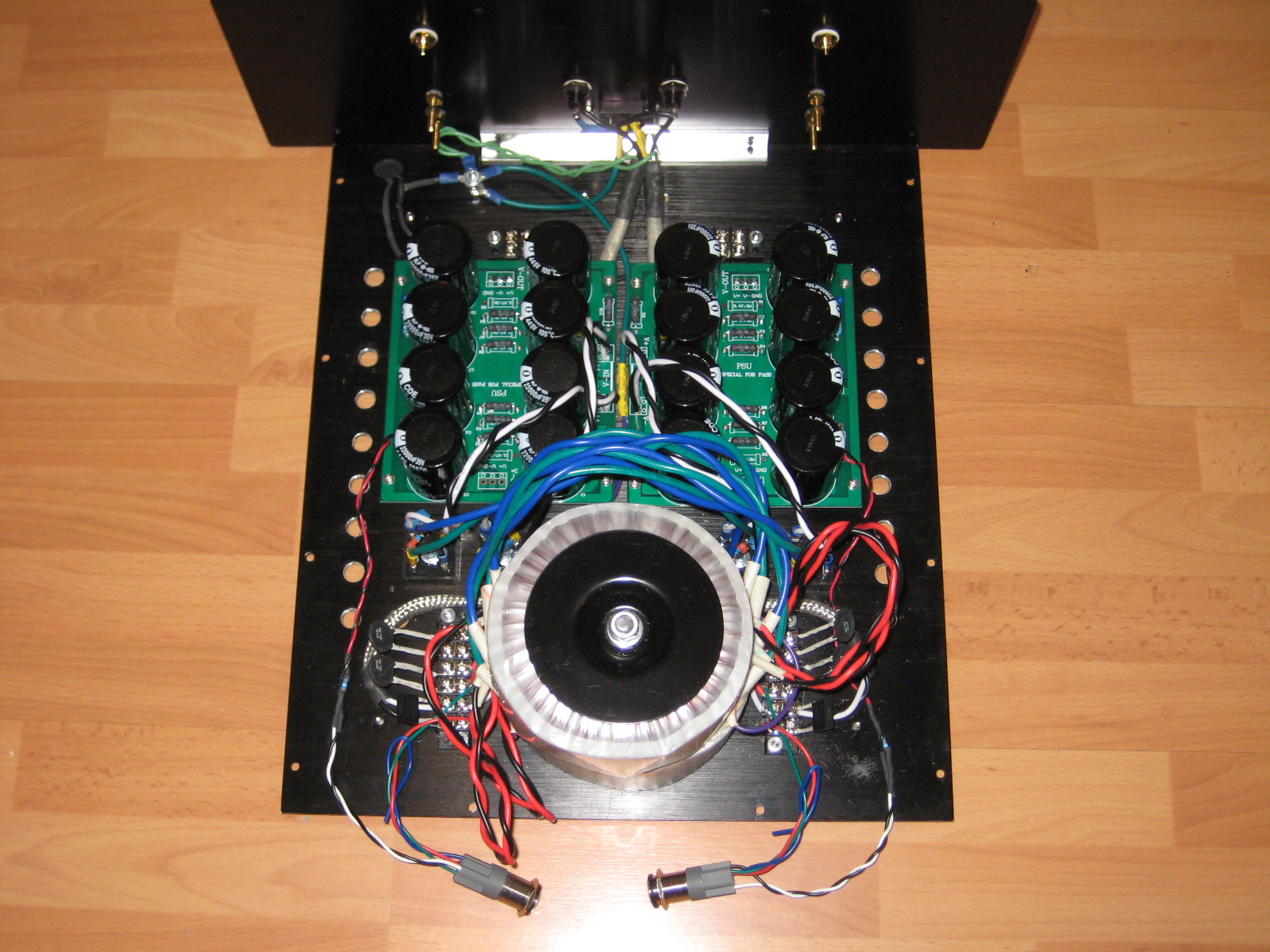

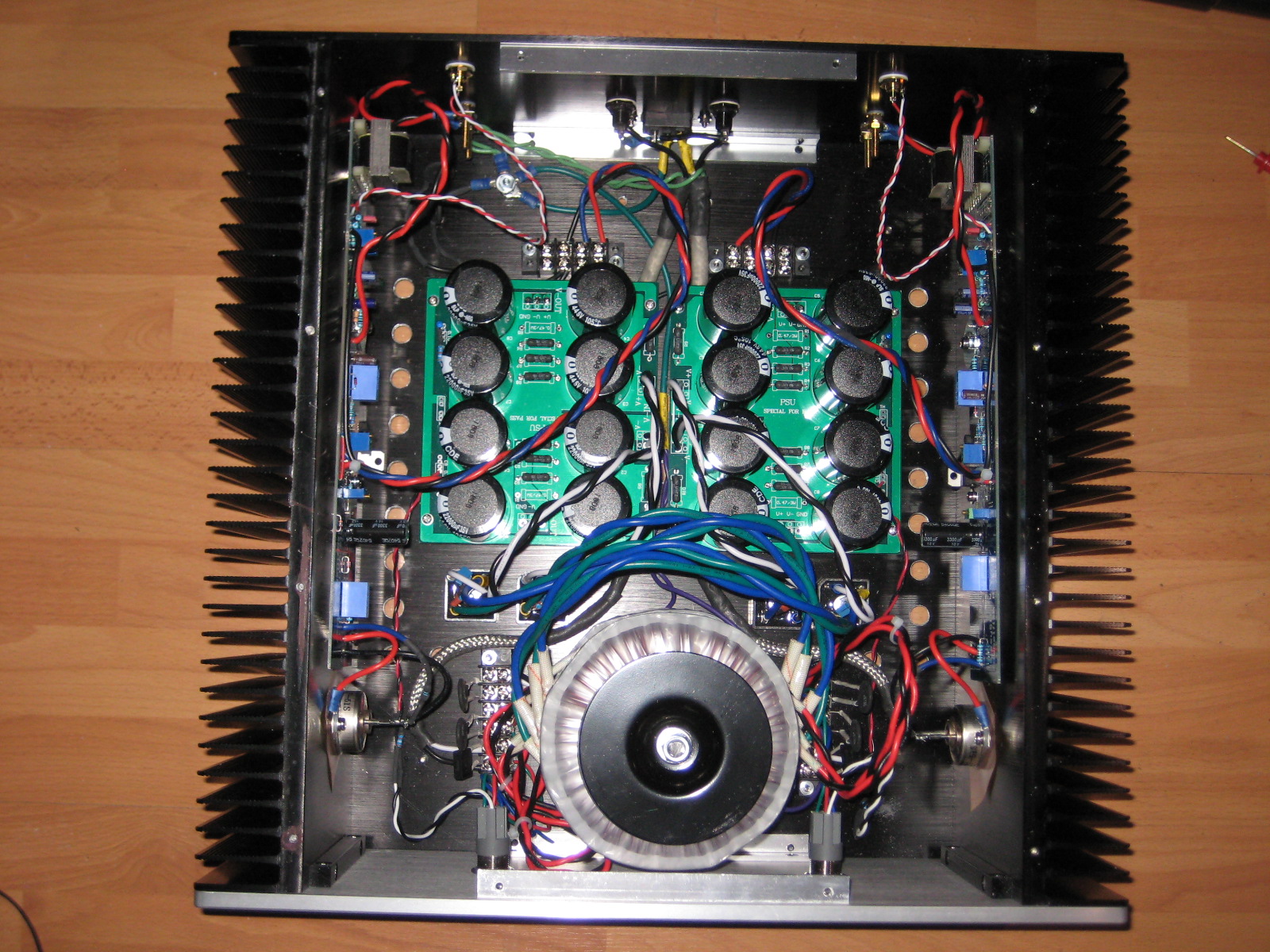

I finished my SissySit on the weekend and it is up and running and making music.
I had completed and tested the right channel prior to the weekend (see post #395). Chassis information is in post #379.

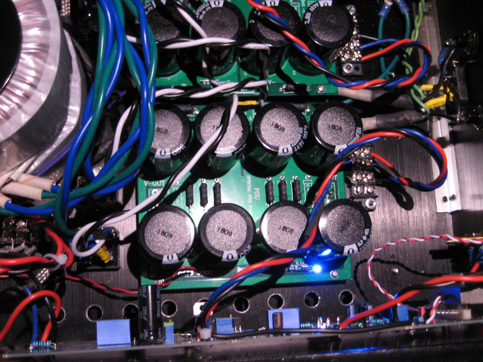

The left channel was completed and fired up and biased with no problems at all. Upon first turn on, the offset was about 0.5V and the voltage across 0R1 was a bit high at about 20mV. I think the right channel had started at about 1V offset and less than 10mV across 0R1, but I am not 100 percent sure as I didn't write it down and my memory is not the best.

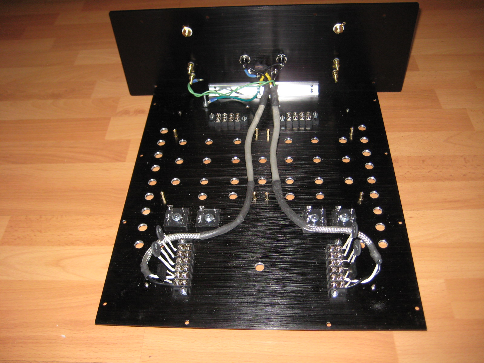

The amplifier is completely quiet with 102 dB speakers. I paid attention to proper grounding, twisted together wires with their ground returns, and also put the line AC wires in steel braid sheathing. I did not shield the Cinemag transformers.

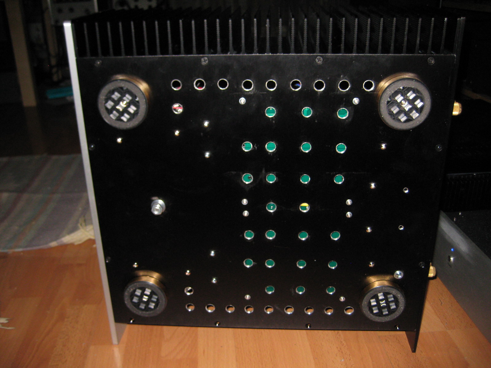

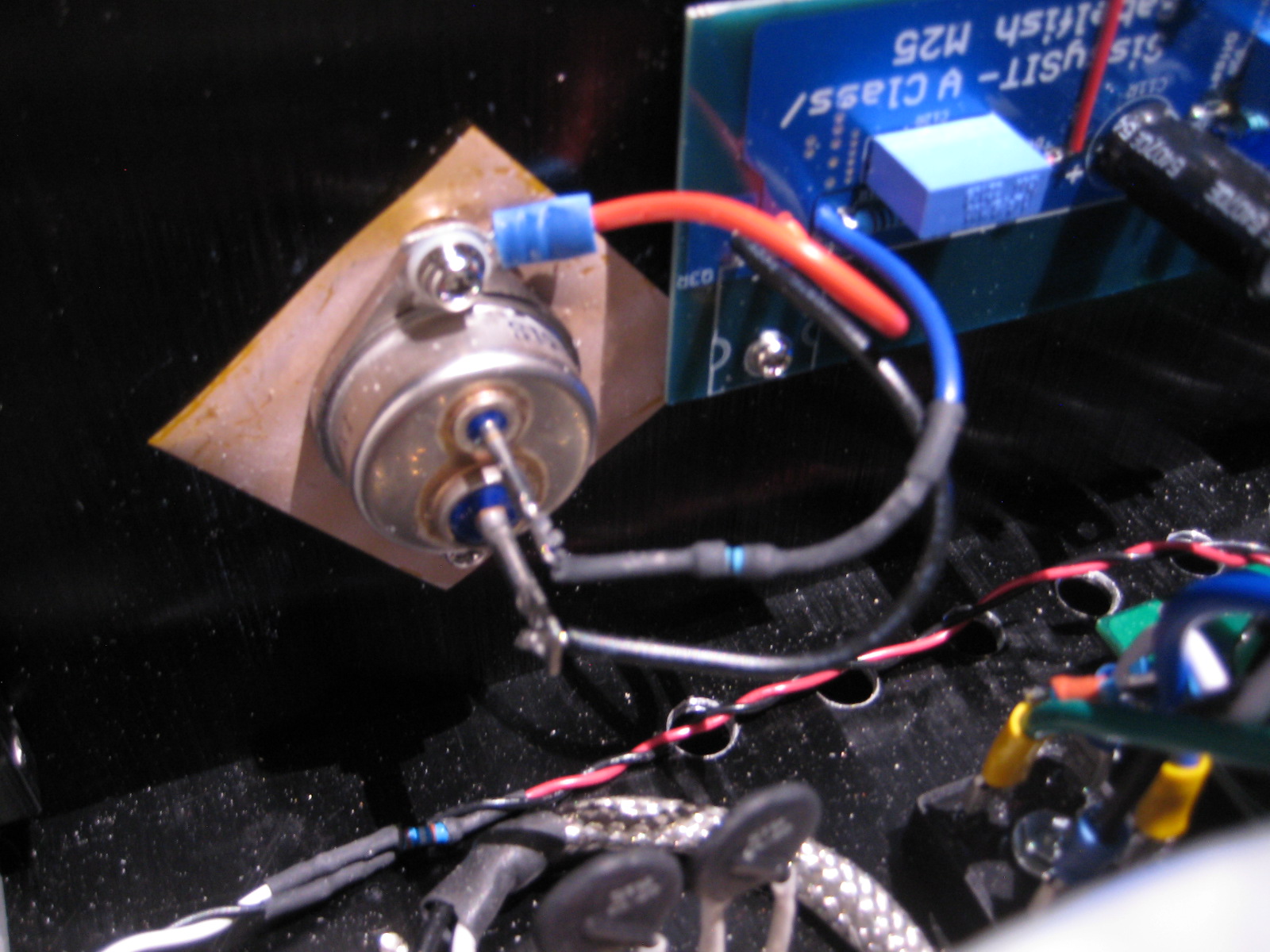

The amplifier does not run too hot. I can keep my hand on the heat sinks indefinitely. I had drilled the Mosfet and SIT attachment screw holes through the heatsink base between the fins so I measured the temperature of the screws from the outside of the heatsinks and it was 46 degrees C with ambient at 20 degrees C. Iq was at 1.8A. So that was the heatsinks' hottest temperature, with the fins cooler. The heatsinks are 150mm x 400mm by 50mm, with the base 10mm thick and the fins 40mm long.
My previous amplifier setup was biamping with DiyAudio Sony VFET amp on bass and Sony 2SJ28 Hammond choke loaded L'Amps on the mids/tweeters. My preamp is a Sony VFET Luminaria, so there was a lot of VFET goodness happening already. Because of that, the SissySit full range in place of the DiyAudio Sony VFET and L'Amps was not a dramatic change, but still a noticeable change for the better. The high frequency became more extended where previously it seemed a bit rolled off. Instruments and voices became more distinct and seemed to occupy more of their own space. It was as if the definition and contrast was turned up a bit.
So I am quite happy with my new SissySit. Thank you, Zen Mod.
