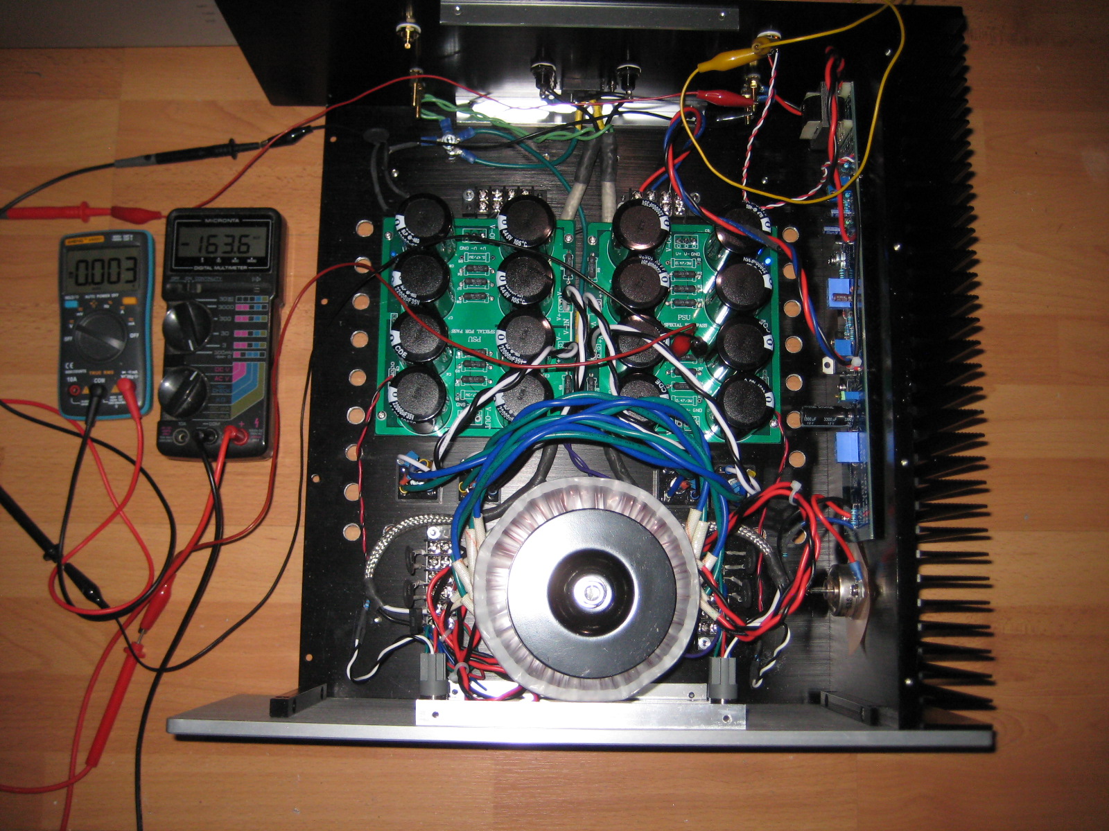

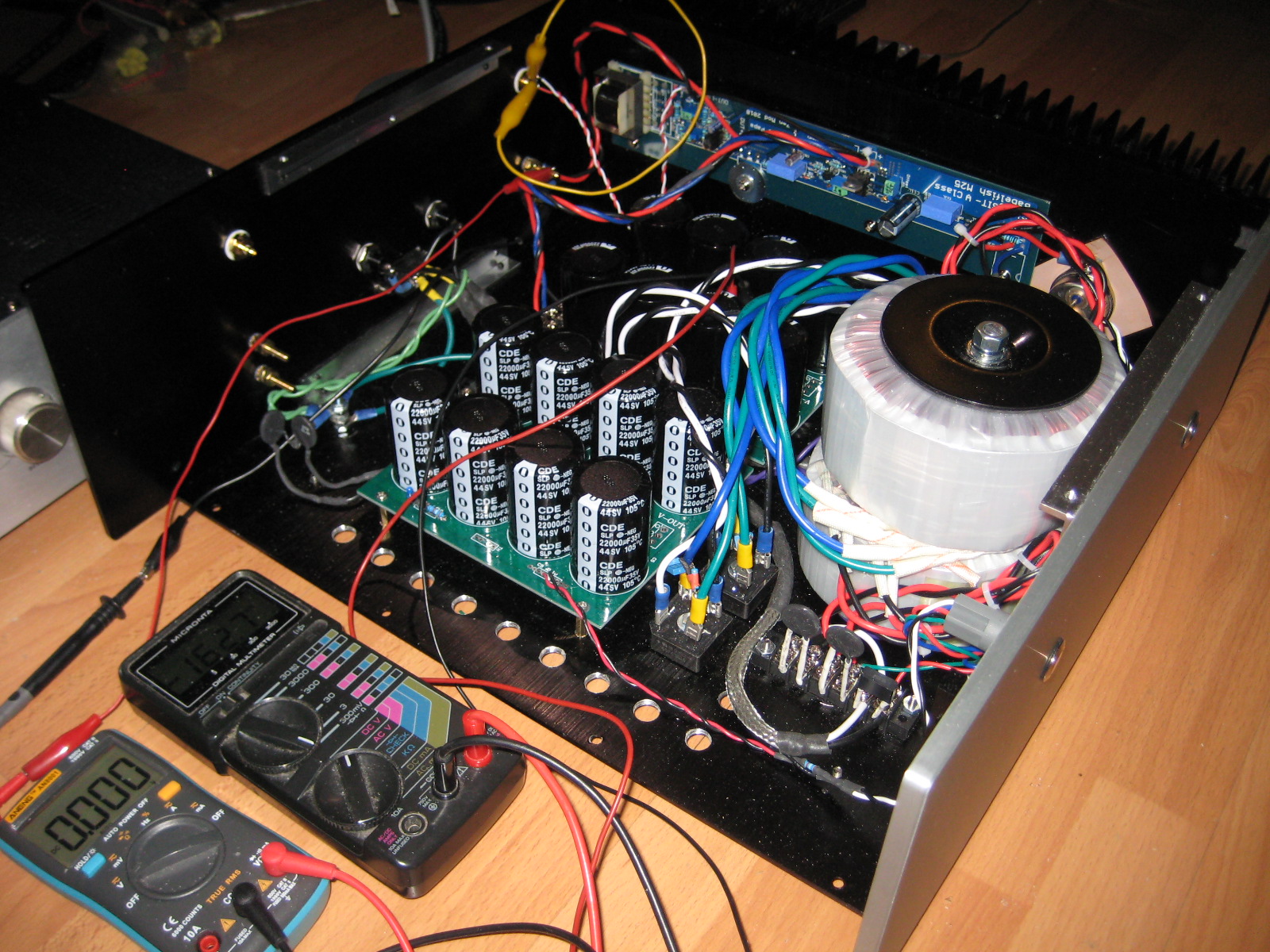

I completed the right channel last night and after much trepidation, I fired her up this morning. Fortunately there were no surprises and all went well. It is cooking at ~1.6A right now with negligible offset. I will probably leave the bias as is for now and set up the front end bias and then check with a speaker. Then onto stuffing the left channel board.
The only issues I had were drilling and tapping the heat sink for M4 screws to secure the IRFP9140 and finding that the hole in the IRFP was too small. I drilled it out with no problems. Also initially I couldn't fit the Cinemag transformer into the board holes. After much fiddling I found that the transformer fitted when offset towards the edge of the board. See ZenMod's post #62 for a clear picture:
Babelfish M25, SissySIT - general building tips and tricks
After about a 45 minutes, Iq has crept up to 1.76A and the heat sink is warm to mildly hot. My cooking thermometer measured 38 degrees C at the outside face of the heat sink base at the IRFP location. Ambient is about 20-21 degrees C.
The power supply is at 22.4VDC positive and negative, with Antek AS 3218 transformer in mono, and AC is 119V.
