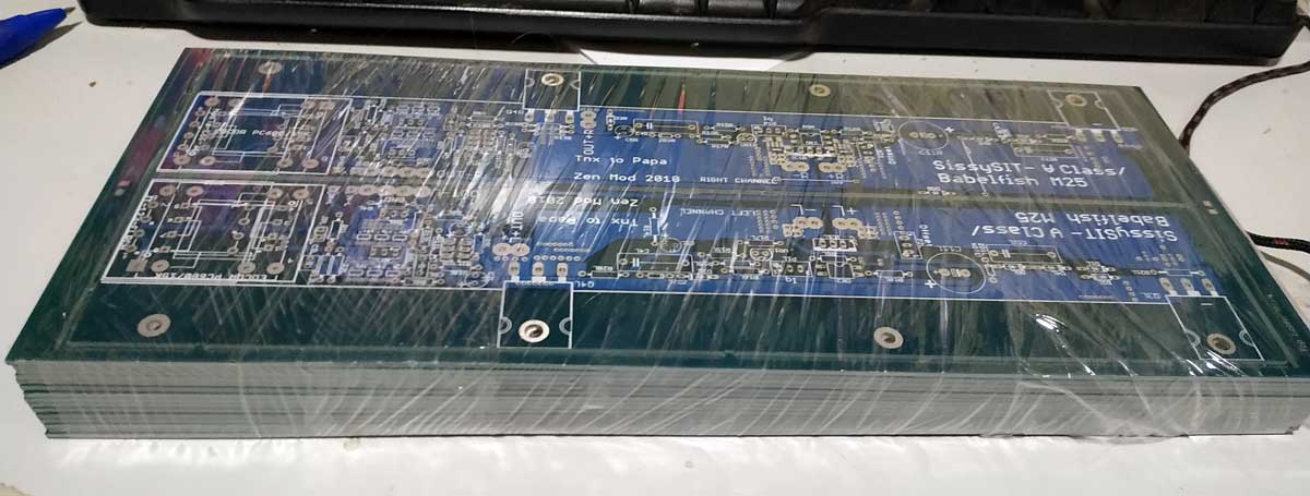

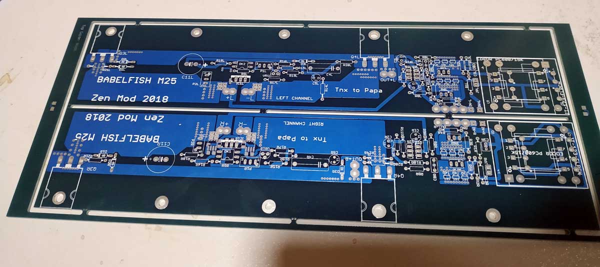

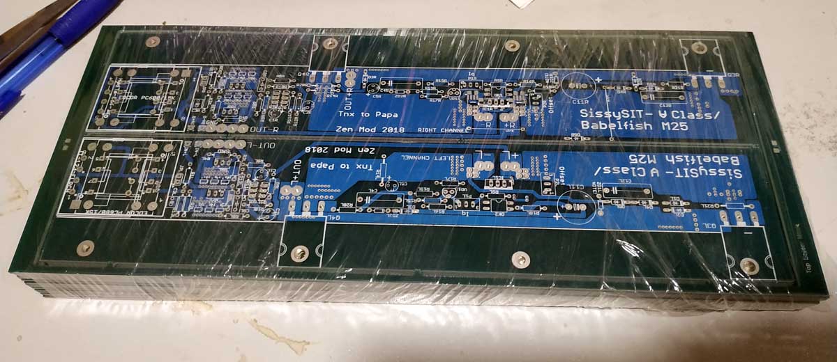

btw.
just arrived two days ago :clown:
one piece with FW form factor , for one Greedy Boy having FW case clone from ebay (and I know that everyone who bought those , did that as Kudos to Pa , even if trading with some damn Leacher)
.... and bunch of regular pcbs

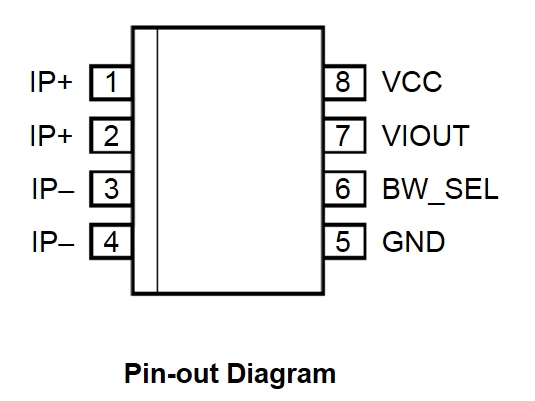

You can check the ACS723 carefully.
You should read on pin 7 +2.5V at Iq=0A
and +3.3V at Iq=2A (400mV/A).
Caution! The Pins are very near, don´t make a short.

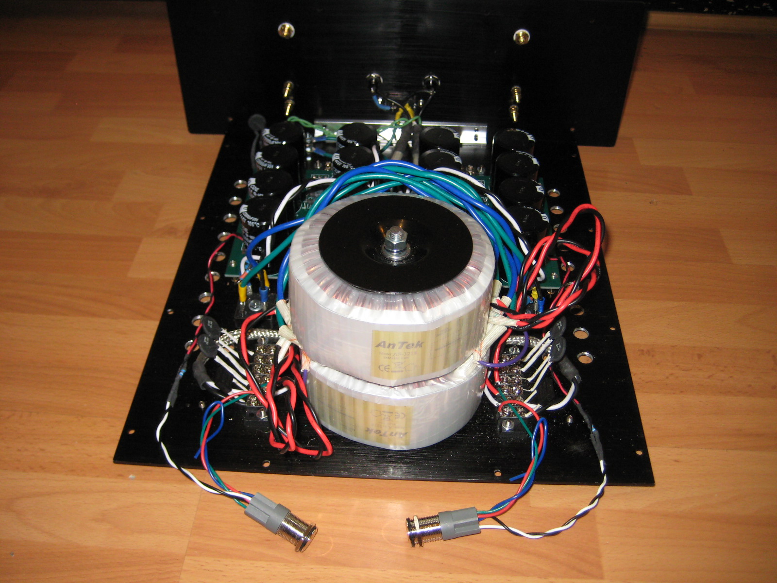

I purchased a WA68 chassis from an AliExpress merchant for my SissySit.
Buy wa68 and get free shipping on AliExpress.com
It says free shipping, but not true.
The chassis is big enough to stack two Antek AS-3218 transformers for dual mono. The internal dimensions are 330mm wide x 400mm deep x 144mm high. The top cover plate has cooling slots but the bottom plate does not. The back plate does not have any holes for any connectors.
I drilled and cut my own holes for RCA. speaker, fuse, and IEC connectors. I also drilled air holes in the bottom plate for cooling, and holes in the front panel for two power switches.
I had previously purchase two amplifier chassis and one preamp chassis from AliExpress mechants with DHL courier shipping, all with no problems. However with this purchase, I had paid for DHL courier shipping and the mechant, Hengfeng Audio Store, did not ship it by DHL. In the end it took nearly six weeks for shipping. All of my previous purchases were shipped DHL and were in my hands approximately two weeks after ordering. It usually took about a week or so for the package to be received by DHL and then only two to three days for shipping from China to Vancouver.
So this last shipment was a bit of a problem, but the chassis itself is to my expectations. This merchant's price at the time was considerably lower than his competitors, so I suppose that was the reason he did not ship it with DHL. At least I ordered it way before I needed it so it did not slow me down.
One thing though, Chinese New Year is next week so there may be some delay before shipments are made.
Here is a picture of the my SissySit in progress:
