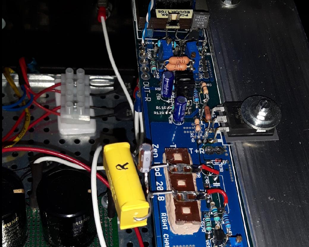

but at least I think I have identified the problem - no 5V to power the HALL effect chips , looks well soldered and the correct orientation, so I will have to explore a little more.
The offset cannot be zeroed but I can get it down to 300mV, the bias settles at 2.6A, the 2K Iq pot has no effect which makes sense given that the opto has no voltage to work with - I measure -0.9V and -.5V at pins 3 and 4.
Both rails at approximately 24 - positive rail looks like it is pulling down a little more than negative rail
I only left it on long enough to do some troubleshooting , very odd that both channels are behaving the same ( although not tested this time - only tested right channel )
..dB
you see what's happening when you are raping pcb with connectors not meant to be mounted here ?
I don't now which of traces you broke , but see - have you positive rail reaching 7805 (most likely you have) , does 7805 is having 5V out .......
in fact , first check is there continuity between 7805 out and Hall, pin 8

While troubleshooting the right board, I tested the left - it again has no ability to lower Iq but voltage across 0R1 comes up at 150mV with 200mV offset and slowly drifts up to 200mV. I can easily zero offset which remains at +- 1mV and the gate voltage measured at the 100R gate resistor is -4 for the SIT and -4.2 for IRFP9240.
Just giving the right board another piece by piece review and then will assess it. I "think" it might be a poor via contact - lower trace did not appear continuous with upper trace and I had not flooded the solder through the board - now corrected.

so , you're saying that you can set Iq to 2A (but no less) and you can set DC offset ?
obviously you have specific pair of outputs ....... 200mV is on the verge of voltage window for opto-bjt I tested for
so - either looking for mosfet with greater Ugs , or slightly increasing one or both resistors from rails to opto-bjt (R16,R17)
or just leave it on 2A , fine with me
the right channel now appears to be working too - gate voltages of -3.2 V and the HALL chip is seeing 5V
BUT - still same behavior - starts up at 1.5A and slowly ramps up - this side gets to 2.6A and I cannot s=zero offset completely.
@ZM - how much would you recommend increasing R16/17 ? take them up to 3K2 or even higher?

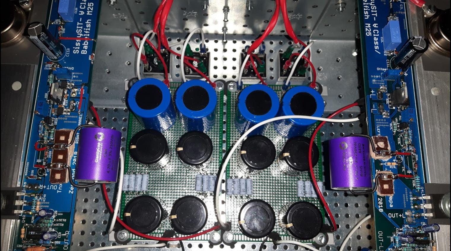

since the Sissy is really an amp that sounds wonderful I decided to refine his qualities. I thought of placing in key points of the circuit where the signal passes some valuable component.
I added the components one at a time to understand how much weight they had in the final result.
then R1 = Vishay z-foil (TX2575), R2 = Caddock MK132, R20 R21 R-flying = Dale RN55.
But the biggest impact on sound was the comparison between capacitors. I was intrigued by ZenMod's suggestion to adopt the old Philips MKC in polycarbonate in parallel to the Silmic II ...... and as I had a pair of 4.7uF Clarity Cap CSA I put them in competition.
having listened carefully to the coupled Silmic + MKC he won tremendously. I invite everyone to try ..... I think nobody will repent.
I am very satisfied at this point .... great sound 😀

........ or slightly increasing one or both resistors from rails to opto-bjt (R16,R17)
of course that I made a typo - I meant R18 and R19
I would try to increase them both (if you can center DC offset with standard values) to first standard value
so - 43 to 47K , 36 to 39K
for test , lifting one leg and putting 4K7 in series (to each( will do the job
what are Ugs values of outputs in that other channel?
