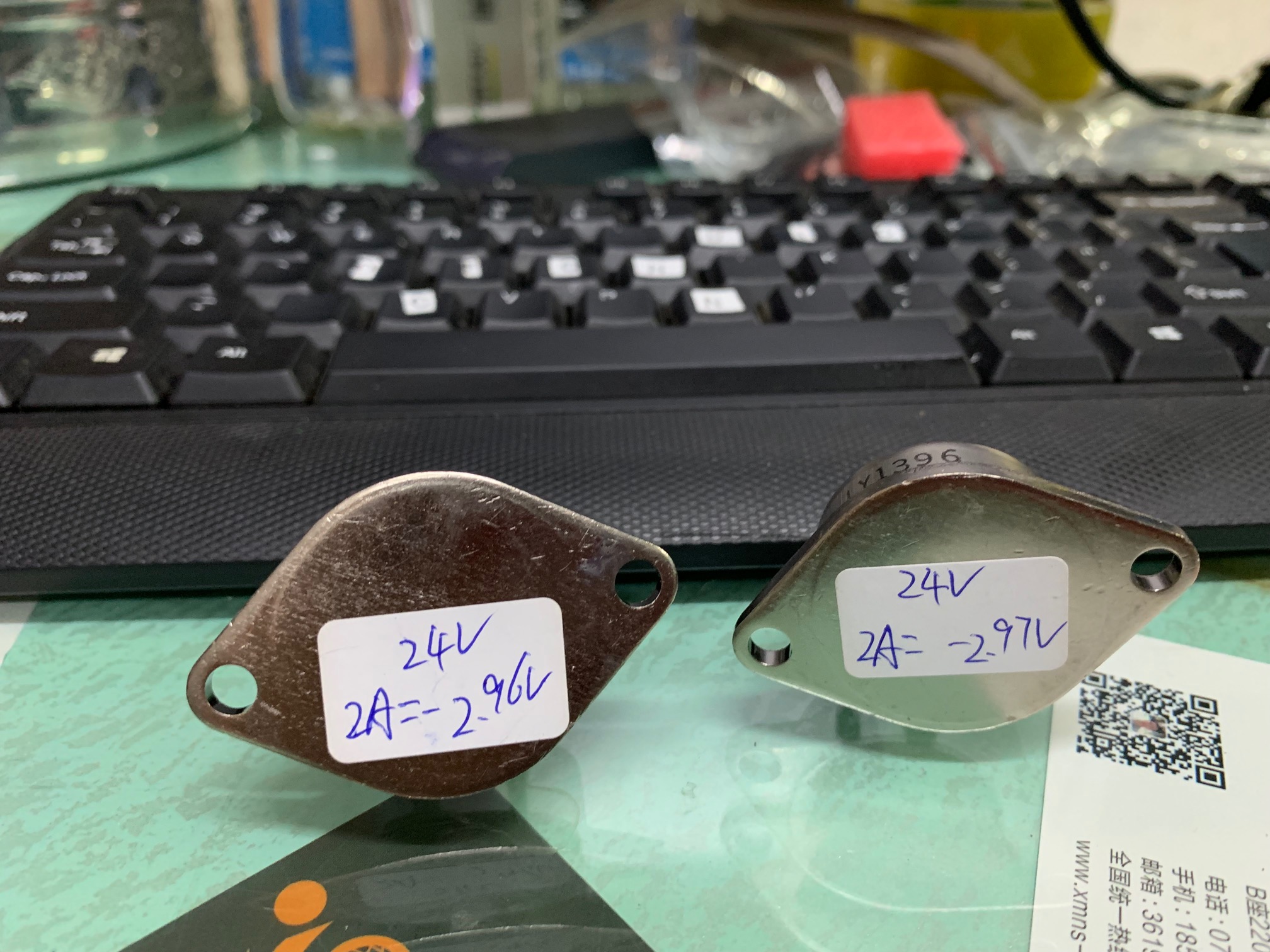

Just got pics of 2.96 and 2.97 Sits. Thanks much! These are NOS, correct?
Thanks again,
Russellc
