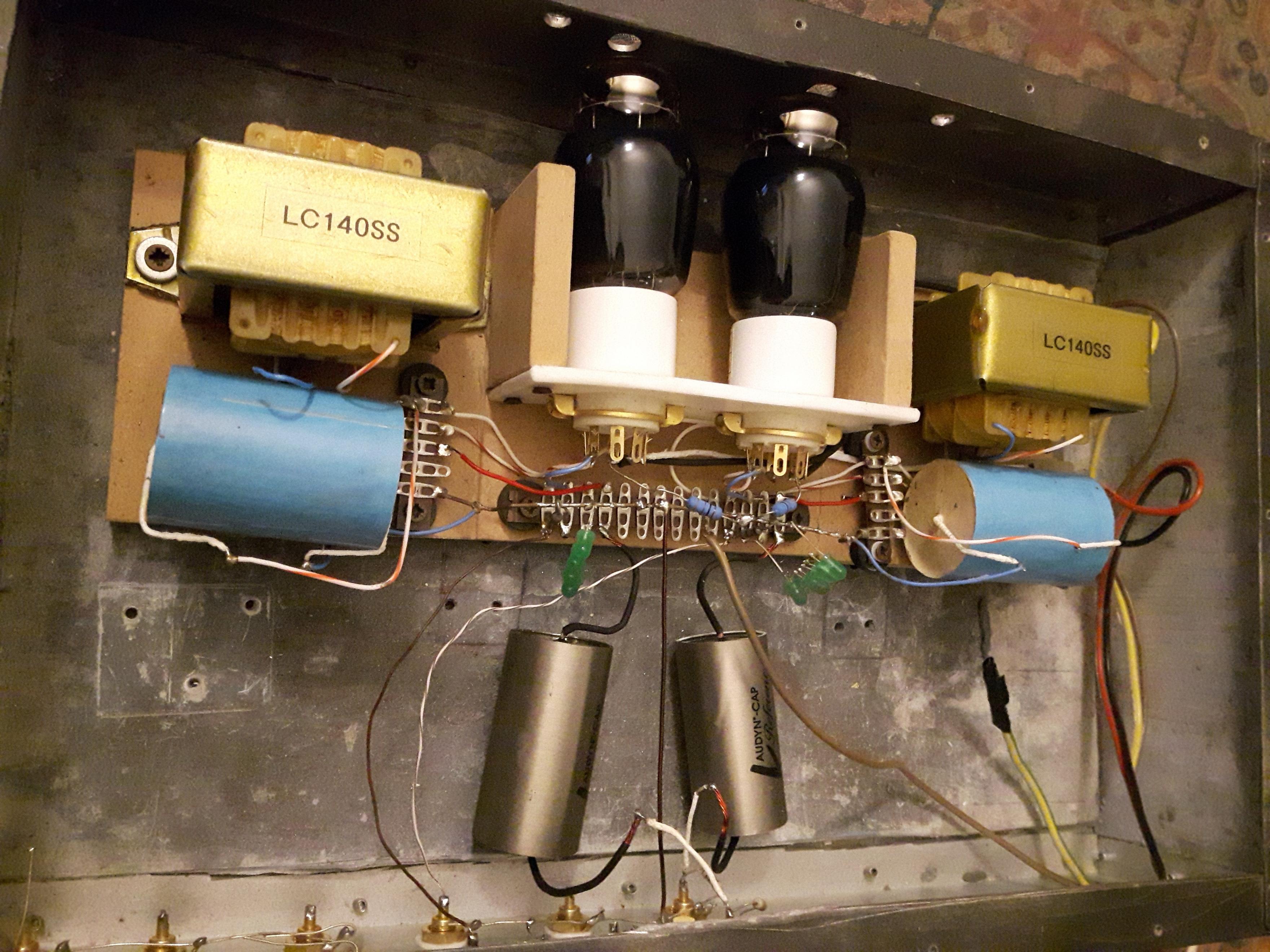

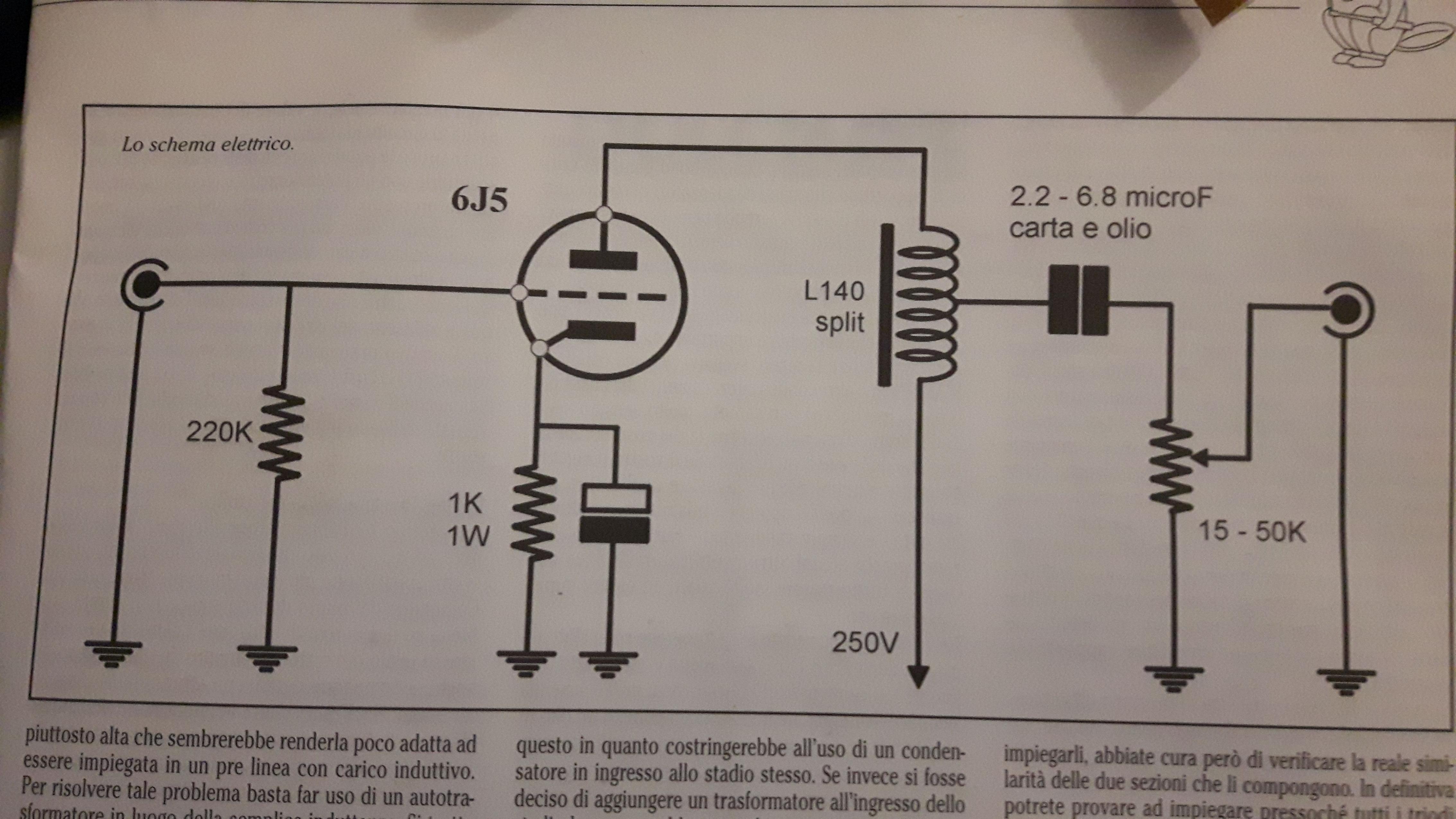

Simple common cathode.
Plate loaded by an autotransformer with 50% output. Built by Ciro Marzio (the author of Euridice preamp).
the fixed polarization in my case is obtained with a series of green leds (preferred to simple R and also to R + cap)
the tubes are the Treasure I talked about mounted on Teflon sheet.
the filaments are in AC in series at 12V. In input i use the Lightspeed as attenuator
Power supply is obtained with 5Y3 + CLC. All caps are made on polypropylene motorun. No electrolyte.

instead of LEDs in cathode , try 1K not bypassed with cap
that way you'll have lower feedback
if you have enough voltage from source , it's easy making cathode follower with same parts
I hope you're not using Lightspeed on output of that preamp ........ it is better having attenuator in front of it

Cathode Follower ..... mmmhh ..... I hate them.
The R on the cathode .... certainly lowers the gain but I do not think significantly .... but I try.

Agreed to both. ZM may disagree with my suggestion, but bascally I see 2 options that will minimally alter the sonic signature of your system:...Cathode Follower ..... mmmhh ..... I hate them.
- Add another LC140SS (you need a pair for stereo) in series with existing autoformer to make 4:1 ratio for minimal change of sonic signature (you will have noticeably more low end extension and a touch more high).
- Replace the autoformer with single ended to Line output Transformer. Something like the Lundahl LL1660 or a special order LL1680 gapped for 10 ma. A bit more change to sonic signature and output coupling capacitors are no longer needed (there is an option to retain them but I think you will prefer going without). This way you have the advantage of different ratios to choose from and galvanic isolation that usually has less noise and hum.
nothing to disagree with - both clean solutions ...... not attenuation but transformation
