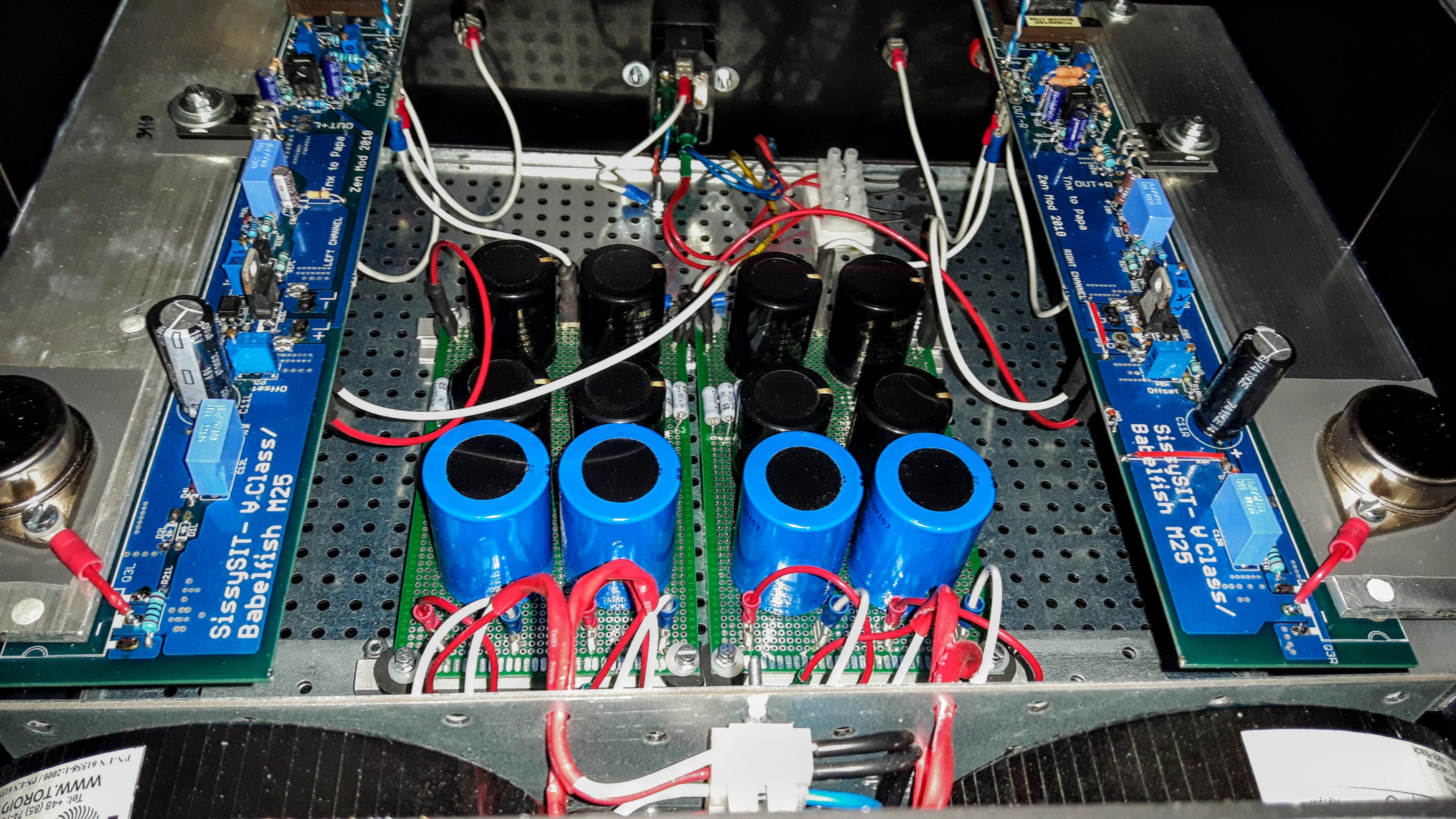

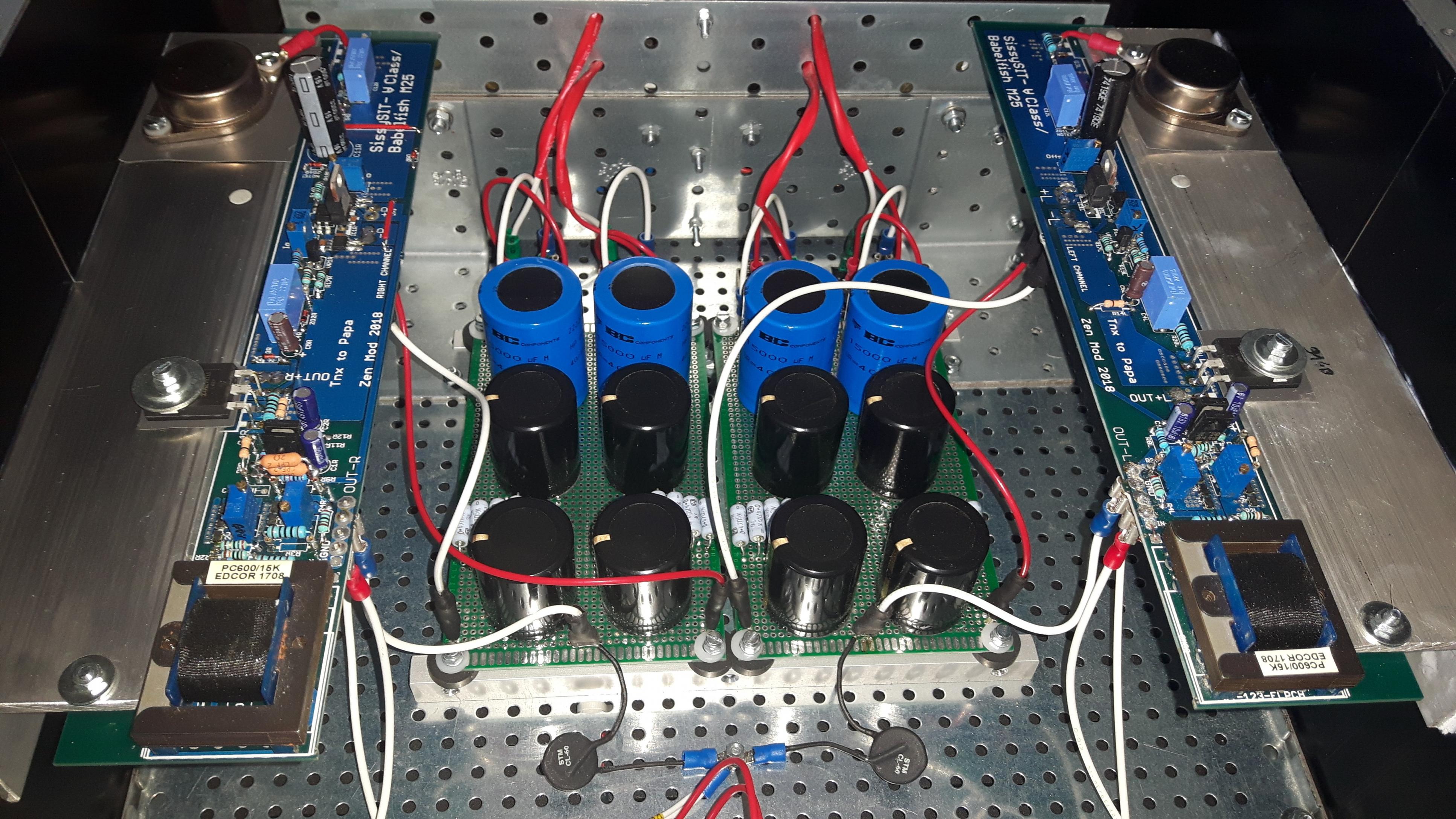

I completed the construction of the SissySIT. Basically I did a dual mono in one case. trafos Toroidy 300VA (18v x2 sec.). Power supply with caps BC Vishay and Mundorf AG. Mosfet IRFP9140 and SIT SK180. Wiring with Teflon-coated 16AWG cables. Only problem when I ran the bias was that R8 of a channel strangely had a completely wrong value (150K instead of 1 ohm .... I have no explanation: I had 4 all wrapped together .... the wrong one is the only one that does not I tested with DMM) .... and clearly I had to replace it. after which everything is regular, offset included both in out and on the Jfet.
interstadio trafo with Edcor 600 / 15K.
The listening test left me extremely surprised by the very high quality of reproduction .... I think it's the best amp that I have passed through my hands. My previous reference was an OTL (with 6C33) in the Circlotron configuration built 15 years ago.
All my admiration for the work of ZenMod .... I received a great gift with this SissySIT. Building it has been relatively challenging but the result is seriously beyond my expectations.
I had also built the MOFO .... a nice amp. But with Sissy you definitely enter another world. I did not expect
