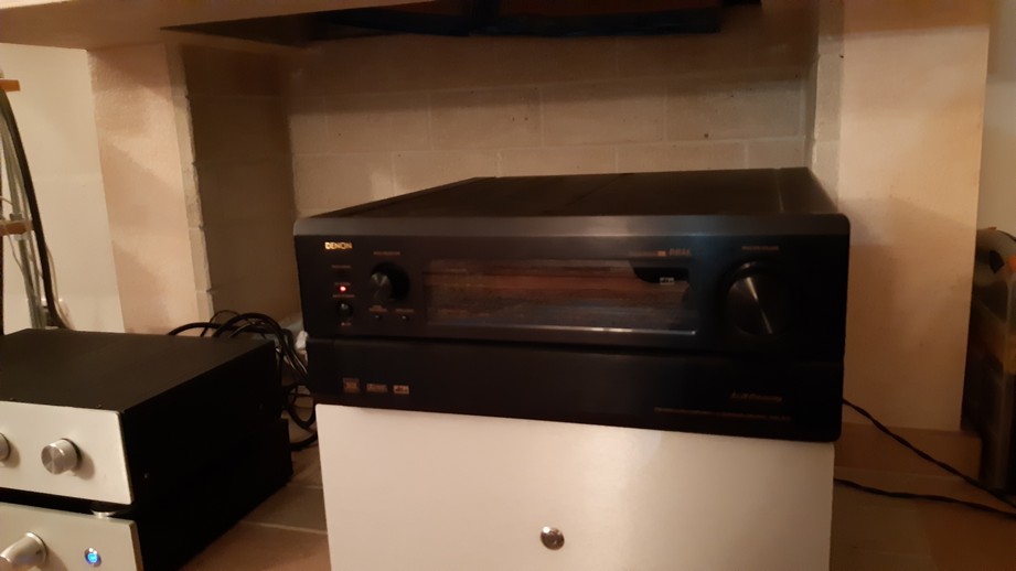

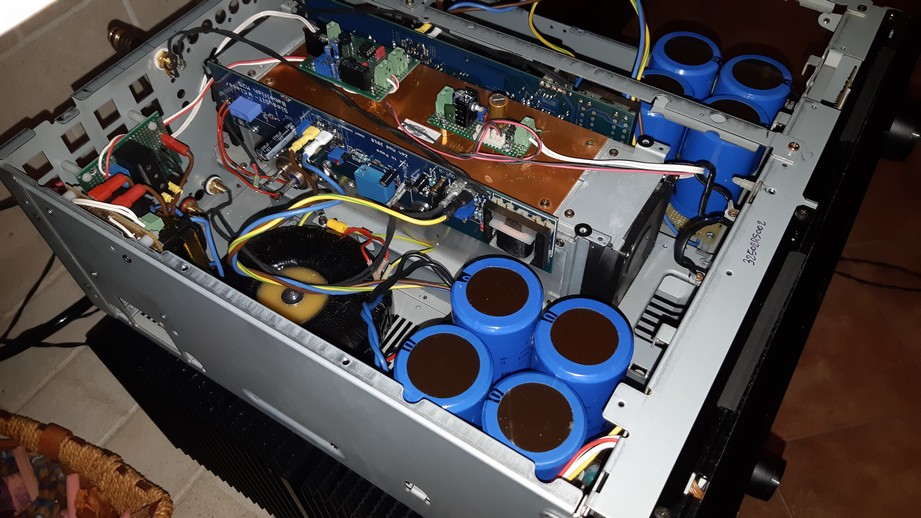

Here is a new son of Zen Mode ...
After some problems for having mistaken the value of a resistor, this other sissysit is finally born. He found a house inside a container of a Denon hometheater that has a nice forced ventilation tunnel for cooling. Almost immediately after adjusting bias and offset, I could not resist and I connected the sissysit instead of my turbo f5 with my IPL S2TLK CD3.0 Ribbon, The source is liquid music with a system based on double pc, HQ player and a Dac based on the jlsounds board, pcm1704 that have as output stage the R1 from Ruggero Sanna (https://up.nexthardware.com/user_images/25508/383/pre_fet_2sk170_ver3.jpg). The tube preamplifier is based on the CAT sl1 schematics. For now I cook it but in the first impression it immediately showed a beautiful soundstage and a chubby and less bright sound of the F5 V2 Turbo, excellent dynamics and energy.
For the father, Zen Mod: A big thank you for these cards that I received together with my friend Sontero (Giovanni)! I thought to replace C5 and C4 with a quality polypropylene capacitor, how many uf can be enough? Thanks to everyone ....😀

well , whatever amount of money you can throw on , it's hard to beat combination of Elna Silmic bypassed with Philips MKC (polycarbonate)
several times confirmed ......
however - be my guest , change with any solid cap , but do not use less than 3u3
