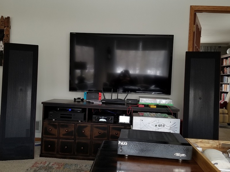

Thought I would share a few pictures
My Sissy SIT closed up but not yet finished - needs anodized or painted, not sure yet
The trigger to start the amp
Back panel
Internal rail leds for my peace of mind
and because i had to be around to watch the multimeters while I cooked the amp for many hours today - offset stabilizes after about 45 min
Norwood daughter board for the M2X
Muses volume control for the B1 nutube pre
Candy anyone? 😀

very nice db ..... tells of the first impressions of listening
+1
Do I spy an Austin daughter board in the candy jar?
very synthetic 🙂..... but that's what I would say too😀one word "spooky"
the speakers ?..... look like magnepan
yes, the sense of layering and spatial projection is eerie
they are Maggies - .7i , my OBs are in the "shop" (aka basement) for some crossover tweaking but I like these Maggies very much

after about 6 hours left channel dc drifted up beyond ability to zero - so will make some minor adjustments, sound is truly whacko !!
gremlins are in that amp of yours
pretty much sole one not being settable as intended to be
let me do this last stint of shipping ( doing smd thingies and preparing packing these days) so we can figure out how to solve your for good
gremlins indeed - I have looked ( and looked .... ) replaced the VR1 and the opto but not not the current sensing chip = everything seems to work aside from being able to reduce the current - I can increase it mooocho but stopped at 3A because I was just testing to see if it adjusted. I have all the critical resistors on sockets so that I can change out values to get it in operating zone
BUT it works and sounds fantastic even if it runs a little hot
If I was sure that it was a mistake on the board, I would buy another set but I have a sneaky feeling it is the VGS of the SIT ( or FET ). I appreciate your willingness to think about it , I know there is much to do ( always ) especially with those crazy new boxes you scrounged up 😀
