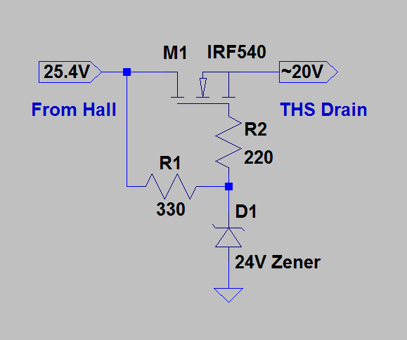

25.4v loaded at 2.5A is pretty high. If the THS you have are high mu, lowering supply voltage using a variac or a series resistor will allow you to set Iq to lower value. If my suspicion is verified then you have 2 options, use reduced supply voltage or use more suitable pair of THS.
Sorry to be thick, how does one know if they have high my SITs? Only parameter I know is that mine from Prass say 2.96 and 2.97 and I don't want to fry them!

Sorry to be thick, how does one know if they have high my SITs? Only parameter I know is that mine from Prass say 2.96 and 2.97 and I don't want to fry them!...
You'll need a curve tracer for that. But don't worry, use 22-23V supply and adequate heatsink, you won't fry them, they are tough beasts. Regulated supply is recommended for SITs when line voltage supply varies more than 5% or if you try to push things close to the limit.
well reducing the rail voltage does reduce the current - not unexpected BUT the control circuit is still not working , so I am not convinced replacing the SITs will solve the problem in my amp .
There must be something simple I am not understanding , the Iq potentiometer has the ability to increase the current , so logic tells me reducing R15 should reduce the current to enable the pot to increase it once again - but this is not the behaviour I saw previously.
I may end up burning some heat in series resistors to drop the rails to 20V which is what it takes to get 1.8A flowing.

There must be something simple I am not understanding , the Iq potentiometer has the ability to increase the current , so logic tells me reducing R15 should reduce the current to enable the pot to increase it once again - but this is not the behaviour I saw previously...
Not when the output of opto is saturated. Measure opto output voltage between R21 & R20 (pin 3 & 4) to verify, if voltage is < 0.5V then opto output has saturated and no longer able to regulate Iq.
... I may end up burning some heat in series resistors to drop the rails to 20V which is what it takes to get 1.8A flowing. ...
When you are sure reducing rail voltage is the solution you want and since you have a 25.4V rail and only need to reduce supply to the THS, I would suggest a regulator instead. I think a cheap IRF540 or IRFP240 mounted on the heatsink will do the job nicely, off course bigger part has better thermal transfer property. Cut the leads between board and drain of THS and insert regulator so regulator is placed between the Hall chip and THS.

that's bad patch , not solving the problem
though , with rectifier etc. loaded , I'm expecting no more than Vac x 1.25
there are few volts more than that , how's that possible ?
only if donuts are 20Vac , not 18Vac
and one thing more is puzzling - how increasing both R18 and R19 is not working ?
