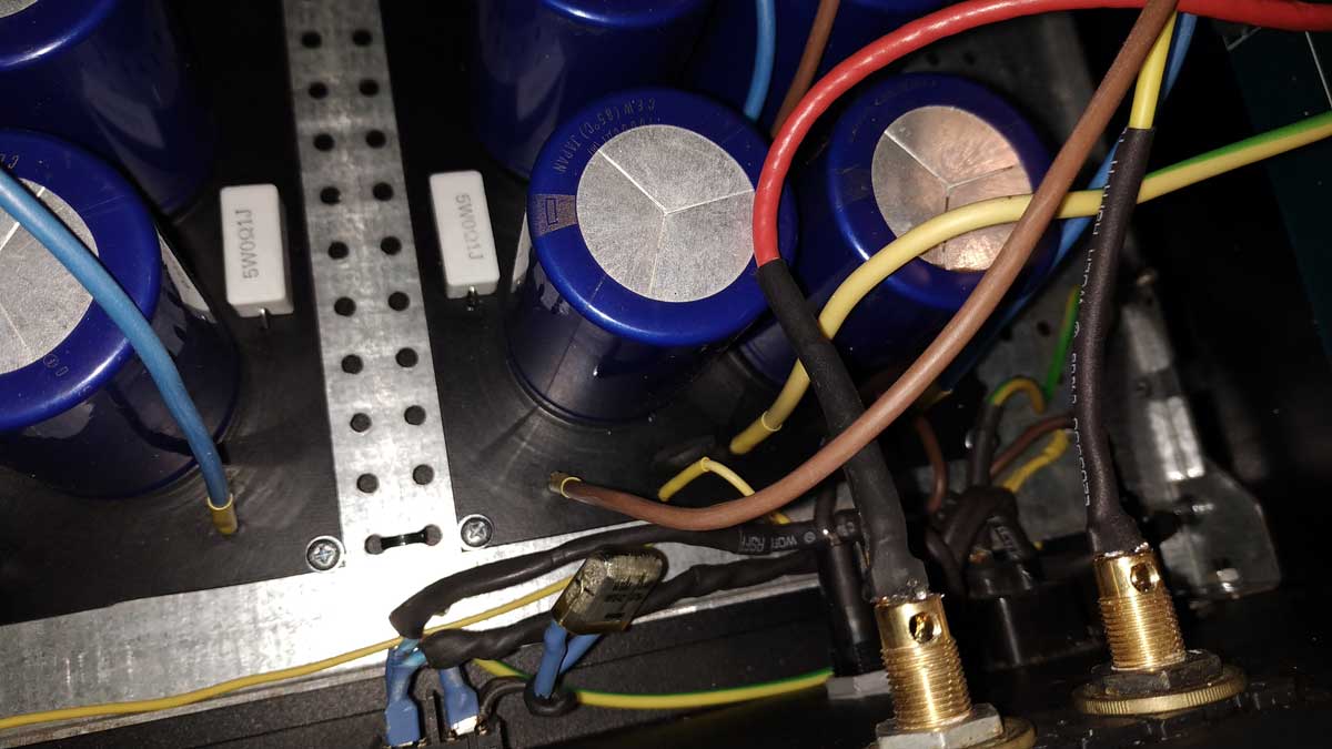

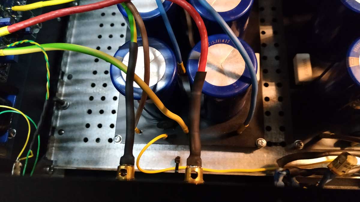

two more
to conclude ..... besides zero specimen , made on T-Bed on pcbs with strict FW form factor (same later used for Sissy Sit development) , this amp is third Convertite I did recently
