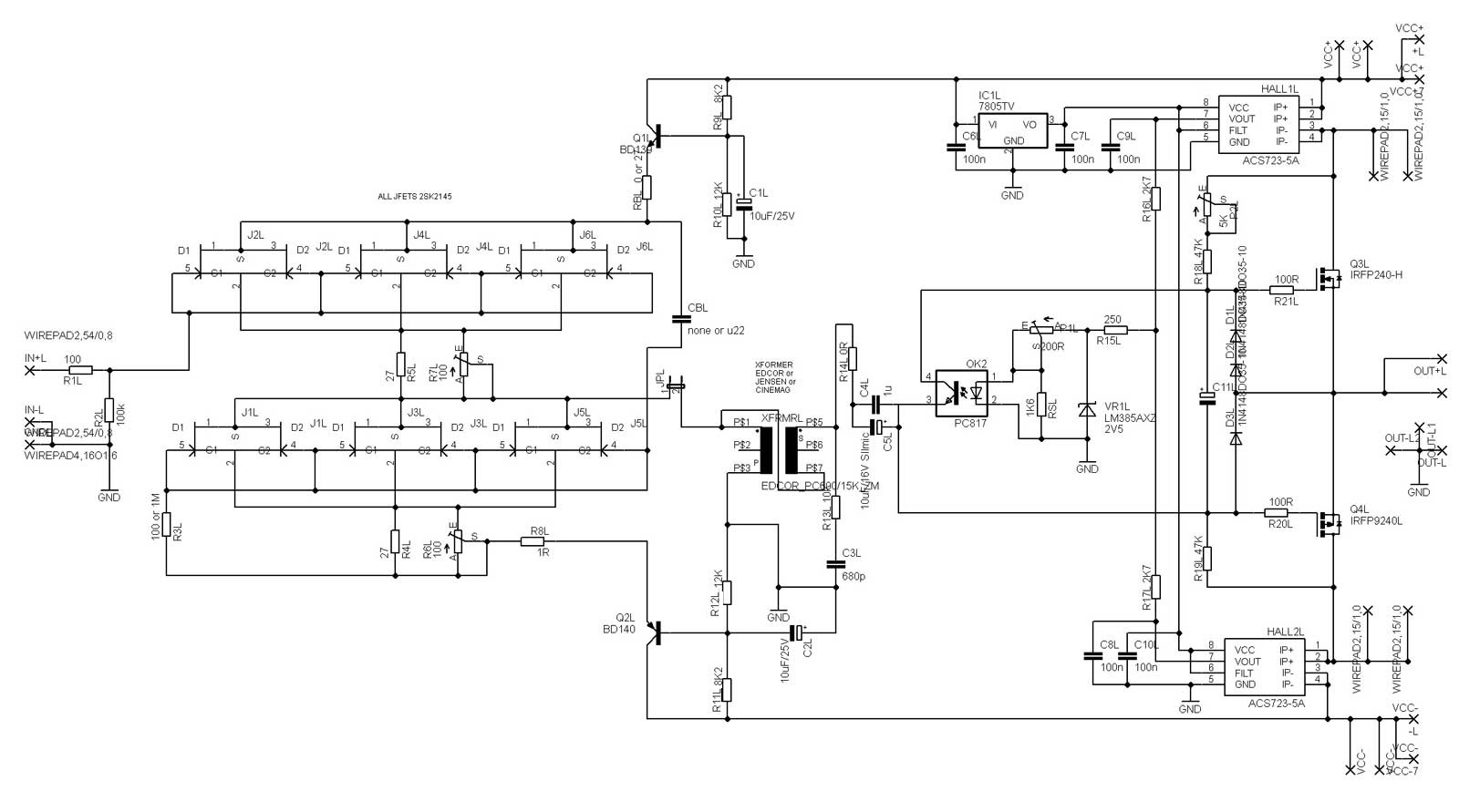

Few lines about intention of experiment:
1. to pursue possibilities of using small bug cased 2SK2145BL Toshiba JFets , of present production , instead of more and more rare Toshiba complementary oldies or always scarce LS JFets ........ in both usual SE configuration and in Papa Borbely's White Cathode Follower transpose in JFet realm ;
1. to make possible usage of Edcor , Jensen and Cinemag xformers of final user's choice ;
3.to pursue possibilities of current sensing in rails , to avoid source resistor in output , further allowing:
4. to pursue changes in OS current capabilities , allowed with unspoiled square law transfer characteristics of mosfets used , enabling significantly enlarged A class envelope (4 Ohms load - A class up to 40-ish Watts , then Klunk! up to 50W , 2 Ohm load -A class up to 20-ish Watts , then clunk up to Wattage you are brave enough to invoke ..... so less Klunk!!-ing in your sound ; also lower THD comparing to regular M2 .
So , 4 or more intentions realized , Mighty ZM fully satisfied .

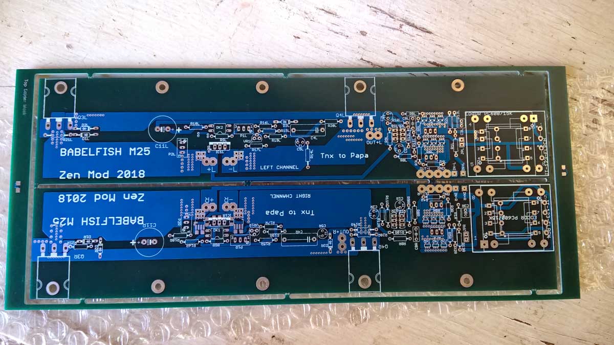

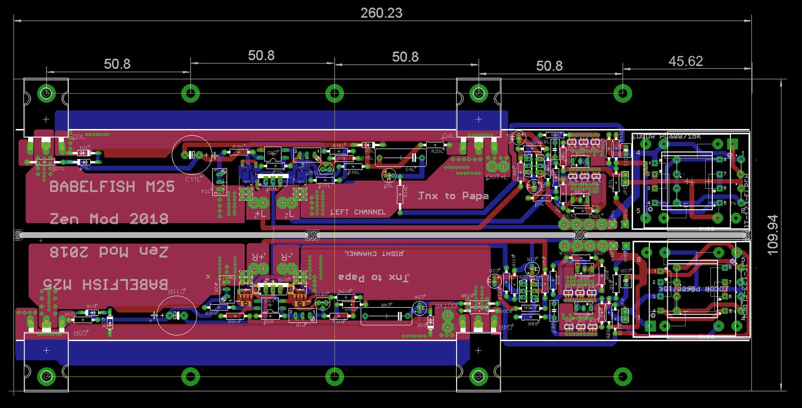

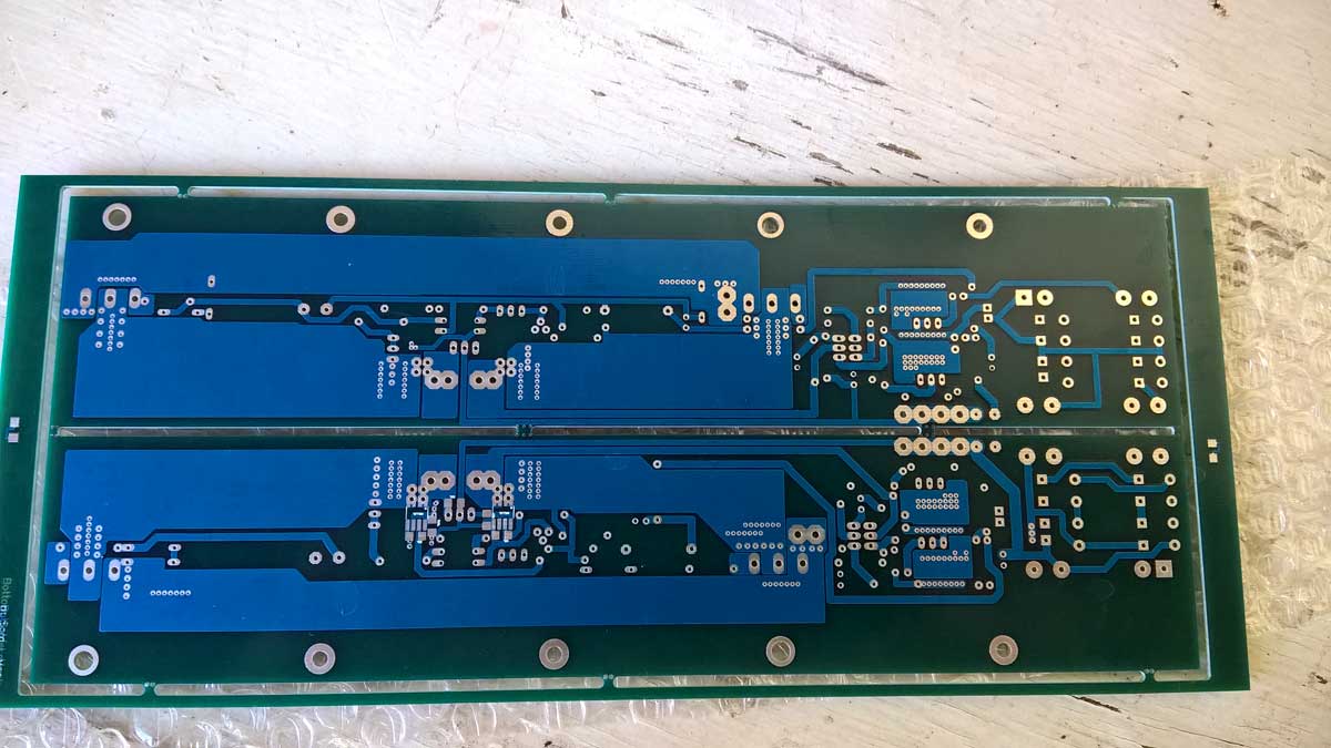

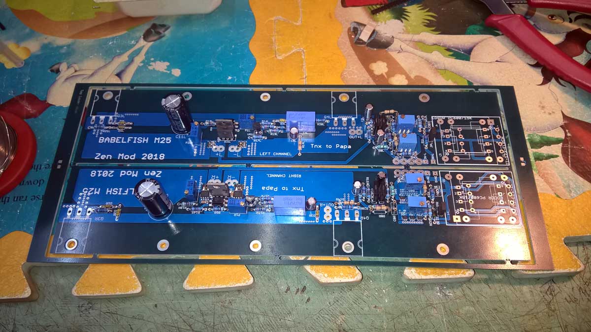

I'm not going to post sim schematic , instead of that I'm jumping ditto to Eagle schematic and resulting pcb patter screenshot
Disclaimer - Universal Whatnot Mounting Spec .... is for Sissies :clown:
I resorted for Papa's FW format ; I'll not gain any Cojones with that , but it's a sort of Kudos to SR Kitchen Table Enterprise , most probably ....... I just like that idea :)

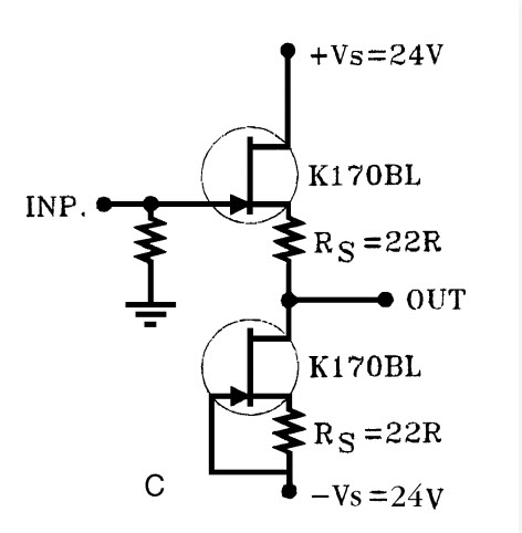

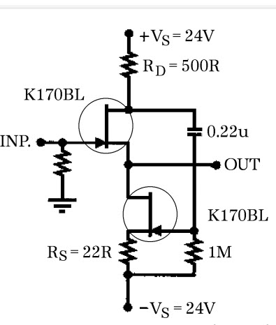

Input buffer comprised of bunch of 2SK2145BL , in form of same-sex JFets buffer , well known from .... dunno ;
attached two pictures , taken from PapaBorbely's JFet frontiers articles ;
first one example of same sex JFet buffer ; there I practically have 6 up , 6 down (2SK2145BL being dual JFet in sissy package) , where Iq is measly 21mA :)
yup , cascoded to some 12V or so at drains
Second pic is Papa Borbely's implementation of tube White Cascode in JFet world ; I took provision of parts needed on pcb , so I can use kosher same sex buffer , or try slightly different THD spectra , which WC is bringing on table ; mostly opposite phase of dominant 2nd , speaking of buffer only
Though , for my case , modulating resistor in upper drains is different value than shown in pic.

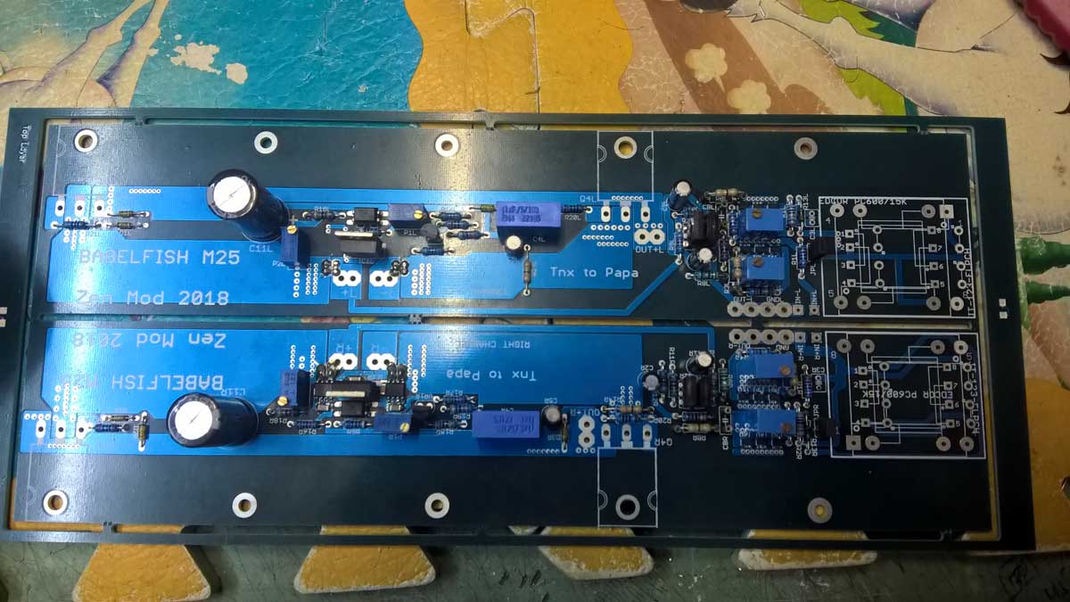

as you can see, even if hardly - it's crowded there , I decided to make possible use of 3 different types of xformer :
-same Edcor as used in original M2 ( and I did all protowork with that one)
-Jensen repeater ( is that one used in F6 ? lazy to check datasheets and type in this moment)
-Cinemag CMOQ4-LPC (also repeater) , same as Papa used in DEFiSIT ;
first one giving gain of 6V/V , two later ones giving gain of 4V/V ;
I'm pretty sure that Edcor is also having repeater coil in same form factor as their 600:15K , if one is to choose cheapest variant ; though , Edcors are cheap , but not bad , in any case.

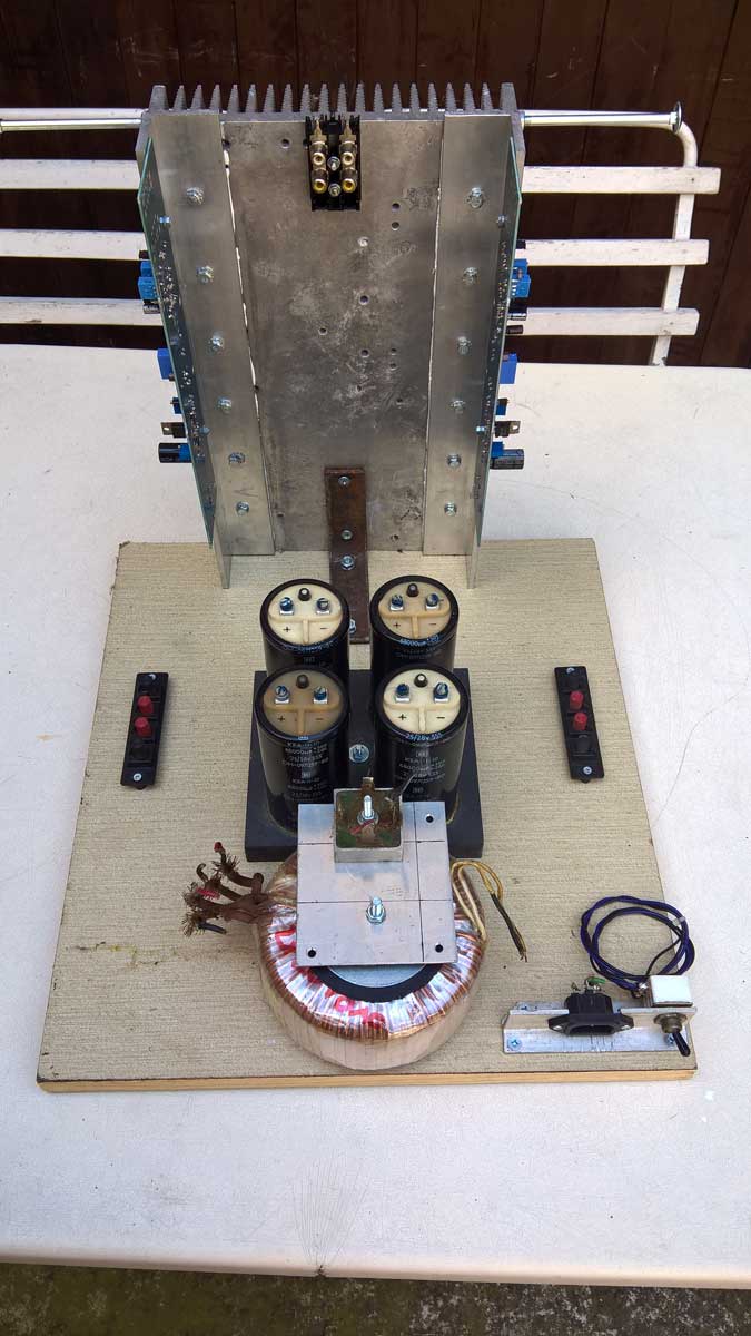

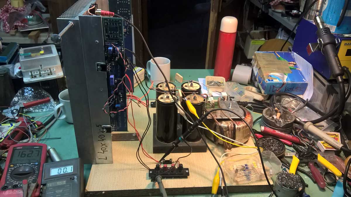

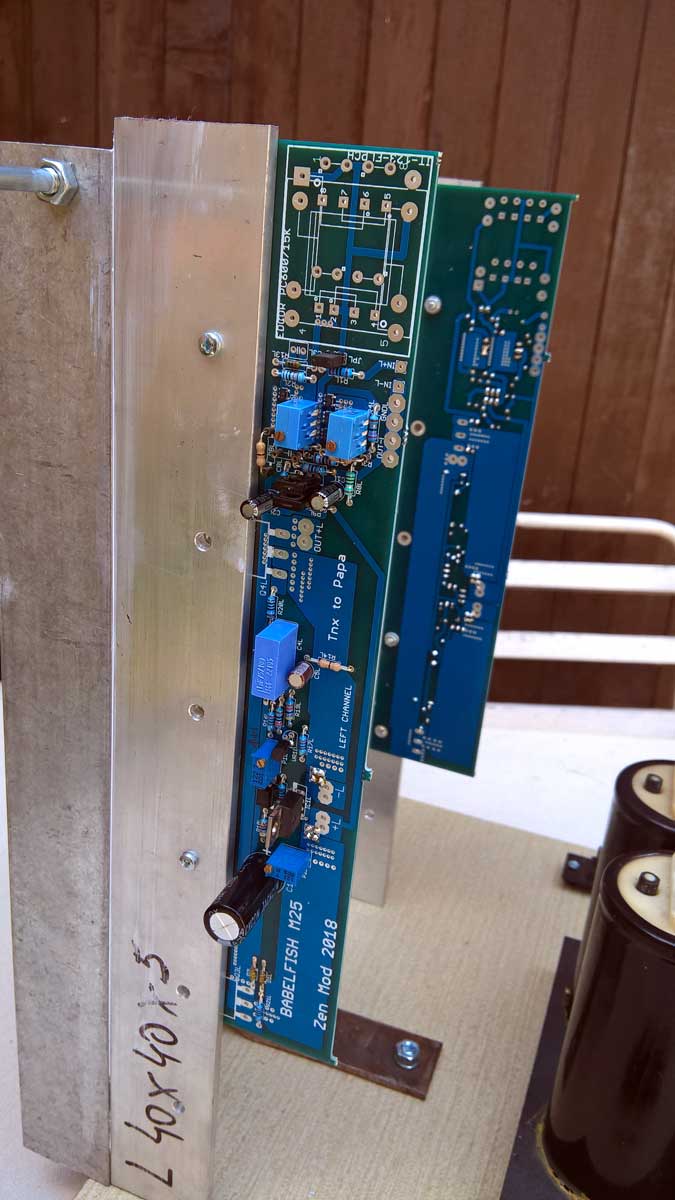

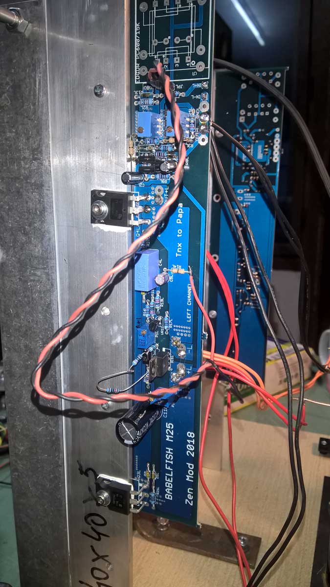

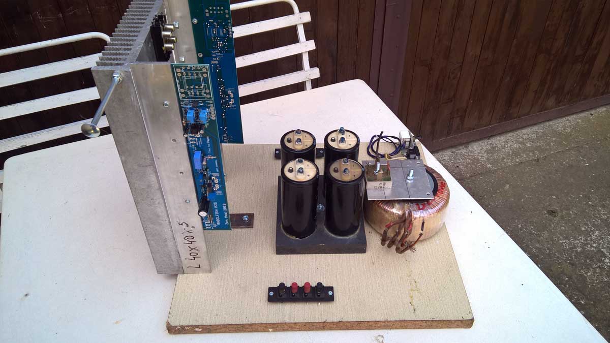

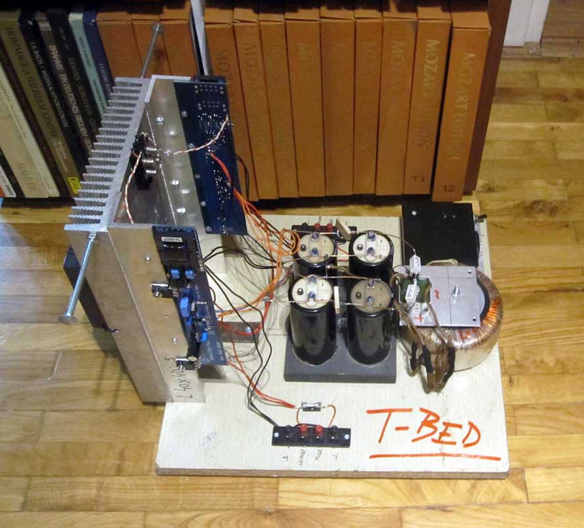

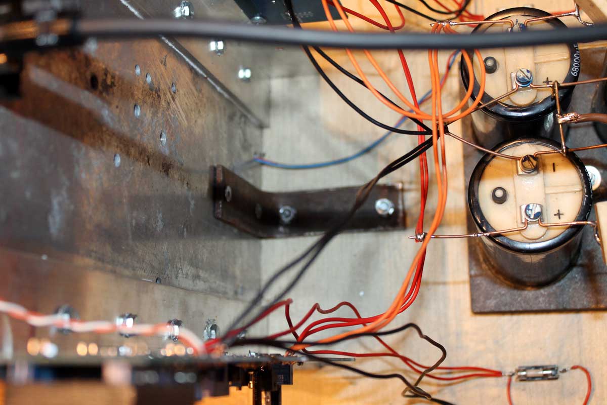

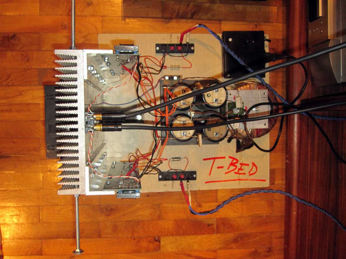

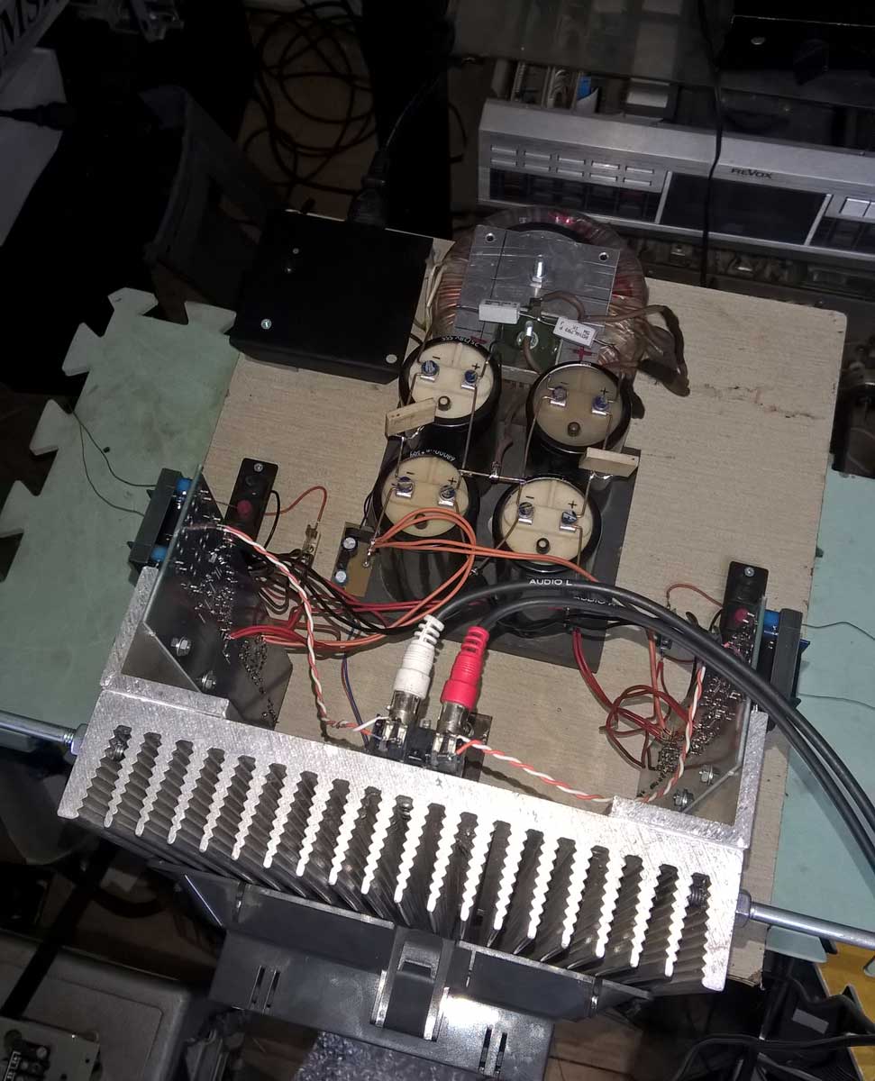

Then , to finally make long ago dreamed of - Test Bed ...... I'm so happy with new toy , that I even have a name for it - T-Bed :clown:
long screws situated at sides are good as handles and also as support , when you toss T-Bed on any side ...... no possibility to pinch or brake any part against the bench

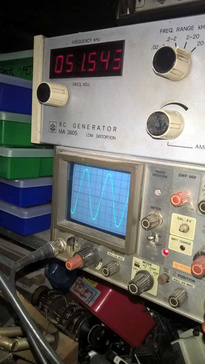

then later , time to divide boyz against the men ........ LTSpice and Back of Napkin Sissies against ....... just lucky ones ....... as I am :)
bench time ; observe direct feed from siggene to buffer then to output stage , sans xformer ; why wasting perfectly good and new Edcor on possibly not good shebang :rofl:

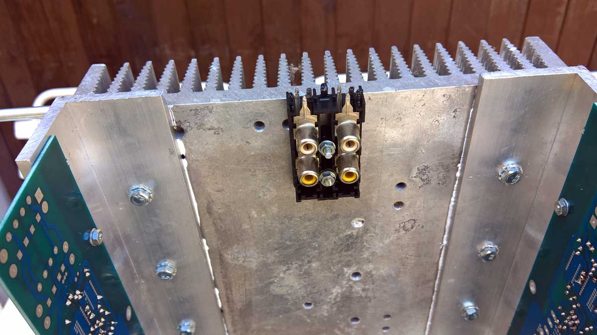

Official Court Jester
Joined 2003

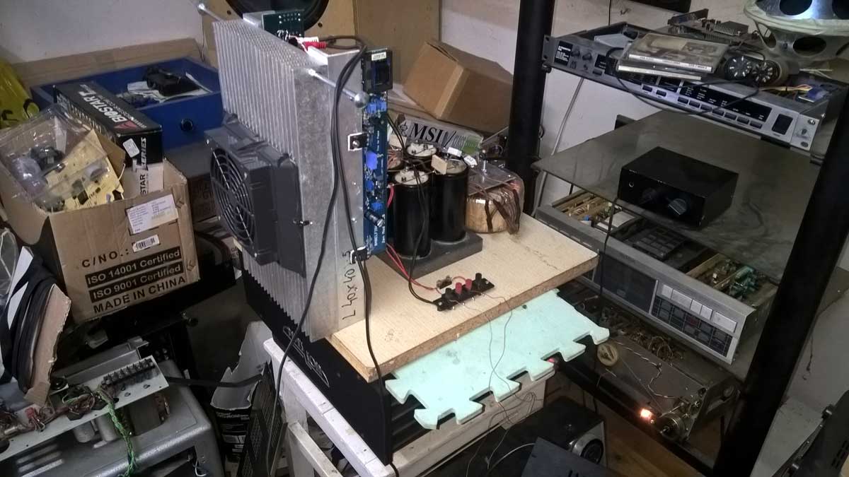

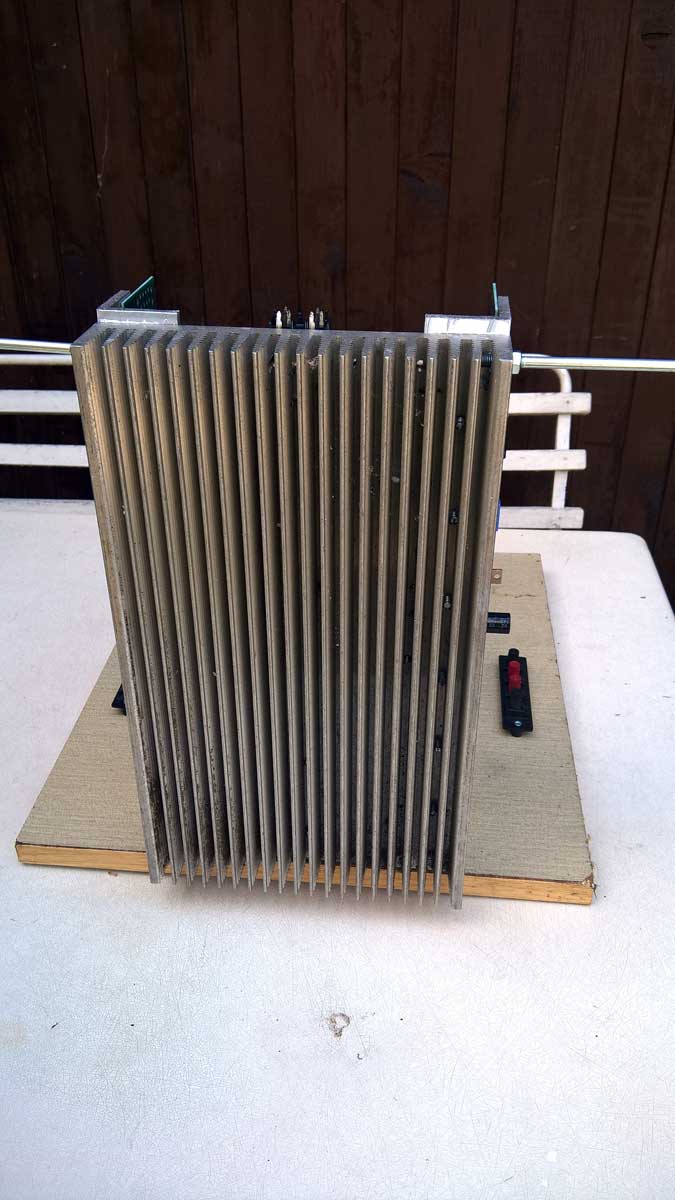

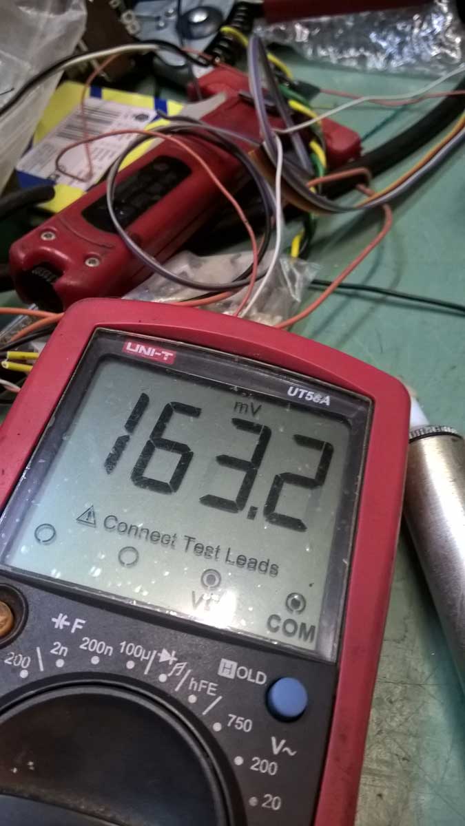

Next day , to solve few problems ........ naah , I can solve just one , lacking in not easy to drive speakers department
so , tossed 12cm fan , small 5+0V6+0V6 reg , and that's it
later I added switch to fan circ , just to ensure shorter warm up
rails are at healthy 25Vdc , Iq first set on inline 0R1 for each channel separately , later removed 0R1s , re-checked at 0R11 which are part of CRC in filter
yup - Iq is 1A7 , per channel ..... I don't wanna depend of some hypothetic square law ( I can't see it :rofl: ) , so better more than less
that resulting in nice for summer 25 x 2 x 1A7 x 2channels =170W of heat
heatsink with lazy fan at Papa's Crikey , it can cruse all day long
IR measuring gun-like thingie with red dot is at home .... who needs that , anyway

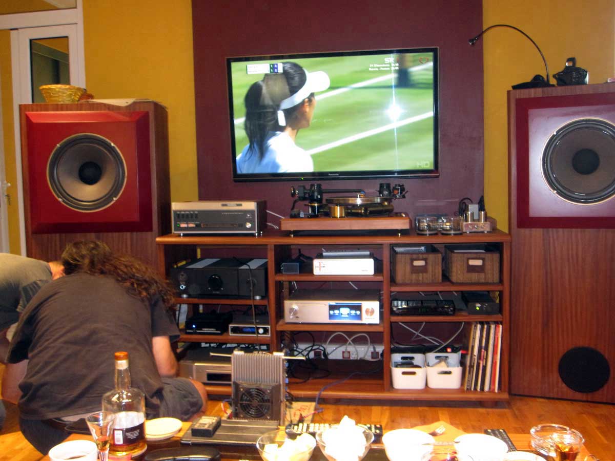

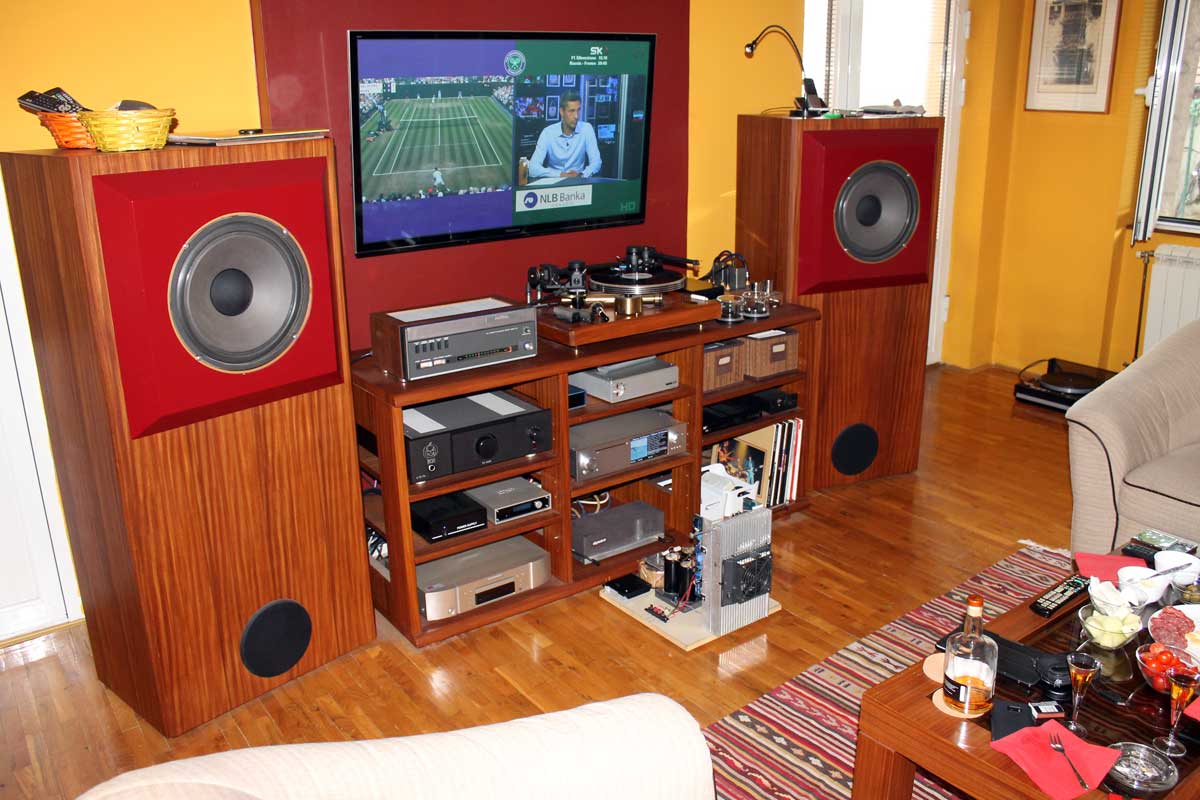

few days later , I had on mind solving/trying few things :
-trying it on some harder to drive spks
-solving problems I had with my THD Spectra measuring rig . I coudn't make it to work after putting "new" EMU1212 and giving old Audigy to friend .
I wanted and needed bal in/bal out , but from sme reason bloody thing is not working ; box with at least 4 various Audigy cards is simply impossible to find in all mass of boxes on zillion of shelves I made crowded in years .
EMU is simply having too much channels , so my brain can't cope with it ...... or ?
anyway , first problem first .... at least while I'm not having solution for second one ; I already posted few pics (in http://www.diyaudio.com/forums/pass-labs/314822-greedy-boy-defisit-papas-koans.html#post5244007) of listening session/having fun occasion , we had at my friend Woland's ......
He's having Poor Man's RCA speakers - Tann DC in Gorgeous and Voluptuous and Luxurious MLTL cabs , dreamed/constructed by ZM , MIghty , Who Else .
So - after painstakingly long warm up time ( I didn't had that fan switch at a time , nor brain to realize necessity of it) , Babelfish M25 finally came to sound ....... it singed dozen of tunes , without special excitement from anyone .......
Reason , later I reckoned - two reasons:
- they're all bloody hooked on Papamps , so nothing new there,
- bloody Tanns in MLTL are also easy to drive , so no shine for M25 Cojones
:rofl:

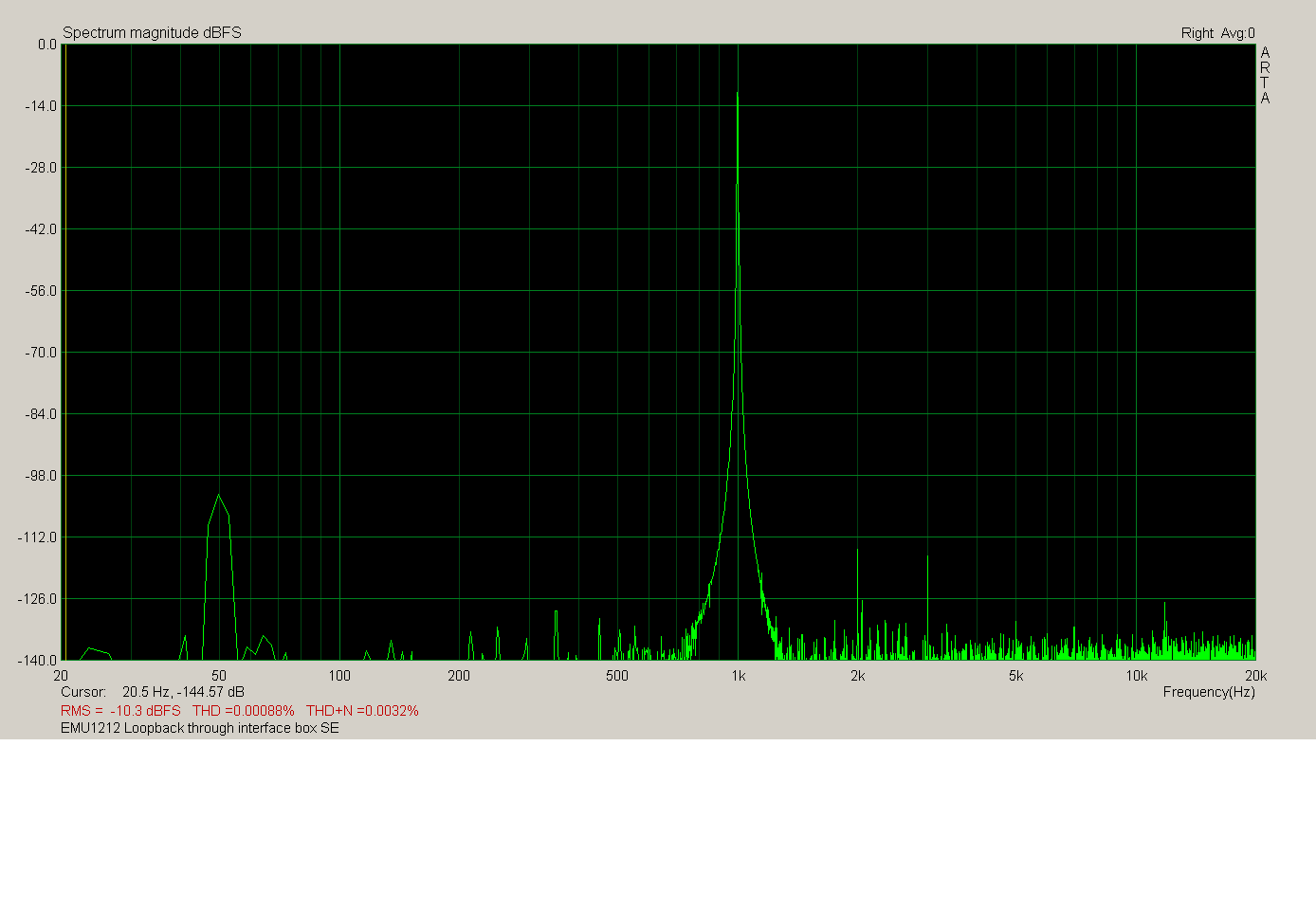

back to reality , day or two after

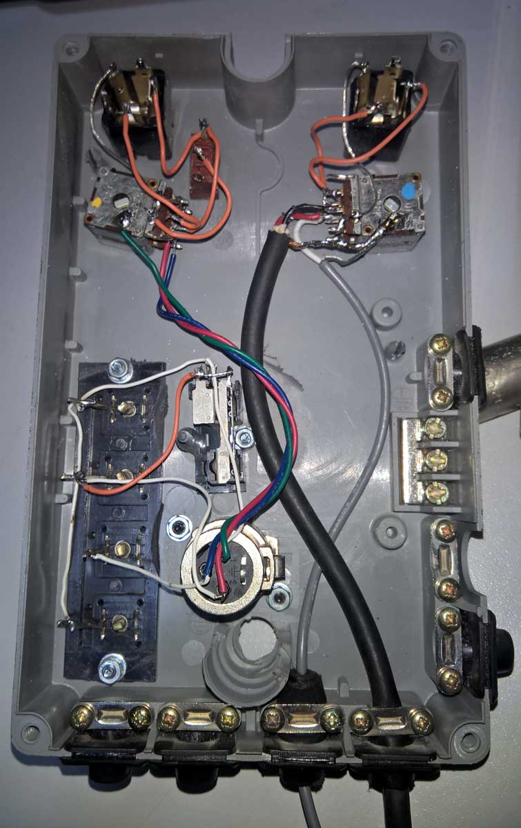

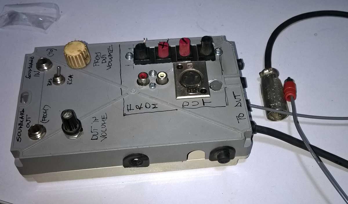

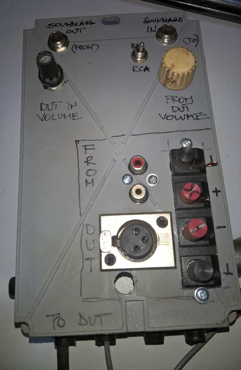

I found what's wrong with EMU - lack of brain combined with defective LCH output
switched to RCH output and all is well :)
of course that I made a mistake , while making new interface box wit bal in/bal out capability - I put it in plastic box .... forgetting that steel is better , esecially when dealing with lower level signals
one thing more to re-do
that time I'm going to put some protection zenners , at side looking back in sound card ; I don't need them , but who knows what's going to happen if I stumble on cable , while going on/from bench

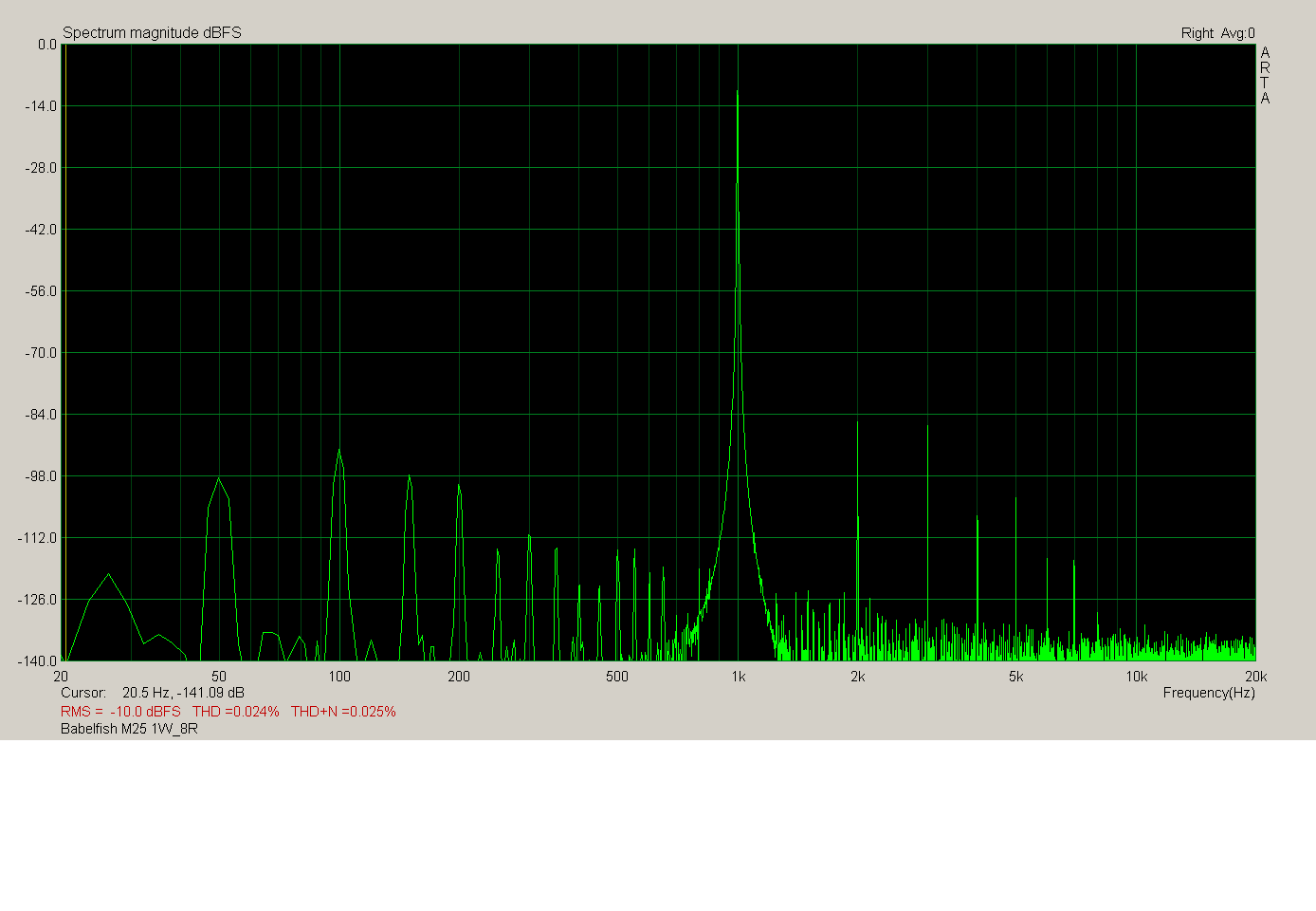

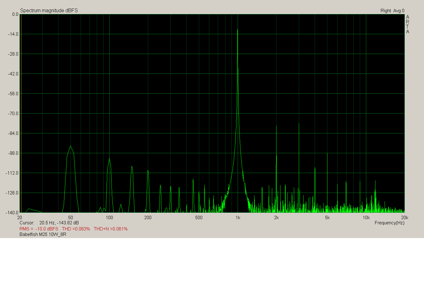

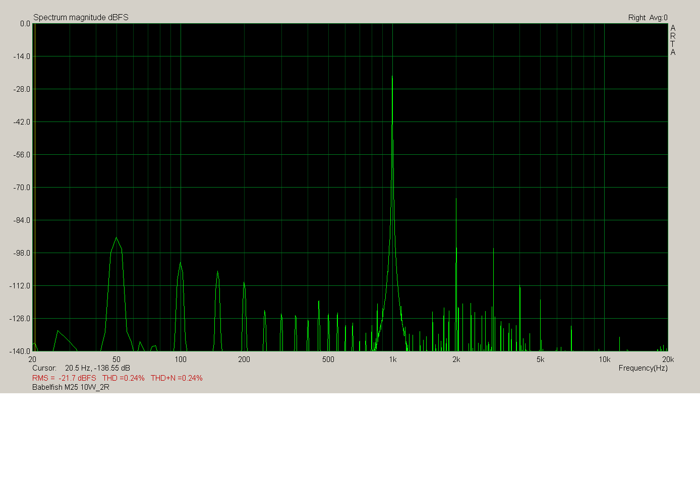

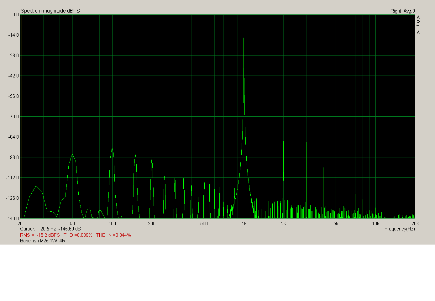

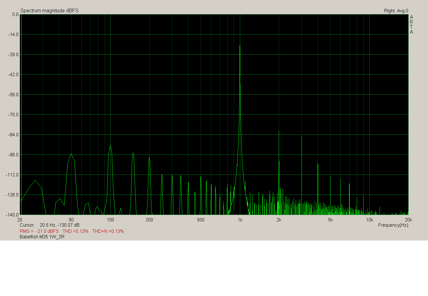

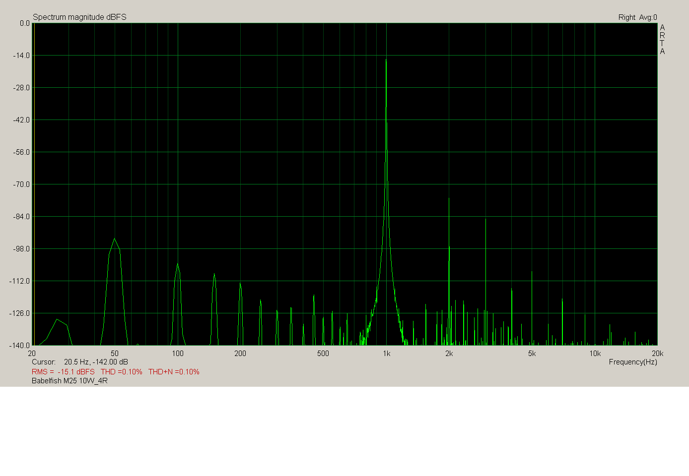

now , battery of tests at 1W
remember - crappy PSU (old caps - see that garbage left of 1K) , intentionally crappy wiring
due to lowish levels involved and my overall lazyness , I must accept sort of lower dBFS levels ....... don't know no one able to make me some decent gain stages with uber OP chips ..... :)
1W/8R (see - same figure as Papa's original M2 ..... easy load)
1W/4R
1W/2R

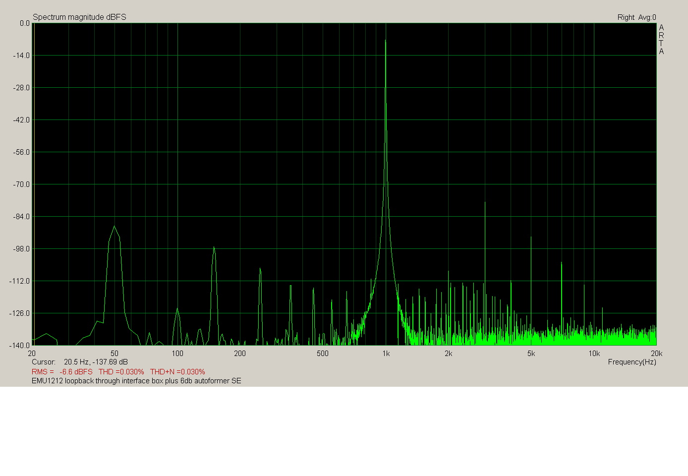

Joined 2003
I was thinking today - I'm really lazy to make superduper OP gain stage , to obtain 6db thingie , and put in between EMU output and interface box , to be able to get more watts for scope; I'm going to use precious Iskra repeater as autoformer , with 6db gain , and see what I'm going to get
I'm anyway more interested in comparison of THD on higer power levels than in absolute values
so , I tried exactly that : 6db gain autoformer ditto on EMU output , so you can see loop-back test is ........ Steel, ZM , Steeel!!!!! , almost joke
so - ignore again everything left of 1K , take rest with pinch of salt :clown:
