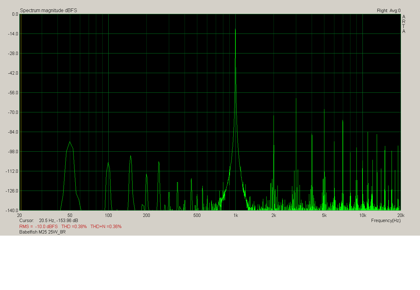

first 25W/8R
at that level (40Vpp) there is I think is some compression of sine crests , easily read in THD figure
remember crappy caps :rofl:
Papa sez 25W/8R @ 1% THD for regular M2

in any cse , simply observing THD behavior , I think it is safe saying that simulations are confirmed , bloody thing being in A class in this brackets:
25W/8R

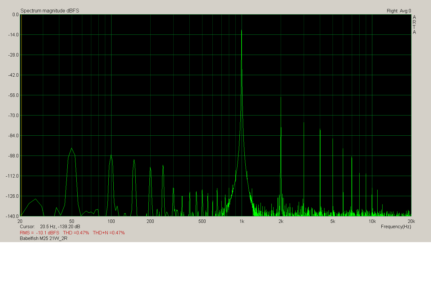

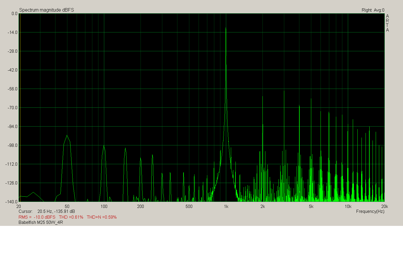

43W/4R
21W/2R
few watts up , or down .......

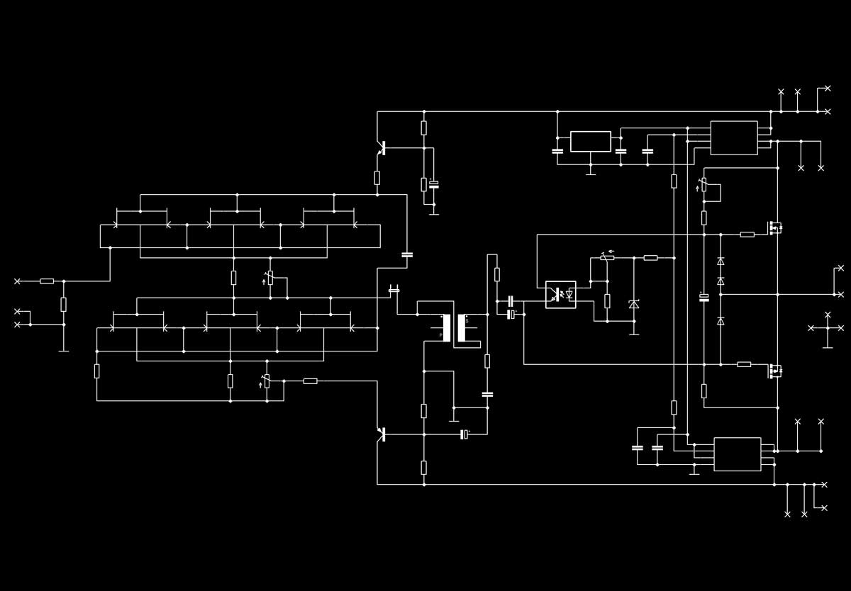

I'm super curious about the hall effect sensors. I'll need to get home and spend some time with some data sheets so I can get around that part of the circuit.
'bravo!' is in order though! Not everyday you get to create a new bias mechanism!
... did use 2SK170 model instead of 2SK2145 (half) , ...
Most similar model to 2SK2145 on standard jfet would be 2SK117. Compared to the K170/J74 complementary pair, the K117 SE buffer with ideal parts simulate to 33% lower H2 and 66% lower H3. I also did not see a CBL for WCF topology on the sim file. On a build however, phase of H2 will be dependent on parts selection.
As you said anyway, it's a trivial matter of reversing speaker polarity to confirm and choose desired connection. Have fun. 🙂
