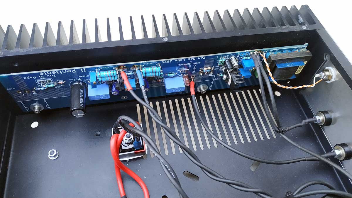

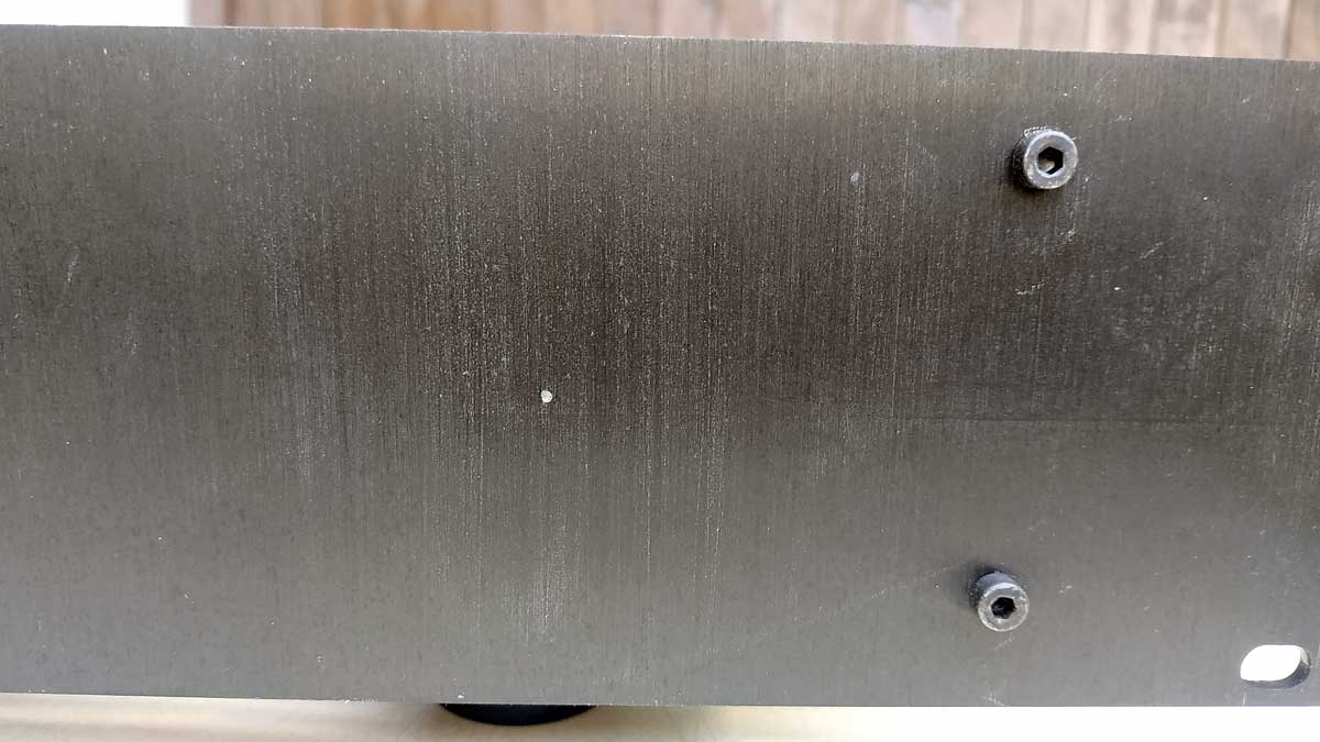

my Kido (sister's son), living in Miami - came first time after 4yrs, to see all of us in Old Country

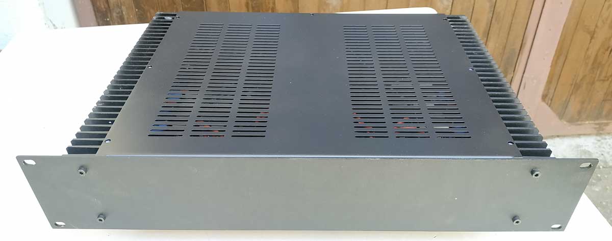

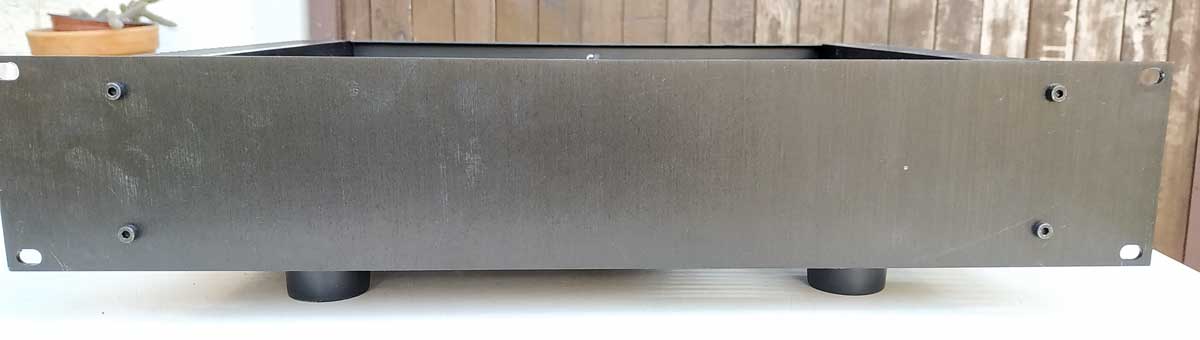

deal was - I'm going to make one smaller and not-so-hot amp for him, to bring back to US
smaller - easier to haul in plane, not-so-hot - logically
also made small passive (motorized 10K Alps) as temporary solution, while Iron Pumpkin SE + pair of 12" Tannoys with xovers is planned for next year visit

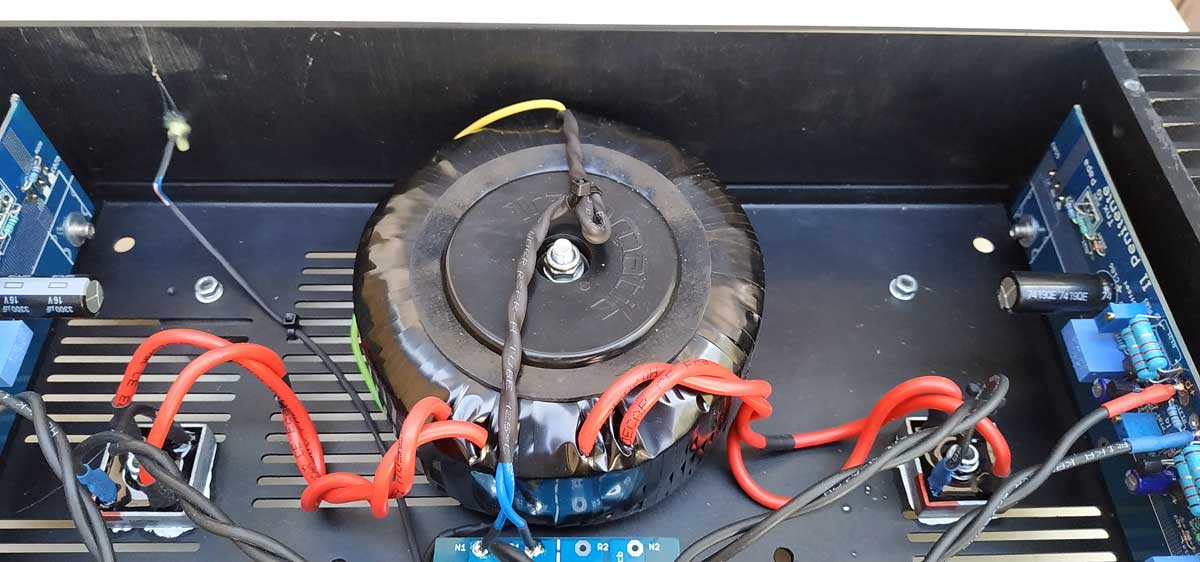

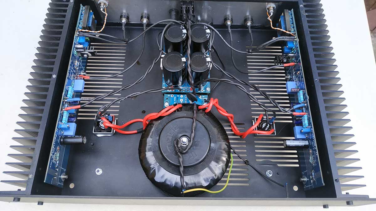

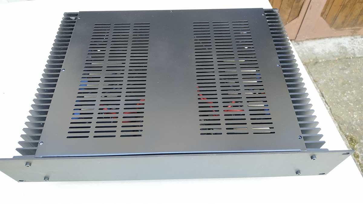

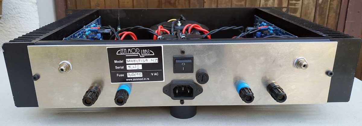

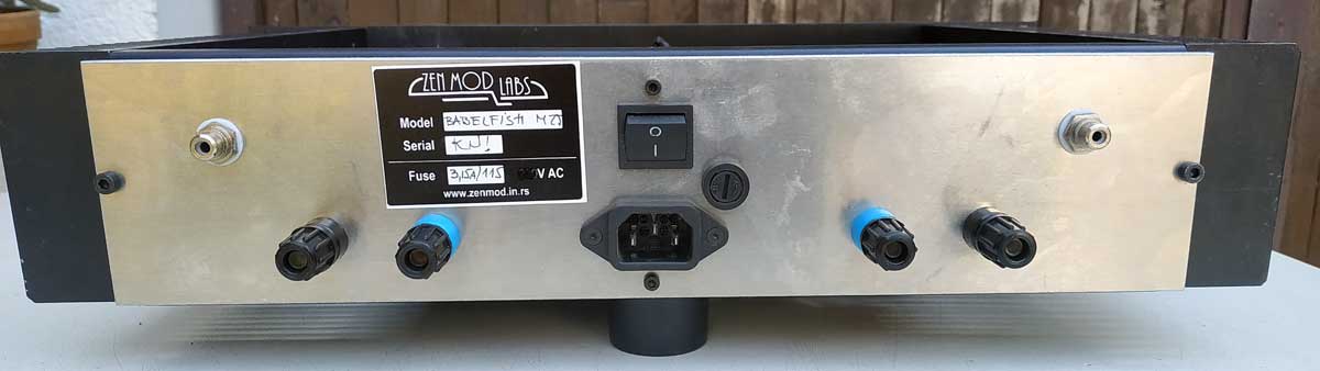

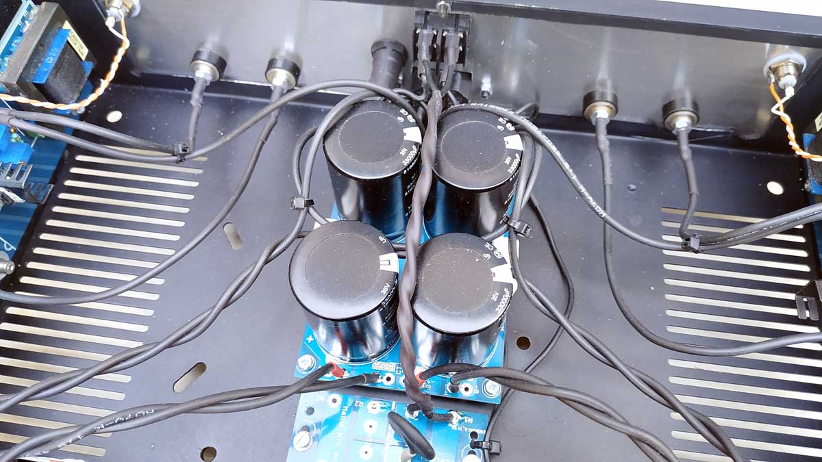

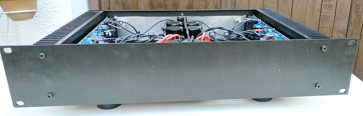

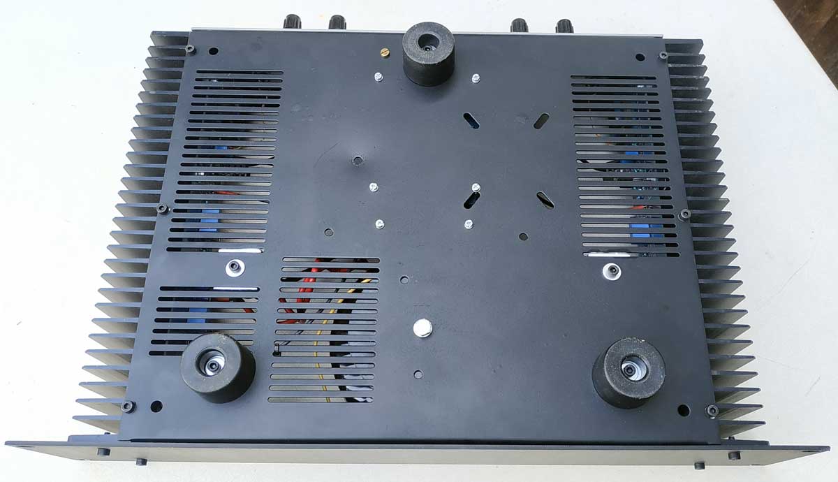

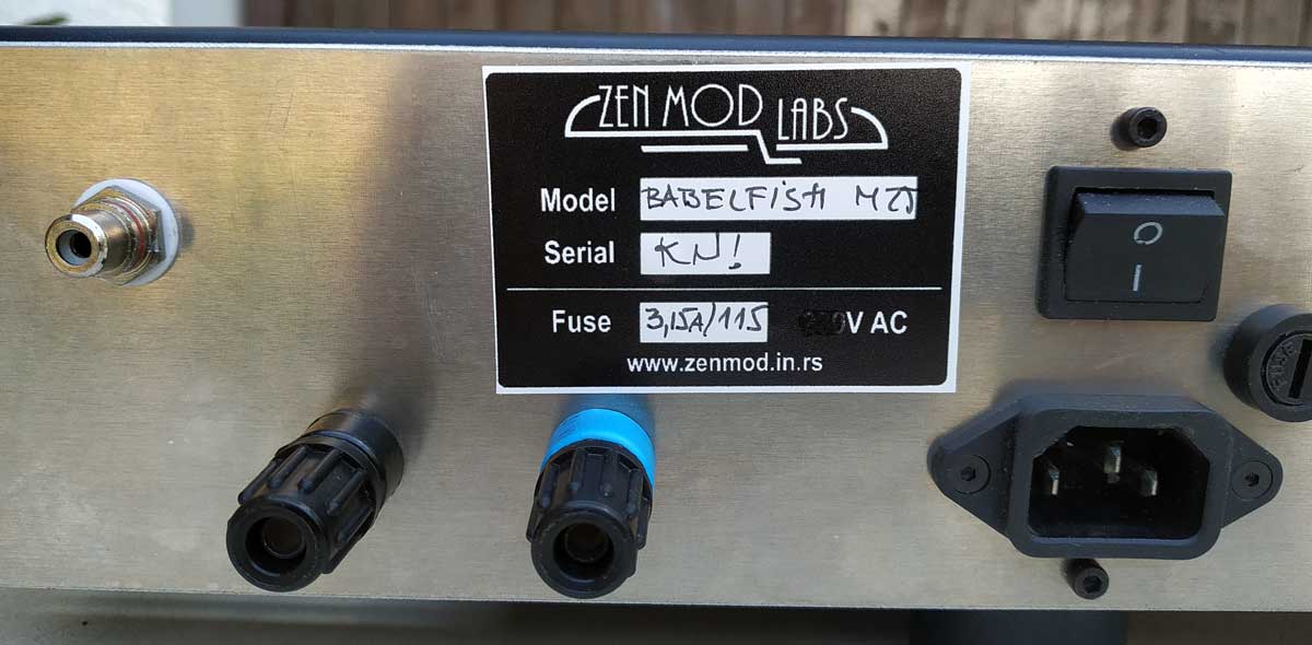

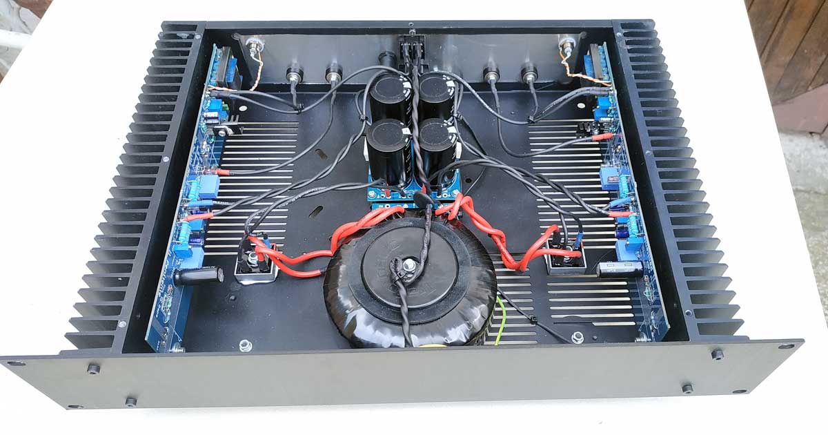

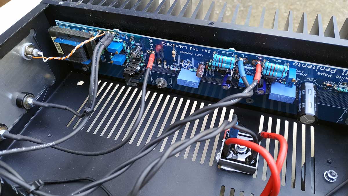

so, I had adequate 2HE/300 case (not new, back to full DIY recycle spirit), ordered custom Donut with Yank primary, had populated Il Penitente boards ........ everything perfect for few lazy afternoons fun work - ended as luke-warm Babelfish M25
spk terminals NOS Hirschman, can't ask for better
RCA, some generic drek, good enough, certainly better than 70% of gold anodized whatsthats around
rails 22Vdc-ish, Iw set to 40W heat per side

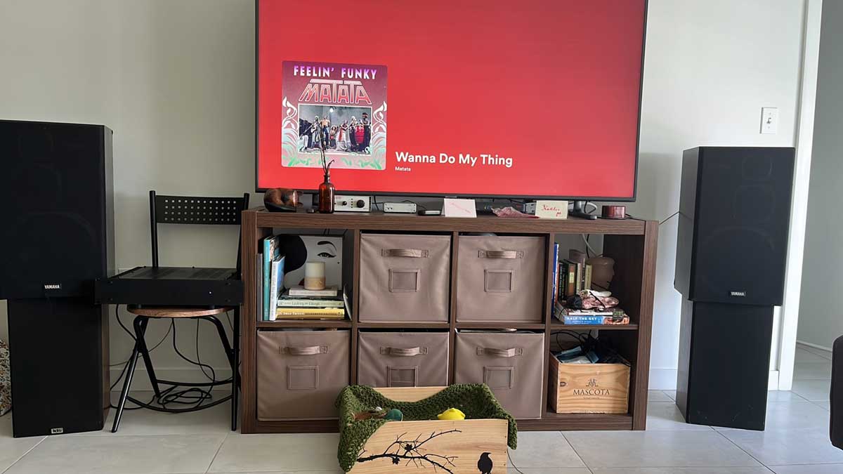

they (Kido and his SheBoss) landed today, and I already got pic of new setup singing
proper amp IKEA furniture already ordered, same as new (all film) caps for Yam NS200MA
yup, Uncle ZM gave him some solder wire, so Viber session for caps changing is inevitable
didn't had any Yank mains solder iron to give, so we ordered nice cheap one from amzn
happiest audiophiles are unspoiled ones, having luck to get some guidance, while really having interest only in music
ZM, happy Uncle
ZM, happy Uncle

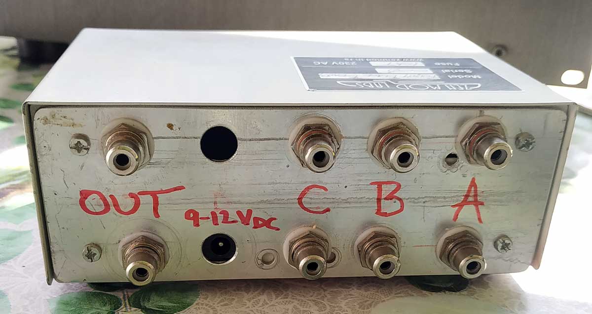

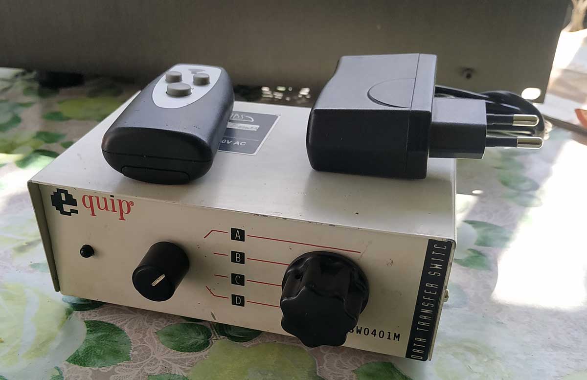

believe it or not, Black Beauty was in that funny box, removed it to mount motorized Alps and its electronic
have another similar box, with 4 channel TKD inside
always handy to have around - proper reference; shattered dreams of more than few Audiophooles with these

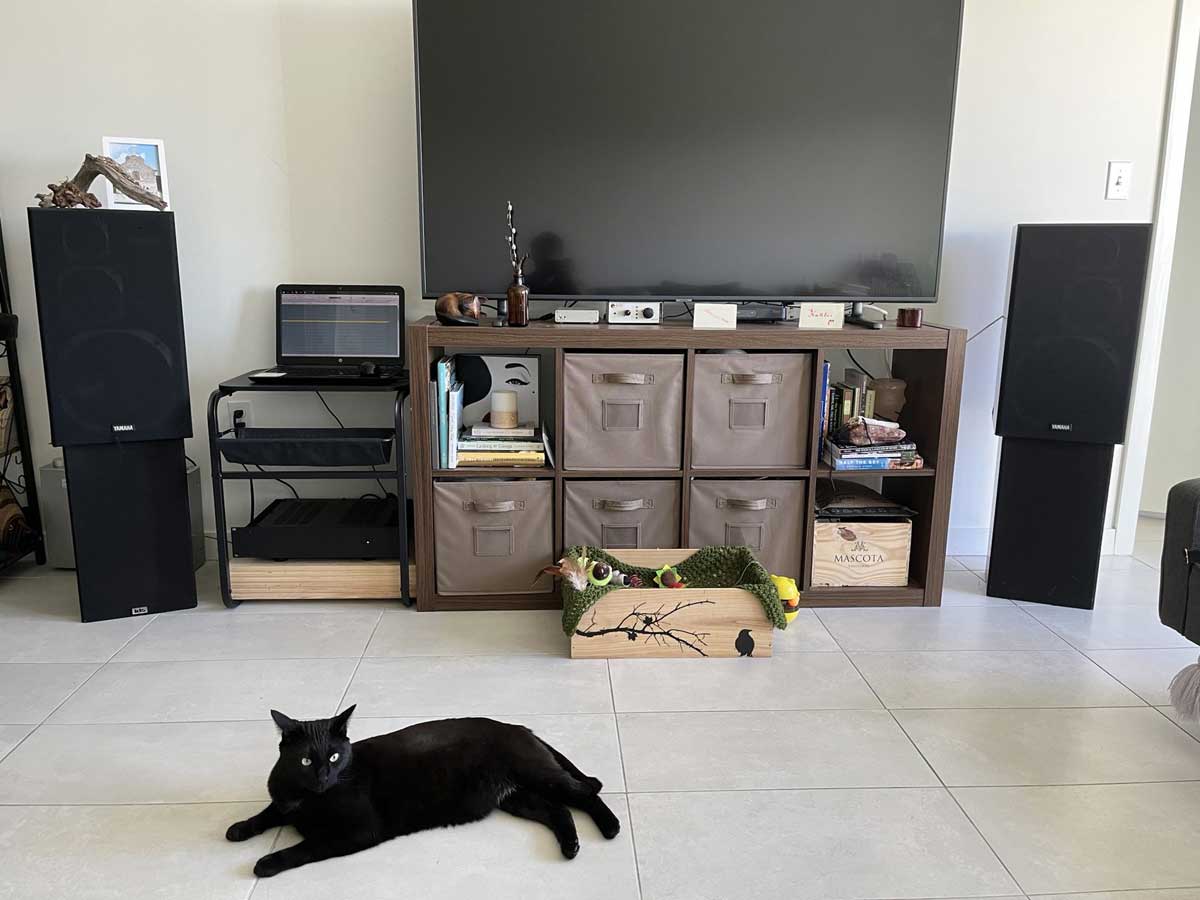

some furniture added
Vlad (Tepes) will soon get some nice carpet, to lay on

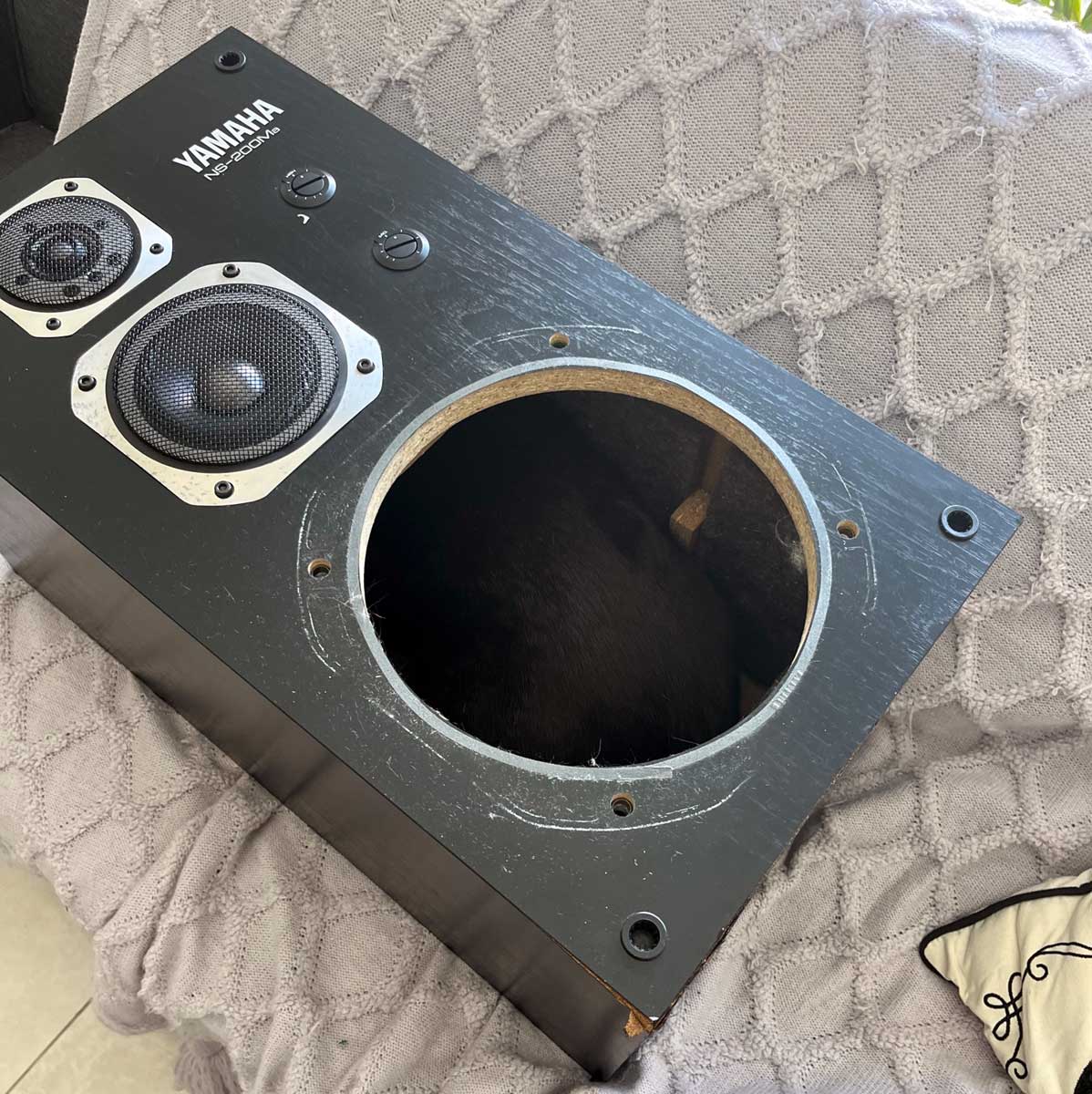

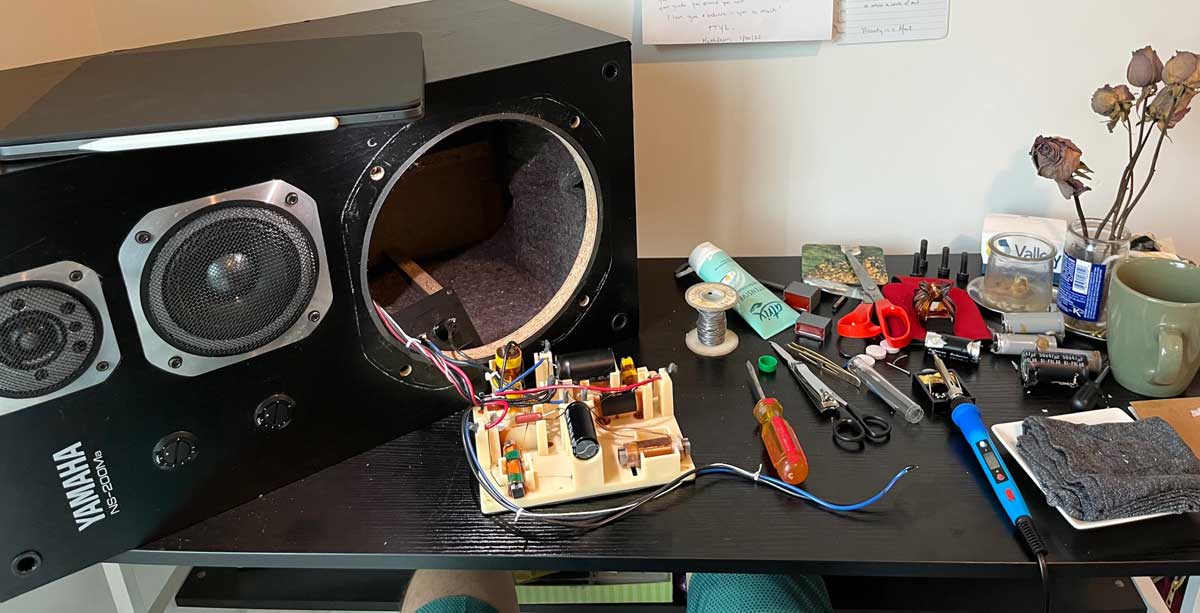

Yam spks, Sleepers from Yore, through extensive Viber session (Batsch - Miami), got all new block caps instead of fluffy old elcos and whatever
2u7, 3u5, 18u, 47u
as I'm informed, it is exactly as expected - heavy blankets removed from spks
not full photo-strip, just most interesting ones
it was practically first time that my kido nephew did soldering job ...... I must confess - it gone easier than I was afraid

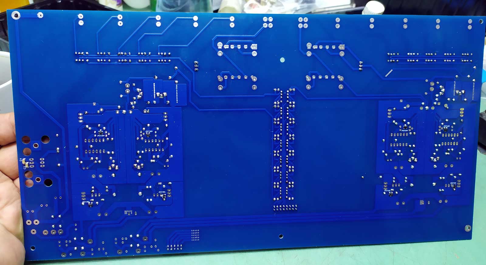

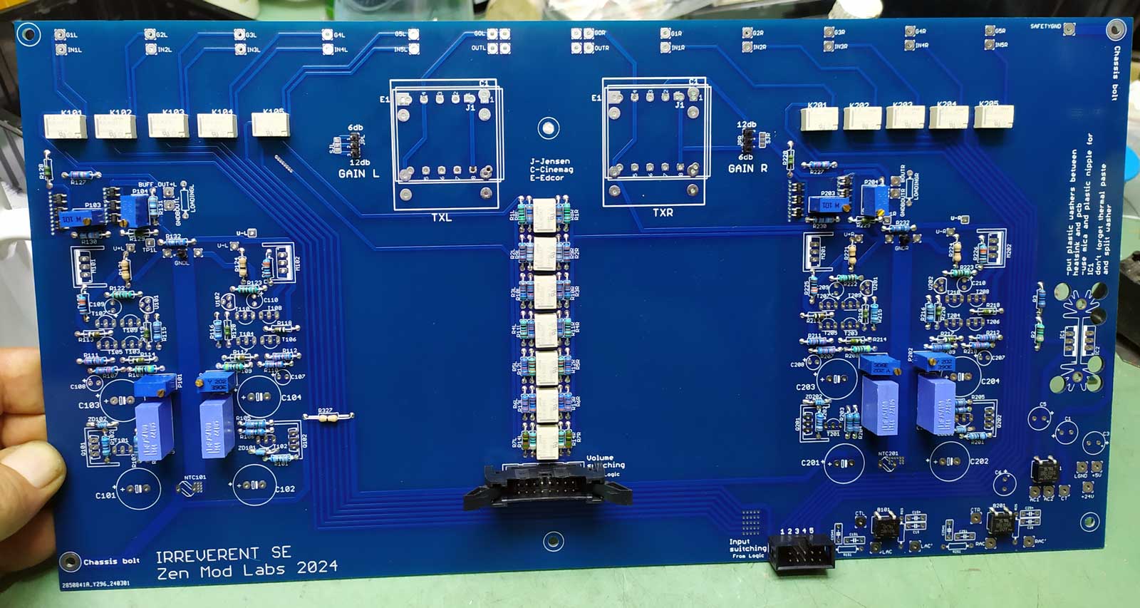

Anyhow, as I promised almost a year ago, this time he's bringing back (to Miami) proper preamp to sit near to proper amp
I've started, hopefully few elements (custom Donuts, faceplate from CNC work) will be in time delivered, so I can assemble it in time
