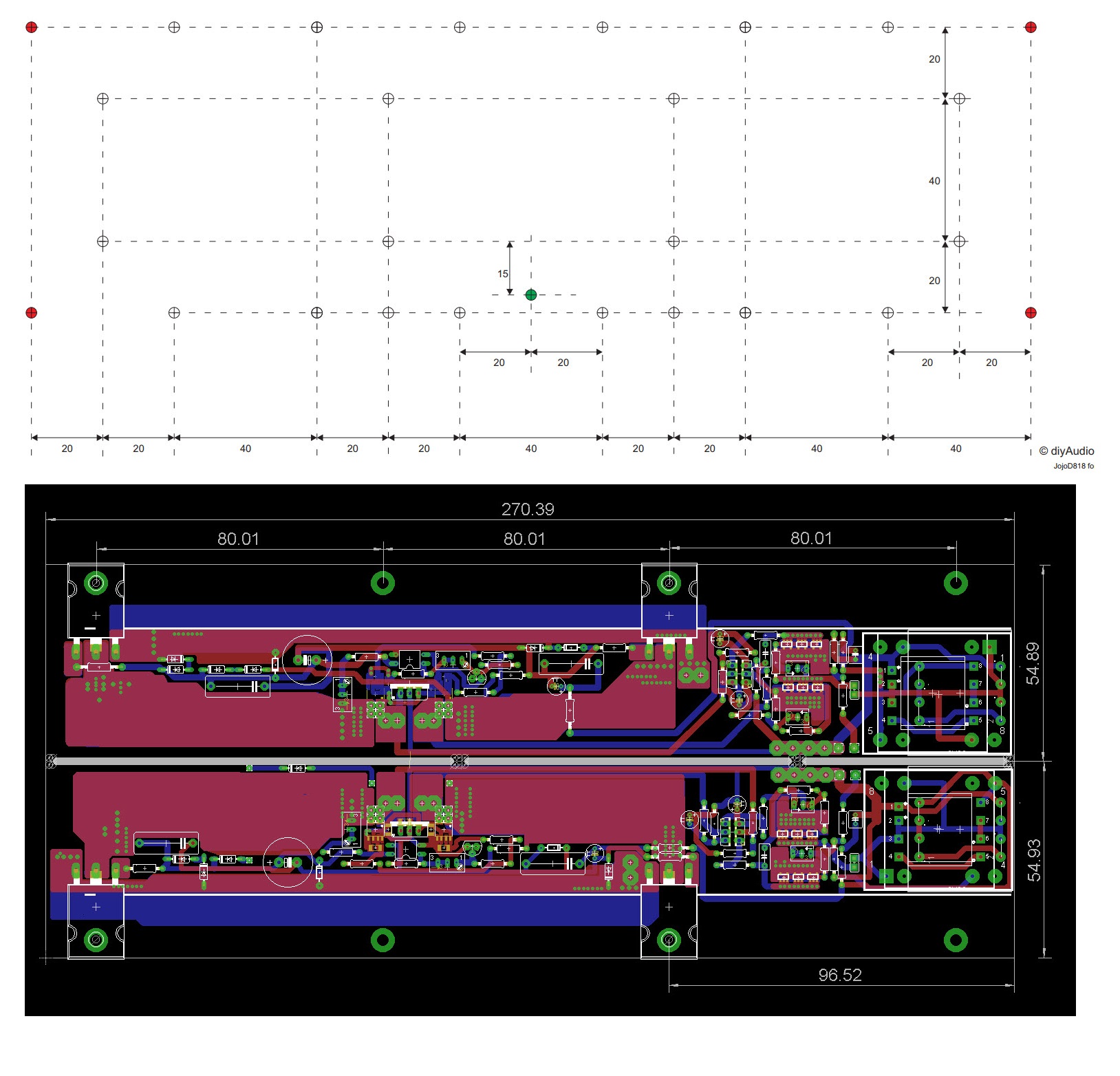

For those cheapskates like me who thought about shoehorning one of these into a Deluxe 4 from the store (and worrying about cooling by fans later) I think it is the case that the board as configured, with the outputs in the designated spots, doesn't actually fit in the chassis using the UMS predrilled holes. I could be wrong, but I've fiddled with it for a bit, and it appears that the M25 in the Deluxe 4 (300mm) chassis would require flying leads on the board to one of the (repositioned) output fets, if avoiding drilling and tapping are your priorities.
The 400 mm deep (non deluxe) chassis is same depth as Deluxe 5. A while back, they provided a member with one pre drilled, but he had to find 4 be others as it required 5 to be ordered. Don't know if it is a "thing" now or not, and if not if they would do another 5. Anyway, just drilling and tapping only the heat sinks isn't that big of a deal.
Russellc
well , it's always possible that I made a mistake :rofl: , but it looked as mosfets are well positioned on half height row

For paralleling devices, would the entire output stage need to be paralleled, so that each N-P pair has its own optocoupler? Without degeneration, it would seem that the only way to effectively share current between parallel devices - which cannot be matched perfectly - is to control the bias points of each N-P pair individually.
Reactions: Robin De Wolf
I don't plan on it, it was just a matter of curiosity - I noted that there was at least one prototype in the F4 Beast thread that used parallel IRFP devices without degeneration to avoid having to use the hockey pucks, and this seemed like one way to add some reliability. The little hall sensors and optocouplers would add up $$ though in a paralleled design.
I wouldn't parallel them in any way without source resistors
having biasing network for each parallel pair could be just another recipe for disaster, at least as it looks for me
disclaimer - someone smarter maybe is having a way for that, but I'm chicken
pucks are way to go, for another Berserking level
