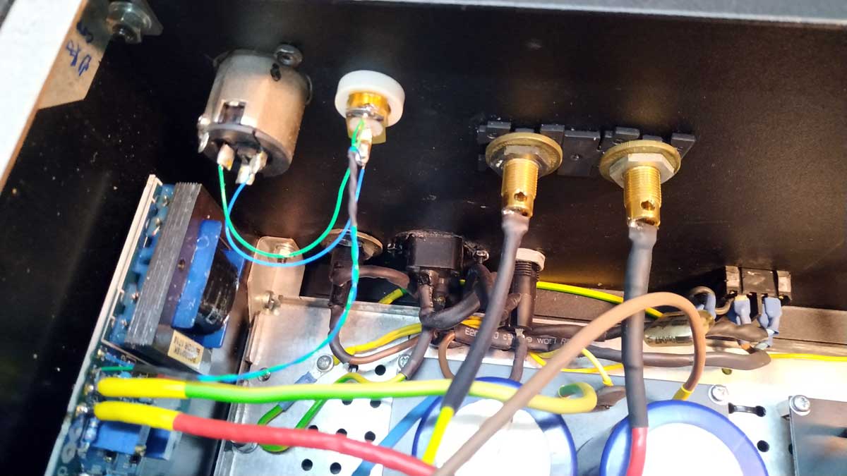

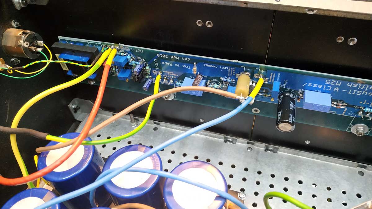

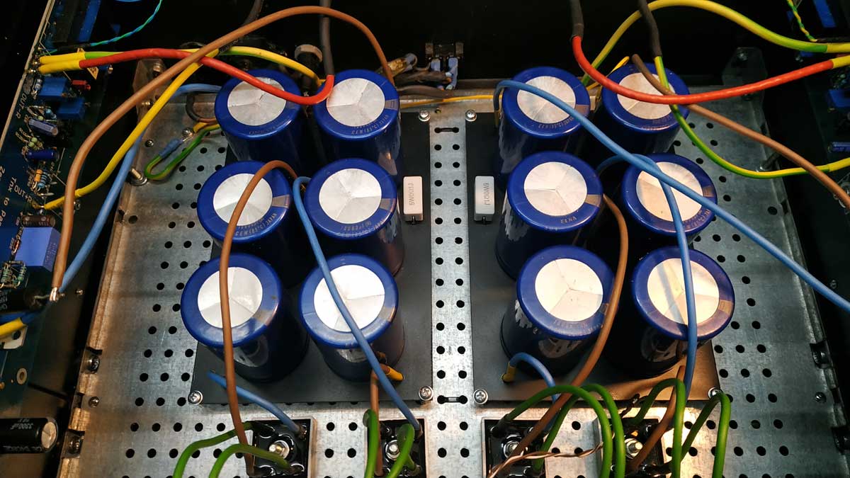

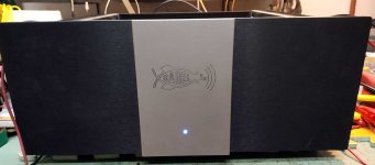

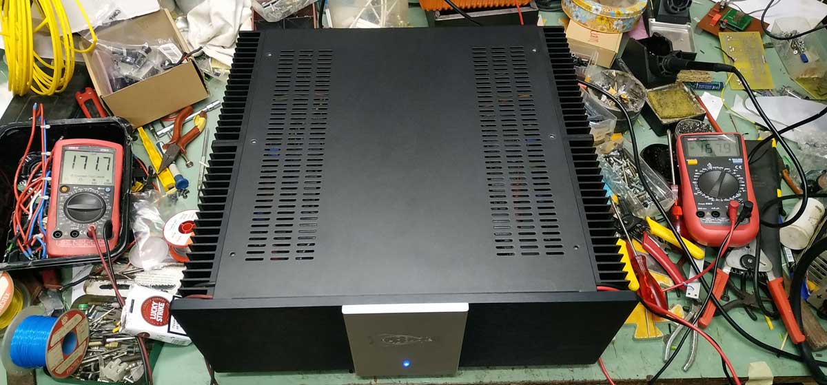

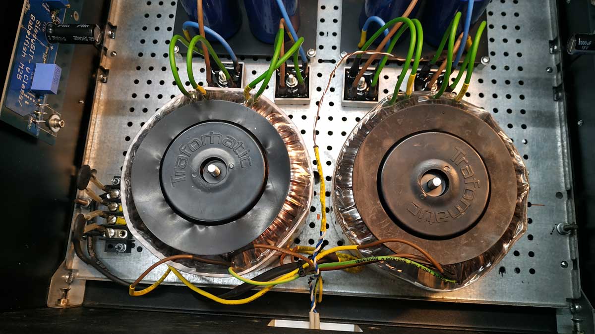

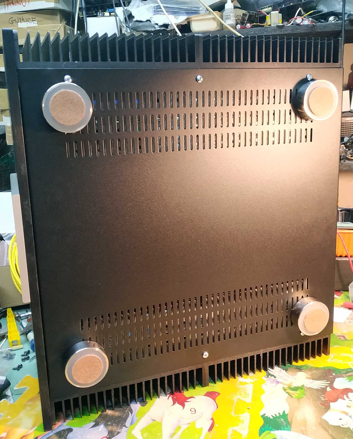

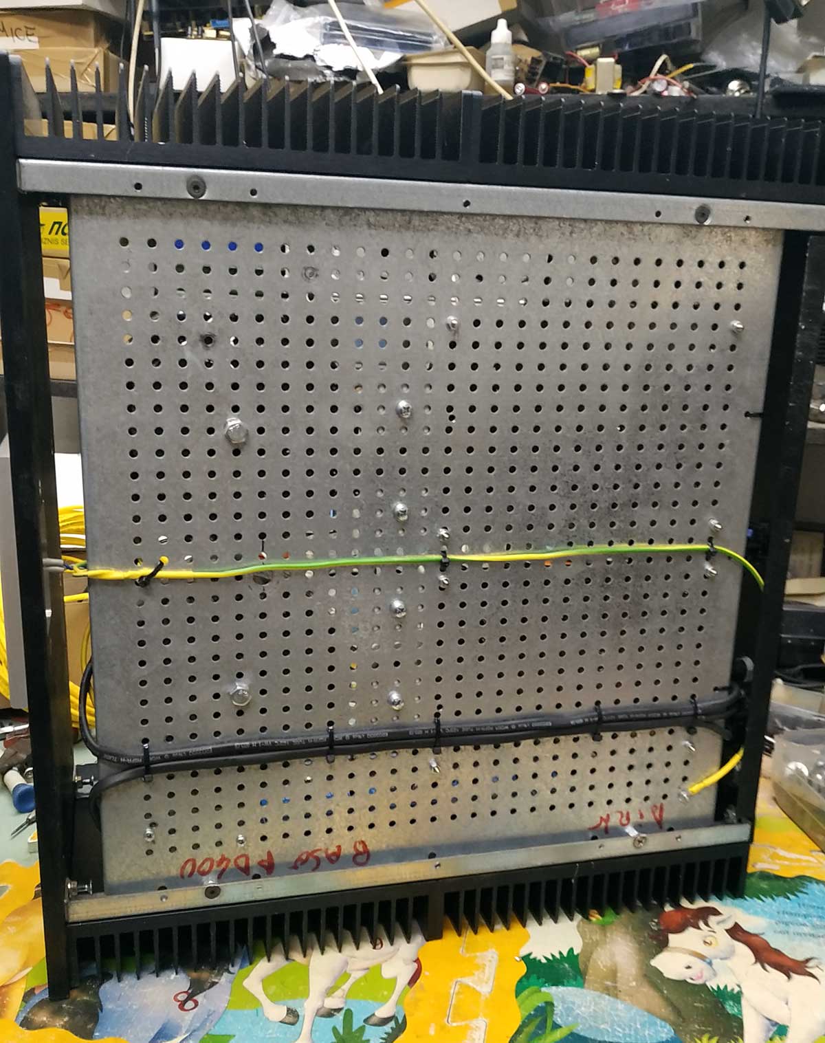

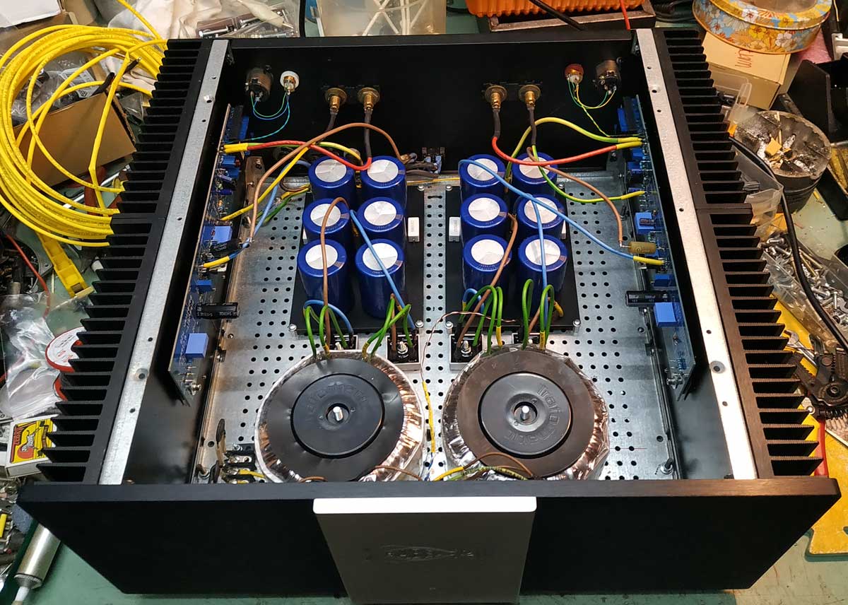

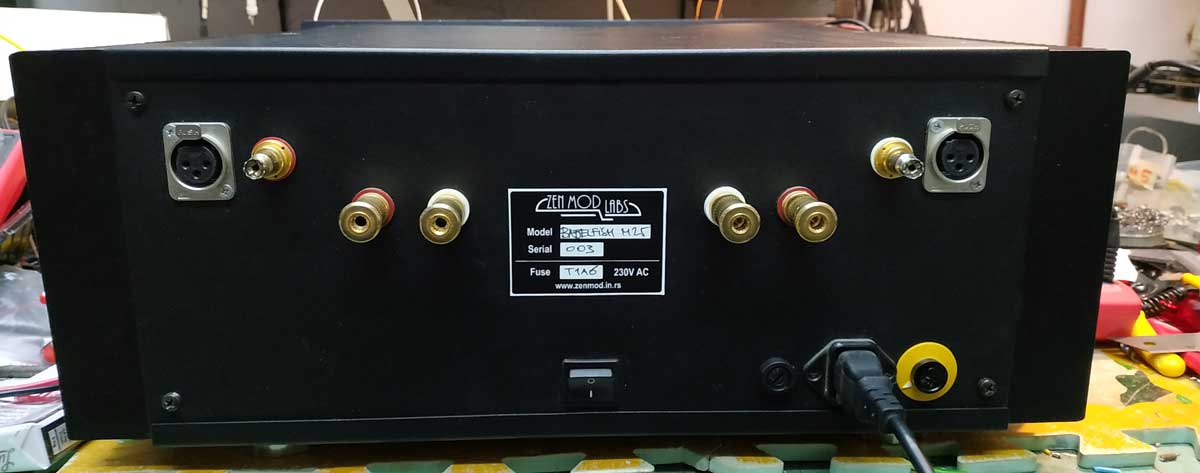

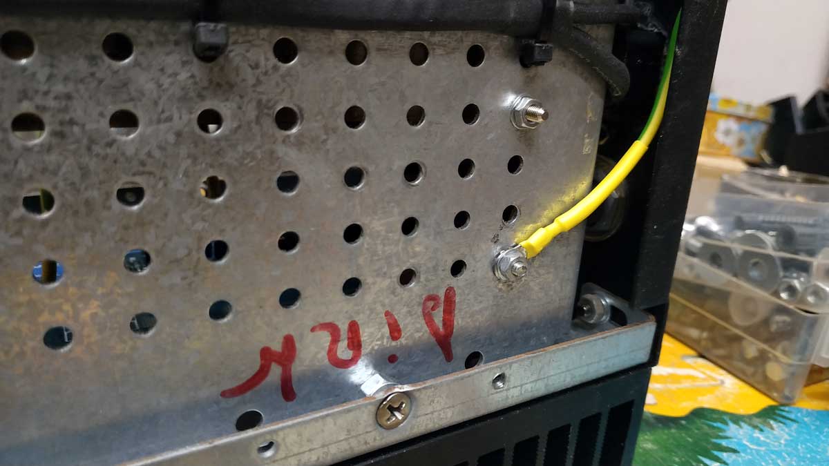

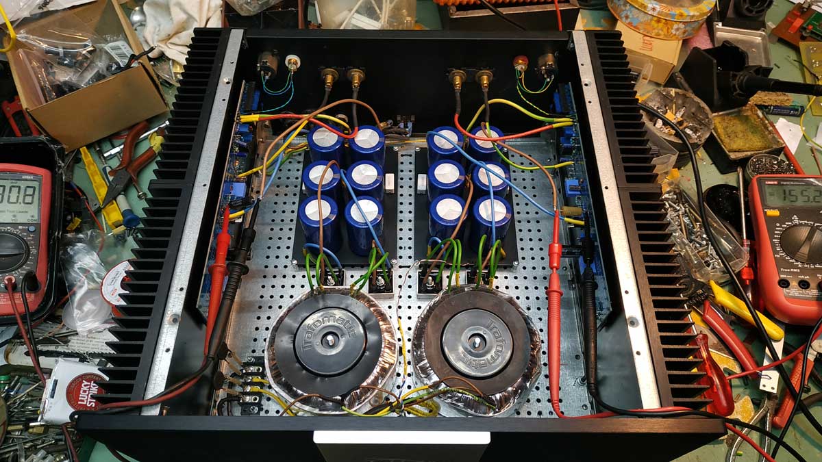

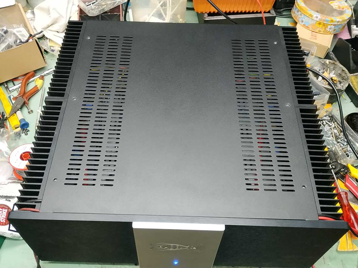

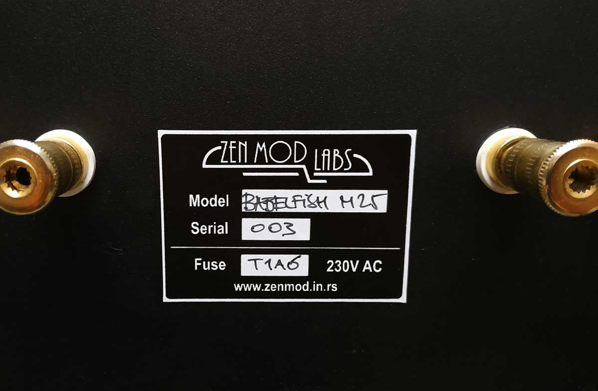

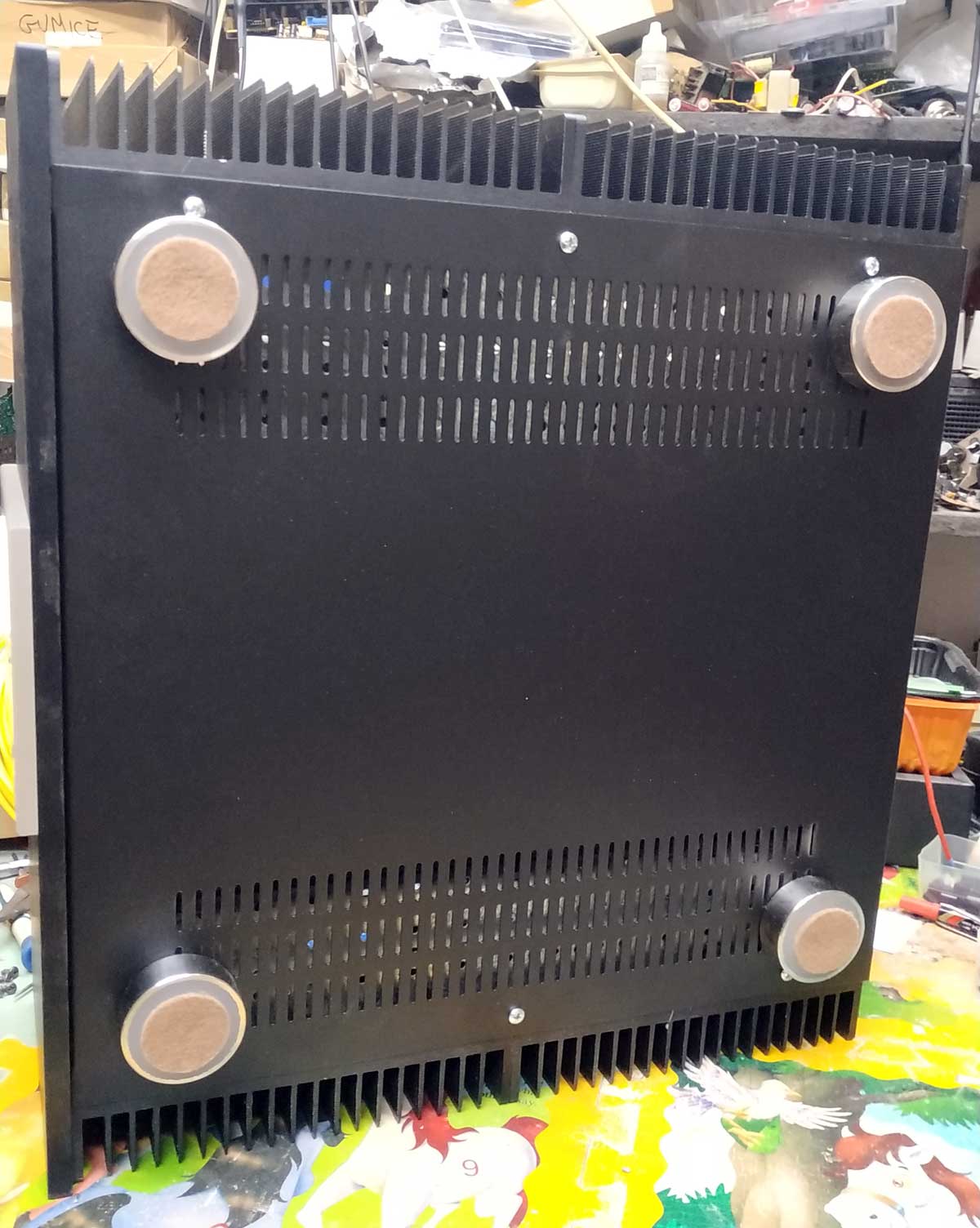

finished just yesterday another one , sorta Chameleon or Convertite amp
was F4 in first instance , not made by me
then I converted it to Babelfish J , funny - additional front panel engraved to Babelfish J2 due to miscommunication between owner and guy who made the plate
now , hope finally, converted to Babelfish M25 , also changing from common PSU to proper dual mono

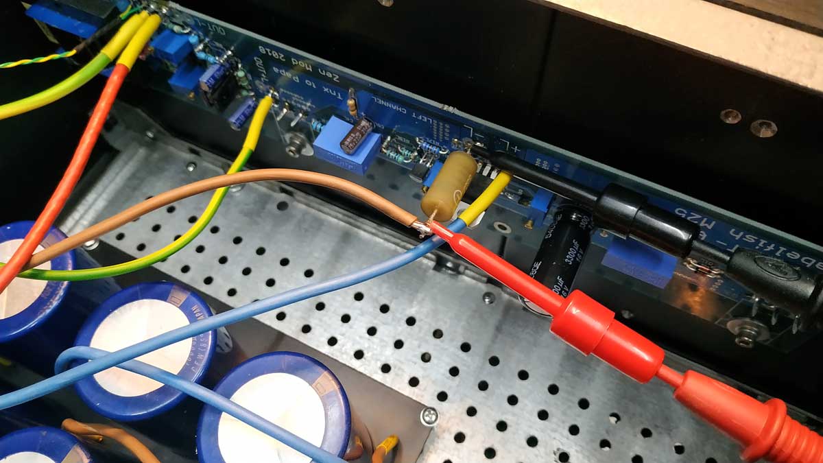

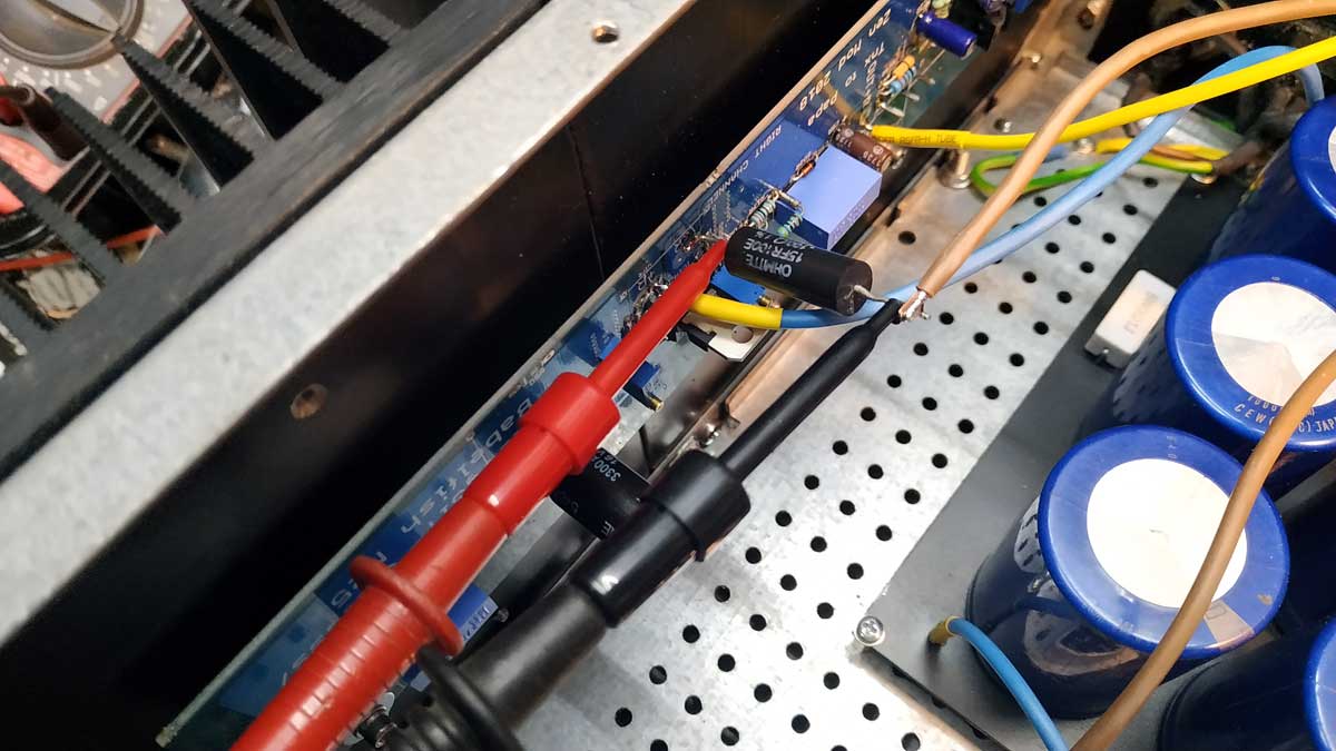

in Babelfish M25, SissySIT - general building tips and tricks , I'm specifically saying that you use 0R1 in negative rail for monitoring Iq , more important to be in neg rail for Sissy , of course
though , if one is using CRC filter in PSU , Iq can be monitored on R in CRC , so no need for additional 0R1 , inserted temporary in neg rail
so , you said 10R ??

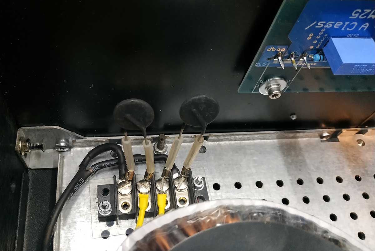

more of Convertite
