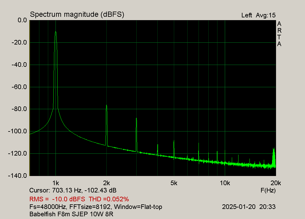

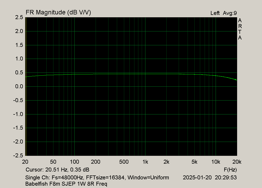

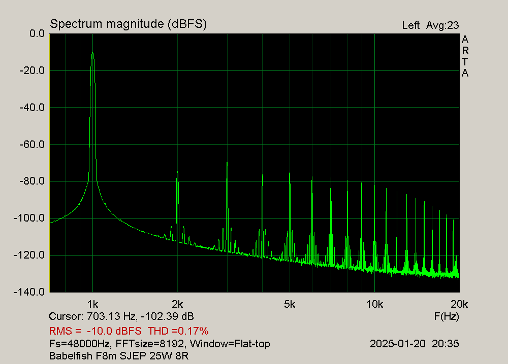

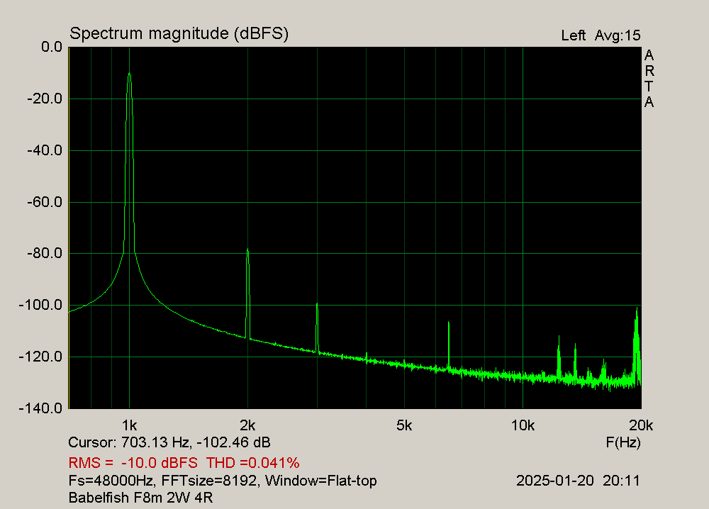

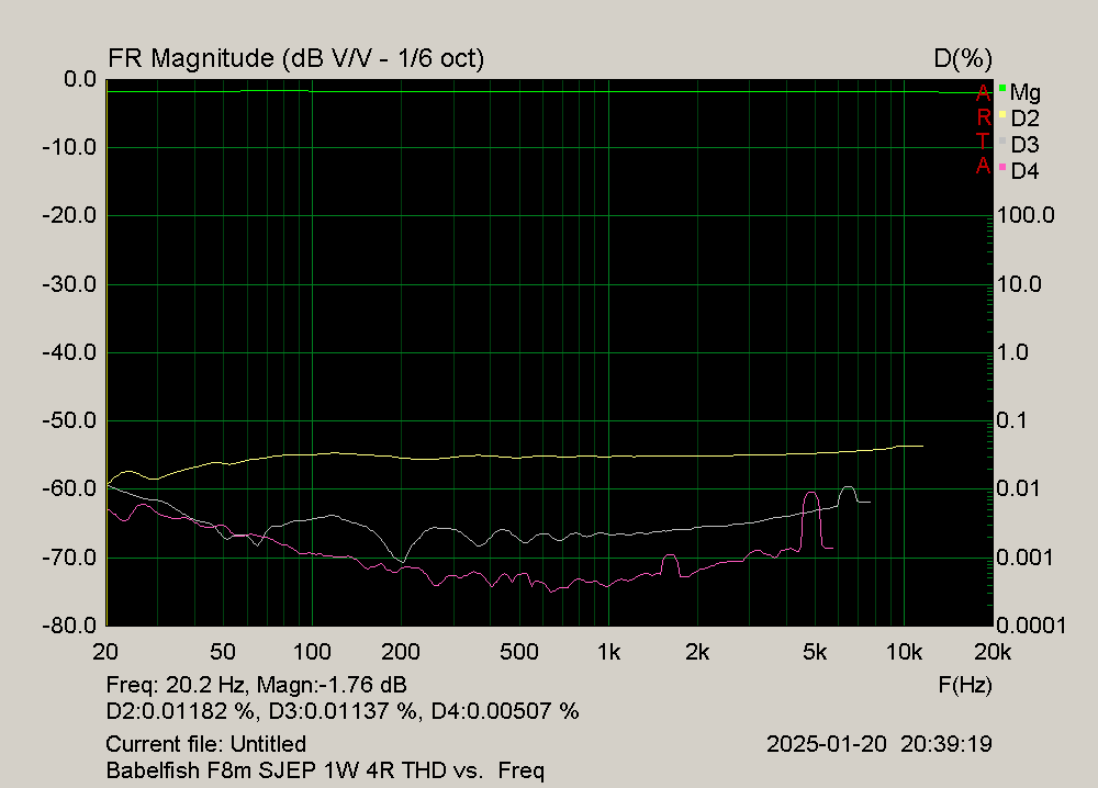

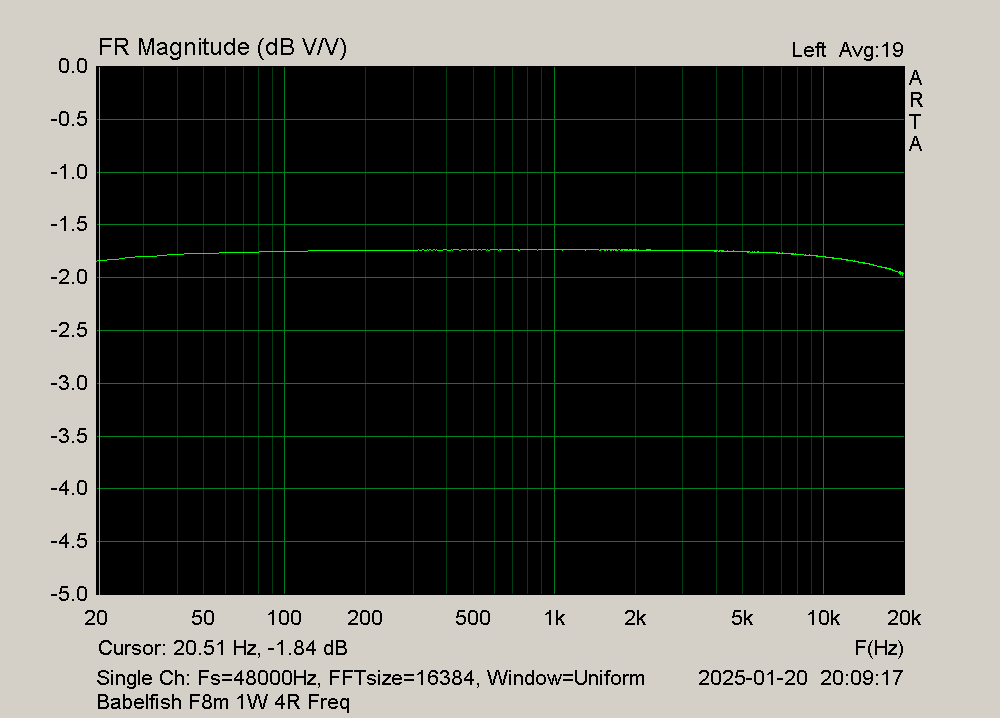

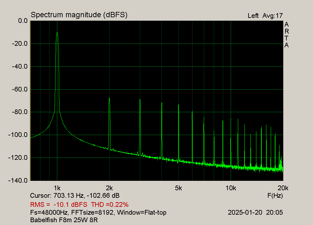

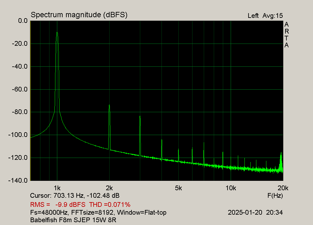

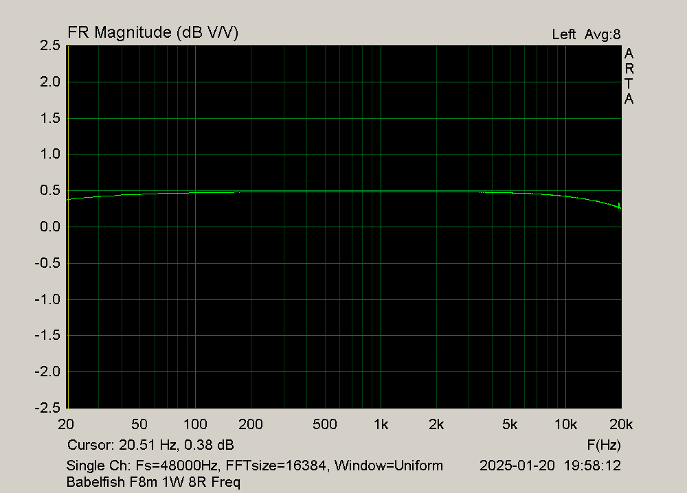

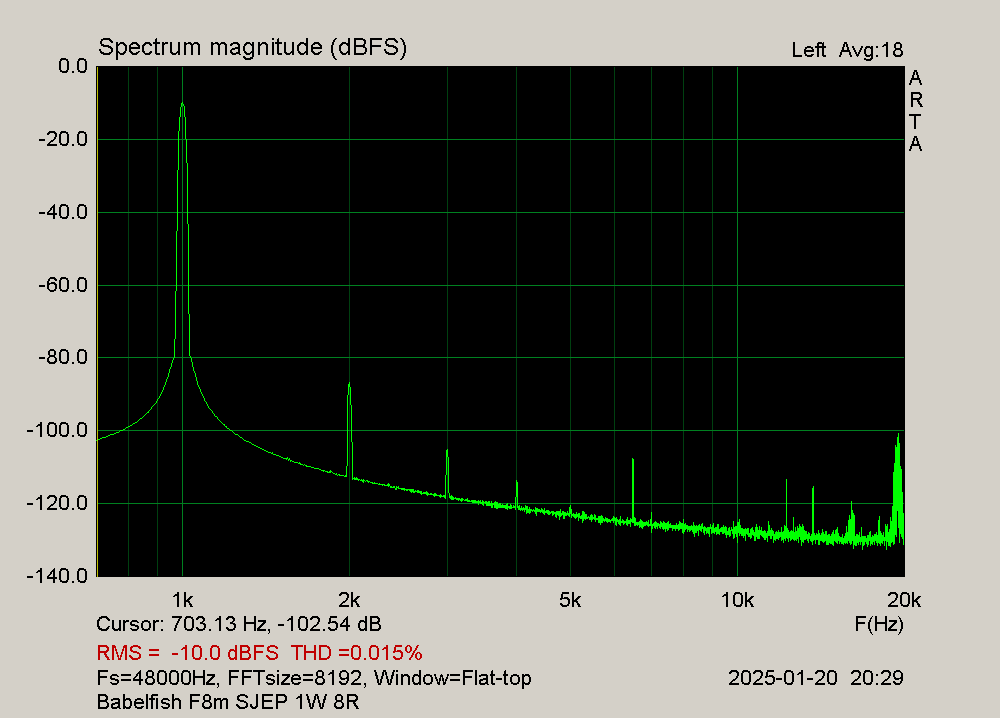

Usual Pudding

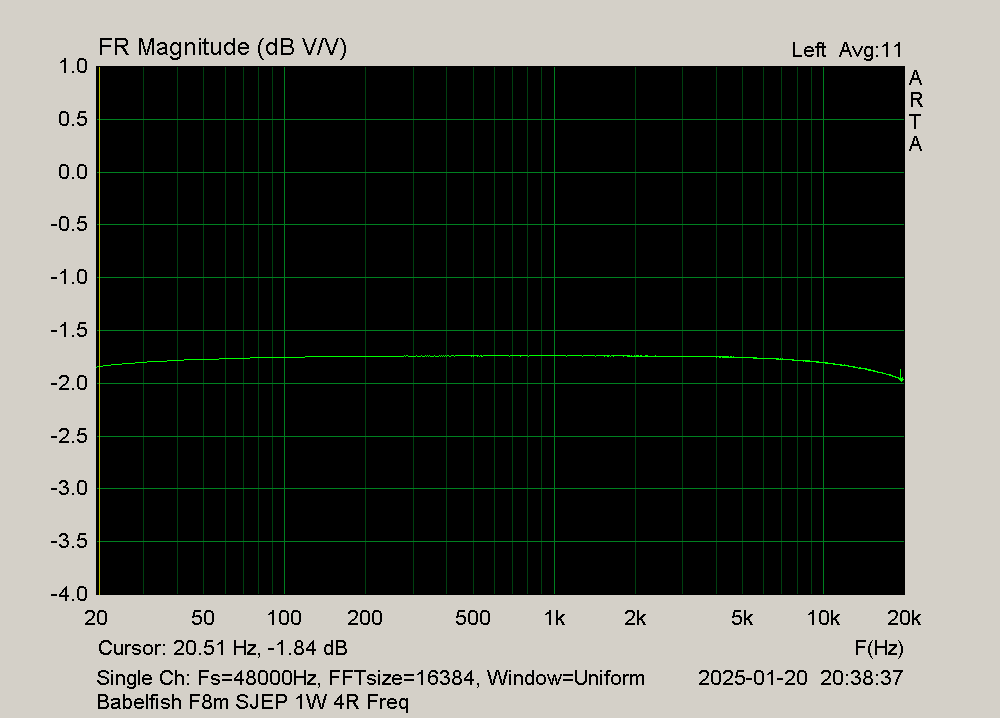

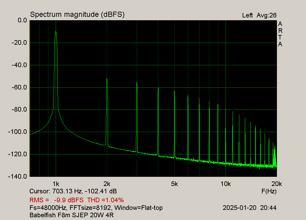

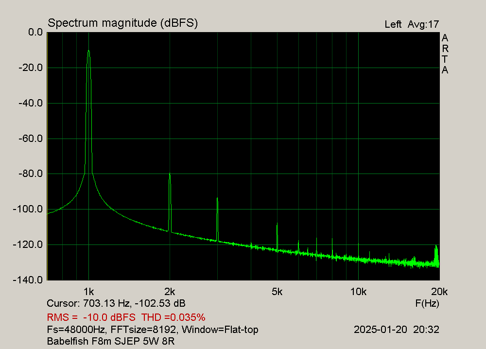

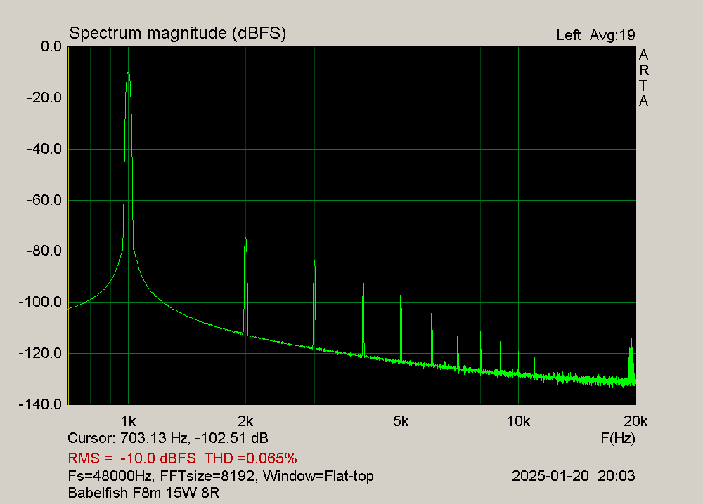

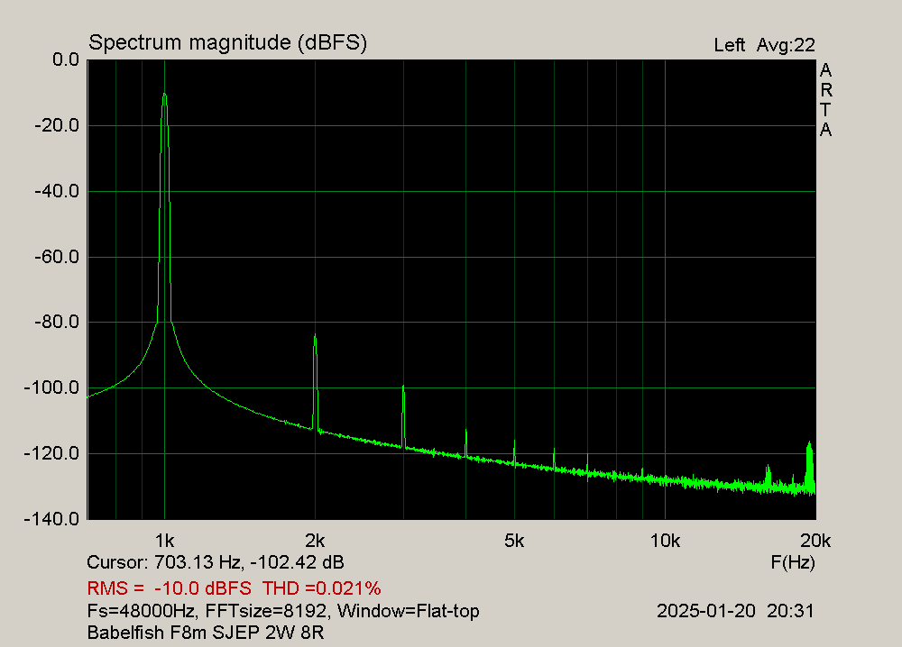

SJEP down, 8R load
SJEP down, 8R load

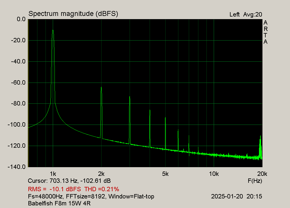

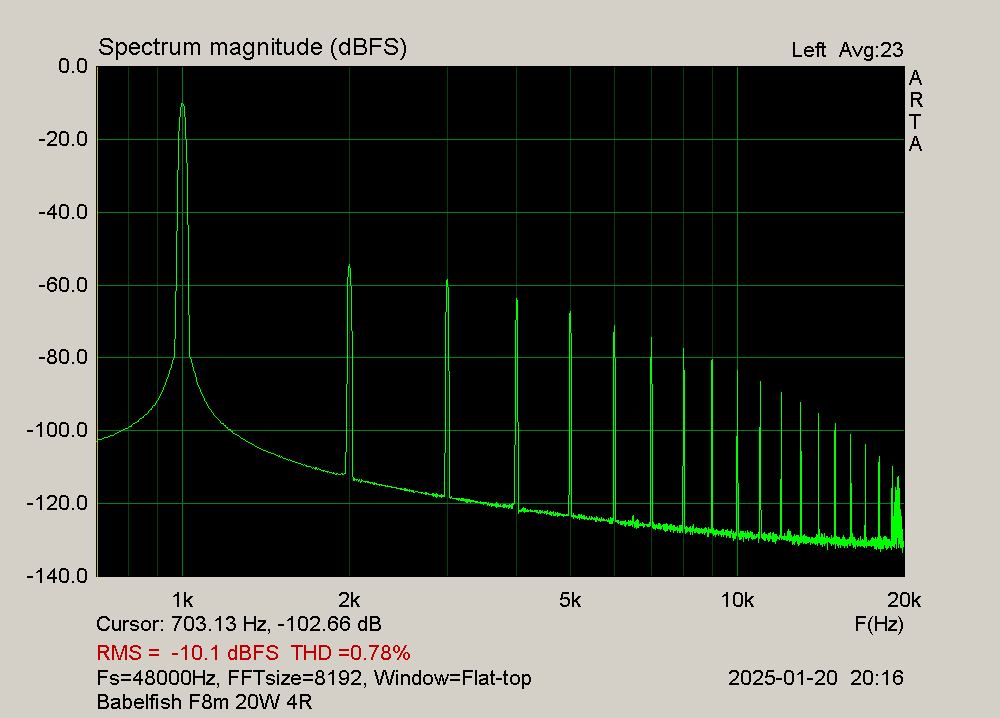

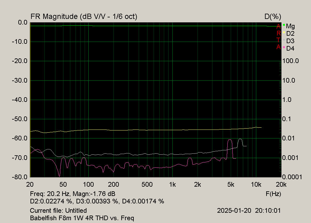

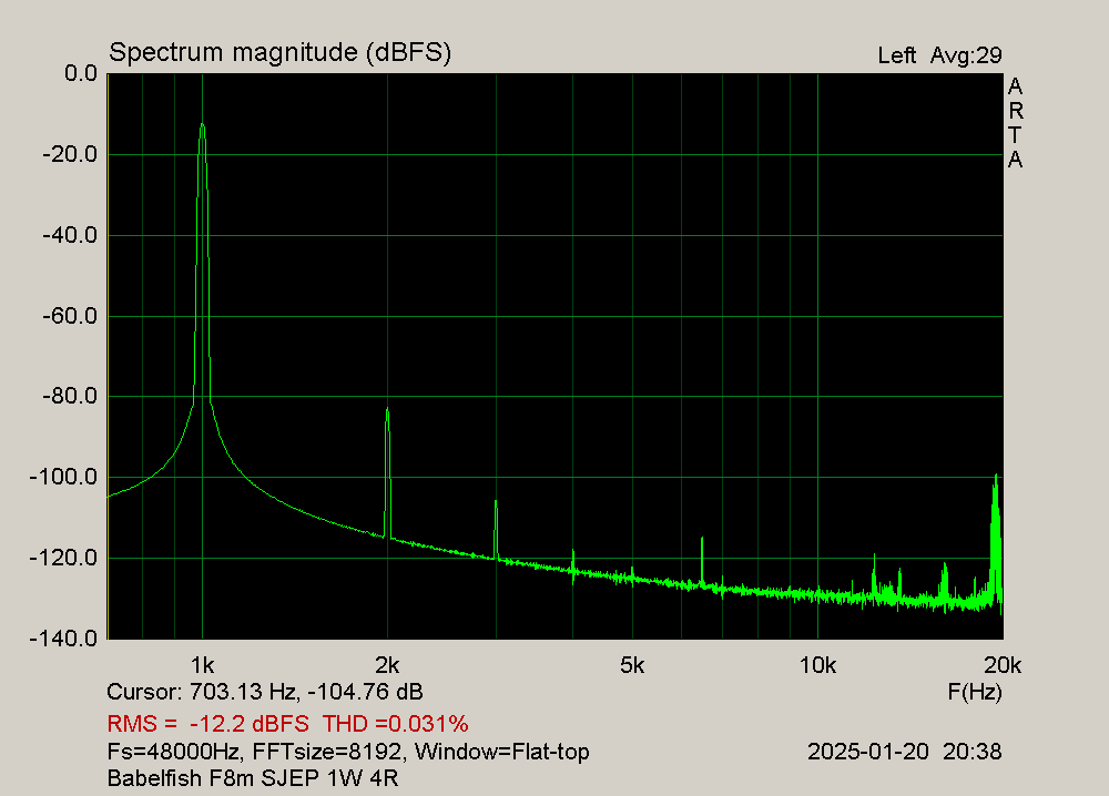

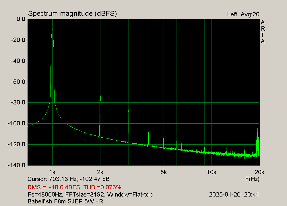

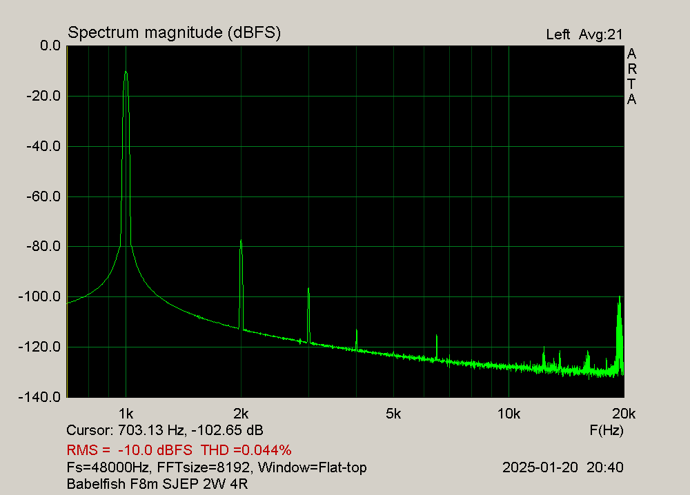

............... SJEP down, 4R load

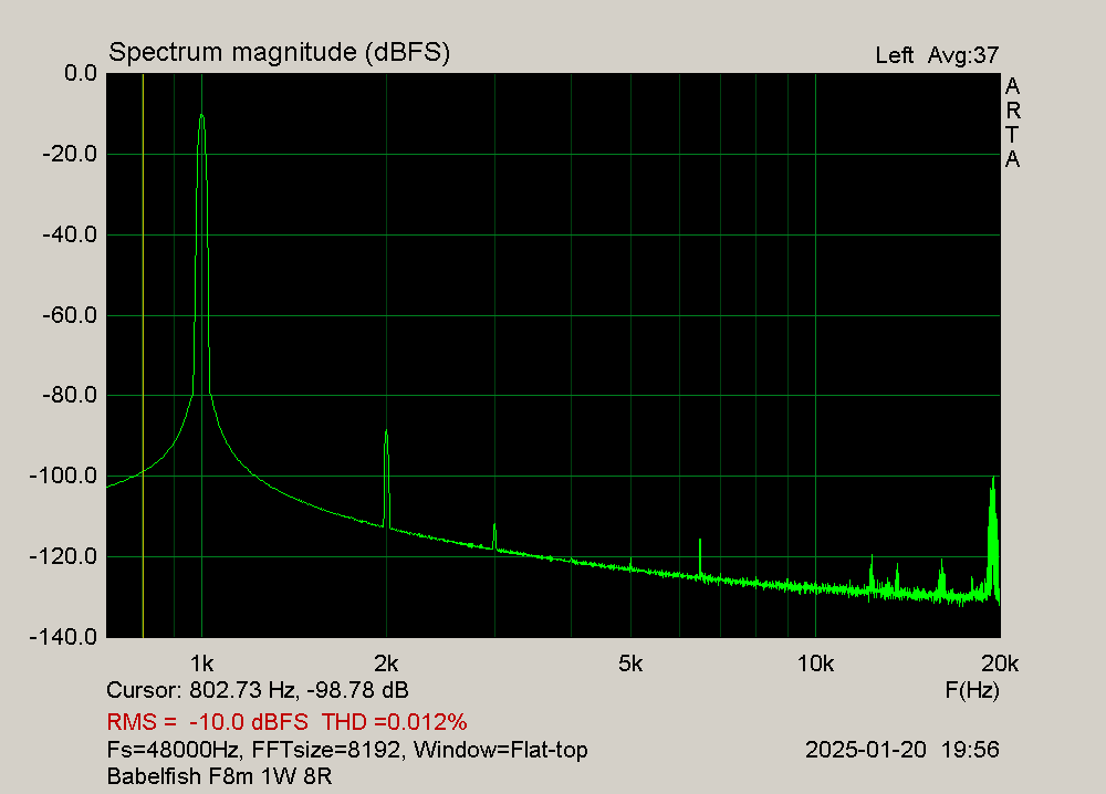

All IRFP150, 8R load
....... same, 4R load
Lovely giggly wiggly, ZM. That looks like it sounds quite good.
That is, sounding the same as all your other amps.

I really appreciate all the data you give us and 3 BFF8s - unbelievable.
The question especially for old folks like me - could I hear the difference between the three?
I am so lucky to have a number of your amps and I can appreciate the differences there. XA252 Big Puck is getting a lot of play these days but the Sissy is right behind. Scryer and F8a are ready to go on heat sinks and I think they will provide interesting comparisons. Just my thoughts.
Your posts keep me young 😊

I see 4x IRFP150 ??If you look carefully ZM sent SJEP instead of IRFP 🙂
Yes, yes 4 x IRFP......just tried to be fun......or check if you were awake 🙂
with so easy speakers as you have (Pass Labs Tannoys), I believe no big difference ......
But then, this amp format is made for such speakers
what I forgot to say - I made 2 additional iterations just because ...... as conceptual problem solving fun, but - as main criteria - trying to have them in same quality bracket as first one, and then, hopefully, with Papa's original
So, again, not expecting too much of difference sound-wise
After all, what's +/-6db of difference, between friends

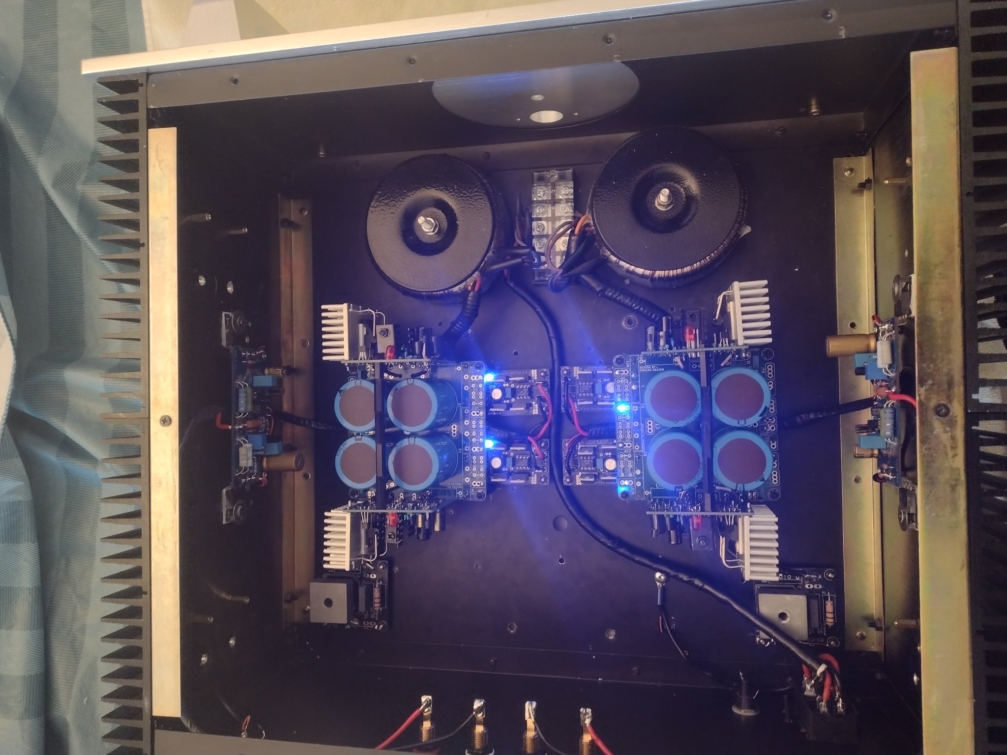

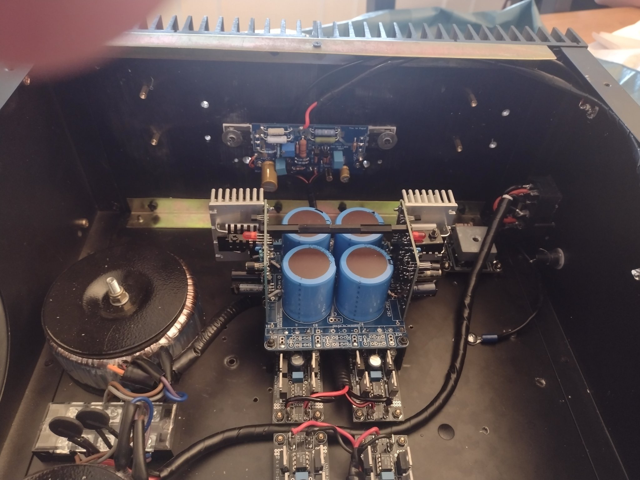

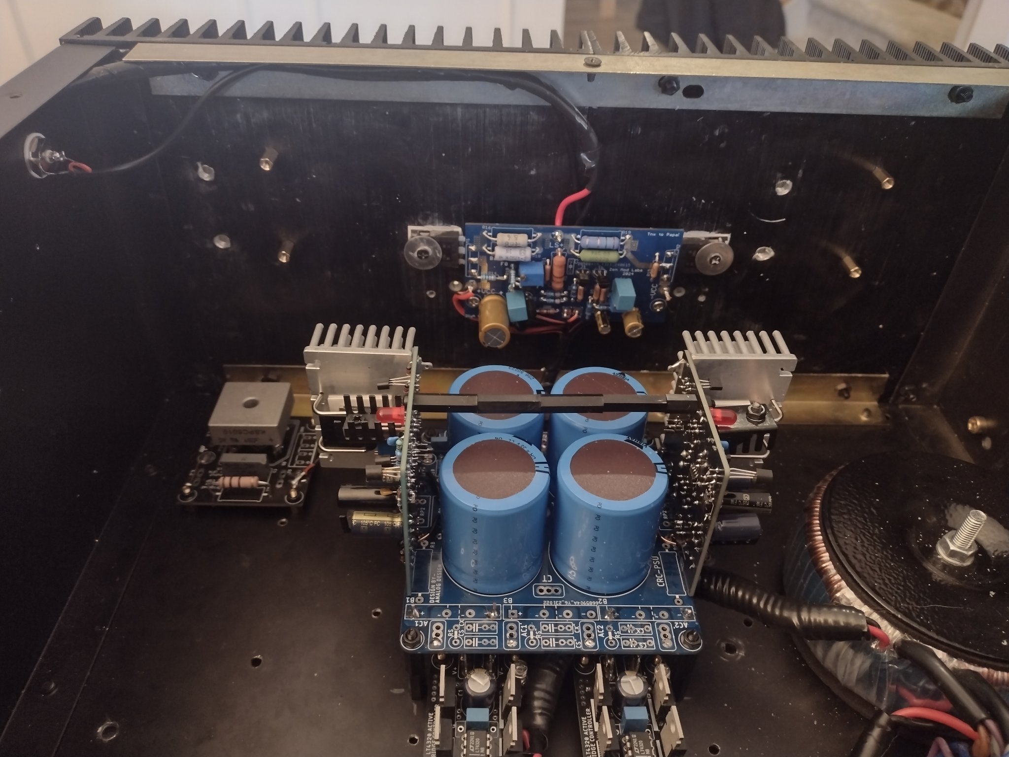

No idea if it makes music, but bias is set to 490mv across r16 and offset is close to zero on both channels. Had a little hiccup with 4 volts of offset on one channel which turned out to be a cold solder joint on the trim pot. All good now. Dual mono setup with 160va trafos, LT4320 rectifiers, R21 modules and IRFP150s(until I win the lottery)
